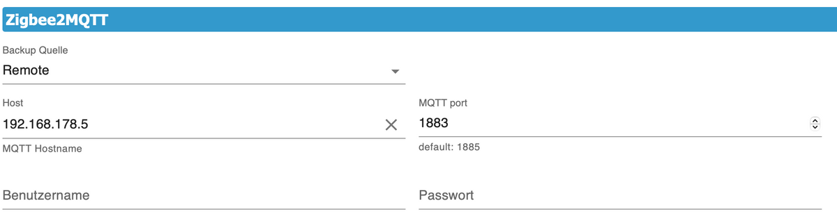

                            Ich habe das mal getestet und bekomme ne Fehlermeldung.
                            21:45:49.323 DEBUG zigbee2mqttConnected to MQTT broker, sending Zigbee2MQTT backup request...
                            21:45:59.303 ERROR zigbee2mqttError: Timeout waiting for Zigbee2MQTT response
                            Hier die Konfigurationen
                            Backitup V3.2.2
                            Zigbee2Mqtt Adapter V3.0.6
                            simatec 1 Reply Last reply Reply Quote 0

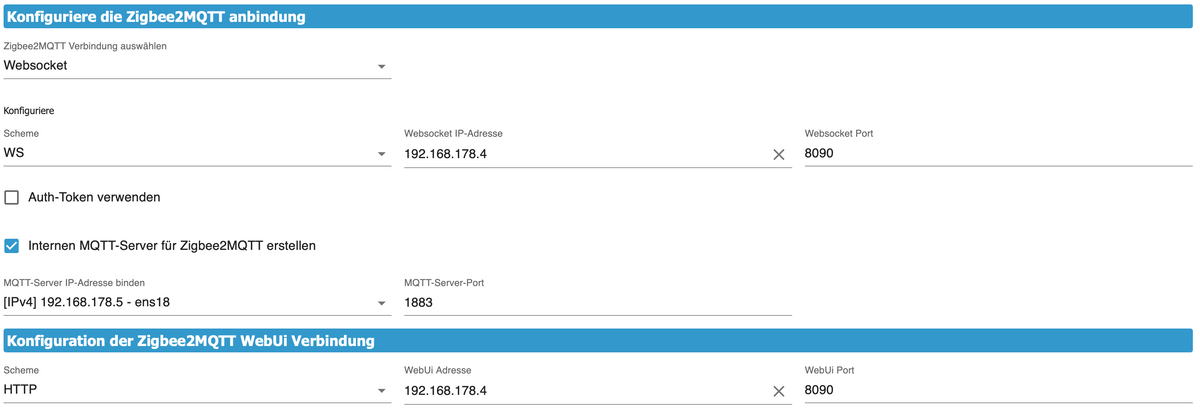

                                    MichMein @simatec last edited by
                                    Hi @simatec,
                                    hier meine Konfiguration des Z2M Adapters.
                                    zigbee2mqtt.0.json
                                    arteck 1 Reply Last reply Reply Quote 0
