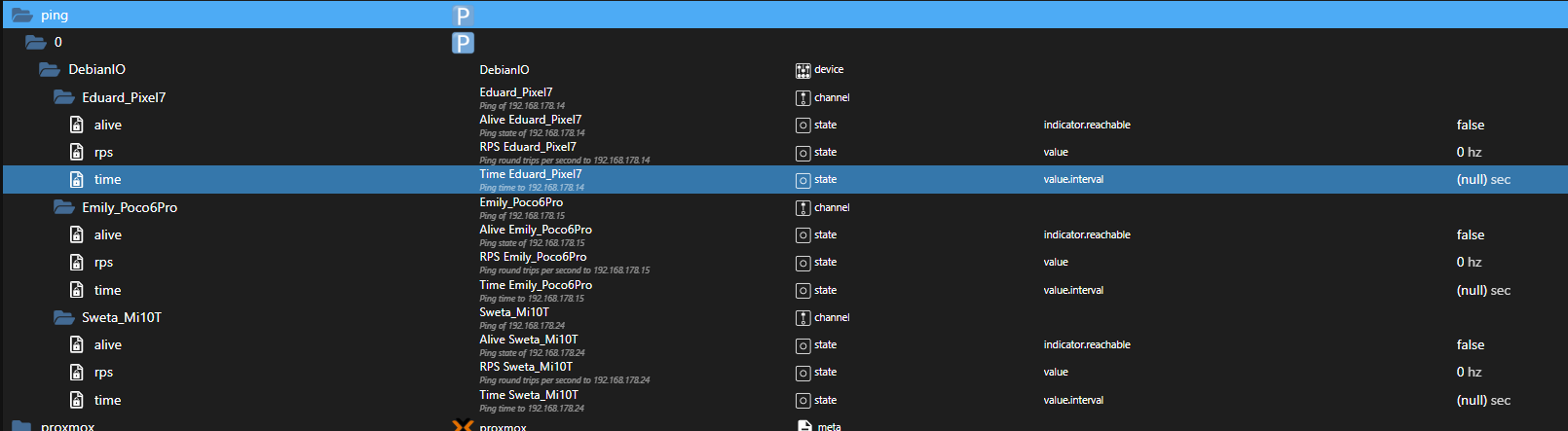

        • Eduard77
          Eduard77 @Dr. Bakterius last edited by
          @dr-bakterius sagte in Upgrade von Debian 12 'Bookworm' auf Debian 13 'Trixie':
          sudo apt-get install iputils-ping --reinstall
          Tut mir leid, dass ich erst jetzt antworte.
          Ich habe jetzt versucht nochmals mit deinem Code zu machen.
          Hat wieder nichts gebracht.
          edi77@DebianIO:~$ sudo apt-get install iputils-ping --reinstall
          [sudo] password for edi77:
          Reading package lists... Done
          Building dependency tree... Done
          Reading state information... Done
          The following packages were automatically installed and are no longer required:
            g++-12 libassuan0 libavcodec59 libavdevice59 libavfilter8 libavformat59 libavutil57 libc-ares2 libcares2 libcodec2-1.0 libdav1d6 libdrm-nouveau2
            libdrm-radeon1 libepoxy0 libflac12 libgirepository-1.0-1 libglapi-mesa libjsoncpp25 libjxl0.7 libllvm15 libmbedcrypto7 libmfx1 libnl-3-200
            libnl-genl-3-200 libnsl-dev libplacebo208 libpostproc56 libpthread-stubs0-dev librav1e0 librhash0 libssh-gcrypt-4 libstdc++-12-dev libsvtav1enc1
            libswresample4 libswscale6 libtheora0 libtirpc-dev libvpx7 libx265-199 libxcb-dri2-0 node-busboy node-cjs-module-lexer node-undici node-xtend
            x11proto-core-dev
          Use 'sudo apt autoremove' to remove them.
          0 upgraded, 0 newly installed, 1 reinstalled, 0 to remove and 0 not upgraded.
          Need to get 51.2 kB of archives.
          After this operation, 0 B of additional disk space will be used.
          Get:1 http://deb.debian.org/debian trixie/main amd64 iputils-ping amd64 3:20240905-3 [51.2 kB]
          Fetched 51.2 kB in 0s (612 kB/s)
          (Reading database ... 48784 files and directories currently installed.)
          Preparing to unpack .../iputils-ping_3%3a20240905-3_amd64.deb ...
          Unpacking iputils-ping (3:20240905-3) over (3:20240905-3) ...
          Setting up iputils-ping (3:20240905-3) ...
          Processing triggers for man-db (2.13.1-1) ...
          edi77@DebianIO:~$
