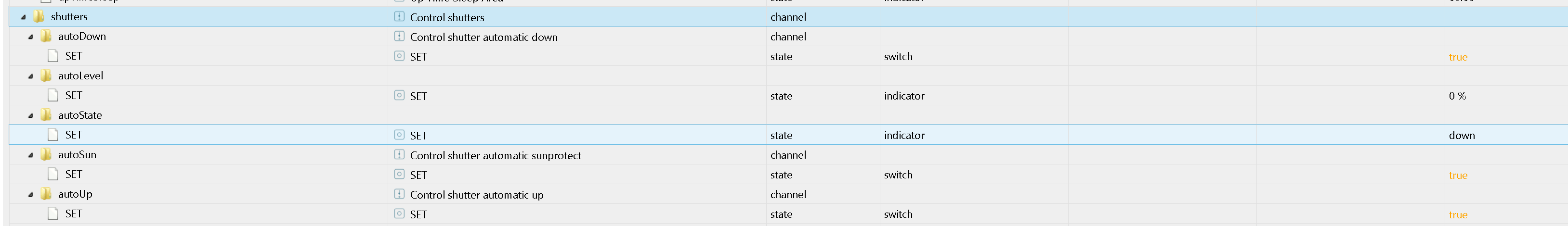

und hier mal die Einstellungen
"enabled": true,
"shutterName": "Balkon",
"name": "alias.0.Rolllaeden.Balkon",
"triggerID": "",
"typeUp": "sleep",
"typeDown": "goldenhour",
"type": "in- & outside temperature and direction",
"heightDownSun": "30",
"direction": "245",
"directionRange": "50",
"tempInside": "24",
"tempSensor": "",
"outsideTempSensor": "alias.0.Temperaturen.Hochbeet",
"tempOutside": "25",
"lightSensor": "",
"valueLight": "15",
"heightUp": "100",
"heightDown": "0",
"triggerState": "0",
"triggerDrive": "100",
"triggerChange": "onlyUp",
"elevation": "8",
"autoDrive": "off",
"hysteresisOutside": "10",
"hysteresisInside": "5",
"hysteresisLight": "5",
"currentAction": "",
"currentHeight": "",
"oldHeight": "",
"firstCompleteUp": "",
"triggerHeight": "",
"LateDown": false,
"inSummerNotDown": false,
"KeepSunProtect": true,
"triggerAction": "",
"driveAfterClose": false,
"useXmasLevel": false,
"XmasLevel": "",
"betweenPosition": false,
"betweenPositionLevel": "",
"trigDelyUp": "",
"trigDelyDown": ""
"enabled": true,
"shutterName": "Jan",
"name": "alias.0.Rolllaeden.Jan",
"triggerID": "alias.0.Fenster.Jan_Zimmer",
"typeUp": "sleep",
"typeDown": "sleep",
"type": "only outside temperature",
"heightDownSun": "3",
"direction": "130",
"directionRange": "55",
"tempInside": "23",
"tempSensor": "",
"outsideTempSensor": "yr.0.forecast.day0.temperatureMax",
"tempOutside": "23",
"lightSensor": "javascript.0.Sonne.sonne",
"valueLight": "5",
"heightUp": "100",
"heightDown": "0",
"triggerDrive": "10",
"elevation": "8",
"autoDrive": "upDown",
"hysteresisOutside": "5",
"hysteresisLight": "0",
"oldHeight": "",
"LateDown": false,
"KeepSunProtect": false,
"XmasLevel": "",
"trigDelyUp": "",
"trigDelyDown": ""
Balkon hat keine triggerID!
