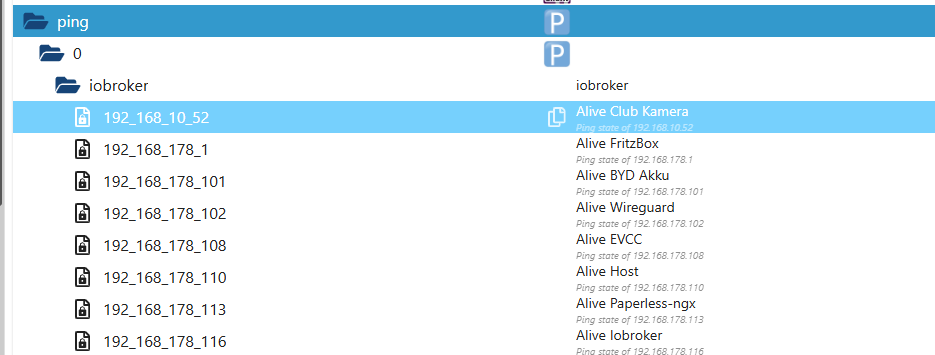

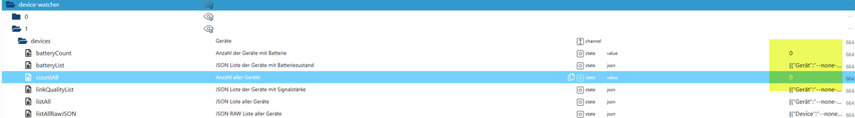

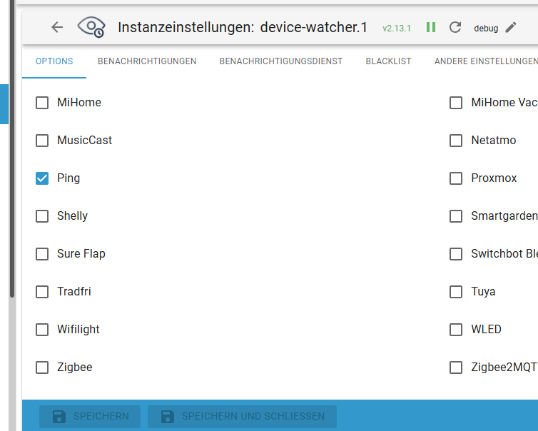

                                      Kann mir jemand helfen, warum der Device Watcher im Ping Adapter keine Geräte findet?
                                      Vers 2.13.1
                                      device-watcher.1
                                      2025-10-28 10:20:30.227	debug	Number of selected days for daily offline devices message: 1. Send Message on: 2 ...
                                      device-watcher.1
                                      2025-10-28 10:20:30.179	debug	Start the function writeDatapoints
                                      device-watcher.1
                                      2025-10-28 10:20:30.179	debug	Function finished: main
                                      device-watcher.1
                                      2025-10-28 10:20:30.178	debug	Created and filled data for all adapters
                                      device-watcher.1
                                      2025-10-28 10:20:30.127	debug	Start the function writeDatapoints
                                      device-watcher.1
                                      2025-10-28 10:20:30.105	debug	Search can't be optimized because wildcard not at the end, fallback to keys!: function(doc) { if (doc.type === 'state') emit(doc._id, doc) }
                                      device-watcher.1
                                      2025-10-28 10:20:30.101	debug	Function started main
                                      device-watcher.1
                                      2025-10-28 10:20:29.843	debug	Start the function createBlacklist
                                        Vers 2.13.1

                                        @tippy88
                                        im Ping-Adapter "Erweiterte Informationen" angeklickt?
