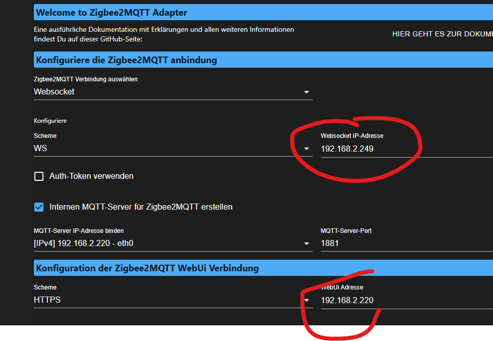

                              Moien Jungs,
                              ich versuch zigbee2mqtt mit meinem Zigbee Coordinator zu verbinden, leider ohne Erfolg !
                              ich weiß nicht was ich hier falsch mache, 192.168.2.249:6638 ist meine Adresse zum Coordinator.
                              Thomas Braun arteck skvarel 3 Replies Last reply Reply Quote 0

                                @maniackill sagte in Smart-Home mit ioBroker – Zigbee, Z-Wave, DECT, Matter?:
                                Das steht vielleicht im Log drin.

                                  ManiacKill @Thomas Braun last edited by
                                  @thomas-braun
                                  zigbee2mqtt.0
                                  2025-07-31 20:25:41.125	debug	Search can't be optimized because wildcard not at the end, fallback to keys!: function(doc) { if (doc.type === 'state') emit(doc._id, doc) }
                                  zigbee2mqtt.0
                                  2025-07-31 20:25:41.124	warn	Start try again in 1 seconds...
                                  zigbee2mqtt.0
                                  2025-07-31 20:25:41.124	debug	Error: Parse Error: Expected HTTP/
                                  zigbee2mqtt.0
                                  2025-07-31 20:25:23.126	debug	Search can't be optimized because wildcard not at the end, fallback to keys!: function(doc) { if (doc.type === 'state') emit(doc._id, doc) }
                                  zigbee2mqtt.0
                                  2025-07-31 20:25:23.124	warn	Start try again in 1 seconds...
                                  zigbee2mqtt.0
                                  2025-07-31 20:25:23.124	debug	Error: Parse Error: Expected HTTP/
                                  zigbee2mqtt.0
                                  2025-07-31 20:25:08.833	info	Statring DummyMQTT-Server on IP 192.168.2.220 and Port 1881
                                  zigbee2mqtt.0
                                  2025-07-31 20:25:08.782	info	==================================================================================
                                  zigbee2mqtt.0
                                  2025-07-31 20:25:08.782	info	|| Coordinator Check Cron : 0 3 * * *
                                  zigbee2mqtt.0
                                  2025-07-31 20:25:08.782	info	|| Coordinator Check Loglevel: info
                                  zigbee2mqtt.0
                                  2025-07-31 20:25:08.782	info	|| Use Automatic Coordinator Check: no
                                  zigbee2mqtt.0
                                  2025-07-31 20:25:08.782	info	|| Use Simple Press/Release State: no
                                  zigbee2mqtt.0
                                  2025-07-31 20:25:08.782	info	|| Use Simple Move/Stop State: no
                                  zigbee2mqtt.0
                                  2025-07-31 20:25:08.782	info	|| Use Simple Hold/Release State: yes
                                  zigbee2mqtt.0
                                  2025-07-31 20:25:08.782	info	|| Use Device Icons: no
                                  zigbee2mqtt.0
                                  2025-07-31 20:25:08.782	info	|| Use Event In Desc: yes
                                  zigbee2mqtt.0
                                  2025-07-31 20:25:08.782	info	|| Use BrightnessStep OnOff: no
                                  zigbee2mqtt.0
                                  2025-07-31 20:25:08.782	info	|| Use BrightnessMove OnOff: no
                                  zigbee2mqtt.0
                                  2025-07-31 20:25:08.782	info	|| Use ColorTemperature ColorSync: no
                                  zigbee2mqtt.0
                                  2025-07-31 20:25:08.782	info	|| Use Kelvin: no
                                  zigbee2mqtt.0
                                  2025-07-31 20:25:08.782	info	|| Proxy Zigbee2MQTT Logs to ioBroker Logs: activated
                                  zigbee2mqtt.0
                                  2025-07-31 20:25:08.782	info	|| Zigbee2MQTT Debug Log: deactivated
                                  zigbee2mqtt.0
                                  2025-07-31 20:25:08.782	info	|| Zigbee2MQTT Dummy MQTT Port: 1881
                                  zigbee2mqtt.0
                                  2025-07-31 20:25:08.782	info	|| Zigbee2MQTT Dummy MQTT IP-Bind: 192.168.2.220
                                  zigbee2mqtt.0
                                  2025-07-31 20:25:08.782	info	|| Zigbee2MQTT Websocket Dummy MQTT-Server: activated
                                  zigbee2mqtt.0
                                  2025-07-31 20:25:08.782	info	|| Zigbee2MQTT Websocket Auth-Token: unused
                                  zigbee2mqtt.0
                                  2025-07-31 20:25:08.782	info	|| Zigbee2MQTT Websocket Port: 6638
                                  zigbee2mqtt.0
                                  2025-07-31 20:25:08.782	info	|| Zigbee2MQTT Websocket Server: 192.168.2.249
                                  zigbee2mqtt.0
                                  2025-07-31 20:25:08.782	info	|| Zigbee2MQTT Websocket Scheme: ws
                                  Das kommt aber das sagt mir leider nix !

                                    arteck Developer Most Active @ManiacKill last edited by
                                    @maniackill das kann nicht sein
                                    die websocket IP kann nicht anders als die von der GUI sein

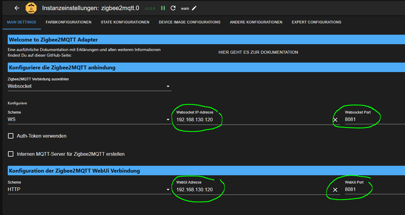

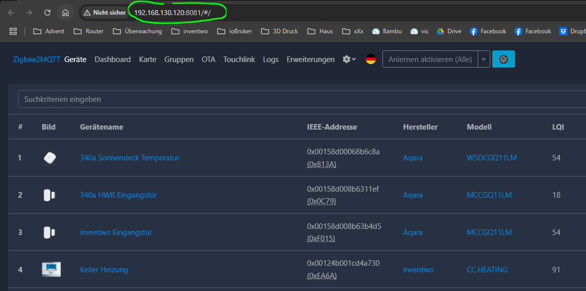

                                    • skvarel
                                      skvarel Developer @ManiacKill last edited by skvarel
                                      @maniackill .. du musst den Adapter nicht mit deinem Coordinator sondern mit deiner Zigbee2mqtt Installation verbinden.
                                      Die IP 192.168.130.120:8081 ist die Adresse von meinem Zigbee2mqtt Server
