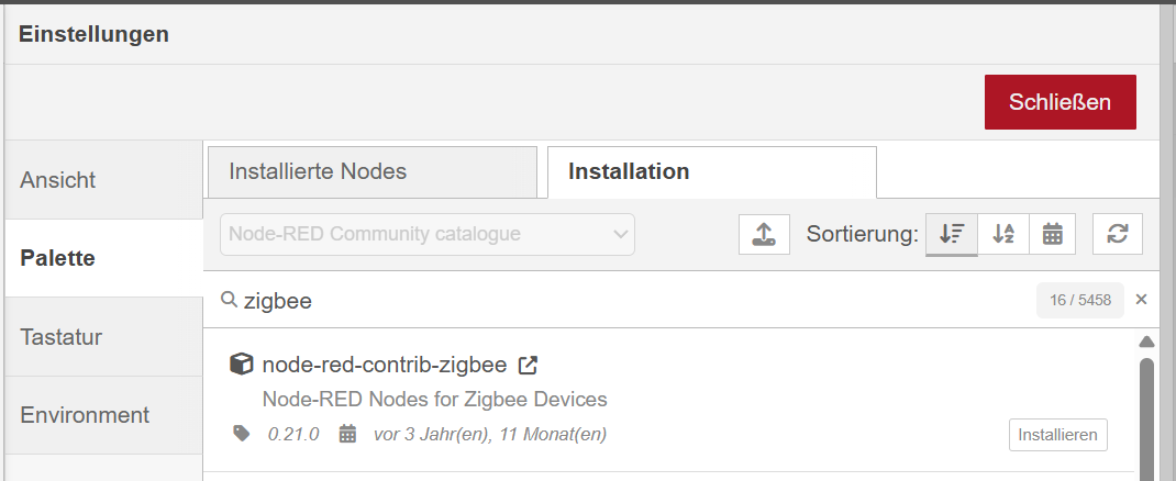

      Und was könnte denn da falsch gelaufen sein?
      node-red.0
      2025-06-25 20:50:44.811	error	Node-RED: Error: Install failed at /opt/iobroker/node_modules/@node-red/registry/lib/installer.js:288:25 at process.processTicksAndRejections (node:internal/process/task_queues:95:5) 25 Jun 20:50:44 - [error] Error: Install failed at /opt/iobroker/node_modules/@node-red/registry/lib/installer.js:288:25 at process.processTicksAndRejections (node:internal/process/task_queues:95:5)
      node-red.0
      2025-06-25 20:50:44.809	warn	Node-RED: 25 Jun 20:50:44 - [warn] npm warn config production Use `--omit=dev` instead. npm warn deprecated vis@4.21.0: Please consider using https://github.com/visjs npm error code 1 npm error path /opt/iobroker/iobroker-data/node-red/node_modules/zigbee-herdsman/node_modules/@serialport/bindings npm error command failed npm error command sh -c node-gyp rebuild npm error make: Entering directory '/opt/iobroker/iobroker-data/node-red/node_modules/zigbee-herdsman/node_modules/@serialport/bindings/build' npm error CXX(target) Release/obj.target/bindings/src/serialport.o npm error make: Leaving directory '/opt/iobroker/iobroker-data/node-red/node_modules/zigbee-herdsman/node_modules/@serialport/bindings/build' npm error gyp info it worked if it ends with ok npm error gyp info using node-gyp@8.4.1 npm error gyp info using node@20.19.3 | linux | arm64 npm error gyp info find Python using Python version 3.9.2 found at "/usr/bin/python3" npm error gyp info spawn /usr/bin/python3 npm error gyp info spawn args [ npm error gyp info spawn args '/opt/iobroker/node_modules/node-gyp/gyp/gyp_main.py', npm error gyp info spawn args 'binding.gyp', npm error gyp info spawn args '-f', npm error gyp info spawn args 'make', npm error gyp info spawn args '-I', npm error gyp info spawn args '/opt/iobroker/iobroker-data/node-red/node_modules/zigbee-herdsman/node_modules/@serialport/bindings/build/config.gypi', npm error gyp info spawn args '-I', npm error gyp info spawn args '/opt/iobroker/node_modules/node-gyp/addon.gypi', npm error gyp info spawn args '-I', npm error gyp info spawn args '/home/iobroker/.cache/node-gyp/20.19.3/include/node/common.gypi', npm error gyp info spawn args '-Dlibrary=shared_library', npm error gyp info spawn args '-Dvisibility=default', npm error gyp info spawn args '-Dnode_root_dir=/home/iobroker/.cache/node-gyp/20.19.3', npm error gyp info spawn args '-Dnode_gyp_dir=/opt/iobroker/node_modules/node-gyp', npm error gyp info spawn args '-Dnode_lib_file=/home/iobroker/.cache/node-gyp/20.19.3/<(target_arch)/node.lib', npm error gyp info spawn args '-Dmodule_root_dir=/opt/iobroker/iobroker-data/node-red/node_modules/zigbee-herdsman/node_modules/@serialport/bindings', npm error gyp info spawn args '-Dnode_engine=v8', npm error gyp info spawn args '--depth=.', npm error gyp info spawn args '--no-parallel', npm error gyp info spawn args '--generator-output', npm error gyp info spawn args 'build', npm error gyp info spawn args '-Goutput_dir=.' npm error gyp info spawn args ] npm error gyp info spawn make npm error gyp info spawn args [ 'BUILDTYPE=Release', '-C', 'build' ] npm error In file included from ../../../nan/nan.h:178, npm error from ../src/./serialport.h:13, npm error from ../src/serialport.cpp:1: npm error ../../../nan/nan_callbacks.h:55:23: error: ‘AccessorSignature’ is not a member of ‘v8’ npm error 55 | typedef v8::Local<v8::AccessorSignature> Sig; npm error | ^~~~~~~~~~~~~~~~~ npm error ../../../nan/nan_callbacks.h:55:40: error: template argument 1 is invalid npm error 55 | typedef v8::Local<v8::AccessorSignature> Sig; npm error | ^ npm error In file included from ../src/./serialport.h:13, npm error from ../src/serialport.cpp:1: npm error ../../../nan/nan.h: In function ‘void Nan::SetAccessor(v8::Local<v8::ObjectTemplate>, v8::Local<v8::String>, Nan::GetterCallback, Nan::SetterCallback, v8::Local<v8::Value>, v8::AccessControl, v8::PropertyAttribute, Nan::imp::Sig)’: npm error ../../../nan/nan.h:2551:16: error: no matching function for call to ‘v8::ObjectTemplate::SetAccessor(v8::Local<v8::String>&, void (*&)(v8::Local<v8::Name>, const v8::PropertyCallbackInfo<v8::Value>&), void (*&)(v8::Local<v8::Name>, v8::Local<v8::Value>, const v8::PropertyCallbackInfo<void>&), v8::Local<v8::Object>&, v8::AccessControl&, v8::PropertyAttribute&, Nan::imp::Sig&)’ npm error 2551 | , signature); npm error | ^ npm error In file included from /home/iobroker/.cache/node-gyp/20.19.3/include/node/v8-function.h:15, npm error from /home/iobroker/.cache/node-gyp/20.19.3/include/node/v8.h:33, npm error from /home/iobroker/.cache/node-gyp/20.19.3/include/node/node.h:73, npm error from ../../../nan/nan.h:58, npm error from ../src/./serialport.h:13, npm error from ../src/serialport.cpp:1: npm error /home/iobroker/.cache/node-gyp/20.19.3/include/node/v8-template.h:809:8: note: candidate: ‘void v8::ObjectTemplate::SetAccessor(v8::Local<v8::String>, v8::AccessorGetterCallback, v8::AccessorSetterCallback, v8::Local<v8::Value>, v8::AccessControl, v8::PropertyAttribute, v8::SideEffectType, v8::SideEffectType)’ npm error 809 | void SetAccessor( npm error | ^~~~~~~~~~~ npm error /home/iobroker/.cache/node-gyp/20.19.3/include/node/v8-template.h:814:22: note: no known conversion for argument 7 from ‘Nan::imp::Sig’ {aka ‘int’} to ‘v8::SideEffectType’ npm error 814 | SideEffectType getter_side_effect_type = SideEffectType::kHasSideEffect, npm error | ~~~~~~~~~~~~~~~^~~~~~~~~~~~~~~~~~~~~~~~~~~~~~~~~~~~~~~~~~~~~~~~~~~~~~~~ npm error /home/iobroker/.cache/node-gyp/20.19.3/include/node/v8-template.h:816:8: note: candidate: ‘void v8::ObjectTemplate::SetAccessor(v8::Local<v8::Name>, v8::AccessorNameGetterCallback, v8::AccessorNameSetterCallback, v8::Local<v8::Value>, v8::AccessControl, v8::PropertyAttribute, v8::SideEffectType, v8::SideEffectType)’ npm error 816 | void SetAccessor( npm error | ^~~~~~~~~~~ npm error /home/iobroker/.cache/node-gyp/20.19.3/include/node/v8-template.h:821:22: note: no known conversion for argument 7 from ‘Nan::imp::Sig’ {aka ‘int’} to ‘v8::SideEffectType’ npm error 821 | SideEffectType getter_side_effect_type = SideEffectType::kHasSideEffect, npm error | ~~~~~~~~~~~~~~~^~~~~~~~~~~~~~~~~~~~~~~~~~~~~~~~~~~~~~~~~~~~~~~~~~~~~~~~ npm error ../src/serialport.cpp: In function ‘Nan::NAN_METHOD_RETURN_TYPE Open(Nan::NAN_METHOD_ARGS_TYPE)’: npm error ../src/serialport.cpp:78:51: warning: cast between incompatible function types from ‘void (*)(uv_work_t*)’ {aka ‘void (*)(uv_work_s*)’} to ‘uv_after_work_cb’ {aka ‘void (*)(uv_work_s*, int)’} [-Wcast-function-type] npm error 78 | uv_queue_work(uv_default_loop(), req, EIO_Open, (uv_after_work_cb)EIO_AfterOpen); npm error | ^~~~~~~~~~~~~~~~~~~~~~~~~~~~~~~ npm error ../src/serialport.cpp: In function ‘Nan::NAN_METHOD_RETURN_TYPE Update(Nan::NAN_METHOD_ARGS_TYPE)’: npm error ../src/serialport.cpp:135:53: warning: cast between incompatible function types from ‘void (*)(uv_work_t*)’ {aka ‘void (*)(uv_work_s*)’} to ‘uv_after_work_cb’ {aka ‘void (*)(uv_work_s*, int)’} [-Wcast-function-type] npm error 135 | uv_queue_work(uv_default_loop(), req, EIO_Update, (uv_after_work_cb)EIO_AfterUpdate); npm error | ^~~~~~~~~~~~~~~~~~~~~~~~~~~~~~~~~ npm error ../src/serialport.cpp: In function ‘Nan::NAN_METHOD_RETURN_TYPE Close(Nan::NAN_METHOD_ARGS_TYPE)’: npm error ../src/serialport.cpp:175:52: warning: cast between incompatible function types from ‘void (*)(uv_work_t*)’ {aka ‘void (*)(uv_work_s*)’} to ‘uv_after_work_cb’ {aka ‘void (*)(uv_work_s*, int)’} [-Wcast-function-type] npm error 175 | uv_queue_work(uv_default_loop(), req, EIO_Close, (uv_after_work_cb)EIO_AfterClose); npm error | ^~~~~~~~~~~~~~~~~~~~~~~~~~~~~~~~ npm error ../src/serialport.cpp: In function ‘Nan::NAN_METHOD_RETURN_TYPE Flush(Nan::NAN_METHOD_ARGS_TYPE)’: npm error ../src/serialport.cpp:215:52: warning: cast between incompatible function types from ‘void (*)(uv_work_t*)’ {aka ‘void (*)(uv_work_s*)’} to ‘uv_after_work_cb’ {aka ‘void (*)(uv_work_s*, int)’} [-Wcast-function-type] npm error 215 | uv_queue_work(uv_default_loop(), req, EIO_Flush, (uv_after_work_cb)EIO_AfterFlush); npm error | ^~~~~~~~~~~~~~~~~~~~~~~~~~~~~~~~ npm error ../src/serialport.cpp: In function ‘Nan::NAN_METHOD_RETURN_TYPE Set(Nan::NAN_METHOD_ARGS_TYPE)’: npm error ../src/serialport.cpp:271:50: warning: cast between incompatible function types from ‘void (*)(uv_work_t*)’ {aka ‘void (*)(uv_work_s*)’} to ‘uv_after_work_cb’ {aka ‘void (*)(uv_work_s*, int)’} [-Wcast-function-type] npm error 271 | uv_queue_work(uv_default_loop(), req, EIO_Set, (uv_after_work_cb)EIO_AfterSet); npm error | ^~~~~~~~~~~~~~~~~~~~~~~~~~~~~~ npm error ../src/serialport.cpp: In function ‘Nan::NAN_METHOD_RETURN_TYPE Get(Nan::NAN_METHOD_ARGS_TYPE)’: npm error ../src/serialport.cpp:316:50: warning: cast between incompatible function types from ‘void (*)(uv_work_t*)’ {aka ‘void (*)(uv_work_s*)’} to ‘uv_after_work_cb’ {aka ‘void (*)(uv_work_s*, int)’} [-Wcast-function-type] npm error 316 | uv_queue_work(uv_default_loop(), req, EIO_Get, (uv_after_work_cb)EIO_AfterGet); npm error | ^~~~~~~~~~~~~~~~~~~~~~~~~~~~~~ npm error ../src/serialport.cpp: In function ‘Nan::NAN_METHOD_RETURN_TYPE GetBaudRate(Nan::NAN_METHOD_ARGS_TYPE)’: npm error ../src/serialport.cpp:366:58: warning: cast between incompatible function types from ‘void (*)(uv_work_t*)’ {aka ‘void (*)(uv_work_s*)’} to ‘uv_after_work_cb’ {aka ‘void (*)(uv_work_s*, int)’} [-Wcast-function-type] npm error 366 | uv_queue_work(uv_default_loop(), req, EIO_GetBaudRate, (uv_after_work_cb)EIO_AfterGetBaudRate); npm error | ^~~~~~~~~~~~~~~~~~~~~~~~~~~~~~~~~~~~~~ npm error ../src/serialport.cpp: In function ‘Nan::NAN_METHOD_RETURN_TYPE Drain(Nan::NAN_METHOD_ARGS_TYPE)’: npm error ../src/serialport.cpp:412:52: warning: cast between incompatible function types from ‘void (*)(uv_work_t*)’ {aka ‘void (*)(uv_work_s*)’} to ‘uv_after_work_cb’ {aka ‘void (*)(uv_work_s*, int)’} [-Wcast-function-type] npm error 412 | uv_queue_work(uv_default_loop(), req, EIO_Drain, (uv_after_work_cb)EIO_AfterDrain); npm error | ^~~~~~~~~~~~~~~~~~~~~~~~~~~~~~~~ npm error ../src/serialport.cpp: At global scope: npm error ../src/serialport.cpp:433:28: warning: unnecessary parentheses in declaration of ‘ToParityEnum’ [-Wparentheses] npm error 433 | SerialPortParity NAN_INLINE(ToParityEnum(const v8::Local<v8::String>& v8str)) { npm error | ^ npm error ../src/serialport.cpp:452:30: warning: unnecessary parentheses in declaration of ‘ToStopBitEnum’ [-Wparentheses] npm error 452 | SerialPortStopBits NAN_INLINE(ToStopBitEnum(double stopBits)) { npm error | ^ npm error In file included from ../../../nan/nan.h:58, npm error from ../src/./serialport.h:13, npm error from ../src/serialport.cpp:1: npm error /home/iobroker/.cache/node-gyp/20.19.3/include/node/node.h:1227:7: warning: cast between incompatible function types from ‘void (*)(Nan::ADDON_REGISTER_FUNCTION_ARGS_TYPE)’ {aka ‘void (*)(v8::Local<v8::Object>)’} to ‘node::addon_register_func’ {aka ‘void (*)(v8::Local<v8::Object>, v8::Local<v8::Value>, void*)’} [-Wcast-function-type] npm error 1227 | (node::addon_register_func) (regfunc), \ npm error | ^~~~~~~~~~~~~~~~~~~~~~~~~~~~~~~~~~~~~ npm error /home/iobroker/.cache/node-gyp/20.19.3/include/node/node.h:1261:3: note: in expansion of macro ‘NODE_MODULE_X’ npm error 1261 | NODE_MODULE_X(modname, regfunc, NULL, 0) // NOLINT (readability/null_usage) npm error | ^~~~~~~~~~~~~ npm error ../src/serialport.cpp:486:1: note: in expansion of macro ‘NODE_MODULE’ npm error 486 | NODE_MODULE(serialport, init); npm error | ^~~~~~~~~~~ npm error make: *** [bindings.target.mk:109: Release/obj.target/bindings/src/serialport.o] Error 1 npm error gyp ERR! build error npm error gyp ERR! stack Error: `make` failed with exit code: 2 npm error gyp ERR! stack at ChildProcess.onExit (/opt/iobroker/node_modules/node-gyp/lib/build.js:194:23) npm error gyp ERR! stack at ChildProcess.emit (node:events:524:28) npm error gyp ERR! stack at ChildProcess._handle.onexit (node:internal/child_process:293:12) npm error gyp ERR! System Linux 6.1.21-v8+ npm error gyp ERR! command "/usr/bin/node" "/opt/iobroker/node_modules/.bin/node-gyp" "rebuild" npm error gyp ERR! cwd /opt/iobroker/iobroker-data/node-red/node_modules/zigbee-herdsman/node_modules/@serialport/bindings npm error gyp ERR! node -v v20.19.3 npm error gyp ERR! node-gyp -v v8.4.1 npm error gyp ERR! not ok npm error A complete log of this run can be found in: /home/iobroker/.npm/_logs/2025-06-25T18_50_27_905Z-debug-0.log 25 Jun 20:50:44 - [warn] ------------------------------------------
      node-red.0
      2025-06-25 20:50:44.808	warn	Node-RED: 25 Jun 20:50:44 - [warn] ------------------------------------------
      node-red.0
      2025-06-25 20:50:44.807	warn	Node-RED: 25 Jun 20:50:44 - [warn] Installation of module node-red-contrib-zigbee failed:

          • Autodidakt
            Autodidakt @Thomas Braun last edited by Autodidakt
            @thomas-braun
            2025-06-25 21:25:46.719  - warn: node-red.0 (25486) Node-RED: 25 Jun 21:25:46 - [warn] Installation of module node-red-contrib-zigbee failed:
            2025-06-25 21:25:46.720  - warn: node-red.0 (25486) Node-RED: 25 Jun 21:25:46 - [warn] ------------------------------------------
            25 Jun 21:25:46 - [warn] npm warn config production Use `--omit=dev` instead.

                                  Kann niemand mit dieser Fehlermeldung etwas anfangen?
                                  2025-06-26T08:09:05.411Z Installieren : node-red-contrib-zigbee 0.21.0
                                  2025-06-26T08:09:05.300Z npm install --no-audit --no-update-notifier --no-fund --save --save-prefix=~ --production --engine-strict node-red-contrib-zigbee@0.21.0

                                    @autodidakt sagte in Zigbee Adapter schmeißt warnungen:
                                    doch!
                                    aber du bist falsch hier!
                                    hat nichts mit dem zigbee-Adapter zu tun!

                                          Ich möchte nur installieren.
                                          Ich möchte auf meinem Node red Dashboard einen ein/aus Button für ein zigbee Gerät.
                                          Ich weiß nicht, was ich Dir verheimlicht hätte...
                                          STOP! Node red schreibt, dass dieser Knoten aufgegeben wurde. IoB hat also nichts damit zu tun.
                                          Dank euch.
                                          Mfg
                                          Tom
