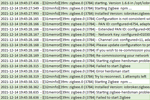

                                    • andy6325
                                      andy6325 @Thomas Braun last edited by
                                      @thomas-braun Habe mich gerade mal remote eingeloggt und das Log herausgesucht. Ich hätte es gestern mal noch lesen sollen 🤦 Siehe Zeile 11. Ich versuche das heute abend die Datei /opt/iobroker/iobroker-data/zigbee_0/nvbackup.json mal zu löschen und werde berichten.
                                      ![b4bea40b-2f7a-42fa-893d-139fd7a83fd2-grafik.png](/assets/uploads/files/1639557281215-b4bea40b-2f7a-42fa-893d-139fd7a83fd2-grafik.png) code_text
                                      ```2021-12-14 19:45:27.436  - info: zigbee.0 (3784) starting. Version 1.6.6 in /opt/iobroker/node_modules/iobroker.zigbee, node: v12.22.7, js-controller: 3.3.21
                                      2021-12-14 19:45:27.549  - info: zigbee.0 (3784) Starting Zigbee  npm ...
                                      2021-12-14 19:45:27.993  - info: zigbee.0 (3784) Installed Version: iobroker.zigbee@1.6.6
                                      2021-12-14 19:45:28.165  - error: zigbee.0 (3784) Configuration is not consistent with adapter state/backup!
                                      2021-12-14 19:45:28.166  - error: zigbee.0 (3784) - PAN ID: configured=6754, adapter=4195
                                      2021-12-14 19:45:28.166  - error: zigbee.0 (3784) - Extended PAN ID: configured=00124b00256c52ca, adapter=00124b00256c52ca
                                      2021-12-14 19:45:28.167  - error: zigbee.0 (3784) - Network Key: configured=01030507090b0d0f00020406080a0c0d, adapter=01030507090b0d0f00020406080a0c0d
                                      2021-12-14 19:45:28.168  - error: zigbee.0 (3784) - Channel List: configured=11, adapter=12
                                      2021-12-14 19:45:28.168  - error: zigbee.0 (3784) Please update configuration to prevent further issues.
                                      2021-12-14 19:45:28.168  - error: zigbee.0 (3784) If you wish to re-commission your network, please remove coordinator backup at /opt/iobroker/iobroker-data/zigbee_0/nvbackup.json.
                                      2021-12-14 19:45:28.169  - error: zigbee.0 (3784) Re-commissioning your network will require re-pairing of all devices!
                                      2021-12-14 19:45:28.315  - error: zigbee.0 (3784) Starting zigbee-herdsman problem : "startup failed - configuration-adapter mismatch - see logs above for more information"
                                      2021-12-14 19:45:28.315  - error: zigbee.0 (3784) Failed to start Zigbee
                                      2021-12-14 19:45:28.316  - error: zigbee.0 (3784) Error herdsman start
                                      2021-12-14 19:45:38.319  - info: zigbee.0 (3784) Try to reconnect. 1 attempts left
                                      2021-12-14 19:45:38.321  - info: zigbee.0 (3784) Starting Zigbee  npm ...
                                      2021-12-14 19:45:38.362  - info: zigbee.0 (3784) Installed Version: iobroker.zigbee@1.6.6
                                      2021-12-14 19:45:38.635  - error: zigbee.0 (3784) Starting zigbee-herdsman problem : "Error while opening serialport 'Error: Error Resource temporarily unavailable Cannot lock port'"
                                      2021-12-14 19:45:38.636  - error: zigbee.0 (3784) Failed to start Zigbee
                                      Thomas Braun J 2 Replies Last reply Reply Quote 0
                                      • Thomas Braun
                                        Thomas Braun Most Active @andy6325 last edited by Thomas Braun
                                        @andy6325 sagte in Alternative zu CC2652P Zigbee Stick:
                                        Da sind halt Diskrepanzen.
                                        node: v12.22.7 würde ich auch auf die derzeitig empfohlene Version 14 heben.
                                        andy6325 1 Reply Last reply Reply Quote 1
                                        • J
                                          Jan1 @andy6325 last edited by
                                          @andy6325
                                          Wenn Du das tust, muss alles neu angelernt werden und das ist eben nicht nötig, weil das nicht Dein Problem ist 😉
                                          Schau was Thomas rausgesucht hat, exakt was ich auch geschrieben habe. Augen auf beim Log lesen.
                                          • andy6325
                                            @thomas-braun @Jan1
                                            Danke ihr beiden. Mit den Tipps läuft jetzt alles mit dem neuen Stick. Bin gespannt, ob jetzt alles stabiler läuft für die Zukunft.
                                            node v14 habe ich jetzt noch nicht, aber das kommt dann im nächsten Urlaub an Weihnachten 😄
