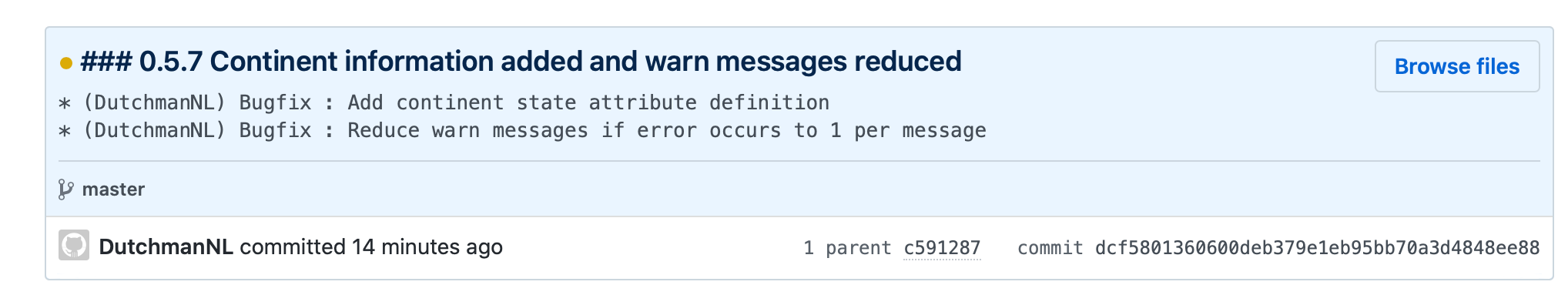

                                            und da wurde 0.5.7 geboren 😁
                                            https://github.com/iobroker-community-adapters/ioBroker.coronavirus-statistics/commit/dcf5801360600deb379e1eb95bb70a3d4848ee88
                                            0 DutchmanNL committed to iobroker-community-adapters/ioBroker.coronavirus-statistics
                                            ### 0.5.7 Continent information added and warn messages reduced
                                            * (DutchmanNL) Bugfix : Add continent state attribute definition
                                            * (DutchmanNL) Bugfix : Reduce warn messages if error occurs to 1 per message
                                            sigi234 M 2 Replies Last reply Reply Quote 3
