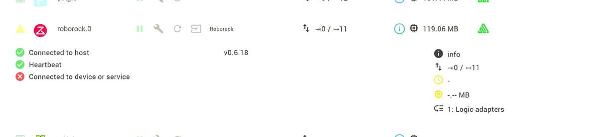

                            Hi zusammen,
                            Ich bekomme den roborock.0 adapter nicht zum laufen, connected to host und heartbeat sind beide grün, aber Connected to device or service bleibt rot, irgendwas mache ich falsch. habe die login daten eingegeben, aber irgendwie verbindet sich der adapter nicht. bitte um hilfe :-)
                            • K karsten089
                              Hi zusammen,
                              #1044
                              @karsten089 sagte:
                              bitte um hilfe :-)
                              Schau in das Log.
                              iob logs
                              K 1 Antwort Letzte Antwort

                                @Thomas-Braun sagte:
                                iob logs
                                2026-05-30 19:22:53.271  - info: host.pi5 "system.adapter.roborock.0" disabled
                                2026-05-30 19:22:53.271  - info: host.pi5 stopInstance system.adapter.roborock.0                                                  (force=false, process=true)
                                2026-05-30 19:22:53.273  - info: roborock.0 (3660) Got terminate signal TERMINAT                                                 E_YOURSELF
                                2026-05-30 19:22:53.275  - info: roborock.0 (3660) terminating
                                2026-05-30 19:22:53.276  - info: roborock.0 (3660) Terminated (ADAPTER_REQUESTED                                                 _TERMINATION): Without reason
                                2026-05-30 19:22:53.316  - info: host.pi5 stopInstance system.adapter.roborock.0                                                  send kill signal
                                2026-05-30 19:22:53.777  - info: roborock.0 (3660) terminating
                                2026-05-30 19:22:53.806  - info: host.pi5 instance system.adapter.roborock.0 ter                                                 minated with code 11 (ADAPTER_REQUESTED_TERMINATION)
                                2026-05-30 19:22:56.166  - info: host.pi5 "system.adapter.roborock.0" enabled
                                2026-05-30 19:22:56.370  - info: host.pi5 instance system.adapter.roborock.0 in                                                  version "0.6.18" started with pid 12300
                                2026-05-30 19:22:57.233  - info: host.pi5 "system.adapter.roborock.0" disabled
                                2026-05-30 19:22:57.233  - info: host.pi5 stopInstance system.adapter.roborock.0                                                  (force=false, process=true)
                                2026-05-30 19:22:57.278  - info: host.pi5 stopInstance system.adapter.roborock.0                                                  send kill signal
                                2026-05-30 19:22:57.489  - error: roborock.0 (12300) adapter disabled
                                2026-05-30 19:22:57.534  - warn: roborock.0 (12300) Terminated (NO_ADAPTER_CONFI                                                 G_FOUND): Without reason
                                2026-05-30 19:22:58.054  - info: host.pi5 instance system.adapter.roborock.0 ter                                                 minated with code 3 (NO_ADAPTER_CONFIG_FOUND)
                                2026-05-30 19:23:02.119  - info: host.pi5 "system.adapter.roborock.0" enabled
                                2026-05-30 19:23:02.325  - info: host.pi5 instance system.adapter.roborock.0 in                                                  version "0.6.18" started with pid 12316
                                2026-05-30 19:23:03.674  - info: roborock.0 (12316) starting. Version 0.6.18 in                                                  /opt/iobroker/node_modules/iobroker.roborock, node: v22.22.2, js-controller: 6.0                                                 .11
                                2026-05-30 19:23:03.683  - info: roborock.0 (12316) Starting adapter. This might                                                  take a few minutes depending on your setup. Please wait.
                                2026-05-30 19:23:03.888  - error: roborock.0 (12316) Error in getUserData: Login                                                  returned empty userdata.. This is most likely due to too many reconnects.
                                2026-05-30 19:23:03.895  - error: roborock.0 (12316) Error retrieving or setting                                                  clientID: Error: Login returned empty userdata.
                                    at Roborock.getUserData (/opt/iobroker/node_modules/iobroker.roborock/main.j                                                 s:236:11)
                                    at processTicksAndRejections (node:internal/process/task_queues:103:5)
                                    at Roborock.initializeRoborockApi (/opt/iobroker/node_modules/iobroker.robor                                                 ock/main.js:103:21)
                                    at Roborock.onReady (/opt/iobroker/node_modules/iobroker.roborock/main.js:65                                                 :34)
                                2026-05-30 19:23:04.278  - error: roborock.0 (12316) Failed to get home details:                                                  Error: loginApi is not initialized.
                                    at Roborock.initializeHomeDetails (/opt/iobroker/node_modules/iobroker.robor                                                 ock/main.js:144:25)
                                    at Roborock.onReady (/opt/iobroker/node_modules/iobroker.roborock/main.js:67                                                 :14)

                                        wenn ich in der Konsole bin, zeigt er mir an ich habe 0 7 3 installiert:
                                        pi5:~ $ sudo systemctl restart iobroker
                                        pi5:~ $ iobroker restart roborock.0
                                        The adapter "roborock.0" was started.
                                        pi5:~ $ npm list iobroker.roborock
                                        pi5@ /home/pi5
                                        └── iobroker.roborock@0.7.3
                                        pi5:~ $
                                        aber in der weboberfläche bin ich immer noch im status: wie folgt: 041e888e-2d9b-43db-9006-66f35114fce4-image.jpeg
                                        auch ein neustart des adapters, der instanz oder der pis bringt keine änderung... :(
                                        • K Offline
                                          K Offline
                                          karsten089
                                          #1050
                                          jetzt habe ich zumindest version 0 7 3 zum laufen bekommen, ich vermute es liegt an der 2FA.
                                          ich kann ja in 0 7 3 auswählen dass ich mich per mail und 2fa anmelden muss, dann kommt auch eine Email, aber wo gebe ich den 2FA code dann im adapter ein im iobroker ?
