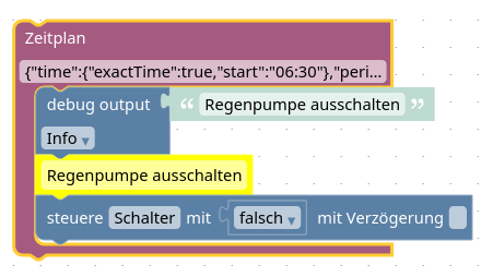

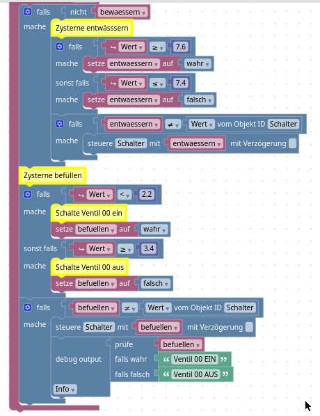

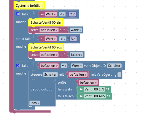

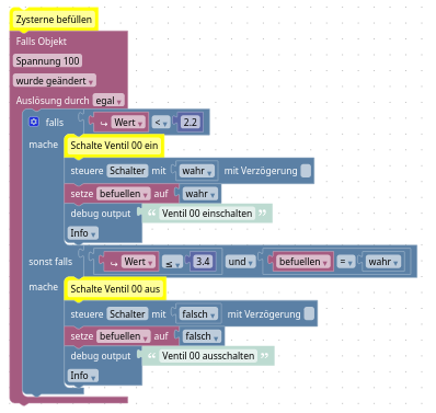

      Hey Folks,

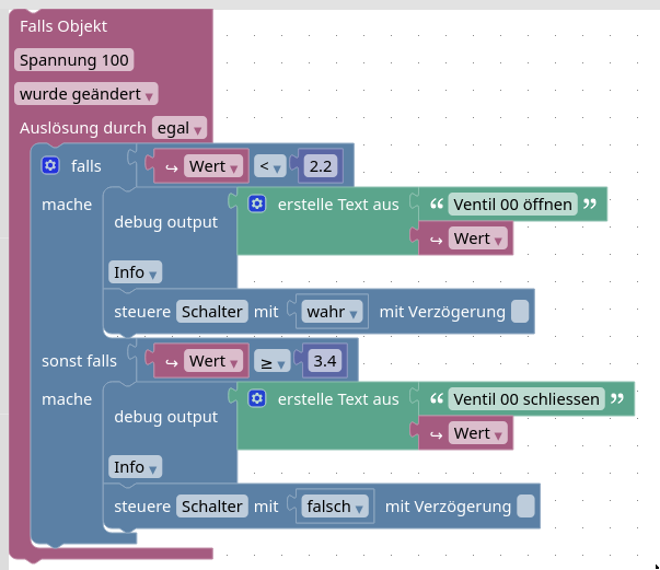

      ich habe mir folgendes Blockly geschrieben, es funktioniert auch, doch es schreib mir das Protokoll voll.
      2025-08-18 07:36:08.701 - info: javascript.0 (19015) script.js.Zysterne.Zysterne-befuellen: Ventil 00 schliessen3.41
      2025-08-18 07:36:25.705 - info: javascript.0 (19015) script.js.Zysterne.Zysterne-befuellen: Ventil 00 schliessen3.43
      2025-08-18 07:36:58.700 - info: javascript.0 (19015) script.js.Zysterne.Zysterne-befuellen: Ventil 00 schliessen3.44
      2025-08-18 07:37:05.699 - info: javascript.0 (19015) script.js.Zysterne.Zysterne-befuellen: Ventil 00 schliessen3.43
      2025-08-18 07:37:09.701 - info: javascript.0 (19015) script.js.Zysterne.Zysterne-befuellen: Ventil 00 schliessen3.42
      2025-08-18 07:38:06.699 - info: javascript.0 (19015) script.js.Zysterne.Zysterne-befuellen: Ventil 00 schliessen3.4
      2025-08-18 07:38:07.699 - info: javascript.0 (19015) script.js.Zysterne.Zysterne-befuellen: Ventil 00 schliessen3.41
      2025-08-18 07:38:09.700 - info: javascript.0 (19015) script.js.Zysterne.Zysterne-befuellen: Ventil 00 schliessen3.43
      2025-08-18 07:38:10.484 - info: admin.0 (18969) ==> Connected system.user.admin from ::ffff:192.168.3.11
      2025-08-18 07:38:21.699 - info: javascript.0 (19015) script.js.Zysterne.Zysterne-befuellen: Ventil 00 schliessen3.42
      2025-08-18 07:38:32.700 - info: javascript.0 (19015) script.js.Zysterne.Zysterne-befuellen: Ventil 00 schliessen3.43
      2025-08-18 07:38:48.969 - info: admin.0 (18969) ==> Connected system.user.admin from ::ffff:192.168.3.11
      2025-08-18 07:38:51.700 - info: javascript.0 (19015) script.js.Zysterne.Zysterne-befuellen: Ventil 00 schliessen3.42
      2025-08-18 07:39:05.697 - info: javascript.0 (19015) script.js.Zysterne.Zysterne-befuellen: Ventil 00 schliessen3.43
      2025-08-18 07:39:06.715 - info: javascript.0 (19015) script.js.Zysterne.Zysterne-befuellen: Ventil 00 schliessen3.42
      2025-08-18 07:39:07.698 - info: javascript.0 (19015) script.js.Zysterne.Zysterne-befuellen: Ventil 00 schliessen3.4
      2025-08-18 07:39:08.697 - info: javascript.0 (19015) script.js.Zysterne.Zysterne-befuellen: Ventil 00 schliessen3.43
      2025-08-18 07:39:13.698 - info: javascript.0 (19015) script.js.Zysterne.Zysterne-befuellen: Ventil 00 schliessen3.42
      2025-08-18 07:39:59.698 - info: javascript.0 (19015) script.js.Zysterne.Zysterne-befuellen: Ventil 00 schliessen3.43
      2025-08-18 07:40:07.720 - info: javascript.0 (19015) script.js.Zysterne.Zysterne-befuellen: Ventil 00 schliessen3.41
      2025-08-18 07:40:08.715 - info: javascript.0 (19015) script.js.Zysterne.Zysterne-befuellen: Ventil 00 schliessen3.43
      2025-08-18 07:40:29.696 - info: javascript.0 (19015) script.js.Zysterne.Zysterne-befuellen: Ventil 00 schliessen3.41
      2025-08-18 07:40:37.699 - info: javascript.0 (19015) script.js.Zysterne.Zysterne-befuellen: Ventil 00 schliessen3.43
      2025-08-18 07:40:38.743 - info: javascript.0 (19015) script.js.Zysterne.Zysterne-befuellen: Ventil 00 schliessen3.41
      2025-08-18 07:40:49.697 - info: javascript.0 (19015) script.js.Zysterne.Zysterne-befuellen: Ventil 00 schliessen3.43
      2025-08-18 07:41:03.698 - info: javascript.0 (19015) script.js.Zysterne.Zysterne-befuellen: Ventil 00 schliessen3.42
      2025-08-18 07:41:08.728 - info: javascript.0 (19015) script.js.Zysterne.Zysterne-befuellen: Ventil 00 schliessen3.4
      2025-08-18 07:41:09.697 - info: javascript.0 (19015) script.js.Zysterne.Zysterne-befuellen: Ventil 00 schliessen3.43
      2025-08-18 07:41:22.697 - info: javascript.0 (19015) script.js.Zysterne.Zysterne-befuellen: Ventil 00 schliessen3.42
      2025-08-18 07:41:26.695 - info: javascript.0 (19015) script.js.Zysterne.Zysterne-befuellen: Ventil 00 schliessen3.43
      2025-08-18 07:41:48.694 - info: javascript.0 (19015) script.js.Zysterne.Zysterne-befuellen: Ventil 00 schliessen3.42
      2025-08-18 07:41:56.262 - info: admin.0 (18969) <== Disconnect system.user.admin from ::ffff:192.168.3.11 javascript
      2025-08-18 07:41:57.693 - info: javascript.0 (19015) script.js.Zysterne.Zysterne-befuellen: Ventil 00 schliessen3.43
      So geht das die ganze Zeit.
      Homoran paul53 3 Replies Last reply Reply Quote 0
      • Homoran
        Homoran Global Moderator Administrators @wotan2005 last edited by Homoran
        @wotan2005 sagte in Wie Blockly besser organisieren, schreibt mir Protokoll voll:
        nicht nur das, es steuert auch unnötig andauernd deinen Schalter an.
        und zwar bei jeder Änderung der Spannung 100.
        und nicht nur einmalig bei unter-/überschreiten deines Grenzwertes
        einfach bei falls und sonst falls noch ...und Schalter != wahr/falsch hinzufügen

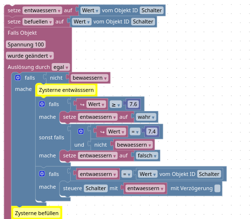

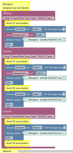

        • W
          Hallo @Homoran ,
          Danke das funktioniert erst einmal.
          Aber dabei habe ich ein generelles Problem bei diesem Vergleich.

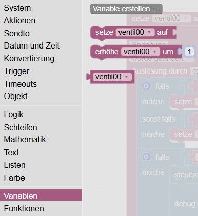

          Ich habe mehrere Blockly's die sehr ähnlich sind und auch die selben Schalter benötigen. Gibt es da noch eine andere Lösungen?
          In PHP würde ich mir einfach eine Variable declarieren und auf diese Prüfen, aber das mit einem Datenpunktschreiben funktioniert irgendwie nicht ganz so, wie ich mir das gedacht habe.

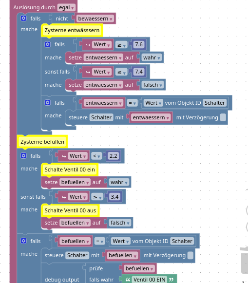

            • paul53
              paul53 @wotan2005 last edited by
              @wotan2005 sagte: schreib mir das Protokoll voll.
              Siehe hier für das Prinzip. Den Debug-Block zusammen mit dem "steuere" innerhalb des Vergleichs.

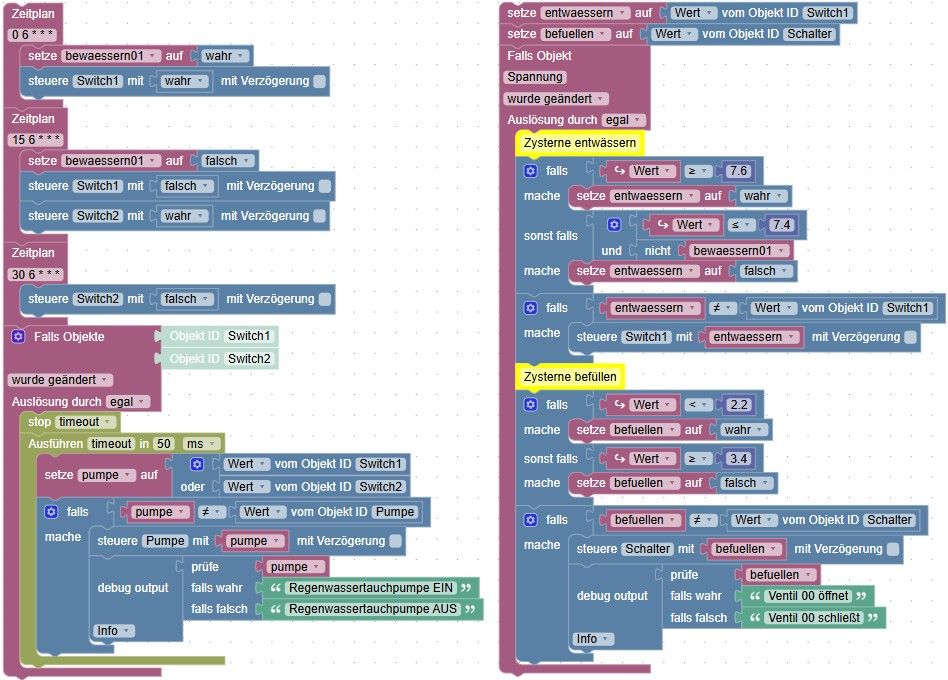

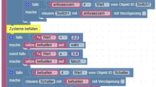

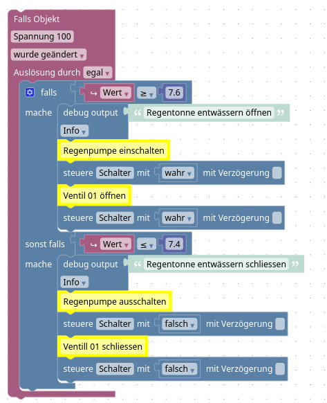

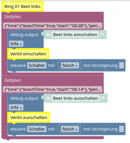

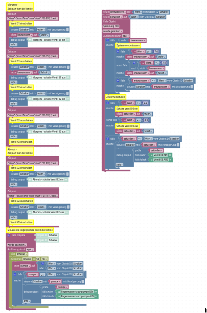

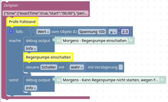

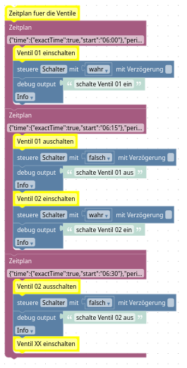

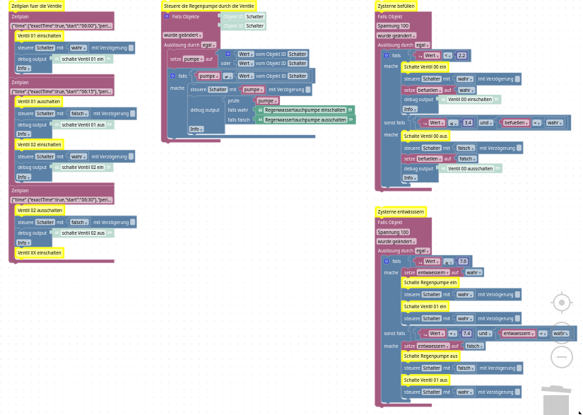

                Na gut dann der Reihe nach.
                Folgende Reihenfolge wird ab 6:00Uhr morgens gestartet:
                Und dann gibt es noch die beiden Blockly zum befüllen und um ein Überlaufen zu verhindern.
                Zum Thema Datenpunkt schreiben, da bin ich leider nicht wirklich mit zurecht gekommen.
                Mein Gedanke war, ich packe vor dem Trigger ein "Datenpunkt erzeugen" mit einem NULL-Wert, aktualisiere Ihn wenn ich die Pumpe einschalte oder ausschalte. Das hat aber leider nicht funktioniert.
                Homoran Asgothian 2 Replies Last reply Reply Quote 0

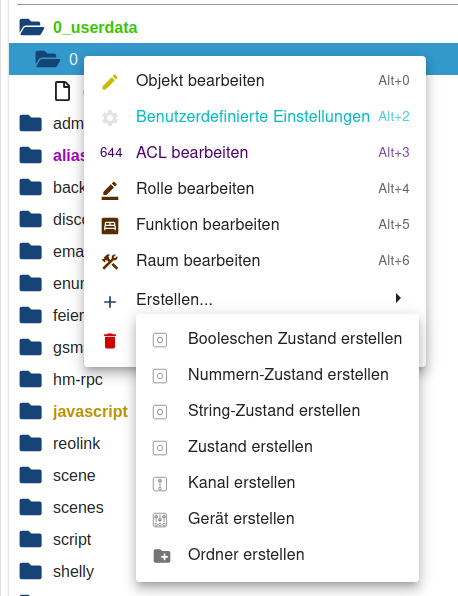

                  Auch ohne erzeugen vor dem Trigger, wenn du den DP msnuell unter 0_userdata.0 angelegt hast
                  • W
                    Da wäre mein nächsten Verständnis-Problem, wo muss ich wenn dann welchen Datenpunkt wie händisch erzeugen? Das habe ich irgendwie noch nicht wirklich verstanden.
                    Codierknecht 1 Reply Last reply Reply Quote 0

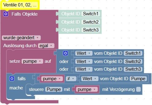

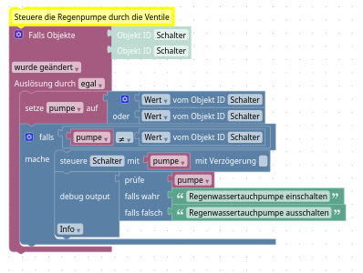

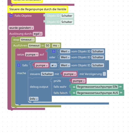

                    • Asgothian
                      Asgothian Developer @wotan2005 last edited by Asgothian

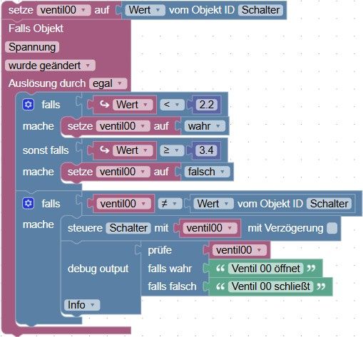

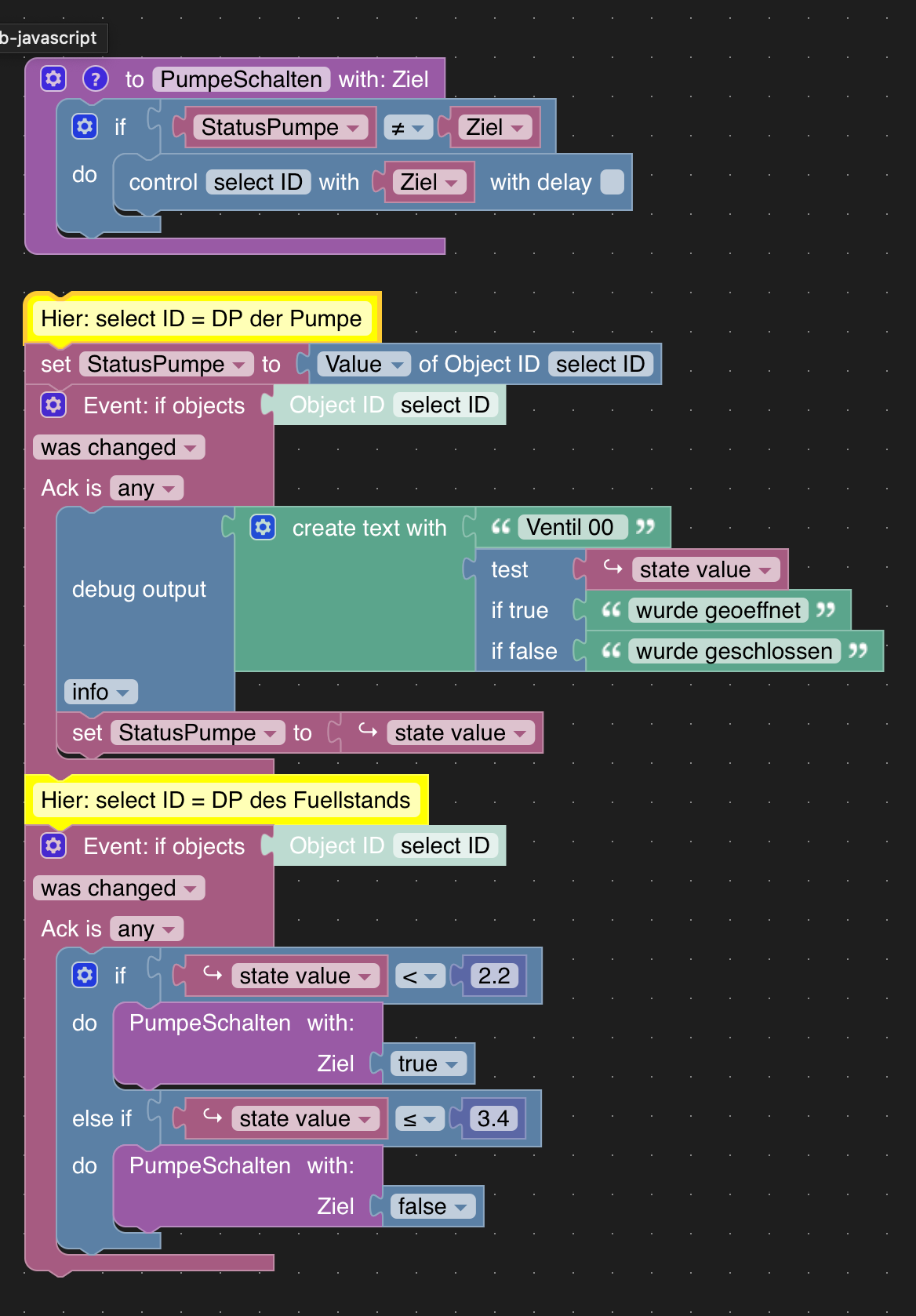

                      Warum nutzt du nicht einfach den DP der Pumpe ?
                      Diese Variante logged nebenbei auch wenn die Pumpe wegen des Zeitplans geschaltet wird.
                      Nebenbei hast du da noch ein Screenshot 2025-08-18 at 09.32.53.png in deinem Skript. Das wird denke ich so nicht gehen. Woher kommt dieses Objekt Schalter ?
                      Edit: Jetzt ist mir klar was du damit wolltest - so geht das aber nicht. Wenn du den Wert eines DP abfragen willst, dann geht das nicht via dem Objekt Baustein, sondern via
                      Nur das du das in meinem Beispiel nicht brauchst - die Variable StatusPumpe merkt sich wie die Pumpe geschaltet ist - wird durch den trigger auf die Pumpe aktualisiert und wird benutzt um sicher zu stellen das die Pumpe nur angesteuert wird wenn sie auch angesteuert werden soll
                      A.
                      Homoran W 2 Replies Last reply Reply Quote 0

                          ich vermute er hatte dich einfach nicht verstanden. Wobei - wenn er PHP nutzt sollte er eigentlich seine Skripte in JS machen - nicht Blockly 🙂

                            Codierknecht Developer Most Active @wotan2005 last edited by
                            Offensichtlich hast Du noch gar keinen DP unterhalb von 0_userdata.0 angelegt.
                            Du kannst in Deinem Beispiel dort "XYZ-Zustand erstellen" verwenden. Halt mit dem passenden Typen ... je nach Bedarf.
                            Oder Du wählst (wie in Deinem Beispiel) den Eltern-Knoten und klickst oben auf das "+".
                            Ich persönlich würde die Trigger nicht mit dem Wizard erstellen, sondern einen CRON hinterlegen. Die funktionieren nach meiner Erfahrung stabiler und lassen sich in Screenshots besser lesen.
                            Lesestoff: https://forum.iobroker.net/topic/70481/blockly-for-dummies-starthilfe-und-tipps

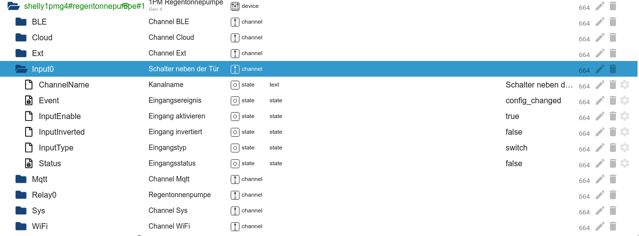

                              Mit Status der Pumpe, meinst du diesen Datenpunkt:

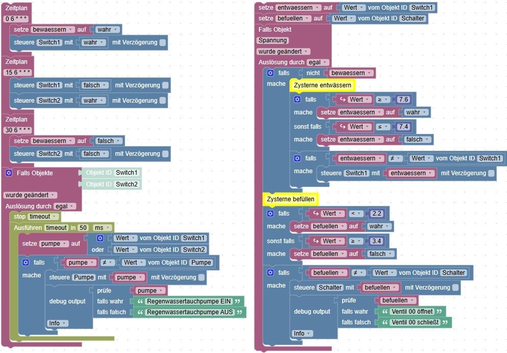

                                      • paul53
                                        @wotan2005
                                        Vorschlag:
                                        • W

                                          wo finde ich [setze "Ventil00" auf]
                                          • paul53

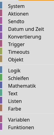

                                            @wotan2005 sagte: wo finde ich [setze "Ventil00" auf]
                                            Du musst erst die Variable Ventil00 erstellen.
