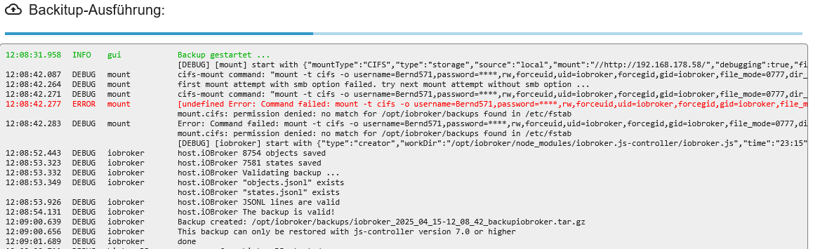

                  Was mich stutzig macht ist Zeile 15 mit der Meldung. Das Passwort hqbe ich mehrfach überprüft. Auch habe ich mit unteerschiedlichen Nutzernamen - Passwortkombinationen getestet - immer das gleiche.
                  Was kann ich da noch machen?
                  code_tgui
                  Backup gestartet ...
                  [DEBUG] [mount] start with {"mountType":"CIFS","type":"storage","source":"local","mount":"//192.168.178.58","debugging":true,"fileDir":"/opt/iobroker/iobroker-data/backitup","wakeOnLAN":false,"macAd":"20:DE:20:DE:20:DE","wolTime":"25","wolPort":"9","wolExtra":false,"smb":"vers=3.0","sudo":false,"cifsDomain":"","clientInodes":false,"cacheLoose":false,"deleteOldBackup":false,"ownDir":true,"dir":"Ext_FP_1_Backups_1.0_A_u_B/Backups_iOBroker","dirMinimal":"Ext_FP_1_Backups_1.0_A_u_B/Backups_iOBroker","user":"Bernd571","pass":"****","expertMount":"sudo mount -t cifs -o username=<username>,password=\"<password>\",noserverino,cache=loose,rw,uid=iobroker,gid=iobroker,file_mode=0777,dir_mode=0777,vers=3.1.1 //192.168.0.1/NAS/BACKUP /opt/iobroker/backups","ignoreErrors":false}
                  12:16:05.363
                  DEBUG
                  mount
                  cifs-mount command: "mount -t cifs -o username=Bernd571,password=****,rw,forceuid,uid=iobroker,forcegid,gid=iobroker,file_mode=0777,dir_mode=0777,vers=3.0 //192.168.178.58/Ext_FP_1_Backups_1.0_A_u_B/Backups_iOBroker /opt/iobroker/backups"
                  12:16:05.396
                  DEBUG
                  mount
                  cifs-mount command: "mount -t cifs -o username=Bernd571,password=****,rw,forceuid,uid=iobroker,forcegid,gid=iobroker,file_mode=0777,dir_mode=0777 //192.168.178.58/Ext_FP_1_Backups_1.0_A_u_B/Backups_iOBroker /opt/iobroker/backups"
                  12:16:05.515
                  DEBUG
                  mount
                  Error: Command failed: mount -t cifs -o username=Bernd571,password=****,rw,forceuid,uid=iobroker,forcegid,gid=iobroker,file_mode=0777,dir_mode=0777 //192.168.178.58/Ext_FP_1_Backups_1.0_A_u_B/Backups_iOBroker /opt/iobroker/backups
                  mount.cifs: permission denied: no match for /opt/iobroker/backups found in /etc/fstab
                  [DEBUG] [iobroker] start with {"type":"creator","workDir":"/opt/iobroker/node_modules/iobroker.js-controller/iobroker.js","time":"23:15","cronjob":"00 48 02 */1 * *","ownCron":false,"debugging":true,"slaveBackup":"Single","everyXDays":"1","deleteBackupAfter":0,"cifs":{"enabled":true,"mountType":"CIFS","type":"storage","source":"local","mount":"//192.168.178.58","debugging":true,"fileDir":"/opt/iobroker/iobroker-data/backitup","wakeOnLAN":false,"macAd":"20:DE:20:DE:20:DE","wolTime":"25","wolPort":"9","wolExtra":false,"smb":"vers=3.0","sudo":false,"cifsDomain":"","clientInodes":false,"cacheLoose":false,"deleteOldBackup":false,"ownDir":true,"dir":"/Ext_FP_1_Backups_1.0_A_u_B/Backups_iOBroker","dirMinimal":"Ext_FP_1_Backups_1.0_A_u_B/Backups_iOBroker","user":"Bernd571","pass":"****","expertMount":"sudo mount -t cifs -o username=<username>,password=\"<password>\",noserverino,cache=loose,rw,uid=iobroker,gid=iobroker,file_mode=0777,dir_mode=0777,vers=3.1.1 //192.168.0.1/NAS/BACKUP /opt/iobroker/backups","ignoreErrors":false,"context":{"fileNames":[],"errors":{"mount":{"code":1,"killed":false,"signal":null,"cmd":"mount -t cifs -o username=Bernd571,password=\"Was571serQNA\",rw,forceuid,uid=iobroker,forcegid,gid=iobroker,file_mode=0777,dir_mode=0777 //192.168.178.58/Ext_FP_1_Backups_1.0_A_u_B/Backups_iOBroker /opt/iobroker/backups"}},"done":[],"types":[]},"timestamp":1744798555425,"adapter":null,"influxDBEvents":[],"mySqlEvents":[],"pgSqlEvents":[]},"ignoreErrors":false,"dir":"/opt/iobroker","historyDB":{"enabled":true,"type":"creator","ftp":{"enabled":false,"type":"storage","source":"local","host":"192.168.178.1","debugging":true,"deleteOldBackup":true,"ftpDeleteAfter":10,"advancedDelete":false,"ownDir":true,"dir":"iOBroker","dirMinimal":"iOBroker","user":"Bernd571","pass":"****","port":"21","secure":false,"signedCertificates":true,"ignoreErrors":false},"cifs":{"enabled":true,"mountType":"CIFS","type":"storage","source":"local","mount":"192.168.178.58","debugging":true,"fileDir":"/opt/iobroker/iobroker-data/backitup","wakeOnLAN":false,"macAd":"20:DE:20:DE:20:DE","wolTime":"25","wolPort":"9","wolExtra":false,"smb":"vers=3.0","sudo":false,"cifsDomain":"","clientInodes":false,"cacheLoose":false,"deleteOldBackup":false,"ownDir":true,"dir":"Ext_FP_1_Backups_1.0_A_u_B/Backups_iOBroker","dirMinimal":"Ext_FP_1_Backups_1.0_A_u_B/Backups_iOBroker","user":"Bernd571","pass":"****","expertMount":"sudo mount -t cifs -o username=<username>,password=ext

                    • Thomas Braun
                      Thomas Braun Most Active @Bernd 3 last edited by Thomas Braun
                      @bernd-3 sagte in Bin total überfordert mit Reaktivierung meines Systems:
                      Hast du da die Experten-Einstellungen aktiv?
                      Denn soweit ich weiß muss es im Standard in der /etc/fstab keine Einträge geben.
                      Das 'permission denied' bezieht sich auch nicht auf die user/pw - Kombination sondern auf das mounten an sich. Das darf (ohne passende Einstellungen) so nur root.

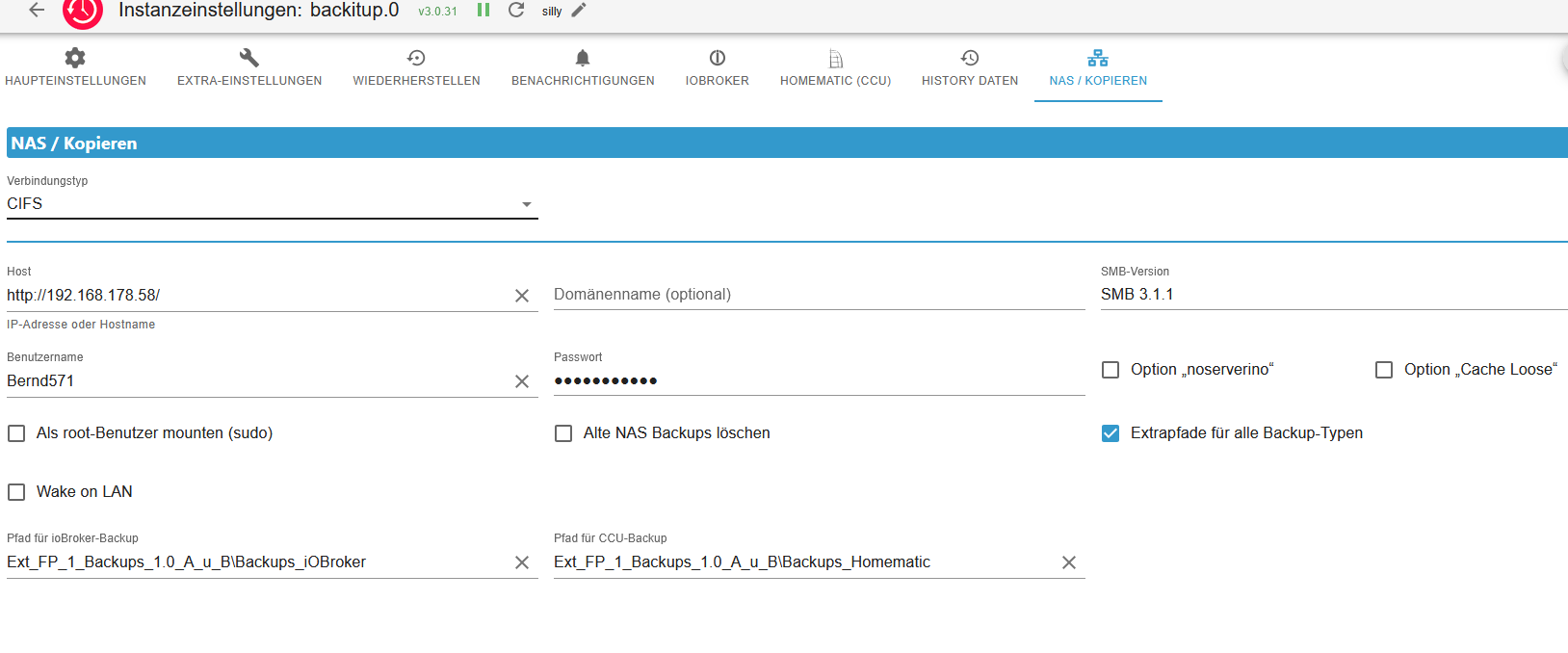

                              • B
                                Bernd 3 @Homoran last edited by
                                @homoran sagte in Bin total überfordert mit Reaktivierung meines Systems:
                                @thomas-braun
                                Experten-Einstellung ist "off (default)"
                                bitte zeigen!
                                auch die cifs Einstellungen
                                (ggf. Passwort o.ä. unkenntlich machen)

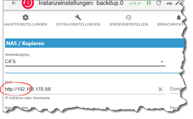

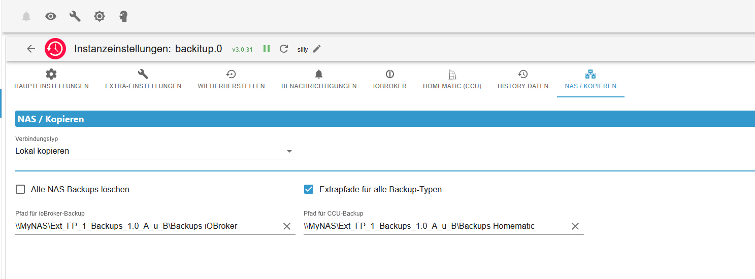

                                Meinst Du das mit CIFS -Einstellungen?

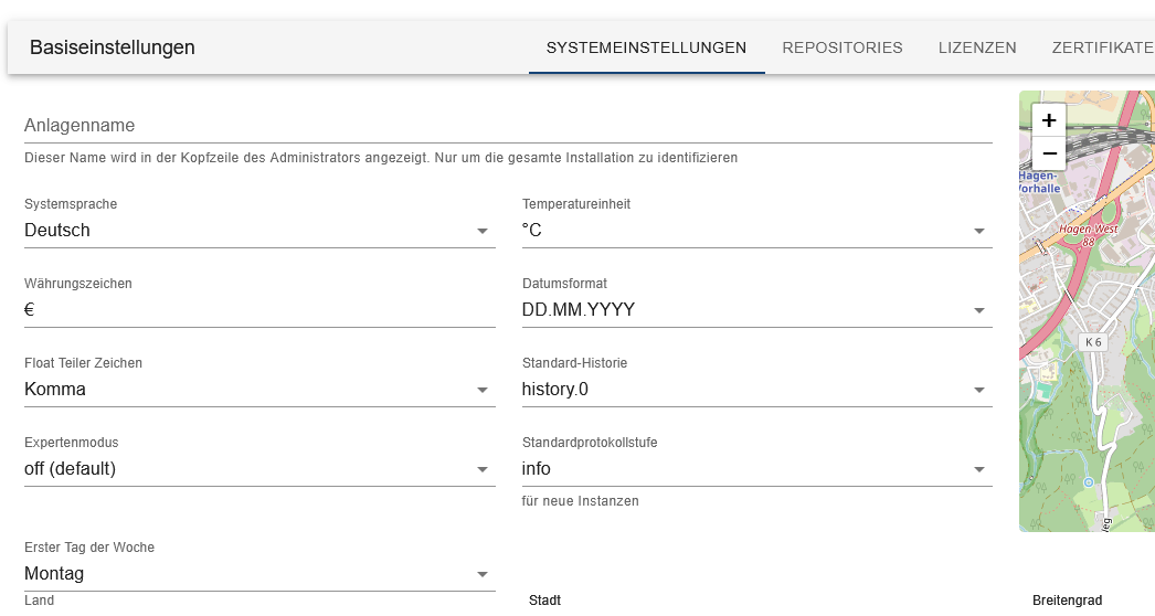

                                Hier die Experten-Einstellung OFF
                                Codierknecht 1 Reply Last reply Reply Quote 0

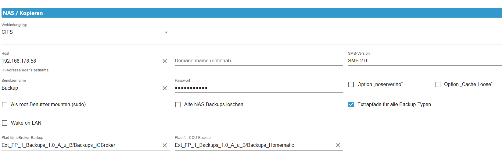

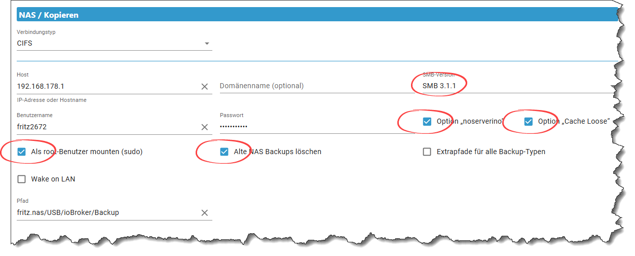

                                  • Codierknecht
                                    Codierknecht Developer Most Active @Bernd 3 last edited by Codierknecht
                                    @bernd-3
                                    So in etwa sollte das aussehen:
                                    (natürlich mit anderer IP und Pfad)
                                    Edit
                                    Hab nochmal den Screenshot geändert und die Einstellungen meines Testsystems genommen.

                                      'Als root Benutzer mounten (sudo)'
                                      Und den SMB-Dialekt würde ich auch so hoch wie möglich einstellen. Sollte 3.1.1 statt 2.0 sein.
                                      Okay, SMB-Einstellung sagt mir etwas. Hatte ich aber vorher auch schon mal auf 3.1.1. Versuche ich aber nochmals.
                                      "Als root Benutzer mounten (sudo)" - Kannst Du mir das bitte genauer erklären, für den totalen Newbie oder den im Windoof hängengebliebenen Idioten? Danke! Hat sich erledigt - Codierknecht war schon so frei! Danke
                                      • Thomas Braun
                                        Thomas Braun Most Active @Codierknecht last edited by Thomas Braun
                                        @codierknecht
                                        Ja, wobei man die Optionen 'noserverino' und 'cache loose' nur setzen sollte, wenn die unbedingt erforderlich sind. Erstmal ohne probieren.
                                        Beim FritzNAS sind die aber erforderlich.
                                        • B
                                          Bernd 3 @Thomas Braun last edited by
                                          @thomas-braun
                                          Es handelt sich um ein QNAP-NAS (mit externen Erweiterungs-Festplatten), kein FritzNAS.
                                          Mit 3.1.1 aber ohne "nosevervino" und ohne "cache loose" getestet:
                                          backitup.0
                                          	2025-04-16 15:14:31.316	error	[iobroker/clean] Backup files not deleted from /opt/iobroker/backups because some errors.
                                          backitup.0
                                          	2025-04-16 15:13:12.229	error	[iobroker/mount] Refer to the mount.cifs(8) manual page (e.g. man mount.cifs) and kernel log messages (dmesg)
                                          backitup.0
                                          	2025-04-16 15:13:12.229	error	[iobroker/mount] mount error(2): No such file or directory
                                          backitup.0
                                          	2025-04-16 15:13:12.228	error	[iobroker/mount] [undefined Error: Command failed: sudo mount -t cifs -o username=Backup,password=****,rw,forceuid,uid=iobroker,forcegid,gid=iobroker,file_mode=0777,dir_mode=0777 //192.168.178.58/Ext_FP_1_Backups_1.0_A_u_B/Backups_iOBroker /opt/iobroker/backups
                                          backitup.0
                                          	2025-04-16 15:12:21.122	error	Error: Command failed: sudo mount -t cifs -o username=Backup,password=****,rw,forceuid,uid=iobroker,forcegid,gid=iobroker,file_mode=0777,dir_mode=0777 //192.168.178.58/Ext_FP_1_Backups_1.0_A_u_B/Backups_iOBroker /opt/iobroker/backupsmount error(2): No such file or directoryRefer to the mount.cifs(8) manual page (e.g. man mount.cifs) and kernel log messages (dmesg)
                                          backitup.0
                                          	2025-04-16 15:09:35.786	error	[iobroker/clean] Backup files not deleted from /opt/iobroker/backups because some errors.
                                          Als nächstes versuche ich mit "noserverino" und "cacheloose". Berichte dann
                                          Homoran B 2 Replies Last reply Reply Quote 0
