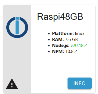

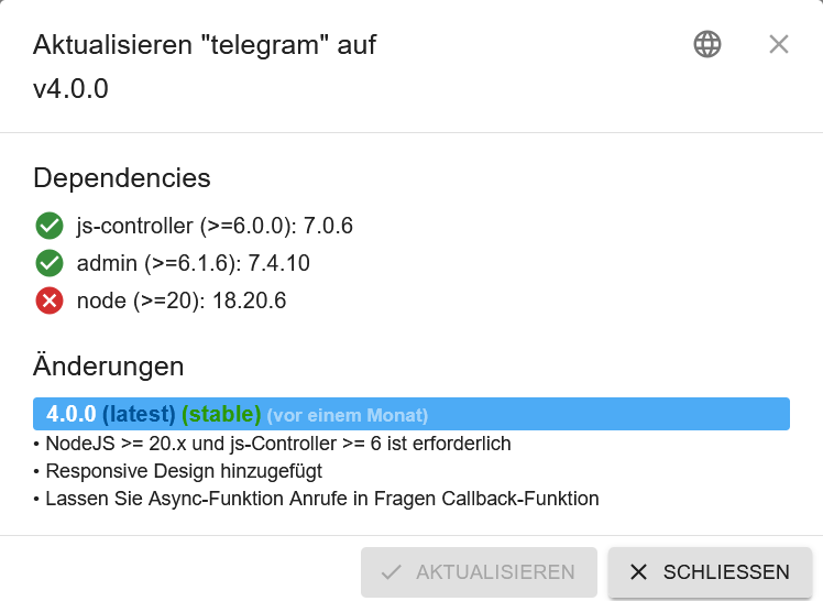

                    Entschuldigung! hier die Infos:
                    ```bash
                    Script v.2025-02-02
                    *** BASE SYSTEM ***
                     Static hostname: Raspi48GB
                           Icon name: computer
                              Kernel: Linux 6.6.62+rpt-rpi-v8
                        Architecture: arm64
                    OS is similar to:
                    Model           : Raspberry Pi 4 Model B Rev 1.5
                    Docker          : false
                    Virtualization  : none
                    Kernel          : aarch64
                    Userland        : 64 bit
                    Systemuptime and Load:
                     17:49:00 up 10 days, 22:20,  2 users,  load average: 0.16, 0.18, 0.45
                    CPU threads: 4
                    *** LIFE CYCLE STATUS ***
                    Operating System is the current Debian stable version codenamed 'bookworm'!
                    *** RASPBERRY THROTTLING ***
                    Current issues:
                    Previously detected issues:
                    *** TIME AND TIMEZONES ***
                                   Local time: Sat 2025-02-08 17:49:00 CET
                               Universal time: Sat 2025-02-08 16:49:00 UTC
                                     RTC time: n/a
                                  NTP service: active
                              RTC in local TZ: no
                    *** Users and Groups ***
                    User that called 'iob diag':
                    pi
                    HOME=/home/pi
                    GROUPS=pi adm dialout cdrom sudo audio video plugdev games users input render netdev gpio i2c spi iobroker
                    iobroker
                    HOME=/home/iobroker
                    *** DISPLAY-SERVER SETUP ***
                    Display-Server: false
                    Desktop:
                    Terminal:       tty
                    *** MEMORY ***
                    Mem:            8.2G        1.7G        4.9G        1.3M        1.6G        6.5G
                    Swap:           209M          0B        209M
                    Total:          8.4G        1.7G        5.2G
                    Active iob-Instances:   18
                             7809 M total memory
                             1648 M used memory
                             1690 M active memory
                             1164 M inactive memory
                             4715 M free memory
                              226 M buffer memory
                             1343 M swap cache
                              199 M total swap
                                0 M used swap
                              199 M free swap
                    top - 17:49:01 up 10 days, 22:20,  2 users,  load average: 0.16, 0.18, 0.45
                    Tasks: 185 total,   3 running, 182 sleeping,   0 stopped,   0 zombie
                    %Cpu(s):  0.0 us, 25.0 sy,  0.0 ni, 75.0 id,  0.0 wa,  0.0 hi,  0.0 si,  0.0 st
                    MiB Mem :   7809.9 total,   4714.8 free,   1649.0 used,   1569.3 buff/cache
                    MiB Swap:    200.0 total,    200.0 free,      0.0 used.   6160.9 avail Mem
                    *** FAILED SERVICES ***
                    0 loaded units listed.
                    *** DMESG CRITICAL ERRORS ***
                    No critical errors detected
                    *** FILESYSTEM ***
                    udev           devtmpfs  3.6G     0  3.6G   0% /dev
                    tmpfs          tmpfs     781M  1.2M  780M   1% /run
                    /dev/mmcblk0p2 ext4       59G  9.6G   46G  18% /
                    tmpfs          tmpfs     3.9G     0  3.9G   0% /dev/shm
                    tmpfs          tmpfs     5.0M   16K  5.0M   1% /run/lock
                    /dev/mmcblk0p1 vfat      510M   65M  446M  13% /boot/firmware
                    /dev/sda1      exfat     3.9G  195M  3.7G   5% /mnt/usb0
                    tmpfs          tmpfs     781M     0  781M   0% /run/user/1000
                    [Tue Jan 28 19:28:38 2025] Kernel command line: coherent_pool=1M 8250.nr_uarts=1 snd_bcm2835.enable_headphones=0 cgroup_disable=memory numa_policy=interleave snd_bcm2835.enable_headphones=1 snd_bcm2835.enable_hdmi=1 snd_bcm2835.enable_hdmi=0  smsc95xx.macaddr=D8:3A:DD:43:B6:26 vc_mem.mem_base=0x3ec00000 vc_mem.mem_size=0x40000000  console=tty1 root=PARTUUID=8ebf6d55-02 rootfstype=ext4 fsck.repair=yes rootwait
                    [Tue Jan 28 19:28:41 2025] EXT4-fs (mmcblk0p2): mounted filesystem 93c89e92-8f2e-4522-ad32-68faed883d2f ro with ordered data mode. Quota mode: none.
                    [Tue Jan 28 19:28:42 2025] EXT4-fs (mmcblk0p2): re-mounted 93c89e92-8f2e-4522-ad32-68faed883d2f r/w. Quota mode: none.
                    Show mounted filesystems:
                    TARGET           SOURCE         FSTYPE OPTIONS
                    /                /dev/mmcblk0p2 ext4   rw,noatime
                    |-/boot/firmware /dev/mmcblk0p1 vfat   rw,relatime,fmask=0022,dmask=0022,codepage=437,iocharset=ascii,shortname=mixed,errors=remount-ro
                    `-/mnt/usb0      /dev/sda1      exfat  rw,relatime,fmask=0000,dmask=0000,allow_utime=0022,iocharset=utf8,errors=remount-ro
                    /var:
                    1.3G    /var/
                    729M    /var/log
                    728M    /var/log/journal/0e010272fae14c1784990c1fc7429731
                    206M    /var/cache
                    Journal file /var/log/journal/0e010272fae14c1784990c1fc7429731/user-1001@00062a7f4e38fbb1-0ae92bb7e00931f0.journal~ is truncated, ignoring file.
                    Archived and active journals take up 727.5M in the file system.
                    /opt/iobroker/backups:
                    193M    /opt/iobroker/backups/
                    /opt/iobroker/iobroker-data:
                    1.2G    /opt/iobroker/iobroker-data/
                    1.1G    /opt/iobroker/iobroker-data/files
                    617M    /opt/iobroker/iobroker-data/files/javascript.admin
                    560M    /opt/iobroker/iobroker-data/files/javascript.admin/static
                    558M    /opt/iobroker/iobroker-data/files/javascript.admin/static/js
                    35M     /opt/iobroker/iobroker-data/files/devices.admin/static/js/main.24f2bb56.js.map
                    24M     /opt/iobroker/iobroker-data/files/web.admin/static/js/main.135279a0.js.map
                    24M     /opt/iobroker/iobroker-data/files/vis-2/static/js/main.f305bc29.js.map
                    24M     /opt/iobroker/iobroker-data/files/vis-2/static/js/main.8e80ccb0.js.map
                    24M     /opt/iobroker/iobroker-data/files/vis-2/customWidgets.js.map
                    USB-Devices by-id:
                    /dev/serial/by-id/usb-ITead_Sonoff_Zigbee_3.0_USB_Dongle_Plus_0867d5d6b78ded11959b02f6b86ce6f8-if00-port0
                    Your zigbee.0 COM-Port is matching 'by-id'. Very good!
                    *** NodeJS-Installation ***
                    /usr/bin/nodejs         v18.20.6
                    /usr/bin/node           v18.20.6
                    /usr/bin/npm            10.8.2
                    /usr/bin/npx            10.8.2
                    /usr/bin/corepack       0.29.4
                    nodejs:
                      Installed: 18.20.6-1nodesource1
                      Candidate: 18.20.6-1nodesource1
                      Version table:
                     *** 18.20.6-1nodesource1 100
                            100 /var/lib/dpkg/status
                         18.19.0+dfsg-6~deb12u2 500
                            500 http://deb.debian.org/debian bookworm/main arm64 Packages
                         18.19.0+dfsg-6~deb12u1 500
                            500 http://deb.debian.org/debian-security bookworm-security/main arm64 Packages
                    No problems detected
                    Errors in npm tree: 0
                    *** ioBroker-Installation ***
                    ioBroker Status
                    Objects type: jsonl
                    States  type: jsonl
                    Hosts:
                    Raspi48GB           Raspi48GB (version: 7.0.6, hostname: Raspi48GB     , alive, uptime: 1234)
                    Core adapters versions
                    js-controller:  7.0.6
                    admin:          7.4.10
                    javascript:     8.8.3
                    nodejs modules from github:     0
                    Adapter State
                    + system.adapter.admin.0                  : admin                 : Raspi48GB                                -  enabled, port: 8081, bind: 0.0.0.0, run as: admin
                    + system.adapter.backitup.0               : backitup              : Raspi48GB                                -  enabled
                    + system.adapter.discovery.0              : discovery             : Raspi48GB                                -  enabled
                    + system.adapter.followthesun.0           : followthesun          : Raspi48GB                                -  enabled
                    + system.adapter.frontier_silicon.0       : frontier_silicon      : Raspi48GB                                -  enabled
                    + system.adapter.hm-rega.0                : hm-rega               : Raspi48GB                                -  enabled
                    + system.adapter.hm-rpc.0                 : hm-rpc                : Raspi48GB                                -  enabled, port: 0
                    + system.adapter.hm-rpc.1                 : hm-rpc                : Raspi48GB                                -  enabled, port: 0
                    + system.adapter.javascript.0             : javascript            : Raspi48GB                                -  enabled
                    + system.adapter.mqtt.0                   : mqtt                  : Raspi48GB                                -  enabled, port: 1883, bind: 0.0.0.0
                    + system.adapter.shelly.0                 : shelly                : Raspi48GB                                -  enabled, port: 1882, bind: 0.0.0.0
                    + system.adapter.shelly.1                 : shelly                : Raspi48GB                                -  enabled, port: 1882, bind: 0.0.0.0
                    + system.adapter.telegram.0               : telegram              : Raspi48GB                                -  enabled, port: 8443, bind: 0.0.0.0
                    + system.adapter.text2command.0           : text2command          : Raspi48GB                                -  enabled
                    + system.adapter.vis-2.0                  : vis-2                 : Raspi48GB                                -  enabled
                    + system.adapter.web.0                    : web                   : Raspi48GB                                -  enabled, port: 8082, bind: 0.0.0.0, run as: admin
                      system.adapter.yr.0                     : yr                    : Raspi48GB                                -  enabled
                    + system.adapter.zigbee.0                 : zigbee                : Raspi48GB                                -  enabled, port: /dev/serial/by-id/usb-ITead_Sonoff_Zigbee_3.0_USB_Dongle_Plus_0867d5d6b78ded11959b02f6b86ce6f8-if00-port0
                    + instance is alive

                          Sorry, aber ich kann Dir kein Protokoll liefern, sondern einen Screen-shot:
                          Homoran Thomas Braun 2 Replies Last reply Reply Quote 0
                          • Homoran
                            Homoran Global Moderator Administrators @searcher57 last edited by
                            @searcher57 sagte in Update von Node 18 auf Node 20 bricht ab:
                            einen Screen-shot:
                            da steht's doch ganz deutlich und rot markiert
                            ist zu alt
                            du brauchst v20
                            S 2 Replies Last reply Reply Quote 0
