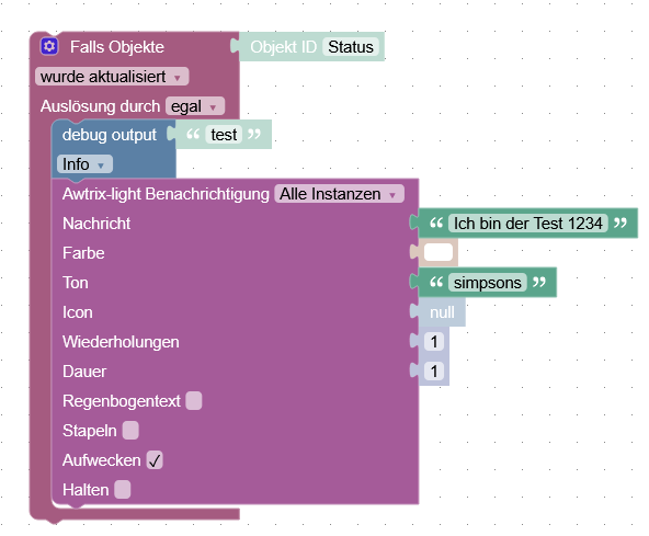

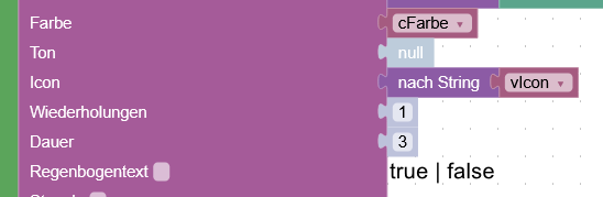

        • DJMarc75
          DJMarc75 @Bravestarr last edited by DJMarc75
          @bravestarr sagte in Test Adapter Awtrix-Light:
          I saw "blocky" in your documentation. Is this the way to go?
          Yes
          example:
          C 1 Reply Last reply Reply Quote 0

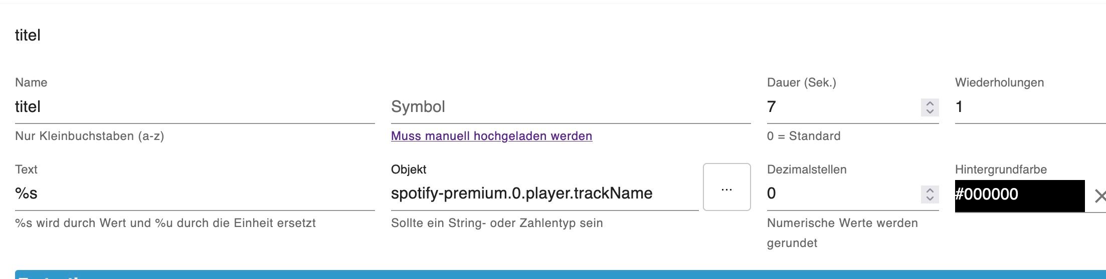

            Czarno13 @DJMarc75 last edited by Czarno13
            @djmarc75
            Aber es geht auch mit App:
            wird nur dann angezeigt, wenn Spotify läuft
            Bravestarr 1 Reply Last reply Reply Quote 0
            • Bravestarr
              Bravestarr @Czarno13 last edited by Bravestarr
              @czarno13 No the app is always active and does not disapear or appear when a song is played.
              What works is this:
              // Create a state change listener for spotify-premium.0.player.trackName
              on({ id: 'spotify-premium.0.player.trackName', change: 'ne', ack: true }, function (obj) {
                  if (!obj || !obj.state || obj.state.val === null) {
                      console.warn('Invalid trackName state object or null value.');
                      return;
                  const newTrackName = obj.state.val;
                  const notificationText = `Now playing: ${newTrackName}`;
                  if (newTrackName.trim() === '') {
                      console.warn('Track name is empty.');
                      return;
                  // Send the notification to Awtrix display
                  sendTo('awtrix-light', 'notification', { text: notificationText, repeat: 1, duration: 5, stack: true, wakeup: true }, (res) => {
                      if (res && res.error) {
                          console.error(res.error);
              C M 2 Replies Last reply Reply Quote 1
              • C
                Czarno13 @Bravestarr last edited by Czarno13
                @bravestarr
                no, for me it works exactly like that, it only displays something when spotify is playing

                  • Bravestarr
                    @czarno13 said in Test Adapter Awtrix-Light:
                    @bravestarr
                    Yes, but what I wanted and accomplished with the notice triggered by the js adapter is when a songs starts its name is briefly displayed and disappears after 3 seconds. I do not want to keep the song visible while spotify is playing.
                    BTW: how can I display an icon cia id in the js notice?
