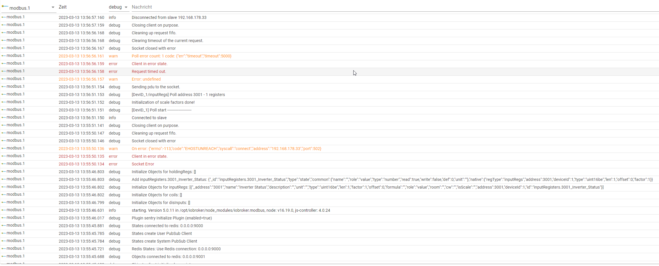

                  • P
                    Pep @wendy2702 last edited by
                    @wendy2702
                    sieht aus, als ob er das ModBus Gerät nicht findet oder?

                      • P
                        Pep @Homoran last edited by
                        aber gern doch
                        modbus.1 2023-03-13 17:15:28.705	info	Disconnected from slave 192.168.178.33
                        modbus.1 2023-03-13 17:15:28.704	debug	Closing client on purpose.
                        modbus.1 2023-03-13 17:15:27.705	debug	Cleaning up request fifo.
                        modbus.1 2023-03-13 17:15:27.705	debug	Clearing timeout of the current request.
                        modbus.1 2023-03-13 17:15:27.704	debug	Socket closed with error
                        modbus.1 2023-03-13 17:15:27.702	warn	Poll error count: 1 code: {"err":"timeout","timeout":5000}
                        modbus.1 2023-03-13 17:15:27.701	error	Client in error state.
                        modbus.1 2023-03-13 17:15:27.701	error	Request timed out.
                        modbus.1 2023-03-13 17:15:27.701	warn	Error: undefined
                        modbus.1 2023-03-13 17:15:22.697	debug	Sending pdu to the socket.
                        modbus.1 2023-03-13 17:15:22.696	debug	[DevID_1/inputRegs] Poll address 3001 - 1 registers
                        modbus.1 2023-03-13 17:15:22.695	debug	Initialization of scale factors done!
                        modbus.1 2023-03-13 17:15:22.694	debug	[DevID_1] Poll start ---------------------
                        modbus.1 2023-03-13 17:15:22.693	info	Connected to slave
                        modbus.1 2023-03-13 17:15:22.406	debug	Initialize Objects for holdingRegs: []
                        modbus.1 2023-03-13 17:15:22.406	debug	Add inputRegisters.3001_Inverter_Status: {"_id":"inputRegisters.3001_Inverter_Status","type":"state","common":{"name":"","role":"value","type":"number","read":true,"write":false,"def":0,"unit":""},"native":{"regType":"inputRegs","address":3001,"deviceId":1,"type":"uint16be","len":1,"offset":0,"factor":1}}
                        modbus.1 2023-03-13 17:15:22.405	debug	Initialize Objects for inputRegs: [{"_address":"3001","name":"Inverter Status","description":"","unit":"","type":"uint16be","len":1,"factor":1,"offset":0,"formula":"","role":"value","room":"","cw":"","isScale":"","address":3001,"deviceId":1,"id":"inputRegisters.3001_Inverter_Status"}]
                        modbus.1 2023-03-13 17:15:22.405	debug	Initialize Objects for coils: []
                        modbus.1 2023-03-13 17:15:22.404	debug	Initialize Objects for disInputs: []
                        modbus.1 2023-03-13 17:15:22.201	info	starting. Version 5.0.11 in /opt/iobroker/node_modules/iobroker.modbus, node: v16.19.0, js-controller: 4.0.24
                        modbus.1 2023-03-13 17:15:21.884	debug	Plugin sentry Initialize Plugin (enabled=true)
                        modbus.1 2023-03-13 17:15:21.749	debug	States connected to redis: 0.0.0.0:9000
                        modbus.1 2023-03-13 17:15:21.655	debug	States create User PubSub Client
                        modbus.1 2023-03-13 17:15:21.654	debug	States create System PubSub Client
                        modbus.1 2023-03-13 17:15:21.588	debug	Redis States: Use Redis connection: 0.0.0.0:9000
                        modbus.1 2023-03-13 17:15:21.555	debug	Objects connected to redis: 0.0.0.0:9001
                        modbus.1 2023-03-13 17:15:21.550	debug	Objects client initialize lua scripts
                        modbus.1 2023-03-13 17:15:21.478	debug	Objects create User PubSub Client
                        modbus.1 2023-03-13 17:15:21.477	debug	Objects create System PubSub Client
                        modbus.1 2023-03-13 17:15:21.381	debug	Objects client ready ... initialize now
                        modbus.1 2023-03-13 17:15:21.262	debug	Redis Objects: Use Redis connection: 0.0.0.0:9001
                        wendy2702 Homoran 2 Replies Last reply Reply Quote 0
                        • wendy2702
                          wendy2702 @Pep last edited by
                          @pep sagte in ModBus RTU auf ModBus TCP über DR302:
                          Gibt es das Register? Ich meine mich aus dem anderen Thread an Zahlen mit 4xxxx zu erinnern. Auch sollten es Holding sein meine ich.
