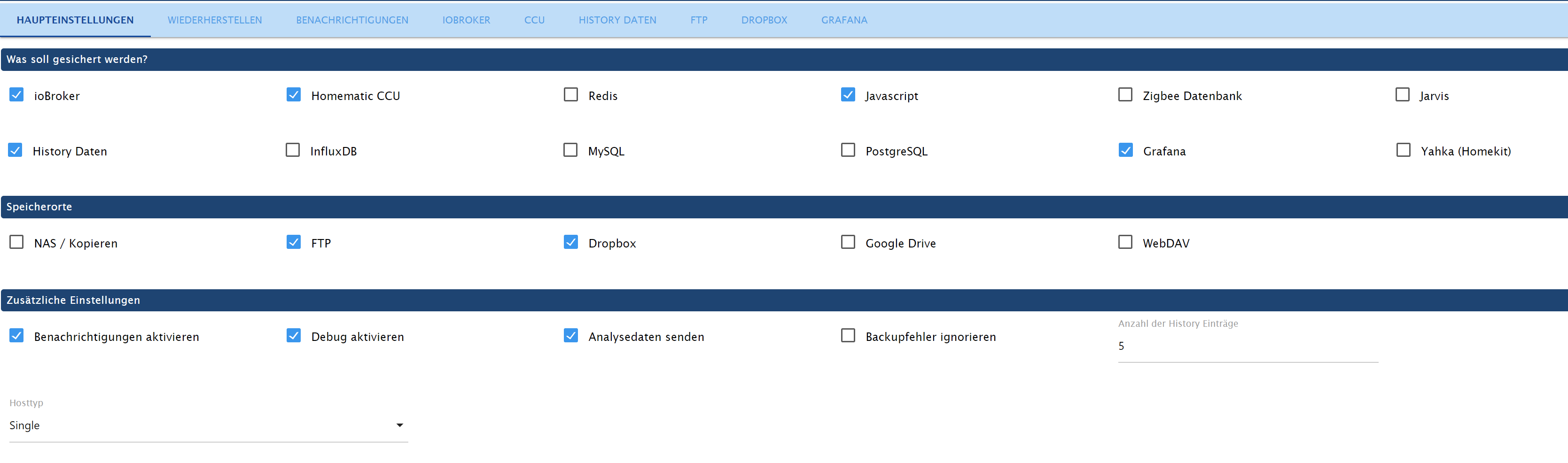

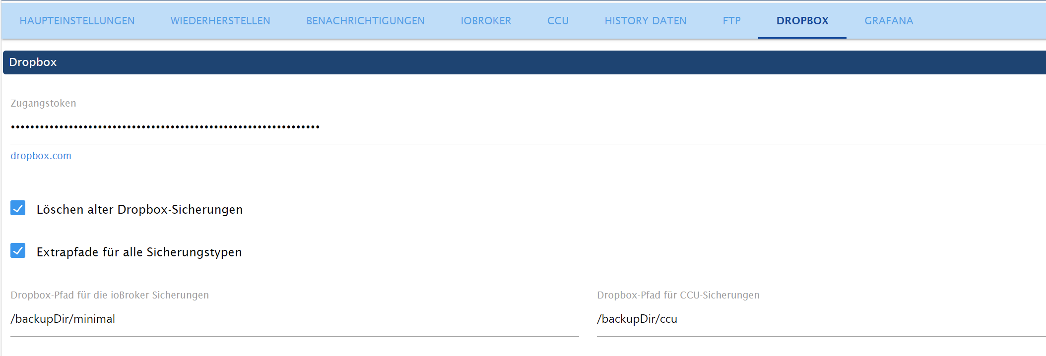

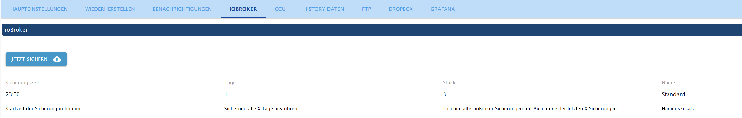

ich bemerkte gerade dass Backitup schon monatelang kein ioBroker-Backup in die Dropbox sichert.
Grafana, History und Javascript hingegen schon.
Was kann das sein?[DEBUG] [iobroker] start with {"type":"creator","time":"23:00","debugging":true,"slaveBackup":"Single","everyXDays":"1","nameSuffix":"Standard","deleteBackupAfter":0,"ftp":{"enabled":true,"type":"storage","source":null,"host":"www27.world4you.com","debugging":true,"deleteOldBackup":true,"ownDir":true,"bkpType":"Minimal","dir":"/backupDir/minimal","dirMinimal":"/backupDir/minimal","user":"ftp6257055_iobroker","pass":"****","port":"21","ignoreErrors":false},"dropbox":{"enabled":true,"type":"storage","source":null,"debugging":true,"deleteOldBackup":true,"accessToken":"****","ownDir":true,"bkpType":"Minimal","dir":"/backupDir/minimal","dirMinimal":"/backupDir/minimal","ignoreErrors":false},"ignoreErrors":false,"dir":"/opt/iobroker","historyDB":{"enabled":true,"type":"creator","ftp":{"enabled":true,"type":"storage","source":null,"host":"www27.world4you.com","debugging":true,"deleteOldBackup":true,"ownDir":true,"bkpType":"Minimal","dir":"/backupDir/minimal","dirMinimal":"/backupDir/minimal","user":"ftp6257055_iobroker","pass":"****","port":"21","ignoreErrors":false},"cifs":{"enabled":false,"mountType":"CIFS","type":"storage","source":null,"mount":"10.0.1.22","debugging":true,"fileDir":"/opt/iobroker/iobroker-data/backitup","wakeOnLAN":false,"macAd":"20:DE:20:DE:20:DE","wolTime":"25","smb":"vers=1.0","sudo":true,"cifsDomain":"","clientInodes":false,"deleteOldBackup":true,"ownDir":false,"bkpType":"Minimal","dir":"/volume1/io_backup","dirMinimal":"sharename/backupDir","user":"Christian","pass":"****","ignoreErrors":false},"dropbox":{"enabled":true,"type":"storage","source":null,"debugging":true,"deleteOldBackup":true,"accessToken":"****","ownDir":true,"bkpType":"Minimal","dir":"/backupDir/minimal","dirMinimal":"/backupDir/minimal","ignoreErrors":false},"webdav":{"enabled":false,"type":"storage","source":null,"debugging":true,"deleteOldBackup":false,"username":"username","pass":"****","url":"https://example.com/remote.php/dav/files/username/","ownDir":false,"bkpType":"Minimal","dir":"/backupDir","dirMinima ... [DEBUG] [iobroker] start with {"type":"creator","time":"23:00","debugging":true,"slaveBackup":"Single","everyXDays":"1","nameSuffix":"Standard","deleteBackupAfter":0,"ftp":{"enabled":true,"type":"storage","source":null,"host":"www27.world4you.com","debugging":true,"deleteOldBackup":true,"ownDir":true,"bkpType":"Minimal","dir":"/backupDir/minimal","dirMinimal":"/backupDir/minimal","user":"ftp6257055_iobroker","pass":"****","port":"21","ignoreErrors":false},"dropbox":{"enabled":true,"type":"storage","source":null,"debugging":true,"deleteOldBackup":true,"accessToken":"****","ownDir":true,"bkpType":"Minimal","dir":"/backupDir/minimal","dirMinimal":"/backupDir/minimal","ignoreErrors":false},"ignoreErrors":false,"dir":"/opt/iobroker","historyDB":{"enabled":true,"type":"creator","ftp":{"enabled":true,"type":"storage","source":null,"host":"www27.world4you.com","debugging":true,"deleteOldBackup":true,"ownDir":true,"bkpType":"Minimal","dir":"/backupDir/minimal","dirMinimal":"/backupDir/minimal","user":"ftp6257055_iobroker","pass":"****","port":"21","ignoreErrors":false},"cifs":{"enabled":false,"mountType":"CIFS","type":"storage","source":null,"mount":"10.0.1.22","debugging":true,"fileDir":"/opt/iobroker/iobroker-data/backitup","wakeOnLAN":false,"macAd":"20:DE:20:DE:20:DE","wolTime":"25","smb":"vers=1.0","sudo":true,"cifsDomain":"","clientInodes":false,"deleteOldBackup":true,"ownDir":false,"bkpType":"Minimal","dir":"/volume1/io_backup","dirMinimal":"sharename/backupDir","user":"Christian","pass":"****","ignoreErrors":false},"dropbox":{"enabled":true,"type":"storage","source":null,"debugging":true,"deleteOldBackup":true,"accessToken":"****","ownDir":true,"bkpType":"Minimal","dir":"/backupDir/minimal","dirMinimal":"/backupDir/minimal","ignoreErrors":false},"webdav":{"enabled":false,"type":"storage","source":null,"debugging":true,"deleteOldBackup":false,"username":"username","pass":"****","url":"https://example.com/remote.php/dav/files/username/","ownDir":false,"bkpType":"Minimal","dir":"/backupDir","dirMinima ... [DEBUG] [iobroker] start with {"type":"creator","time":"23:00","debugging":true,"slaveBackup":"Single","everyXDays":"1","nameSuffix":"Standard","deleteBackupAfter":0,"ftp":{"enabled":true,"type":"storage","source":null,"host":"www27.world4you.com","debugging":true,"deleteOldBackup":true,"ownDir":true,"bkpType":"Minimal","dir":"/backupDir/minimal","dirMinimal":"/backupDir/minimal","user":"ftp6257055_iobroker","pass":"****","port":"21","ignoreErrors":false},"dropbox":{"enabled":true,"type":"storage","source":null,"debugging":true,"deleteOldBackup":true,"accessToken":"****","ownDir":true,"bkpType":"Minimal","dir":"/backupDir/minimal","dirMinimal":"/backupDir/minimal","ignoreErrors":false},"ignoreErrors":false,"dir":"/opt/iobroker","historyDB":{"enabled":true,"type":"creator","ftp":{"enabled":true,"type":"storage","source":null,"host":"www27.world4you.com","debugging":true,"deleteOldBackup":true,"ownDir":true,"bkpType":"Minimal","dir":"/backupDir/minimal","dirMinimal":"/backupDir/minimal","user":"ftp6257055_iobroker","pass":"****","port":"21","ignoreErrors":false},"cifs":{"enabled":false,"mountType":"CIFS","type":"storage","source":null,"mount":"10.0.1.22","debugging":true,"fileDir":"/opt/iobroker/iobroker-data/backitup","wakeOnLAN":false,"macAd":"20:DE:20:DE:20:DE","wolTime":"25","smb":"vers=1.0","sudo":true,"cifsDomain":"","clientInodes":false,"deleteOldBackup":true,"ownDir":false,"bkpType":"Minimal","dir":"/volume1/io_backup","dirMinimal":"sharename/backupDir","user":"Christian","pass":"****","ignoreErrors":false},"dropbox":{"enabled":true,"type":"storage","source":null,"debugging":true,"deleteOldBackup":true,"accessToken":"****","ownDir":true,"bkpType":"Minimal","dir":"/backupDir/minimal","dirMinimal":"/backupDir/minimal","ignoreErrors":false},"webdav":{"enabled":false,"type":"storage","source":null,"debugging":true,"deleteOldBackup":false,"username":"username","pass":"****","url":"https://example.com/remote.php/dav/files/username/","ownDir":false,"bkpType":"Minimal","dir":"/backupDir","dirMinima ... [DEBUG] [iobroker] start with {"type":"creator","time":"23:00","debugging":true,"slaveBackup":"Single","everyXDays":"1","nameSuffix":"Standard","deleteBackupAfter":0,"ftp":{"enabled":true,"type":"storage","source":null,"host":"www27.world4you.com","debugging":true,"deleteOldBackup":true,"ownDir":true,"bkpType":"Minimal","dir":"/backupDir/minimal","dirMinimal":"/backupDir/minimal","user":"ftp6257055_iobroker","pass":"****","port":"21","ignoreErrors":false},"dropbox":{"enabled":true,"type":"storage","source":null,"debugging":true,"deleteOldBackup":true,"accessToken":"****","ownDir":true,"bkpType":"Minimal","dir":"/backupDir/minimal","dirMinimal":"/backupDir/minimal","ignoreErrors":false},"ignoreErrors":false,"dir":"/opt/iobroker","historyDB":{"enabled":true,"type":"creator","ftp":{"enabled":true,"type":"storage","source":null,"host":"www27.world4you.com","debugging":true,"deleteOldBackup":true,"ownDir":true,"bkpType":"Minimal","dir":"/backupDir/minimal","dirMinimal":"/backupDir/minimal","user":"ftp6257055_iobroker","pass":"****","port":"21","ignoreErrors":false},"cifs":{"enabled":false,"mountType":"CIFS","type":"storage","source":null,"mount":"10.0.1.22","debugging":true,"fileDir":"/opt/iobroker/iobroker-data/backitup","wakeOnLAN":false,"macAd":"20:DE:20:DE:20:DE","wolTime":"25","smb":"vers=1.0","sudo":true,"cifsDomain":"","clientInodes":false,"deleteOldBackup":true,"ownDir":false,"bkpType":"Minimal","dir":"/volume1/io_backup","dirMinimal":"sharename/backupDir","user":"Christian","pass":"****","ignoreErrors":false},"dropbox":{"enabled":true,"type":"storage","source":null,"debugging":true,"deleteOldBackup":true,"accessToken":"****","ownDir":true,"bkpType":"Minimal","dir":"/backupDir/minimal","dirMinimal":"/backupDir/minimal","ignoreErrors":false},"webdav":{"enabled":false,"type":"storage","source":null,"debugging":true,"deleteOldBackup":false,"username":"username","pass":"****","url":"https://example.com/remote.php/dav/files/username/","ownDir":false,"bkpType":"Minimal","dir":"/backupDir","dirMinima ... [DEBUG] [dropbox] - Dropbox: Copy iobroker_2022_03_27-15_08_11_Standard_backupiobroker.tar.gz... [DEBUG] [dropbox] - Dropbox: Copy iobroker_2022_03_27-15_08_11_Standard_backupiobroker.tar.gz... [DEBUG] [dropbox] start with {"type":"storage","source":null,"debugging":true,"deleteOldBackup":true,"accessToken":"****","ownDir":true,"bkpType":"Minimal","dir":"/backupDir/minimal","dirMinimal":"/backupDir/minimal","ignoreErrors":false,"deleteBackupAfter":0} [ERROR] [dropbox] - upload Dropbox: {"error_summary":"payload_too_large/...","error":{".tag":"payload_too_large"},"code":409} [ERROR] [dropbox] - upload Dropbox: {"error_summary":"payload_too_large/...","error":{".tag":"payload_too_large"},"code":409} [DEBUG] [dropbox] - Dropbox: Copy historyDB_2022_03_27-15_08_59_Standard_backupiobroker.tar.gz... [DEBUG] [dropbox] - Dropbox: Copy historyDB_2022_03_27-15_08_59_Standard_backupiobroker.tar.gz... [DEBUG] [dropbox] - Dropbox: Copy grafana_2022_03_27-15_09_46_Standard_backupiobroker.tar.gz... [DEBUG] [dropbox] - Dropbox: Copy grafana_2022_03_27-15_09_46_Standard_backupiobroker.tar.gz... [DEBUG] [dropbox] - Dropbox: Copy javascripts_2022_03_27-15_09_52_Standard_backupiobroker.tar.gz... [DEBUG] [dropbox] - Dropbox: Copy javascripts_2022_03_27-15_09_52_Standard_backupiobroker.tar.gz... [DEBUG] [dropbox] - done [DEBUG] [telegram] start with {"type":"creator","time":"23:00","debugging":true,"slaveBackup":"Single","everyXDays":"1","nameSuffix":"Standard","deleteBackupAfter":0,"ftp":{"enabled":true,"type":"storage","source":null,"host":"www27.world4you.com","debugging":true,"deleteOldBackup":true,"ownDir":true,"bkpType":"Minimal","dir":"/backupDir/minimal","dirMinimal":"/backupDir/minimal","user":"ftp6257055_iobroker","pass":"****","port":"21","ignoreErrors":false},"dropbox":{"enabled":true,"type":"storage","source":null,"debugging":true,"deleteOldBackup":true,"accessToken":"****","ownDir":true,"bkpType":"Minimal","dir":"/backupDir/minimal","dirMinimal":"/backupDir/minimal","ignoreErrors":false},"ignoreErrors":false,"dir":"/opt/iobroker","historyDB":{"enabled":true,"type":"creator","ftp":{"enabled":true,"type":"storage","source":null,"host":"www27.world4you.com","debugging":true,"deleteOldBackup":true,"ownDir":true,"bkpType":"Minimal","dir":"/backupDir/minimal","dirMinimal":"/backupDir/minimal","user":"ftp6257055_iobroker","pass":"****","port":"21","ignoreErrors":false},"cifs":{"enabled":false,"mountType":"CIFS","type":"storage","source":null,"mount":"10.0.1.22","debugging":true,"fileDir":"/opt/iobroker/iobroker-data/backitup","wakeOnLAN":false,"macAd":"20:DE:20:DE:20:DE","wolTime":"25","smb":"vers=1.0","sudo":true,"cifsDomain":"","clientInodes":false,"deleteOldBackup":true,"ownDir":false,"bkpType":"Minimal","dir":"/volume1/io_backup","dirMinimal":"sharename/backupDir","user":"Christian","pass":"****","ignoreErrors":false},"dropbox":{"enabled":true,"type":"storage","source":null,"debugging":true,"deleteOldBackup":true,"accessToken":"****","ownDir":true,"bkpType":"Minimal","dir":"/backupDir/minimal","dirMinimal":"/backupDir/minimal","ignoreErrors":false},"webdav":{"enabled":false,"type":"storage","source":null,"debugging":true,"deleteOldBackup":false,"username":"username","pass":"****","url":"https://example.com/remote.php/dav/files/username/","ownDir":false,"bkpType":"Minimal","dir":"/backupDir","dirMini ... [DEBUG] [telegram] start with {"type":"creator","time":"23:00","debugging":true,"slaveBackup":"Single","everyXDays":"1","nameSuffix":"Standard","deleteBackupAfter":0,"ftp":{"enabled":true,"type":"storage","source":null,"host":"www27.world4you.com","debugging":true,"deleteOldBackup":true,"ownDir":true,"bkpType":"Minimal","dir":"/backupDir/minimal","dirMinimal":"/backupDir/minimal","user":"ftp6257055_iobroker","pass":"****","port":"21","ignoreErrors":false},"dropbox":{"enabled":true,"type":"storage","source":null,"debugging":true,"deleteOldBackup":true,"accessToken":"****","ownDir":true,"bkpType":"Minimal","dir":"/backupDir/minimal","dirMinimal":"/backupDir/minimal","ignoreErrors":false},"ignoreErrors":false,"dir":"/opt/iobroker","historyDB":{"enabled":true,"type":"creator","ftp":{"enabled":true,"type":"storage","source":null,"host":"www27.world4you.com","debugging":true,"deleteOldBackup":true,"ownDir":true,"bkpType":"Minimal","dir":"/backupDir/minimal","dirMinimal":"/backupDir/minimal","user":"ftp6257055_iobroker","pass":"****","port":"21","ignoreErrors":false},"cifs":{"enabled":false,"mountType":"CIFS","type":"storage","source":null,"mount":"10.0.1.22","debugging":true,"fileDir":"/opt/iobroker/iobroker-data/backitup","wakeOnLAN":false,"macAd":"20:DE:20:DE:20:DE","wolTime":"25","smb":"vers=1.0","sudo":true,"cifsDomain":"","clientInodes":false,"deleteOldBackup":true,"ownDir":false,"bkpType":"Minimal","dir":"/volume1/io_backup","dirMinimal":"sharename/backupDir","user":"Christian","pass":"****","ignoreErrors":false},"dropbox":{"enabled":true,"type":"storage","source":null,"debugging":true,"deleteOldBackup":true,"accessToken":"****","ownDir":true,"bkpType":"Minimal","dir":"/backupDir/minimal","dirMinimal":"/backupDir/minimal","ignoreErrors":false},"webdav":{"enabled":false,"type":"storage","source":null,"debugging":true,"deleteOldBackup":false,"username":"username","pass":"****","url":"https://example.com/remote.php/dav/files/username/","ownDir":false,"bkpType":"Minimal","dir":"/backupDir","dirMini ... [DEBUG] [telegram] start with {"type":"creator","time":"23:00","debugging":true,"slaveBackup":"Single","everyXDays":"1","nameSuffix":"Standard","deleteBackupAfter":0,"ftp":{"enabled":true,"type":"storage","source":null,"host":"www27.world4you.com","debugging":true,"deleteOldBackup":true,"ownDir":true,"bkpType":"Minimal","dir":"/backupDir/minimal","dirMinimal":"/backupDir/minimal","user":"ftp6257055_iobroker","pass":"****","port":"21","ignoreErrors":false},"dropbox":{"enabled":true,"type":"storage","source":null,"debugging":true,"deleteOldBackup":true,"accessToken":"****","ownDir":true,"bkpType":"Minimal","dir":"/backupDir/minimal","dirMinimal":"/backupDir/minimal","ignoreErrors":false},"ignoreErrors":false,"dir":"/opt/iobroker","historyDB":{"enabled":true,"type":"creator","ftp":{"enabled":true,"type":"storage","source":null,"host":"www27.world4you.com","debugging":true,"deleteOldBackup":true,"ownDir":true,"bkpType":"Minimal","dir":"/backupDir/minimal","dirMinimal":"/backupDir/minimal","user":"ftp6257055_iobroker","pass":"****","port":"21","ignoreErrors":false},"cifs":{"enabled":false,"mountType":"CIFS","type":"storage","source":null,"mount":"10.0.1.22","debugging":true,"fileDir":"/opt/iobroker/iobroker-data/backitup","wakeOnLAN":false,"macAd":"20:DE:20:DE:20:DE","wolTime":"25","smb":"vers=1.0","sudo":true,"cifsDomain":"","clientInodes":false,"deleteOldBackup":true,"ownDir":false,"bkpType":"Minimal","dir":"/volume1/io_backup","dirMinimal":"sharename/backupDir","user":"Christian","pass":"****","ignoreErrors":false},"dropbox":{"enabled":true,"type":"storage","source":null,"debugging":true,"deleteOldBackup":true,"accessToken":"****","ownDir":true,"bkpType":"Minimal","dir":"/backupDir/minimal","dirMinimal":"/backupDir/minimal","ignoreErrors":false},"webdav":{"enabled":false,"type":"storage","source":null,"debugging":true,"deleteOldBackup":false,"username":"username","pass":"****","url":"https://example.com/remote.php/dav/files/username/","ownDir":false,"bkpType":"Minimal","dir":"/backupDir","dirMini ... [DEBUG] [telegram] start with {"type":"creator","time":"23:00","debugging":true,"slaveBackup":"Single","everyXDays":"1","nameSuffix":"Standard","deleteBackupAfter":0,"ftp":{"enabled":true,"type":"storage","source":null,"host":"www27.world4you.com","debugging":true,"deleteOldBackup":true,"ownDir":true,"bkpType":"Minimal","dir":"/backupDir/minimal","dirMinimal":"/backupDir/minimal","user":"ftp6257055_iobroker","pass":"****","port":"21","ignoreErrors":false},"dropbox":{"enabled":true,"type":"storage","source":null,"debugging":true,"deleteOldBackup":true,"accessToken":"****","ownDir":true,"bkpType":"Minimal","dir":"/backupDir/minimal","dirMinimal":"/backupDir/minimal","ignoreErrors":false},"ignoreErrors":false,"dir":"/opt/iobroker","historyDB":{"enabled":true,"type":"creator","ftp":{"enabled":true,"type":"storage","source":null,"host":"www27.world4you.com","debugging":true,"deleteOldBackup":true,"ownDir":true,"bkpType":"Minimal","dir":"/backupDir/minimal","dirMinimal":"/backupDir/minimal","user":"ftp6257055_iobroker","pass":"****","port":"21","ignoreErrors":false},"cifs":{"enabled":false,"mountType":"CIFS","type":"storage","source":null,"mount":"10.0.1.22","debugging":true,"fileDir":"/opt/iobroker/iobroker-data/backitup","wakeOnLAN":false,"macAd":"20:DE:20:DE:20:DE","wolTime":"25","smb":"vers=1.0","sudo":true,"cifsDomain":"","clientInodes":false,"deleteOldBackup":true,"ownDir":false,"bkpType":"Minimal","dir":"/volume1/io_backup","dirMinimal":"sharename/backupDir","user":"Christian","pass":"****","ignoreErrors":false},"dropbox":{"enabled":true,"type":"storage","source":null,"debugging":true,"deleteOldBackup":true,"accessToken":"****","ownDir":true,"bkpType":"Minimal","dir":"/backupDir/minimal","dirMinimal":"/backupDir/minimal","ignoreErrors":false},"webdav":{"enabled":false,"type":"storage","source":null,"debugging":true,"deleteOldBackup":false,"username":"username","pass":"****","url":"https://example.com/remote.php/dav/files/username/","ownDir":false,"bkpType":"Minimal","dir":"/backupDir","dirMini ... [DEBUG] [historyHTML] start with {"type":"creator","time":"23:00","debugging":true,"slaveBackup":"Single","everyXDays":"1","nameSuffix":"Standard","deleteBackupAfter":0,"ftp":{"enabled":true,"type":"storage","source":null,"host":"www27.world4you.com","debugging":true,"deleteOldBackup":true,"ownDir":true,"bkpType":"Minimal","dir":"/backupDir/minimal","dirMinimal":"/backupDir/minimal","user":"ftp6257055_iobroker","pass":"****","port":"21","ignoreErrors":false},"dropbox":{"enabled":true,"type":"storage","source":null,"debugging":true,"deleteOldBackup":true,"accessToken":"****","ownDir":true,"bkpType":"Minimal","dir":"/backupDir/minimal","dirMinimal":"/backupDir/minimal","ignoreErrors":false},"ignoreErrors":false,"dir":"/opt/iobroker","historyDB":{"enabled":true,"type":"creator","ftp":{"enabled":true,"type":"storage","source":null,"host":"www27.world4you.com","debugging":true,"deleteOldBackup":true,"ownDir":true,"bkpType":"Minimal","dir":"/backupDir/minimal","dirMinimal":"/backupDir/minimal","user":"ftp6257055_iobroker","pass":"****","port":"21","ignoreErrors":false},"cifs":{"enabled":false,"mountType":"CIFS","type":"storage","source":null,"mount":"10.0.1.22","debugging":true,"fileDir":"/opt/iobroker/iobroker-data/backitup","wakeOnLAN":false,"macAd":"20:DE:20:DE:20:DE","wolTime":"25","smb":"vers=1.0","sudo":true,"cifsDomain":"","clientInodes":false,"deleteOldBackup":true,"ownDir":false,"bkpType":"Minimal","dir":"/volume1/io_backup","dirMinimal":"sharename/backupDir","user":"Christian","pass":"****","ignoreErrors":false},"dropbox":{"enabled":true,"type":"storage","source":null,"debugging":true,"deleteOldBackup":true,"accessToken":"****","ownDir":true,"bkpType":"Minimal","dir":"/backupDir/minimal","dirMinimal":"/backupDir/minimal","ignoreErrors":false},"webdav":{"enabled":false,"type":"storage","source":null,"debugging":true,"deleteOldBackup":false,"username":"username","pass":"****","url":"https://example.com/remote.php/dav/files/username/","ownDir":false,"bkpType":"Minimal","dir":"/backupDir","dirM ... [DEBUG] [historyHTML] start with {"type":"creator","time":"23:00","debugging":true,"slaveBackup":"Single","everyXDays":"1","nameSuffix":"Standard","deleteBackupAfter":0,"ftp":{"enabled":true,"type":"storage","source":null,"host":"www27.world4you.com","debugging":true,"deleteOldBackup":true,"ownDir":true,"bkpType":"Minimal","dir":"/backupDir/minimal","dirMinimal":"/backupDir/minimal","user":"ftp6257055_iobroker","pass":"****","port":"21","ignoreErrors":false},"dropbox":{"enabled":true,"type":"storage","source":null,"debugging":true,"deleteOldBackup":true,"accessToken":"****","ownDir":true,"bkpType":"Minimal","dir":"/backupDir/minimal","dirMinimal":"/backupDir/minimal","ignoreErrors":false},"ignoreErrors":false,"dir":"/opt/iobroker","historyDB":{"enabled":true,"type":"creator","ftp":{"enabled":true,"type":"storage","source":null,"host":"www27.world4you.com","debugging":true,"deleteOldBackup":true,"ownDir":true,"bkpType":"Minimal","dir":"/backupDir/minimal","dirMinimal":"/backupDir/minimal","user":"ftp6257055_iobroker","pass":"****","port":"21","ignoreErrors":false},"cifs":{"enabled":false,"mountType":"CIFS","type":"storage","source":null,"mount":"10.0.1.22","debugging":true,"fileDir":"/opt/iobroker/iobroker-data/backitup","wakeOnLAN":false,"macAd":"20:DE:20:DE:20:DE","wolTime":"25","smb":"vers=1.0","sudo":true,"cifsDomain":"","clientInodes":false,"deleteOldBackup":true,"ownDir":false,"bkpType":"Minimal","dir":"/volume1/io_backup","dirMinimal":"sharename/backupDir","user":"Christian","pass":"****","ignoreErrors":false},"dropbox":{"enabled":true,"type":"storage","source":null,"debugging":true,"deleteOldBackup":true,"accessToken":"****","ownDir":true,"bkpType":"Minimal","dir":"/backupDir/minimal","dirMinimal":"/backupDir/minimal","ignoreErrors":false},"webdav":{"enabled":false,"type":"storage","source":null,"debugging":true,"deleteOldBackup":false,"username":"username","pass":"****","url":"https://example.com/remote.php/dav/files/username/","ownDir":false,"bkpType":"Minimal","dir":"/backupDir","dirM ... [DEBUG] [historyHTML] start with {"type":"creator","time":"23:00","debugging":true,"slaveBackup":"Single","everyXDays":"1","nameSuffix":"Standard","deleteBackupAfter":0,"ftp":{"enabled":true,"type":"storage","source":null,"host":"www27.world4you.com","debugging":true,"deleteOldBackup":true,"ownDir":true,"bkpType":"Minimal","dir":"/backupDir/minimal","dirMinimal":"/backupDir/minimal","user":"ftp6257055_iobroker","pass":"****","port":"21","ignoreErrors":false},"dropbox":{"enabled":true,"type":"storage","source":null,"debugging":true,"deleteOldBackup":true,"accessToken":"****","ownDir":true,"bkpType":"Minimal","dir":"/backupDir/minimal","dirMinimal":"/backupDir/minimal","ignoreErrors":false},"ignoreErrors":false,"dir":"/opt/iobroker","historyDB":{"enabled":true,"type":"creator","ftp":{"enabled":true,"type":"storage","source":null,"host":"www27.world4you.com","debugging":true,"deleteOldBackup":true,"ownDir":true,"bkpType":"Minimal","dir":"/backupDir/minimal","dirMinimal":"/backupDir/minimal","user":"ftp6257055_iobroker","pass":"****","port":"21","ignoreErrors":false},"cifs":{"enabled":false,"mountType":"CIFS","type":"storage","source":null,"mount":"10.0.1.22","debugging":true,"fileDir":"/opt/iobroker/iobroker-data/backitup","wakeOnLAN":false,"macAd":"20:DE:20:DE:20:DE","wolTime":"25","smb":"vers=1.0","sudo":true,"cifsDomain":"","clientInodes":false,"deleteOldBackup":true,"ownDir":false,"bkpType":"Minimal","dir":"/volume1/io_backup","dirMinimal":"sharename/backupDir","user":"Christian","pass":"****","ignoreErrors":false},"dropbox":{"enabled":true,"type":"storage","source":null,"debugging":true,"deleteOldBackup":true,"accessToken":"****","ownDir":true,"bkpType":"Minimal","dir":"/backupDir/minimal","dirMinimal":"/backupDir/minimal","ignoreErrors":false},"webdav":{"enabled":false,"type":"storage","source":null,"debugging":true,"deleteOldBackup":false,"username":"username","pass":"****","url":"https://example.com/remote.php/dav/files/username/","ownDir":false,"bkpType":"Minimal","dir":"/backupDir","dirM ... [DEBUG] [historyHTML] start with {"type":"creator","time":"23:00","debugging":true,"slaveBackup":"Single","everyXDays":"1","nameSuffix":"Standard","deleteBackupAfter":0,"ftp":{"enabled":true,"type":"storage","source":null,"host":"www27.world4you.com","debugging":true,"deleteOldBackup":true,"ownDir":true,"bkpType":"Minimal","dir":"/backupDir/minimal","dirMinimal":"/backupDir/minimal","user":"ftp6257055_iobroker","pass":"****","port":"21","ignoreErrors":false},"dropbox":{"enabled":true,"type":"storage","source":null,"debugging":true,"deleteOldBackup":true,"accessToken":"****","ownDir":true,"bkpType":"Minimal","dir":"/backupDir/minimal","dirMinimal":"/backupDir/minimal","ignoreErrors":false},"ignoreErrors":false,"dir":"/opt/iobroker","historyDB":{"enabled":true,"type":"creator","ftp":{"enabled":true,"type":"storage","source":null,"host":"www27.world4you.com","debugging":true,"deleteOldBackup":true,"ownDir":true,"bkpType":"Minimal","dir":"/backupDir/minimal","dirMinimal":"/backupDir/minimal","user":"ftp6257055_iobroker","pass":"****","port":"21","ignoreErrors":false},"cifs":{"enabled":false,"mountType":"CIFS","type":"storage","source":null,"mount":"10.0.1.22","debugging":true,"fileDir":"/opt/iobroker/iobroker-data/backitup","wakeOnLAN":false,"macAd":"20:DE:20:DE:20:DE","wolTime":"25","smb":"vers=1.0","sudo":true,"cifsDomain":"","clientInodes":false,"deleteOldBackup":true,"ownDir":false,"bkpType":"Minimal","dir":"/volume1/io_backup","dirMinimal":"sharename/backupDir","user":"Christian","pass":"****","ignoreErrors":false},"dropbox":{"enabled":true,"type":"storage","source":null,"debugging":true,"deleteOldBackup":true,"accessToken":"****","ownDir":true,"bkpType":"Minimal","dir":"/backupDir/minimal","dirMinimal":"/backupDir/minimal","ignoreErrors":false},"webdav":{"enabled":false,"type":"storage","source":null,"debugging":true,"deleteOldBackup":false,"username":"username","pass":"****","url":"https://example.com/remote.php/dav/files/username/","ownDir":false,"bkpType":"Minimal","dir":"/backupDir","dirM ... [DEBUG] [historyJSON] start with {"type":"creator","time":"23:00","debugging":true,"slaveBackup":"Single","everyXDays":"1","nameSuffix":"Standard","deleteBackupAfter":0,"ftp":{"enabled":true,"type":"storage","source":null,"host":"www27.world4you.com","debugging":true,"deleteOldBackup":true,"ownDir":true,"bkpType":"Minimal","dir":"/backupDir/minimal","dirMinimal":"/backupDir/minimal","user":"ftp6257055_iobroker","pass":"****","port":"21","ignoreErrors":false},"dropbox":{"enabled":true,"type":"storage","source":null,"debugging":true,"deleteOldBackup":true,"accessToken":"****","ownDir":true,"bkpType":"Minimal","dir":"/backupDir/minimal","dirMinimal":"/backupDir/minimal","ignoreErrors":false},"ignoreErrors":false,"dir":"/opt/iobroker","historyDB":{"enabled":true,"type":"creator","ftp":{"enabled":true,"type":"storage","source":null,"host":"www27.world4you.com","debugging":true,"deleteOldBackup":true,"ownDir":true,"bkpType":"Minimal","dir":"/backupDir/minimal","dirMinimal":"/backupDir/minimal","user":"ftp6257055_iobroker","pass":"****","port":"21","ignoreErrors":false},"cifs":{"enabled":false,"mountType":"CIFS","type":"storage","source":null,"mount":"10.0.1.22","debugging":true,"fileDir":"/opt/iobroker/iobroker-data/backitup","wakeOnLAN":false,"macAd":"20:DE:20:DE:20:DE","wolTime":"25","smb":"vers=1.0","sudo":true,"cifsDomain":"","clientInodes":false,"deleteOldBackup":true,"ownDir":false,"bkpType":"Minimal","dir":"/volume1/io_backup","dirMinimal":"sharename/backupDir","user":"Christian","pass":"****","ignoreErrors":false},"dropbox":{"enabled":true,"type":"storage","source":null,"debugging":true,"deleteOldBackup":true,"accessToken":"****","ownDir":true,"bkpType":"Minimal","dir":"/backupDir/minimal","dirMinimal":"/backupDir/minimal","ignoreErrors":false},"webdav":{"enabled":false,"type":"storage","source":null,"debugging":true,"deleteOldBackup":false,"username":"username","pass":"****","url":"https://example.com/remote.php/dav/files/username/","ownDir":false,"bkpType":"Minimal","dir":"/backupDir","dirM ... [DEBUG] [historyJSON] start with {"type":"creator","time":"23:00","debugging":true,"slaveBackup":"Single","everyXDays":"1","nameSuffix":"Standard","deleteBackupAfter":0,"ftp":{"enabled":true,"type":"storage","source":null,"host":"www27.world4you.com","debugging":true,"deleteOldBackup":true,"ownDir":true,"bkpType":"Minimal","dir":"/backupDir/minimal","dirMinimal":"/backupDir/minimal","user":"ftp6257055_iobroker","pass":"****","port":"21","ignoreErrors":false},"dropbox":{"enabled":true,"type":"storage","source":null,"debugging":true,"deleteOldBackup":true,"accessToken":"****","ownDir":true,"bkpType":"Minimal","dir":"/backupDir/minimal","dirMinimal":"/backupDir/minimal","ignoreErrors":false},"ignoreErrors":false,"dir":"/opt/iobroker","historyDB":{"enabled":true,"type":"creator","ftp":{"enabled":true,"type":"storage","source":null,"host":"www27.world4you.com","debugging":true,"deleteOldBackup":true,"ownDir":true,"bkpType":"Minimal","dir":"/backupDir/minimal","dirMinimal":"/backupDir/minimal","user":"ftp6257055_iobroker","pass":"****","port":"21","ignoreErrors":false},"cifs":{"enabled":false,"mountType":"CIFS","type":"storage","source":null,"mount":"10.0.1.22","debugging":true,"fileDir":"/opt/iobroker/iobroker-data/backitup","wakeOnLAN":false,"macAd":"20:DE:20:DE:20:DE","wolTime":"25","smb":"vers=1.0","sudo":true,"cifsDomain":"","clientInodes":false,"deleteOldBackup":true,"ownDir":false,"bkpType":"Minimal","dir":"/volume1/io_backup","dirMinimal":"sharename/backupDir","user":"Christian","pass":"****","ignoreErrors":false},"dropbox":{"enabled":true,"type":"storage","source":null,"debugging":true,"deleteOldBackup":true,"accessToken":"****","ownDir":true,"bkpType":"Minimal","dir":"/backupDir/minimal","dirMinimal":"/backupDir/minimal","ignoreErrors":false},"webdav":{"enabled":false,"type":"storage","source":null,"debugging":true,"deleteOldBackup":false,"username":"username","pass":"****","url":"https://example.com/remote.php/dav/files/username/","ownDir":false,"bkpType":"Minimal","dir":"/backupDir","dirM ... [DEBUG] [historyJSON] start with {"type":"creator","time":"23:00","debugging":true,"slaveBackup":"Single","everyXDays":"1","nameSuffix":"Standard","deleteBackupAfter":0,"ftp":{"enabled":true,"type":"storage","source":null,"host":"www27.world4you.com","debugging":true,"deleteOldBackup":true,"ownDir":true,"bkpType":"Minimal","dir":"/backupDir/minimal","dirMinimal":"/backupDir/minimal","user":"ftp6257055_iobroker","pass":"****","port":"21","ignoreErrors":false},"dropbox":{"enabled":true,"type":"storage","source":null,"debugging":true,"deleteOldBackup":true,"accessToken":"****","ownDir":true,"bkpType":"Minimal","dir":"/backupDir/minimal","dirMinimal":"/backupDir/minimal","ignoreErrors":false},"ignoreErrors":false,"dir":"/opt/iobroker","historyDB":{"enabled":true,"type":"creator","ftp":{"enabled":true,"type":"storage","source":null,"host":"www27.world4you.com","debugging":true,"deleteOldBackup":true,"ownDir":true,"bkpType":"Minimal","dir":"/backupDir/minimal","dirMinimal":"/backupDir/minimal","user":"ftp6257055_iobroker","pass":"****","port":"21","ignoreErrors":false},"cifs":{"enabled":false,"mountType":"CIFS","type":"storage","source":null,"mount":"10.0.1.22","debugging":true,"fileDir":"/opt/iobroker/iobroker-data/backitup","wakeOnLAN":false,"macAd":"20:DE:20:DE:20:DE","wolTime":"25","smb":"vers=1.0","sudo":true,"cifsDomain":"","clientInodes":false,"deleteOldBackup":true,"ownDir":false,"bkpType":"Minimal","dir":"/volume1/io_backup","dirMinimal":"sharename/backupDir","user":"Christian","pass":"****","ignoreErrors":false},"dropbox":{"enabled":true,"type":"storage","source":null,"debugging":true,"deleteOldBackup":true,"accessToken":"****","ownDir":true,"bkpType":"Minimal","dir":"/backupDir/minimal","dirMinimal":"/backupDir/minimal","ignoreErrors":false},"webdav":{"enabled":false,"type":"storage","source":null,"debugging":true,"deleteOldBackup":false,"username":"username","pass":"****","url":"https://example.com/remote.php/dav/files/username/","ownDir":false,"bkpType":"Minimal","dir":"/backupDir","dirM ... [DEBUG] [historyJSON] start with {"type":"creator","time":"23:00","debugging":true,"slaveBackup":"Single","everyXDays":"1","nameSuffix":"Standard","deleteBackupAfter":0,"ftp":{"enabled":true,"type":"storage","source":null,"host":"www27.world4you.com","debugging":true,"deleteOldBackup":true,"ownDir":true,"bkpType":"Minimal","dir":"/backupDir/minimal","dirMinimal":"/backupDir/minimal","user":"ftp6257055_iobroker","pass":"****","port":"21","ignoreErrors":false},"dropbox":{"enabled":true,"type":"storage","source":null,"debugging":true,"deleteOldBackup":true,"accessToken":"****","ownDir":true,"bkpType":"Minimal","dir":"/backupDir/minimal","dirMinimal":"/backupDir/minimal","ignoreErrors":false},"ignoreErrors":false,"dir":"/opt/iobroker","historyDB":{"enabled":true,"type":"creator","ftp":{"enabled":true,"type":"storage","source":null,"host":"www27.world4you.com","debugging":true,"deleteOldBackup":true,"ownDir":true,"bkpType":"Minimal","dir":"/backupDir/minimal","dirMinimal":"/backupDir/minimal","user":"ftp6257055_iobroker","pass":"****","port":"21","ignoreErrors":false},"cifs":{"enabled":false,"mountType":"CIFS","type":"storage","source":null,"mount":"10.0.1.22","debugging":true,"fileDir":"/opt/iobroker/iobroker-data/backitup","wakeOnLAN":false,"macAd":"20:DE:20:DE:20:DE","wolTime":"25","smb":"vers=1.0","sudo":true,"cifsDomain":"","clientInodes":false,"deleteOldBackup":true,"ownDir":false,"bkpType":"Minimal","dir":"/volume1/io_backup","dirMinimal":"sharename/backupDir","user":"Christian","pass":"****","ignoreErrors":false},"dropbox":{"enabled":true,"type":"storage","source":null,"debugging":true,"deleteOldBackup":true,"accessToken":"****","ownDir":true,"bkpType":"Minimal","dir":"/backupDir/minimal","dirMinimal":"/backupDir/minimal","ignoreErrors":false},"webdav":{"enabled":false,"type":"storage","source":null,"debugging":true,"deleteOldBackup":false,"username":"username","pass":"****","url":"https://example.com/remote.php/dav/files/username/","ownDir":false,"bkpType":"Minimal","dir":"/backupDir","dirM ...
@negalein In der Dropbox API wurde irgendwie einiges umgestrickt ... Kann dir jetzt aktuell nur leider nicht die maximale Dateigröße sagen.
Ich habe gerade Backitup die letzten Tage umgebaut, um die Änderungen in der Dropbox API supporten zu können.Du könnest mal Backitup aus dem DEV-Branch installieren und eine neue Default APP im Backitup Menü erstellen.
Mit der Default APP muss man nun nicht mehr den umständlichen Weg der Erstellung einer eigenen APP gehen.
Die komplette Konfiguration ist selbsterklärend.Es muss lediglich der Dropbox-API-Typ auf Standard gestellt werden.
Hier der Link für den Dev-Branch.
https://github.com/simatec/ioBroker.backitup/tarball/devDiesen einfach als Installtionsadresse nehmen.
