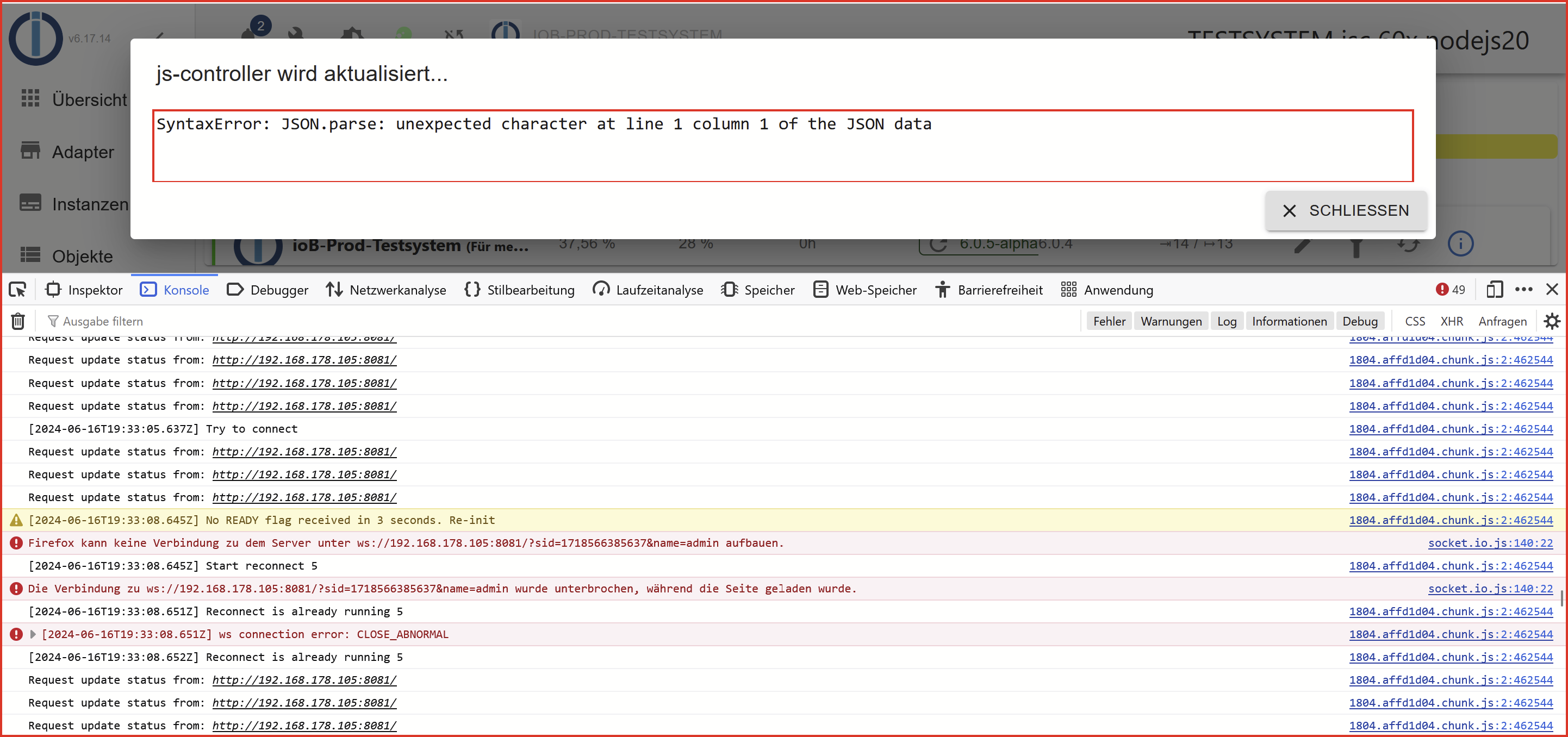

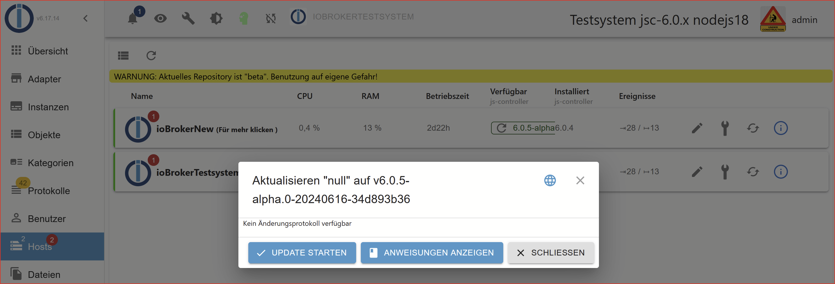

                                      Update von meinem Testsystem1 Master-Slave System) auf js-controller 6.0.5:
                                      Im Admin sieht es so aus:
                                      Das hier meldet der Worx Adapter nach dem Update

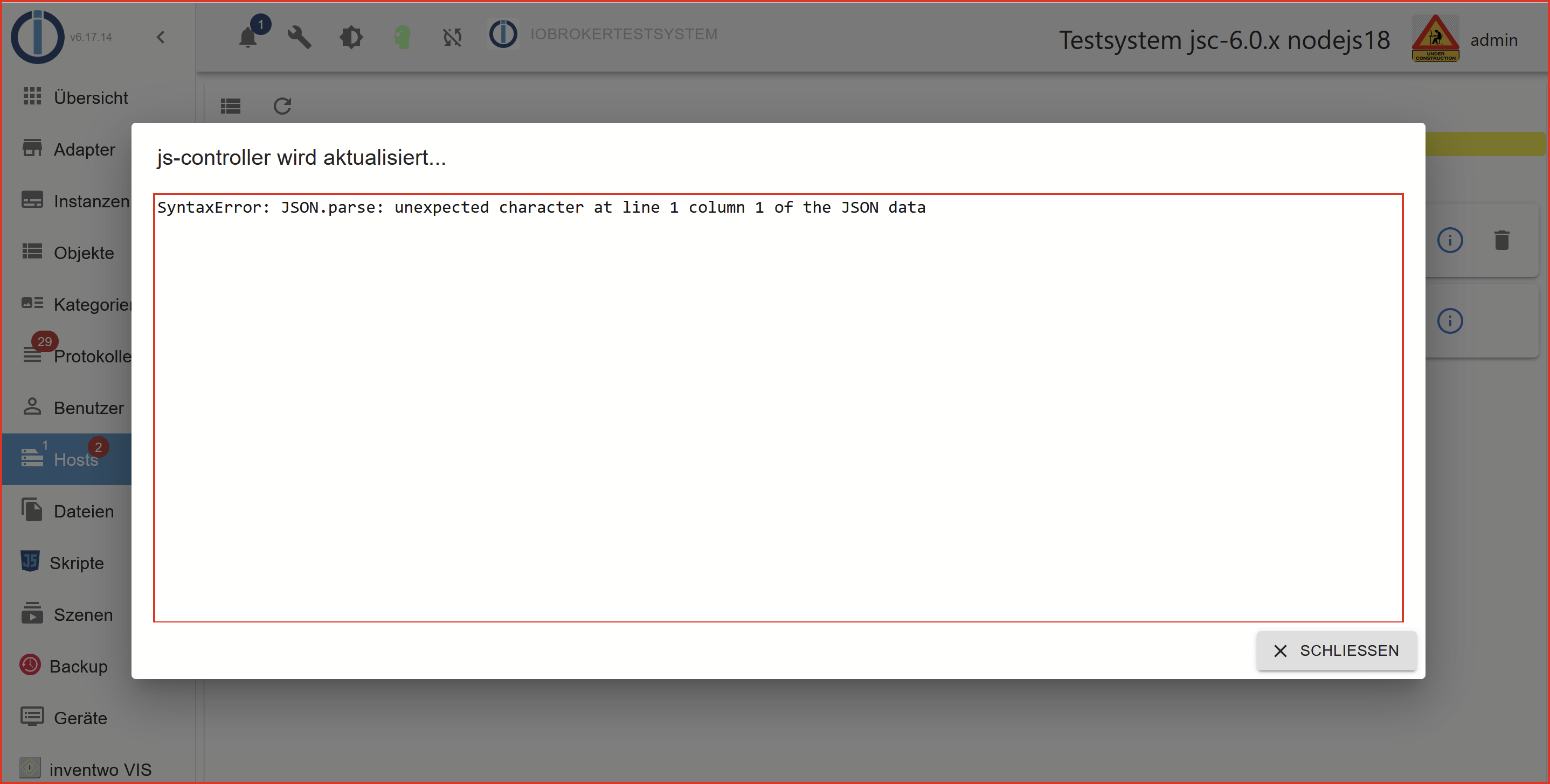

                                      Update vom Slave über Admin. Es kommt wieder die Meldung
                                      In der Browserconsole sehe ich nichts auffällgies:

                                      Request update status from: http://192.168.178.77:8081/ console.ts:40:19
                                      Update Testsystem2 (SingleHost)
                                      Auch die Meldung
                                      Output Browserconsole vom ganzen Updateprozess:
                                      iobroker.admin@6.17.14 1486.79b921ab.chunk.js:1:295856
                                      [2024-06-16T19:30:39.690Z] Try to connect 1804.affd1d04.chunk.js:2:462544
                                      Stored version: , new version: 6.17.14 1804.affd1d04.chunk.js:2:462544
                                      Connected: true 1804.affd1d04.chunk.js:2:462544
                                      Translate: esphome 1804.affd1d04.chunk.js:2:462544
                                      Translate: time 1804.affd1d04.chunk.js:2:462544
                                      Request update status from: http://192.168.178.105:8081/ 8 1804.affd1d04.chunk.js:2:462544
                                      [2024-06-16T19:31:06.567Z] ws connection error: CLOSE_ABNORMAL 1804.affd1d04.chunk.js:2:462544
                                      [2024-06-16T19:31:06.568Z] Start reconnect 0 1804.affd1d04.chunk.js:2:462544
                                      [2024-06-16T19:31:06.610Z] Try to connect 1804.affd1d04.chunk.js:2:462544
                                      Request update status from: http://192.168.178.105:8081/ 2 1804.affd1d04.chunk.js:2:462544
                                      Firefox kann keine Verbindung zu dem Server unter ws://192.168.178.105:8081/?sid=1718566266610&name=admin aufbauen. socket.io.js:140:22
                                      [2024-06-16T19:31:08.910Z] Start reconnect 1 1804.affd1d04.chunk.js:2:462544
                                      [2024-06-16T19:31:08.910Z] ws connection error: CLOSE_ABNORMAL 1804.affd1d04.chunk.js:2:462544
                                      [2024-06-16T19:31:08.910Z] Reconnect is already running 1 1804.affd1d04.chunk.js:2:462544
                                      Request update status from: http://192.168.178.105:8081/ 1804.affd1d04.chunk.js:2:462544
                                      [2024-06-16T19:31:09.914Z] Try to connect 1804.affd1d04.chunk.js:2:462544
                                      Source-Map-Fehler: Error: NetworkError when attempting to fetch resource.
                                      Ressourcen-Adresse: http://192.168.178.105:8081/static/js/1804.affd1d04.chunk.js
                                      Source-Map-Adresse: 1804.affd1d04.chunk.js.map
                                      Ressourcen-Adresse: http://192.168.178.105:8081/static/js/1486.79b921ab.chunk.js
                                      Source-Map-Adresse: 1486.79b921ab.chunk.js.map
                                      Firefox kann keine Verbindung zu dem Server unter ws://192.168.178.105:8081/?sid=1718566269915&name=admin aufbauen. socket.io.js:140:22
                                      [2024-06-16T19:31:11.993Z] Start reconnect 2 1804.affd1d04.chunk.js:2:462544
                                      [2024-06-16T19:31:11.994Z] ws connection error: CLOSE_ABNORMAL 1804.affd1d04.chunk.js:2:462544
                                      [2024-06-16T19:31:11.995Z] Reconnect is already running 2 1804.affd1d04.chunk.js:2:462544
                                      [2024-06-16T19:31:14.006Z] Try to connect 1804.affd1d04.chunk.js:2:462544
                                      Firefox kann keine Verbindung zu dem Server unter ws://192.168.178.105:8081/?sid=1718566274007&name=admin aufbauen. socket.io.js:140:22
                                      [2024-06-16T19:31:16.075Z] Start reconnect 3 1804.affd1d04.chunk.js:2:462544
                                      [2024-06-16T19:31:16.076Z] ws connection error: CLOSE_ABNORMAL 1804.affd1d04.chunk.js:2:462544
                                      [2024-06-16T19:31:16.076Z] Reconnect is already running 3 1804.affd1d04.chunk.js:2:462544
                                      [2024-06-16T19:31:19.089Z] Try to connect 1804.affd1d04.chunk.js:2:462544
                                      Firefox kann keine Verbindung zu dem Server unter ws://192.168.178.105:8081/?sid=1718566279090&name=admin aufbauen. socket.io.js:140:22
                                      [2024-06-16T19:31:19.109Z] Start reconnect 4 1804.affd1d04.chunk.js:2:462544
                                      [2024-06-16T19:31:19.110Z] ws connection error: CLOSE_ABNORMAL 1804.affd1d04.chunk.js:2:462544
                                      [2024-06-16T19:31:19.111Z] Reconnect is already running 4 1804.affd1d04.chunk.js:2:462544
                                      [2024-06-16T19:31:23.119Z] Try to connect 1804.affd1d04.chunk.js:2:462544
                                      Firefox kann keine Verbindung zu dem Server unter ws://192.168.178.105:8081/?sid=1718566283120&name=admin aufbauen. socket.io.js:140:22
                                      [2024-06-16T19:31:23.151Z] Start reconnect 5 1804.affd1d04.chunk.js:2:462544
                                      [2024-06-16T19:31:23.152Z] ws connection error: CLOSE_ABNORMAL 1804.affd1d04.chunk.js:2:462544
                                      [2024-06-16T19:31:23.152Z] Reconnect is already running 5 1804.affd1d04.chunk.js:2:462544
                                      [2024-06-16T19:31:28.154Z] Try to connect 1804.affd1d04.chunk.js:2:462544
                                      Firefox kann keine Verbindung zu dem Server unter ws://192.168.178.105:8081/?sid=1718566288155&name=admin aufbauen. socket.io.js:140:22
                                      [2024-06-16T19:31:28.179Z] Start reconnect 5 1804.affd1d04.chunk.js:2:462544
                                      [2024-06-16T19:31:28.180Z] ws connection error: CLOSE_ABNORMAL 1804.affd1d04.chunk.js:2:462544
                                      [2024-06-16T19:31:28.180Z] Reconnect is already running 5 1804.affd1d04.chunk.js:2:462544
                                      foxriver76 2 Replies Last reply Reply Quote 0
