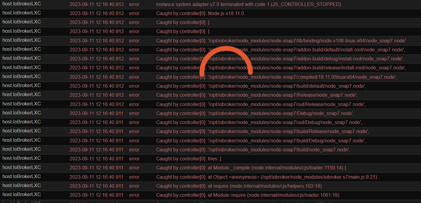

    Hallo ich wollte von node 16 auf 18 hochgehen.
    ich bin nach dieser Anleitung vorgegangen.
    Ich bekomme dann diese Fehlermeldung
    ich habe dann folgendes probiert.
    cd /opt/iobroker/node_modules/iobroker.s7
    npm install --production
    dann bekomme ich folgende Fehlermeldungen

    hoffe mir kann jemand helfen
    • J Offline
      Jacke
      hier einmal der komplette log
      host.IoBrokerLXC
      2023-09-11 12:28:12.449	error	instance system.adapter.s7.0 terminated with code 1 (JS_CONTROLLER_STOPPED)

      • J Jacke
        host.IoBrokerLXC

        host.IoBrokerLXC
        2023-09-11 12:27:52.329	error	Caught by controller[0]: → /opt/iobroker/node_modules/node-snap7/build/default/node_snap7.node
        host.IoBrokerLXC
        2023-09-11 12:27:52.329	error	Caught by controller[0]: → /opt/iobroker/node_modules/node-snap7/Release/node_snap7.node
        host.IoBrokerLXC
        2023-09-11 12:27:52.329	error	Caught by controller[0]: → /opt/iobroker/node_modules/node-snap7/out/Release/node_snap7.node
        host.IoBrokerLXC
        2023-09-11 12:27:52.329	error	Caught by controller[0]: → /opt/iobroker/node_modules/node-snap7/Debug/node_snap7.node
        host.IoBrokerLXC
        2023-09-11 12:27:52.329	error	Caught by controller[0]: → /opt/iobroker/node_modules/node-snap7/out/Debug/node_snap7.node
        host.IoBrokerLXC
        2023-09-11 12:27:52.329	error	Caught by controller[0]: → /opt/iobroker/node_modules/node-snap7/build/Release/node_snap7.node
        host.IoBrokerLXC
        2023-09-11 12:27:52.329	error	Caught by controller[0]: → /opt/iobroker/node_modules/node-snap7/build/Debug/node_snap7.node
        host.IoBrokerLXC
        2023-09-11 12:27:52.329	error	Caught by controller[0]: → /opt/iobroker/node_modules/node-snap7/build/node_snap7.node
        host.IoBrokerLXC
        2023-09-11 12:27:52.329	error	Caught by controller[0]: Error: Could not locate the bindings file. Tried:
        host.IoBrokerLXC
        2023-09-11 12:27:52.329	error	Caught by controller[0]: ^
        host.IoBrokerLXC
        2023-09-11 12:27:52.329	error	Caught by controller[0]: throw err;
        host.IoBrokerLXC
        2023-09-11 12:27:52.328	error	Caught by controller[0]: /opt/iobroker/node_modules/bindings/bindings.js:135
        host.IoBrokerLXC
        2023-09-11 12:27:49.632	error	iobroker npm-rebuild: Rebuilding native modules failed
        host.IoBrokerLXC
        2023-09-11 12:27:42.267	error	instance system.adapter.s7.0 terminated with code 1 (JS_CONTROLLER_STOPPED)
        host.IoBrokerLXC
        2023-09-11 12:27:42.267	error	Caught by controller[0]: Node.js v18.11.0
        host.IoBrokerLXC
        2023-09-11 12:27:42.267	error	Caught by controller[0]: }
        host.IoBrokerLXC
        2023-09-11 12:27:42.266	error	Caught by controller[0]: ]
        host.IoBrokerLXC
        2023-09-11 12:27:42.266	error	Caught by controller[0]: '/opt/iobroker/node_modules/node-snap7/lib/binding/node-v108-linux-x64/node_snap7.node'
        host.IoBrokerLXC
        2023-09-11 12:27:42.266	error	Caught by controller[0]: '/opt/iobroker/node_modules/node-snap7/addon-build/default/install-root/node_snap7.node',
        host.IoBrokerLXC
        2023-09-11 12:27:42.266	error	Caught by controller[0]: '/opt/iobroker/node_modules/node-snap7/addon-build/debug/install-root/node_snap7.node',
        host.IoBrokerLXC
        2023-09-11 12:27:42.266	error	Caught by controller[0]: '/opt/iobroker/node_modules/node-snap7/addon-build/release/install-root/node_snap7.node',
        host.IoBrokerLXC
        2023-09-11 12:27:42.266	error	Caught by controller[0]: '/opt/iobroker/node_modules/node-snap7/compiled/18.11.0/linux/x64/node_snap7.node',
        host.IoBrokerLXC
        2023-09-11 12:27:42.266	error	Caught by controller[0]: '/opt/iobroker/node_modules/node-snap7/build/default/node_snap7.node',
        host.IoBrokerLXC
        2023-09-11 12:27:42.266	error	Caught by controller[0]: '/opt/iobroker/node_modules/node-snap7/Release/node_snap7.node',
        host.IoBrokerLXC
        2023-09-11 12:27:42.266	error	Caught by controller[0]: '/opt/iobroker/node_modules/node-snap7/out/Release/node_snap7.node',
        host.IoBrokerLXC
        2023-09-11 12:27:42.266	error	Caught by controller[0]: '/opt/iobroker/node_modules/node-snap7/Debug/node_snap7.node',
        host.IoBrokerLXC
        2023-09-11 12:27:42.266	error	Caught by controller[0]: '/opt/iobroker/node_modules/node-snap7/out/Debug/node_snap7.node',
        host.IoBrokerLXC
        2023-09-11 12:27:42.266	error	Caught by controller[0]: '/opt/iobroker/node_modules/node-snap7/build/Release/node_snap7.node',
        host.IoBrokerLXC
        2023-09-11 12:27:42.266	error	Caught by controller[0]: '/opt/iobroker/node_modules/node-snap7/build/Debug/node_snap7.node',
        host.IoBrokerLXC
        2023-09-11 12:27:42.266	error	Caught by controller[0]: '/opt/iobroker/node_modules/node-snap7/build/node_snap7.node',
        host.IoBrokerLXC
        2023-09-11 12:27:42.266	error	Caught by controller[0]: tries: [
        host.IoBrokerLXC
        2023-09-11 12:27:42.266	error	Caught by controller[0]: at Module._compile (node:internal/modules/cjs/loader:1159:14) {
        host.IoBrokerLXC
        2023-09-11 12:27:42.266	error	Caught by controller[0]: at Object.<anonymous> (/opt/iobroker/node_modules/iobroker.s7/main.js:9:21)
        host.IoBrokerLXC
        2023-09-11 12:27:42.266	error	Caught by controller[0]: at require (node:internal/modules/cjs/helpers:103:18)
        host.IoBrokerLXC
        2023-09-11 12:27:42.266	error	Caught by controller[0]: at Module.require (node:internal/modules/cjs/loader:1061:19)
        host.IoBrokerLXC
        2023-09-11 12:27:42.266	error	Caught by controller[0]: at Module._load (node:internal/modules/cjs/loader:878:12)
        host.IoBrokerLXC
        2023-09-11 12:27:42.266	error	Caught by controller[0]: at Module.load (node:internal/modules/cjs/loader:1037:32)
        host.IoBrokerLXC
        2023-09-11 12:27:42.266	error	Caught by controller[0]: at Module._extensions..js (node:internal/modules/cjs/loader:1213:10)
        host.IoBrokerLXC
        host.IoBrokerLXC
        2023-09-11 12:27:42.266	error	Caught by controller[0]: at Object.<anonymous> (/opt/iobroker/node_modules/node-snap7/lib/node-snap7.js:8:45)
        host.IoBrokerLXC
        2023-09-11 12:27:42.266	error	Caught by controller[0]: at bindings (/opt/iobroker/node_modules/bindings/bindings.js:126:9)
        host.IoBrokerLXC
        2023-09-11 12:27:42.266	error	Caught by controller[0]: → /opt/iobroker/node_modules/node-snap7/lib/binding/node-v108-linux-x64/node_snap7.node
        host.IoBrokerLXC
        2023-09-11 12:27:42.266	error	Caught by controller[0]: → /opt/iobroker/node_modules/node-snap7/addon-build/default/install-root/node_snap7.node
        host.IoBrokerLXC
        2023-09-11 12:27:42.266	error	Caught by controller[0]: → /opt/iobroker/node_modules/node-snap7/addon-build/debug/install-root/node_snap7.node
        host.IoBrokerLXC
        2023-09-11 12:27:42.266	error	Caught by controller[0]: → /opt/iobroker/node_modules/node-snap7/addon-build/release/install-root/node_snap7.node
        host.IoBrokerLXC
        2023-09-11 12:27:42.266	error	Caught by controller[0]: → /opt/iobroker/node_modules/node-snap7/compiled/18.11.0/linux/x64/node_snap7.node
        host.IoBrokerLXC
        2023-09-11 12:27:42.266	error	Caught by controller[0]: → /opt/iobroker/node_modules/node-snap7/build/default/node_snap7.node
        host.IoBrokerLXC
        2023-09-11 12:27:42.266	error	Caught by controller[0]: → /opt/iobroker/node_modules/node-snap7/Release/node_snap7.node
        host.IoBrokerLXC
        2023-09-11 12:27:42.266	error	Caught by controller[0]: → /opt/iobroker/node_modules/node-snap7/out/Release/node_snap7.node
        host.IoBrokerLXC
        2023-09-11 12:27:42.266	error	Caught by controller[0]: → /opt/iobroker/node_modules/node-snap7/Debug/node_snap7.node
        host.IoBrokerLXC
        2023-09-11 12:27:42.266	error	Caught by controller[0]: → /opt/iobroker/node_modules/node-snap7/out/Debug/node_snap7.node
        host.IoBrokerLXC
        2023-09-11 12:27:42.265	error	Caught by controller[0]: → /opt/iobroker/node_modules/node-snap7/build/Release/node_snap7.node
        host.IoBrokerLXC
        2023-09-11 12:27:42.265	error	Caught by controller[0]: → /opt/iobroker/node_modules/node-snap7/build/Debug/node_snap7.node
        host.IoBrokerLXC
        2023-09-11 12:27:42.265	error	Caught by controller[0]: → /opt/iobroker/node_modules/node-snap7/build/node_snap7.node
        host.IoBrokerLXC
        2023-09-11 12:27:42.265	error	Caught by controller[0]: Error: Could not locate the bindings file. Tried:
        host.IoBrokerLXC
        2023-09-11 12:27:42.265	error	Caught by controller[0]: ^
        host.IoBrokerLXC
        2023-09-11 12:27:42.265	error	Caught by controller[0]: throw err;
        host.IoBrokerLXC
        2023-09-11 12:27:42.265	error	Caught by controller[0]: /opt/iobroker/node_modules/bindings/bindings.js:135

                So sieht danach der Fehler im Log aus
                host.IoBrokerLXC
                2023-09-11 17:41:24.854	error	instance system.adapter.s7.0 terminated with code 1 (JS_CONTROLLER_STOPPED)
                host.IoBrokerLXC
                2023-09-11 17:41:24.854	error	Caught by controller[0]: Node.js v18.17.1
                host.IoBrokerLXC
                2023-09-11 17:41:24.854	error	Caught by controller[0]: }
                host.IoBrokerLXC
                2023-09-11 17:41:24.854	error	Caught by controller[0]: ]
                host.IoBrokerLXC
                2023-09-11 17:41:24.854	error	Caught by controller[0]: '/opt/iobroker/node_modules/node-snap7/lib/binding/node-v108-linux-x64/node_snap7.node'
                host.IoBrokerLXC
                2023-09-11 17:41:24.854	error	Caught by controller[0]: '/opt/iobroker/node_modules/node-snap7/addon-build/default/install-root/node_snap7.node',
                host.IoBrokerLXC
                2023-09-11 17:41:24.854	error	Caught by controller[0]: '/opt/iobroker/node_modules/node-snap7/addon-build/debug/install-root/node_snap7.node',
                host.IoBrokerLXC
                2023-09-11 17:41:24.854	error	Caught by controller[0]: '/opt/iobroker/node_modules/node-snap7/addon-build/release/install-root/node_snap7.node',
                host.IoBrokerLXC
                2023-09-11 17:41:24.854	error	Caught by controller[0]: '/opt/iobroker/node_modules/node-snap7/compiled/18.17.1/linux/x64/node_snap7.node',
                host.IoBrokerLXC
                2023-09-11 17:41:24.854	error	Caught by controller[0]: '/opt/iobroker/node_modules/node-snap7/build/default/node_snap7.node',
                host.IoBrokerLXC
                2023-09-11 17:41:24.854	error	Caught by controller[0]: '/opt/iobroker/node_modules/node-snap7/Release/node_snap7.node',
                host.IoBrokerLXC
                2023-09-11 17:41:24.854	error	Caught by controller[0]: '/opt/iobroker/node_modules/node-snap7/out/Release/node_snap7.node',
                host.IoBrokerLXC
                2023-09-11 17:41:24.854	error	Caught by controller[0]: '/opt/iobroker/node_modules/node-snap7/Debug/node_snap7.node',
                host.IoBrokerLXC
                2023-09-11 17:41:24.854	error	Caught by controller[0]: '/opt/iobroker/node_modules/node-snap7/out/Debug/node_snap7.node',
                host.IoBrokerLXC
                2023-09-11 17:41:24.854	error	Caught by controller[0]: '/opt/iobroker/node_modules/node-snap7/build/Release/node_snap7.node',
                host.IoBrokerLXC
                2023-09-11 17:41:24.853	error	Caught by controller[0]: '/opt/iobroker/node_modules/node-snap7/build/Debug/node_snap7.node',
                host.IoBrokerLXC
                2023-09-11 17:41:24.853	error	Caught by controller[0]: '/opt/iobroker/node_modules/node-snap7/build/node_snap7.node',
                host.IoBrokerLXC
                2023-09-11 17:41:24.853	error	Caught by controller[0]: tries: [
                host.IoBrokerLXC
                2023-09-11 17:41:24.853	error	Caught by controller[0]: at Module._compile (node:internal/modules/cjs/loader:1256:14) {
                host.IoBrokerLXC
                2023-09-11 17:41:24.853	error	Caught by controller[0]: at Object.<anonymous> (/opt/iobroker/node_modules/iobroker.s7/main.js:9:21)
                host.IoBrokerLXC
                2023-09-11 17:41:24.853	error	Caught by controller[0]: at require (node:internal/modules/cjs/helpers:121:18)
                host.IoBrokerLXC
                2023-09-11 17:41:24.853	error	Caught by controller[0]: at Module.require (node:internal/modules/cjs/loader:1143:19)
                host.IoBrokerLXC
                2023-09-11 17:41:24.853	error	Caught by controller[0]: at Module._load (node:internal/modules/cjs/loader:960:12)
                host.IoBrokerLXC
                2023-09-11 17:41:24.853	error	Caught by controller[0]: at Module.load (node:internal/modules/cjs/loader:1119:32)
                host.IoBrokerLXC
                2023-09-11 17:41:24.853	error	Caught by controller[0]: at Module._extensions..js (node:internal/modules/cjs/loader:1310:10)
                host.IoBrokerLXC
                host.IoBrokerLXC
                2023-09-11 17:41:24.853	error	Caught by controller[0]: at Object.<anonymous> (/opt/iobroker/node_modules/node-snap7/lib/node-snap7.js:8:45)
                host.IoBrokerLXC
                2023-09-11 17:41:24.853	error	Caught by controller[0]: at bindings (/opt/iobroker/node_modules/bindings/bindings.js:126:9)
                host.IoBrokerLXC
                2023-09-11 17:41:24.853	error	Caught by controller[0]: → /opt/iobroker/node_modules/node-snap7/lib/binding/node-v108-linux-x64/node_snap7.node
                host.IoBrokerLXC
                2023-09-11 17:41:24.853	error	Caught by controller[0]: → /opt/iobroker/node_modules/node-snap7/addon-build/default/install-root/node_snap7.node
                host.IoBrokerLXC
                2023-09-11 17:41:24.853	error	Caught by controller[0]: → /opt/iobroker/node_modules/node-snap7/addon-build/debug/install-root/node_snap7.node
                host.IoBrokerLXC
                2023-09-11 17:41:24.853	error	Caught by controller[0]: → /opt/iobroker/node_modules/node-snap7/addon-build/release/install-root/node_snap7.node
                host.IoBrokerLXC
                2023-09-11 17:41:24.853	error	Caught by controller[0]: → /opt/iobroker/node_modules/node-snap7/compiled/18.17.1/linux/x64/node_snap7.node
                host.IoBrokerLXC
                2023-09-11 17:41:24.853	error	Caught by controller[0]: → /opt/iobroker/node_modules/node-snap7/build/default/node_snap7.node
                host.IoBrokerLXC
                2023-09-11 17:41:24.852	error	Caught by controller[0]: → /opt/iobroker/node_modules/node-snap7/Release/node_snap7.node
                host.IoBrokerLXC
                2023-09-11 17:41:24.852	error	Caught by controller[0]: → /opt/iobroker/node_modules/node-snap7/out/Release/node_snap7.node
                host.IoBrokerLXC
                2023-09-11 17:41:24.852	error	Caught by controller[0]: → /opt/iobroker/node_modules/node-snap7/Debug/node_snap7.node
                host.IoBrokerLXC
                2023-09-11 17:41:24.852	error	Caught by controller[0]: → /opt/iobroker/node_modules/node-snap7/out/Debug/node_snap7.node
                host.IoBrokerLXC
                2023-09-11 17:41:24.852	error	Caught by controller[0]: → /opt/iobroker/node_modules/node-snap7/build/Release/node_snap7.node
                host.IoBrokerLXC
                2023-09-11 17:41:24.852	error	Caught by controller[0]: → /opt/iobroker/node_modules/node-snap7/build/Debug/node_snap7.node
                host.IoBrokerLXC
                2023-09-11 17:41:24.852	error	Caught by controller[0]: → /opt/iobroker/node_modules/node-snap7/build/node_snap7.node
                host.IoBrokerLXC
                2023-09-11 17:41:24.852	error	Caught by controller[0]: Error: Could not locate the bindings file. Tried:
                host.IoBrokerLXC
                2023-09-11 17:41:24.852	error	Caught by controller[0]: ^
                host.IoBrokerLXC
                2023-09-11 17:41:24.852	error	Caught by controller[0]: throw err;
                host.IoBrokerLXC
                2023-09-11 17:41:24.852	error	Caught by controller[0]: /opt/iobroker/node_modules/bindings/bindings.js:135
                host.IoBrokerLXC
                2023-09-11 17:41:22.039	error	iobroker npm-rebuild: Rebuilding native modules failed
                host.IoBrokerLXC
                2023-09-11 17:41:13.912	error	instance system.adapter.s7.0 terminated with code 1 (JS_CONTROLLER_STOPPED)
                host.IoBrokerLXC
                2023-09-11 17:41:13.912	error	Caught by controller[0]: Node.js v18.17.1
                host.IoBrokerLXC
                2023-09-11 17:41:13.912	error	Caught by controller[0]: }
                host.IoBrokerLXC
                2023-09-11 17:41:13.912	error	Caught by controller[0]: ]
                host.IoBrokerLXC
                2023-09-11 17:41:13.912	error	Caught by controller[0]: '/opt/iobroker/node_modules/node-snap7/lib/binding/node-v108-linux-x64/node_snap7.node'
                host.IoBrokerLXC
                2023-09-11 17:41:13.912	error	Caught by controller[0]: '/opt/iobroker/node_modules/node-snap7/addon-build/default/install-root/node_snap7.node',
                host.IoBrokerLXC
                2023-09-11 17:41:13.912	error	Caught by controller[0]: '/opt/iobroker/node_modules/node-snap7/addon-build/debug/install-root/node_snap7.node',
                host.IoBrokerLXC
                2023-09-11 17:41:13.912	error	Caught by controller[0]: '/opt/iobroker/node_modules/node-snap7/addon-build/release/install-root/node_snap7.node',
                host.IoBrokerLXC
                2023-09-11 17:41:13.912	error	Caught by controller[0]: '/opt/iobroker/node_modules/node-snap7/compiled/18.17.1/linux/x64/node_snap7.node',
                host.IoBrokerLXC
                2023-09-11 17:41:13.912	error	Caught by controller[0]: '/opt/iobroker/node_modules/node-snap7/build/default/node_snap7.node',
                host.IoBrokerLXC
                2023-09-11 17:41:13.912	error	Caught by controller[0]: '/opt/iobroker/node_modules/node-snap7/Release/node_snap7.node',
                host.IoBrokerLXC
                2023-09-11 17:41:13.912	error	Caught by controller[0]: '/opt/iobroker/node_modules/node-snap7/out/Release/node_snap7.node',
                host.IoBrokerLXC
                2023-09-11 17:41:13.912	error	Caught by controller[0]: '/opt/iobroker/node_modules/node-snap7/Debug/node_snap7.node',
                host.IoBrokerLXC
                2023-09-11 17:41:13.912	error	Caught by controller[0]: '/opt/iobroker/node_modules/node-snap7/out/Debug/node_snap7.node',
                host.IoBrokerLXC
                2023-09-11 17:41:13.912	error	Caught by controller[0]: '/opt/iobroker/node_modules/node-snap7/build/Release/node_snap7.node',
                host.IoBrokerLXC
                2023-09-11 17:41:13.912	error	Caught by controller[0]: '/opt/iobroker/node_modules/node-snap7/build/Debug/node_snap7.node',
                host.IoBrokerLXC
                2023-09-11 17:41:13.911	error	Caught by controller[0]: '/opt/iobroker/node_modules/node-snap7/build/node_snap7.node',
                host.IoBrokerLXC
                2023-09-11 17:41:13.911	error	Caught by controller[0]: tries: [
                host.IoBrokerLXC
                2023-09-11 17:41:13.911	error	Caught by controller[0]: at Module._compile (node:internal/modules/cjs/loader:1256:14) {
                host.IoBrokerLXC
                2023-09-11 17:41:13.911	error	Caught by controller[0]: at Object.<anonymous> (/opt/iobroker/node_modules/iobroker.s7/main.js:9:21)
                host.IoBrokerLXC
                2023-09-11 17:41:13.911	error	Caught by controller[0]: at require (node:internal/modules/cjs/helpers:121:18)
                host.IoBrokerLXC
                2023-09-11 17:41:13.911	error	Caught by controller[0]: at Module.require (node:internal/modules/cjs/loader:1143:19)
                host.IoBrokerLXC
                2023-09-11 17:41:13.911	error	Caught by controller[0]: at Module._load (node:internal/modules/cjs/loader:960:12)
                host.IoBrokerLXC
                2023-09-11 17:41:13.911	error	Caught by controller[0]: at Module.load (node:internal/modules/cjs/loader:1119:32)
                host.IoBrokerLXC
                2023-09-11 17:41:13.911	error	Caught by controller[0]: at Module._extensions..js (node:internal/modules/cjs/loader:1310:10)
                host.IoBrokerLXC
                host.IoBrokerLXC
                2023-09-11 17:41:13.911	error	Caught by controller[0]: at Object.<anonymous> (/opt/iobroker/node_modules/node-snap7/lib/node-snap7.js:8:45)
                host.IoBrokerLXC
                2023-09-11 17:41:13.911	error	Caught by controller[0]: at bindings (/opt/iobroker/node_modules/bindings/bindings.js:126:9)
                host.IoBrokerLXC
                2023-09-11 17:41:13.911	error	Caught by controller[0]: → /opt/iobroker/node_modules/node-snap7/lib/binding/node-v108-linux-x64/node_snap7.node
                host.IoBrokerLXC
                2023-09-11 17:41:13.911	error	Caught by controller[0]: → /opt/iobroker/node_modules/node-snap7/addon-build/default/install-root/node_snap7.node
                host.IoBrokerLXC
                2023-09-11 17:41:13.911	error	Caught by controller[0]: → /opt/iobroker/node_modules/node-snap7/addon-build/debug/install-root/node_snap7.node
                host.IoBrokerLXC
                2023-09-11 17:41:13.911	error	Caught by controller[0]: → /opt/iobroker/node_modules/node-snap7/addon-build/release/install-root/node_snap7.node
                host.IoBrokerLXC
                2023-09-11 17:41:13.911	error	Caught by controller[0]: → /opt/iobroker/node_modules/node-snap7/compiled/18.17.1/linux/x64/node_snap7.node
                host.IoBrokerLXC
                2023-09-11 17:41:13.911	error	Caught by controller[0]: → /opt/iobroker/node_modules/node-snap7/build/default/node_snap7.node
                host.IoBrokerLXC
                2023-09-11 17:41:13.911	error	Caught by controller[0]: → /opt/iobroker/node_modules/node-snap7/Release/node_snap7.node
                host.IoBrokerLXC
                2023-09-11 17:41:13.911	error	Caught by controller[0]: → /opt/iobroker/node_modules/node-snap7/out/Release/node_snap7.node
                host.IoBrokerLXC
                2023-09-11 17:41:13.911	error	Caught by controller[0]: → /opt/iobroker/node_modules/node-snap7/Debug/node_snap7.node
                host.IoBrokerLXC
                2023-09-11 17:41:13.911	error	Caught by controller[0]: → /opt/iobroker/node_modules/node-snap7/out/Debug/node_snap7.node
                host.IoBrokerLXC
                2023-09-11 17:41:13.911	error	Caught by controller[0]: → /opt/iobroker/node_modules/node-snap7/build/Release/node_snap7.node
                host.IoBrokerLXC
                2023-09-11 17:41:13.911	error	Caught by controller[0]: → /opt/iobroker/node_modules/node-snap7/build/Debug/node_snap7.node
                host.IoBrokerLXC
                2023-09-11 17:41:13.911	error	Caught by controller[0]: → /opt/iobroker/node_modules/node-snap7/build/node_snap7.node
                host.IoBrokerLXC
                2023-09-11 17:41:13.911	error	Caught by controller[0]: Error: Could not locate the bindings file. Tried:
                host.IoBrokerLXC
                2023-09-11 17:41:13.911	error	Caught by controller[0]: ^
                host.IoBrokerLXC
                2023-09-11 17:41:13.911	error	Caught by controller[0]: throw err;
                host.IoBrokerLXC
                2023-09-11 17:41:13.911	error	Caught by controller[0]: /opt/iobroker/node_modules/bindings/bindings.js:135
                host.IoBrokerLXC
                2023-09-11 17:41:11.932	error	iobroker npm-rebuild: Rebuilding native modules failed
                host.IoBrokerLXC
                2023-09-11 17:41:01.913	error	instance system.adapter.s7.0 terminated with code 1 (JS_CONTROLLER_STOPPED)
                host.IoBrokerLXC
                2023-09-11 17:41:01.913	error	Caught by controller[1]: Node.js v18.17.1
                host.IoBrokerLXC
                2023-09-11 17:41:01.913	error	Caught by controller[0]: }
                host.IoBrokerLXC
                2023-09-11 17:41:01.913	error	Caught by controller[0]: code: 'ERR_DLOPEN_FAILED'
                host.IoBrokerLXC
                2023-09-11 17:41:01.913	error	Caught by controller[0]: at Module.load (node:internal/modules/cjs/loader:1119:32) {
                host.IoBrokerLXC
                2023-09-11 17:41:01.913	error	Caught by controller[0]: at Module._extensions..js (node:internal/modules/cjs/loader:1310:10)
                host.IoBrokerLXC
                2023-09-11 17:41:01.913	error	Caught by controller[0]: at Module._compile (node:internal/modules/cjs/loader:1256:14)
                host.IoBrokerLXC
                2023-09-11 17:41:01.913	error	Caught by controller[0]: at Object.<anonymous> (/opt/iobroker/node_modules/node-snap7/lib/node-snap7.js:8:45)
                host.IoBrokerLXC
                2023-09-11 17:41:01.913	error	Caught by controller[0]: at bindings (/opt/iobroker/node_modules/bindings/bindings.js:112:48)
                host.IoBrokerLXC
                2023-09-11 17:41:01.913	error	Caught by controller[0]: at require (node:internal/modules/cjs/helpers:121:18)
                host.IoBrokerLXC
                2023-09-11 17:41:01.913	error	Caught by controller[0]: at Module.require (node:internal/modules/cjs/loader:1143:19)
                host.IoBrokerLXC
                2023-09-11 17:41:01.913	error	Caught by controller[0]: at Module._load (node:internal/modules/cjs/loader:960:12)
                host.IoBrokerLXC
                host.IoBrokerLXC
                2023-09-11 17:41:01.913	error	Caught by controller[0]: at Module._extensions..node (node:internal/modules/cjs/loader:1340:18)
                host.IoBrokerLXC
                2023-09-11 17:41:01.913	error	Caught by controller[0]: the module (for instance, using `npm rebuild` or `npm install`).
                host.IoBrokerLXC
                2023-09-11 17:41:01.913	error	Caught by controller[0]: NODE_MODULE_VERSION 108. Please try re-compiling or re-installing
                host.IoBrokerLXC
                2023-09-11 17:41:01.913	error	Caught by controller[0]: NODE_MODULE_VERSION 93. This version of Node.js requires
                host.IoBrokerLXC
                2023-09-11 17:41:01.913	error	Caught by controller[0]: was compiled against a different Node.js version using
                host.IoBrokerLXC
                2023-09-11 17:41:01.913	error	Caught by controller[0]: Error: The module '/opt/iobroker/node_modules/node-snap7/build/Release/node_snap7.node'
                host.IoBrokerLXC
                2023-09-11 17:41:01.913	error	Caught by controller[0]: ^
                host.IoBrokerLXC
                2023-09-11 17:41:01.913	error	Caught by controller[0]: throw e;
                host.IoBrokerLXC
                2023-09-11 17:41:01.913	error	Caught by controller[0]: /opt/iobroker/node_modules/bindings/bindings.js:121
                host.IoBrokerLXC
                2023-09-11 17:40:59.316	error	iobroker npm-rebuild: Rebuilding native modules failed
                host.IoBrokerLXC
                2023-09-11 17:40:43.510	error	instance system.adapter.s7.0 terminated with code 1 (JS_CONTROLLER_STOPPED)

                2023-09-11 17:40:43.510	error	Caught by controller[0]: Node.js v18.17.1
                host.IoBrokerLXC
                2023-09-11 17:40:43.510	error	Caught by controller[0]: }
                host.IoBrokerLXC
                2023-09-11 17:40:43.510	error	Caught by controller[0]: code: 'ERR_DLOPEN_FAILED'
                host.IoBrokerLXC
                2023-09-11 17:40:43.509	error	Caught by controller[0]: at Module.load (node:internal/modules/cjs/loader:1119:32) {
                host.IoBrokerLXC
                2023-09-11 17:40:43.509	error	Caught by controller[0]: at Module._extensions..js (node:internal/modules/cjs/loader:1310:10)
                host.IoBrokerLXC
                2023-09-11 17:40:43.509	error	Caught by controller[0]: at Module._compile (node:internal/modules/cjs/loader:1256:14)
                host.IoBrokerLXC
                2023-09-11 17:40:43.509	error	Caught by controller[0]: at Object.<anonymous> (/opt/iobroker/node_modules/node-snap7/lib/node-snap7.js:8:45)
                host.IoBrokerLXC
                2023-09-11 17:40:43.509	error	Caught by controller[0]: at bindings (/opt/iobroker/node_modules/bindings/bindings.js:112:48)
                host.IoBrokerLXC
                2023-09-11 17:40:43.509	error	Caught by controller[0]: at require (node:internal/modules/cjs/helpers:121:18)
                host.IoBrokerLXC
                2023-09-11 17:40:43.509	error	Caught by controller[0]: at Module.require (node:internal/modules/cjs/loader:1143:19)
                host.IoBrokerLXC
                2023-09-11 17:40:43.509	error	Caught by controller[0]: at Module._load (node:internal/modules/cjs/loader:960:12)
                host.IoBrokerLXC
                host.IoBrokerLXC
                2023-09-11 17:40:43.509	error	Caught by controller[0]: at Module._extensions..node (node:internal/modules/cjs/loader:1340:18)
                host.IoBrokerLXC
                2023-09-11 17:40:43.509	error	Caught by controller[0]: the module (for instance, using `npm rebuild` or `npm install`).
                host.IoBrokerLXC
                2023-09-11 17:40:43.509	error	Caught by controller[0]: NODE_MODULE_VERSION 108. Please try re-compiling or re-installing
                host.IoBrokerLXC
                2023-09-11 17:40:43.509	error	Caught by controller[0]: NODE_MODULE_VERSION 93. This version of Node.js requires
                host.IoBrokerLXC
                2023-09-11 17:40:43.509	error	Caught by controller[0]: was compiled against a different Node.js version using
                host.IoBrokerLXC
                2023-09-11 17:40:43.509	error	Caught by controller[0]: Error: The module '/opt/iobroker/node_modules/node-snap7/build/Release/node_snap7.node'
                host.IoBrokerLXC
                2023-09-11 17:40:43.509	error	Caught by controller[0]: ^
                host.IoBrokerLXC
                2023-09-11 17:40:43.509	error	Caught by controller[0]: throw e;
                host.IoBrokerLXC
                2023-09-11 17:40:43.509	error	Caught by controller[0]: /opt/iobroker/node_modules/bindings/bindings.js:121
                  host.IoBrokerLXC
                  host.IoBrokerLXC
                  host.IoBrokerLXC
                  host.IoBrokerLXC
                  host.IoBrokerLXC
                  host.IoBrokerLXC
                  host.IoBrokerLXC
                  host.IoBrokerLXC
                  host.IoBrokerLXC
                  host.IoBrokerLXC
                  host.IoBrokerLXC
                  host.IoBrokerLXC
                  host.IoBrokerLXC
                  host.IoBrokerLXC
                  host.IoBrokerLXC
                  host.IoBrokerLXC
                  host.IoBrokerLXC
                  host.IoBrokerLXC
                  host.IoBrokerLXC
                  host.IoBrokerLXC
                  host.IoBrokerLXC
                  host.IoBrokerLXC
                  host.IoBrokerLXC
                  host.IoBrokerLXC
                  host.IoBrokerLXC
                  host.IoBrokerLXC
                  host.IoBrokerLXC
                  host.IoBrokerLXC
                  host.IoBrokerLXC
                  host.IoBrokerLXC
                  host.IoBrokerLXC
                  host.IoBrokerLXC
                  host.IoBrokerLXC
                  host.IoBrokerLXC
                  host.IoBrokerLXC
                  host.IoBrokerLXC
                  host.IoBrokerLXC
                  host.IoBrokerLXC
                  host.IoBrokerLXC
                  host.IoBrokerLXC
                  host.IoBrokerLXC
                  host.IoBrokerLXC
                  host.IoBrokerLXC
                  host.IoBrokerLXC
                  host.IoBrokerLXC
                  host.IoBrokerLXC
                  host.IoBrokerLXC
                  host.IoBrokerLXC
                  host.IoBrokerLXC
                  host.IoBrokerLXC
                  host.IoBrokerLXC
                  host.IoBrokerLXC
                  host.IoBrokerLXC
                  host.IoBrokerLXC
                  host.IoBrokerLXC
                  host.IoBrokerLXC
                  host.IoBrokerLXC
                  host.IoBrokerLXC
                  host.IoBrokerLXC
                  host.IoBrokerLXC
                  host.IoBrokerLXC
                  host.IoBrokerLXC
                  host.IoBrokerLXC
                  host.IoBrokerLXC
                  host.IoBrokerLXC
                  host.IoBrokerLXC
                  host.IoBrokerLXC
                  host.IoBrokerLXC
                  host.IoBrokerLXC
                  host.IoBrokerLXC
                  host.IoBrokerLXC
                  host.IoBrokerLXC
                  host.IoBrokerLXC
                  host.IoBrokerLXC
                  host.IoBrokerLXC
                  host.IoBrokerLXC
                  host.IoBrokerLXC
                  host.IoBrokerLXC
                  host.IoBrokerLXC
                  host.IoBrokerLXC
                  host.IoBrokerLXC
                  host.IoBrokerLXC
                  host.IoBrokerLXC
                  host.IoBrokerLXC
                  host.IoBrokerLXC
                  host.IoBrokerLXC
                  host.IoBrokerLXC
                  host.IoBrokerLXC
                  host.IoBrokerLXC
                  host.IoBrokerLXC
                  host.IoBrokerLXC
                  host.IoBrokerLXC
                  host.IoBrokerLXC
                  host.IoBrokerLXC
                  host.IoBrokerLXC
                  host.IoBrokerLXC
                  host.IoBrokerLXC
                  host.IoBrokerLXC
                  host.IoBrokerLXC
                  host.IoBrokerLXC
                  host.IoBrokerLXC
                  host.IoBrokerLXC
                  host.IoBrokerLXC
                  host.IoBrokerLXC
                  host.IoBrokerLXC
                  host.IoBrokerLXC
                  host.IoBrokerLXC
                  host.IoBrokerLXC
                  host.IoBrokerLXC
                  host.IoBrokerLXC
                  host.IoBrokerLXC
                  host.IoBrokerLXC
                  host.IoBrokerLXC
                  host.IoBrokerLXC
                  host.IoBrokerLXC
                  host.IoBrokerLXC
                  host.IoBrokerLXC
                  host.IoBrokerLXC
                  host.IoBrokerLXC
                  host.IoBrokerLXC
                  host.IoBrokerLXC
                  host.IoBrokerLXC
                  host.IoBrokerLXC
                  host.IoBrokerLXC
                  host.IoBrokerLXC
                  host.IoBrokerLXC
                  host.IoBrokerLXC
                  host.IoBrokerLXC
                  host.IoBrokerLXC
                  host.IoBrokerLXC
                  host.IoBrokerLXC
                  host.IoBrokerLXC
                  host.IoBrokerLXC
                  host.IoBrokerLXC
                  host.IoBrokerLXC
                  host.IoBrokerLXC
                  host.IoBrokerLXC
                  @jacke
                  hirsute ist steinalt und wird nicht mehr aktiv gepflegt.
                  Installier da die aktuelle LTS oder gleich ein Debian. Und dann ohne graphische Oberfläche.

                    @thomas-braun Ich habe den S7 adapter gestoppt und dann gesatrtet gleiches ergebnis.
                    dann Habe ich die ganze Maschiene neu gestartet.
                    Evtl. setze ich ein neues System auf und spiel dann alles über den Backitup Adapter neu ein

                      @jacke
                      Das wird dir vermutlich nichts nutzen, bei mir baut das Ding mit aktuellem nodejs auch nicht mehr. Mit nodes@16 funktioniert es allerdings noch.
                      https://forum.iobroker.net/topic/60999/simatic-s7-adapter-fehlermeldung
                      https://github.com/mathiask88/node-snap7/issues/88

                                • J Jacke
                                  @mcm57
                                  habe einen snapshot von gestern eingespielt mein altes system hat jetzt 4.0.23 das neue 4.0.24
                                  npm i iobroker.js-controller@4.0.23 --production
                                  mir wurde dieser befehl vorgeschlagen.
                                  das IoBroker backup beinhaltet das auch NodeRed zigbee und javascript oder muss ich da noch ein einzelnes Backup einspielen?

                                        Die Dependency node-snap7 baut nicht mit nodejs >18, mit 18 rumpelt es ein wenig. Jedenfalls auf meinem Testsystem.
                                        Das oben referenzierte Issue bezieht sich auf node 19 welches einerseits ein (veralteter) Nachfolger von node 18 ist und andrerseits ein unstable release.
                                        Issue ist ja auch aus 12/2022. Damals war das aktuell und nodejs@20 noch nicht released.
