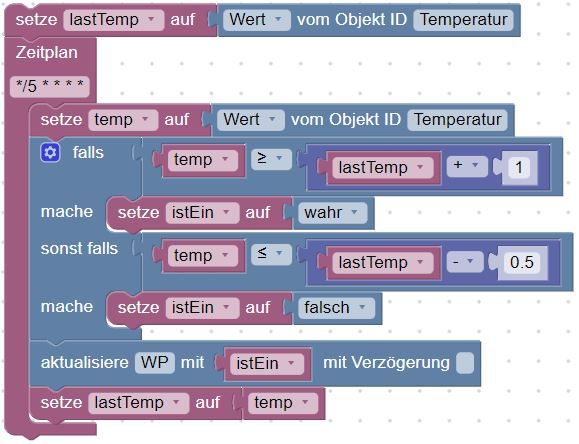

                            • paul53
                              paul53 @siporax last edited by
                              @siporax sagte: script zur verfügung stellen ?
                               <variables>
                                 <variable id="Vn6j?jOO?$kDTnqTWGfU">lastTemp</variable>
                                 <variable id="JV,7/}p(l?3Qii59u`wo">temp</variable>
                                 <variable id="L:#sVF3F*)ZIZ7+wyOUD">istEin</variable>
                               </variables>
                               <block type="variables_set" id="]!T`lxoBB4d;Cg!NZ]}|" x="-662" y="-1163">
                                 <field name="VAR" id="Vn6j?jOO?$kDTnqTWGfU">lastTemp</field>
                                 <value name="VALUE">
                                   <block type="get_value" id="Iz2p*j8Ax;+XzF=rVKhl">
                                     <field name="OID">0_userdata.0.Blockly.Temperatur</field>
                                   </block>
                                 </value>
                                 <next>
                                   <block type="schedule" id="9vy9?l/Ip;~mD-a8NGT4">
                                     <field name="SCHEDULE">*/5 * * * *</field>
                                     <statement name="STATEMENT">
                                       <block type="variables_set" id="U2YZi=*EcWMmgr5TH/5B">
                                         <field name="VAR" id="JV,7/}p(l?3Qii59u`wo">temp</field>
                                           <block type="get_value" id="N5#;gX!iV_`9;l3@%8cd">
                                           </block>
                                         </value>
                                         <next>
                                           <block type="controls_if" id="yoQjZl{f2D5XcmPJfuK!">
                                             <value name="IF0">
                                               <block type="logic_compare" id="X9VwCHq$Ikow)bf5R)$P">
                                                 <field name="OP">GTE</field>
                                                 <value name="A">
                                                   <block type="variables_get" id="4pB((16P$wnIiV:_RW{m">
                                                   </block>
                                                 </value>
                                                 <value name="B">
                                                   <block type="math_arithmetic" id="-ypD2~#RlcvCw8G=N2QT">
                                                     <field name="OP">ADD</field>
                                                     <value name="A">
                                                       <shadow type="math_number" id="dDkgt-`Ih))K6]iktTJ$">
                                                         <field name="NUM">1</field>
                                                       </shadow>
                                                       <block type="variables_get" id="eidIUFk]Uy{qD6:s)P7W">
                                                       </block>
                                                     </value>
                                                     <value name="B">
                                                       <shadow type="math_number" id="m47!La,.3r!*:kGOG:i_">
                                                       </shadow>
                                                     </value>
                                                   </block>
                                                 </value>
                                               </block>
                                             </value>
                                             <statement name="DO0">
                                               <block type="variables_set" id="|;r)}t;NdlJK:U%qf@p@">
                                                 <field name="VAR" id="L:#sVF3F*)ZIZ7+wyOUD">istEin</field>
                                                   <block type="logic_boolean" id="Lte;~5RI[HxZmV~:9,l?">
                                                   </block>
                                                 </value>
                                               </block>
                                             </statement>
                                             <value name="IF1">
                                               <block type="logic_compare" id="Q8YL?;2opW^@CduOyRkJ">
                                                 <field name="OP">LTE</field>
                                                 <value name="A">
                                                   <block type="variables_get" id="-Z_l4#mR/3NfnymU9R+m">
                                                   </block>
                                                 </value>
                                                 <value name="B">
                                                   <block type="math_arithmetic" id="egk=Qz=iAzK-r!HiBrNu">
                                                     <value name="A">
                                                       </shadow>
                                                       <block type="variables_get" id="TmLPt[P}QkHvB:Lf*dV}">
                                                       </block>
                                                     </value>
                                                     <value name="B">
                                                       <shadow type="math_number" id="V;G{]7/Ek0s|@*?,($6q">
                                                         <field name="NUM">0.5</field>
                                                       </shadow>
                                                     </value>
                                                   </block>
                                                 </value>
                                               </block>
                                             </value>
                                             <statement name="DO1">
                                               <block type="variables_set" id=",!.Ij;r44xuub.^h%{pf">
                                                   <block type="logic_boolean" id="6oVc%{sJAP#|aG2JW;F6">
                                                   </block>
                                                 </value>
                                               </block>
                                             </statement>
                                             <next>
                                               <block type="update" id="LoMN_Gt.CbXa^4?p?vjq">
                                                 <field name="OID">0_userdata.0.Blockly.WP</field>
                                                   <block type="variables_get" id="mRHB]k/b2+EI3]6i#%/[">
                                                   </block>
                                                 </value>
                                                 <next>
                                                   <block type="variables_set" id="q=1q;b5nA-;`bgbI8z/d">
                                                       <block type="variables_get" id="U!0X(O3pQvmbqtV:lJ]y">
                                                       </block>
                                                     </value>
                                                   </block>
                                                 </next>
                                               </block>
                                             </next>
                                           </block>
                                         </next>
                                       </block>
                                     </statement>
                                   </block>
                                 </next>
                               </block>
                              </xml>
                              S 1 Reply Last reply Reply Quote 1

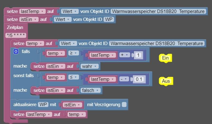

                                          @siporax sagte: ich teste das mal
                                          Ich habe das Skript noch um die Initialisierung von istEin bei Skriptstart erweitert:
                                          • S
                                            siporax @paul53 last edited by
                                            @paul53 Mache ich gleich.
                                            Habe mal nachgemessen ich habe in 16 Minuten einen Temperaturabfall von 0,1°C im Speicher.
                                            Ist doch lang für das Script.
                                            Denke er Vergleich ja nur 1x oder vergleich er immer wieder bis sich das was ändert und die 5 Minuten stoßen das nur wieder von vorne an?
                                            601
                                            32.3k
                                            81.0k
                                            59
                                            2943
