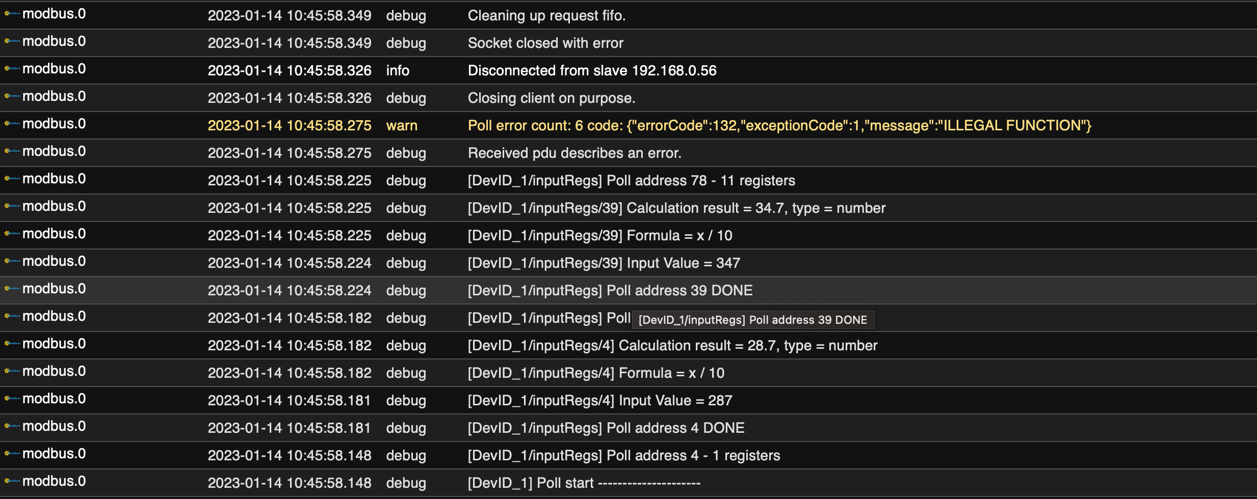

              modbus.1
              2023-01-14 18:07:01.363	debug	Closing client on purpose.
              modbus.1
              2023-01-14 18:07:00.364	silly	States user redis pmessage modbus.1.*/modbus.1.info.connection:{"val":false,"ack":true,"ts":1673716020363,"q":0,"from":"system.adapter.modbus.1","user":"system.user.admin","lc":1673716014383}
              modbus.1
              2023-01-14 18:07:00.362	debug	Cleaning up request fifo.
              modbus.1
              2023-01-14 18:07:00.362	debug	Socket closed with error
              modbus.1
              2023-01-14 18:07:00.339	info	Disconnected from slave 192.168.0.56
              modbus.1
              2023-01-14 18:07:00.339	debug	Closing client on purpose.
              modbus.1
              2023-01-14 18:07:00.336	silly	States user redis pmessage modbus.1.*/modbus.1.info.connection:{"val":false,"ack":true,"ts":1673716020335,"q":0,"from":"system.adapter.modbus.1","user":"system.user.admin","lc":1673716014383}
              modbus.1
              2023-01-14 18:07:00.288	warn	Poll error count: 6 code: {"errorCode":132,"exceptionCode":1,"message":"ILLEGAL FUNCTION"}
              modbus.1
              2023-01-14 18:07:00.287	debug	Received pdu describes an error.
              modbus.1
              2023-01-14 18:07:00.215	silly	States user redis pmessage modbus.1.*/modbus.1.inputRegisters.39_Vorlauf__oben:{"val":34.8,"ack":true,"ts":1673716020214,"q":0,"from":"system.adapter.modbus.1","user":"system.user.admin","lc":1673716014327}
              modbus.1
              2023-01-14 18:07:00.214	silly	States user redis pmessage modbus.1.*/modbus.1.inputRegisters.4_Vorlauf_unten:{"val":29.4,"ack":true,"ts":1673716020213,"q":0,"from":"system.adapter.modbus.1","user":"system.user.admin","lc":1673715884570}
              modbus.1
              2023-01-14 18:07:00.213	debug	[DevID_1/inputRegs] Poll address 77 - 12 registers
              modbus.1
              2023-01-14 18:07:00.212	debug	[DevID_1/inputRegs/39] Calculation result = 34.8, type = number
              modbus.1
              2023-01-14 18:07:00.212	debug	[DevID_1/inputRegs/39] Formula = x / 10

              Komischerweise steht bei PollAdress 77 was von 12 register wenn ich es alleine in einer Instanz Polle dann nur 1 Register
              GlasfaserG Offline
              GlasfaserG Offline
              Glasfaser
              @bytec sagte in Modbus TCP Problem:
              2023-01-14 18:07:00.173 debug [DevID_1/inputRegs] Poll address 39 - 1 registers
              2023-01-14 18:07:00.143 debug [DevID_1/inputRegs] Poll address 4 - 1 registers
              das wäre richtig = 1 Register
              ab hier 12
              kannst du bitte ein Debug log zeigen , wo 77 funktioniert !
              EDIT :
              Bzw. 78 ... komme gerade nicht mit ... da :
              dem auszulesenden Register dazuzählen also ich möchte 77 muss dann aber 78 eingeben. Dies funktioniert so bei den anderen Registern.
              B 1 Antwort Letzte Antwort

                @glasfaser
                Also aktuelle Einstellung im Bild werden 4 / 39 / 77 korrekt ausgelesen 88 kommt eine gelbe 0
                Laut dem Log steht bei 77 ja wieder 12 register ...

                modbus.1
                2023-01-14 19:01:57.540	debug	Add inputRegisters.77_Rücklauf_unten: {"_id":"inputRegisters.77_Rücklauf_unten","type":"state","common":{"name":"","role":"value","type":"number","read":true,"write":false,"def":0,"unit":"°C"},"native":{"regType":"inputRegs","address":77,"deviceId":1,"type":"int16be","len":1,"offset":0,"factor":1}}
                modbus.1
                2023-01-14 19:01:57.540	debug	Add inputRegisters.39_Vorlauf__oben: {"_id":"inputRegisters.39_Vorlauf__oben","type":"state","common":{"name":"","role":"value","type":"number","read":true,"write":false,"def":0,"unit":"°C"},"native":{"regType":"inputRegs","address":39,"deviceId":1,"type":"int16be","len":1,"offset":0,"factor":1}}
                modbus.1
                2023-01-14 19:01:57.540	debug	Add inputRegisters.4_Vorlauf_unten: {"_id":"inputRegisters.4_Vorlauf_unten","type":"state","common":{"name":"","role":"value","type":"number","read":true,"write":false,"def":0,"unit":"°C"},"native":{"regType":"inputRegs","address":4,"deviceId":1,"type":"int16be","len":1,"offset":0,"factor":1}}
                modbus.1
                2023-01-14 19:01:57.540	debug	Initialize Objects for inputRegs: [{"_address":4,"name":"Vorlauf unten","description":"","unit":"°C","type":"int16be","len":1,"factor":1,"offset":0,"formula":"x / 10","role":"value","room":"","cw":false,"isScale":false,"deviceId":1,"address":4,"id":"inputRegisters.4_Vorlauf_unten"},{"_address":39,"name":"Vorlauf oben","description":"","unit":"°C","type":"int16be","len":1,"factor":1,"offset":0,"formula":"x / 10","role":"value","room":"","cw":false,"isScale":false,"deviceId":1,"address":39,"id":"inputRegisters.39_Vorlauf__oben"},{"_address":77,"name":"Rücklauf unten","description":"","unit":"°C","type":"int16be","len":1,"factor":1,"offset":0,"formula":"","role":"value","room":"","cw":false,"isScale":false,"deviceId":1,"address":77,"id":"inputRegisters.77_Rücklauf_unten"},{"_address":88,"name":"Rücklauf oben","description":"","unit":"°C","type":"int16be","len":1,"factor":1,"offset":0,"formula":"","role":"value","room":"","cw":false,"isScale":false,"deviceId":1,"address":88,"id":"inputRegisters.88_Rücklauf_oben"}]
                modbus.1
                2023-01-14 19:01:57.539	debug	Initialize Objects for coils: []
                modbus.1
                2023-01-14 19:01:57.539	debug	Initialize Objects for disInputs: []
                modbus.1
                2023-01-14 19:01:57.479	info	starting. Version 5.0.11 in /opt/iobroker/node_modules/iobroker.modbus, node: v14.17.0, js-controller: 4.0.24
                modbus.1
                2023-01-14 19:01:57.375	debug	Plugin sentry Initialize Plugin (enabled=true)
                modbus.1
                2023-01-14 19:01:57.324	debug	States connected to redis: 127.0.0.1:9000
                modbus.1
                2023-01-14 19:01:57.267	debug	States create User PubSub Client
                modbus.1
                2023-01-14 19:01:57.266	debug	States create System PubSub Client
                modbus.1
                2023-01-14 19:01:57.259	debug	Redis States: Use Redis connection: 127.0.0.1:9000
                modbus.1
                2023-01-14 19:01:57.246	debug	Objects connected to redis: 127.0.0.1:9001
                modbus.1
                2023-01-14 19:01:57.244	debug	Objects client initialize lua scripts
                modbus.1
                2023-01-14 19:01:57.223	debug	Objects create User PubSub Client
                modbus.1
                2023-01-14 19:01:57.223	debug	Objects create System PubSub Client
                modbus.1
                2023-01-14 19:01:57.222	debug	Objects client ready ... initialize now
                modbus.1
                2023-01-14 19:01:57.204	debug	Redis Objects: Use Redis connection: 127.0.0.1:9001

                  Ich muss mich hier auch mal einhängen. Versuche verzweifelt, mein Victron-System per Modbus auszulesen. Fehlermeldung ist ähnlich wie hier oben:
                  modbus.2 2023-01-15 09:28:45.667	debug	[DevID_100/inputRegs] Poll address 840 - 21 registers
                  modbus.2 2023-01-15 09:28:45.666	debug	[DevID_100/inputRegs] Poll address 820 DONE
                  modbus.2 2023-01-15 09:28:45.663	debug	[DevID_100/inputRegs] Poll address 820 - 3 registers
                  modbus.2 2023-01-15 09:28:45.662	debug	[DevID_100] Poll start ---------------------
                  Das abzufragende Gerät liefert mir eine Erklärung:
                  Demnach hat der Modbus-Adapter versucht, ab Adresse 840 direkt 21 Bytes/Adressen (?) abzufragen. Dies scheiterte dann daran, dass es Adresse 847 nicht gibt, was auch stimmt. Er sollte diese Adresse auch gar nicht abfragen:
                  Ich habe jedoch in den Einstellungen des Adapters keine Option gefunden, in der man das Auslesen ganzer Blöcke deaktivieren könnte.
                  Oder bin ich da komplett auf dem Holzweg?
                  K 1 Antwort Letzte Antwort

                      @klassisch Ich dachte mir schon dass es bestimmt Nutzer gibt, die damit Ihr Victron-System bedienen.
                      Ich glaube, ich habe das Problem gefunden. In den Instanz-Einstellung war hinterlegt, dass er 10 Werte in einem Durchgang liest. Daran lag's wohl:
                      • O oxident
                        B Offline
                        B Offline
                        bytec
                        #25
                        @oxident
                        Super das war es jetzt geht es auch bei mir.

                            Also ich habe bei mir jetzt unter Max Leseanforderungslänge eine 1 bei Float und Integer eingetragen und seitdem werden alle Register in einer Instanz sauber ausgelesen.
                            Wahrscheinlich hat sich vorher wenn die Register nah beieinander waren etwas überlappt beim auslesen.

                                  @klassisch @bytec Ja, das war in der Tat das Problem. Ich fänd es ja auch sinniger, wenn der Adapter "in einem Rutsch" mehr lesen könnte, aber das scheint bei uns nicht zu klappen...
