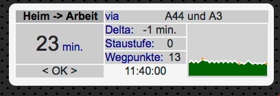

          kannst du mir mal sagen wie du das mit den datenpunkten gemacht hast?
          filename="bild1.jpg" index="0">~~
          • ruhr70
            ruhr70 last edited by
            komme heute aus dem Urlaub zurück. Dann poste ich die Infos
            • ruhr70
              @bahnuhr:
              @ruhr70
              bild1.jpg `
              Anbei das Skript, mit dem die Datenpunkte abgefragt und erzeugt werden:

                      • ruhr70
                        Im Detail ist es folgender Datenpunkt, für den Histroy aktiviert sein muss:
                        javascript.1.Google_Maps.zur_Arbeit.Minuten_0
                        Das gesamte Widget zum Skript:
                        [{"tpl":"tplValueString","data":{"oid":"javascript.1.Google_Maps.zur_Arbeit.Route_0","visibility-cond":"==","visibility-val":1,"test_html":"","html_append":"","gestures-offsetX":0,"gestures-offsetY":0,"html_prepend":"via","signals-cond-0":"==","signals-val-0":true,"signals-icon-0":"/vis/signals/lowbattery.png","signals-icon-size-0":0,"signals-blink-0":false,"signals-horz-0":0,"signals-vert-0":0,"signals-hide-edit-0":false,"signals-cond-1":"==","signals-val-1":true,"signals-icon-1":"/vis/signals/lowbattery.png","signals-icon-size-1":0,"signals-blink-1":false,"signals-horz-1":0,"signals-vert-1":0,"signals-hide-edit-1":false,"signals-cond-2":"==","signals-val-2":true,"signals-icon-2":"/vis/signals/lowbattery.png","signals-icon-size-2":0,"signals-blink-2":false,"signals-horz-2":0,"signals-vert-2":0,"signals-hide-edit-2":false,"visibility-groups-action":"hide"},"style":{"left":"310px","top":"150px","width":"238px","height":"18px","color":"rgb(34, 34, 34)","background":"rgb(204, 204, 204) none repeat scroll 0% 0% / auto padding-box border-box","z-index":"4","text-align":"center"},"widgetSet":"basic"},{"tpl":"tplValueString","data":{"oid":"javascript.1.Google_Maps.zur_Arbeit.Minuten_0","visibility-cond":"==","visibility-val":1,"test_html":"","html_append":" min. ","gestures-offsetX":0,"gestures-offsetY":0,"html_prepend":"","signals-cond-0":"==","signals-val-0":true,"signals-icon-0":"/vis/signals/lowbattery.png","signals-icon-size-0":0,"signals-blink-0":false,"signals-horz-0":0,"signals-vert-0":0,"signals-hide-edit-0":false,"signals-cond-1":"==","signals-val-1":true,"signals-icon-1":"/vis/signals/lowbattery.png","signals-icon-size-1":0,"signals-blink-1":false,"signals-horz-1":0,"signals-vert-1":0,"signals-hide-edit-1":false,"signals-cond-2":"==","signals-val-2":true,"signals-icon-2":"/vis/signals/lowbattery.png","signals-icon-size-2":0,"signals-blink-2":false,"signals-horz-2":0,"signals-vert-2":0,"signals-hide-edit-2":false,"visibility-groups-action":"hide"},"style":{"left":"180px","top":"170px","width":"128px","height":"58px","color":"rgb(34, 34, 34)","background":"rgb(204, 204, 204) none repeat scroll 0% 0% / auto padding-box border-box","z-index":"4","text-align":"center","line-height":"58px","font-size":"30px"},"widgetSet":"basic"},{"tpl":"tplValueString","data":{"oid":"javascript.1.Google_Maps.zur_Arbeit.Staustufe_0","visibility-cond":"==","visibility-val":1,"test_html":"","html_append":"","gestures-offsetX":0,"gestures-offsetY":0,"html_prepend":"Staustufe:","signals-cond-0":"==","signals-val-0":true,"signals-icon-0":"/vis/signals/lowbattery.png","signals-icon-size-0":0,"signals-blink-0":false,"signals-horz-0":0,"signals-vert-0":0,"signals-hide-edit-0":false,"signals-cond-1":"==","signals-val-1":true,"signals-icon-1":"/vis/signals/lowbattery.png","signals-icon-size-1":0,"signals-blink-1":false,"signals-horz-1":0,"signals-vert-1":0,"signals-hide-edit-1":false,"signals-cond-2":"==","signals-val-2":true,"signals-icon-2":"/vis/signals/lowbattery.png","signals-icon-size-2":0,"signals-blink-2":false,"signals-horz-2":0,"signals-vert-2":0,"signals-hide-edit-2":false,"visibility-groups-action":"hide"},"style":{"left":"310px","top":"190px","width":"118px","height":"18px","color":"rgb(34, 34, 34)","background":"rgb(204, 204, 204) none repeat scroll 0% 0% / auto padding-box border-box","z-index":"4","text-align":"center"},"widgetSet":"basic"},{"tpl":"tplHistorySparkLIne","data":{"visibility-cond":"==","visibility-val":1,"aggregate":"max","chartType":"line","points":"400","time_interval":"24 hours","signals-cond-0":"==","signals-val-0":true,"signals-icon-0":"/vis/signals/lowbattery.png","signals-icon-size-0":0,"signals-blink-0":false,"signals-horz-0":0,"signals-vert-0":0,"signals-hide-edit-0":false,"signals-cond-1":"==","signals-val-1":true,"signals-icon-1":"/vis/signals/lowbattery.png","signals-icon-size-1":0,"signals-blink-1":false,"signals-horz-1":0,"signals-vert-1":0,"signals-hide-edit-1":false,"signals-cond-2":"==","signals-val-2":true,"signals-icon-2":"/vis/signals/lowbattery.png","signals-icon-size-2":0,"signals-blink-2":false,"signals-horz-2":0,"signals-vert-2":0,"signals-hide-edit-2":false,"visibility-oid":"","min":"15","max":"45","oid":"javascript.1.Google_Maps.zur_Arbeit.Minuten_0","instance":"sql.0","lineColor":"white","fillColor":"darkgreen","lineWidth":"2","disableTooltips":false,"zeroColor":"#2943c2","visibility-groups-action":"hide"},"style":{"left":"430px","top":"170px","width":"117px","height":"78px","z-index":"2","border-width":"","border-style":"","border-color":"","background-color":"lightgrey","margin-left":"","padding-left":"","padding":"","box-shadow":""},"widgetSet":"history"},{"tpl":"tplValueString","data":{"oid":"javascript.1.Google_Maps.zur_Arbeit.Minuten_0_Deltazeit","visibility-cond":"==","visibility-val":1,"test_html":"","html_append":" min.","gestures-offsetX":0,"gestures-offsetY":0,"html_prepend":"Delta:","signals-cond-0":"==","signals-val-0":true,"signals-icon-0":"/vis/signals/lowbattery.png","signals-icon-size-0":0,"signals-blink-0":false,"signals-horz-0":0,"signals-vert-0":0,"signals-hide-edit-0":false,"signals-cond-1":"==","signals-val-1":true,"signals-icon-1":"/vis/signals/lowbattery.png","signals-icon-size-1":0,"signals-blink-1":false,"signals-horz-1":0,"signals-vert-1":0,"signals-hide-edit-1":false,"signals-cond-2":"==","signals-val-2":true,"signals-icon-2":"/vis/signals/lowbattery.png","signals-icon-size-2":0,"signals-blink-2":false,"signals-horz-2":0,"signals-vert-2":0,"signals-hide-edit-2":false,"visibility-groups-action":"hide"},"style":{"left":"310px","top":"170px","width":"118px","height":"18px","color":"rgb(34, 34, 34)","background":"rgb(204, 204, 204) none repeat scroll 0% 0% / auto padding-box border-box","z-index":"4","text-align":"center"},"widgetSet":"basic"},{"tpl":"tplValueString","data":{"oid":"javascript.1.Google_Maps.zur_Arbeit.Anzahl_Wegpunkte_0","visibility-cond":"==","visibility-val":1,"test_html":"","html_append":"","gestures-offsetX":0,"gestures-offsetY":0,"html_prepend":"Wegpunkte:","signals-cond-0":"==","signals-val-0":true,"signals-icon-0":"/vis/signals/lowbattery.png","signals-icon-size-0":0,"signals-blink-0":false,"signals-horz-0":0,"signals-vert-0":0,"signals-hide-edit-0":false,"signals-cond-1":"==","signals-val-1":true,"signals-icon-1":"/vis/signals/lowbattery.png","signals-icon-size-1":0,"signals-blink-1":false,"signals-horz-1":0,"signals-vert-1":0,"signals-hide-edit-1":false,"signals-cond-2":"==","signals-val-2":true,"signals-icon-2":"/vis/signals/lowbattery.png","signals-icon-size-2":0,"signals-blink-2":false,"signals-horz-2":0,"signals-vert-2":0,"signals-hide-edit-2":false,"visibility-groups-action":"hide"},"style":{"left":"310px","top":"210px","width":"118px","height":"18px","color":"rgb(34, 34, 34)","background":"rgb(204, 204, 204) none repeat scroll 0% 0% / auto padding-box border-box","z-index":"4","text-align":"center"},"widgetSet":"basic"},{"tpl":"tplValueString","data":{"oid":"javascript.1.Google_Maps.zur_Arbeit.skript.status","visibility-cond":"==","visibility-val":1,"test_html":"","html_append":" >","gestures-offsetX":0,"gestures-offsetY":0,"html_prepend":"< ","signals-cond-0":"==","signals-val-0":true,"signals-icon-0":"/vis/signals/lowbattery.png","signals-icon-size-0":0,"signals-blink-0":false,"signals-horz-0":0,"signals-vert-0":0,"signals-hide-edit-0":false,"signals-cond-1":"==","signals-val-1":true,"signals-icon-1":"/vis/signals/lowbattery.png","signals-icon-size-1":0,"signals-blink-1":false,"signals-horz-1":0,"signals-vert-1":0,"signals-hide-edit-1":false,"signals-cond-2":"==","signals-val-2":true,"signals-icon-2":"/vis/signals/lowbattery.png","signals-icon-size-2":0,"signals-blink-2":false,"signals-horz-2":0,"signals-vert-2":0,"signals-hide-edit-2":false,"visibility-groups-action":"hide"},"style":{"left":"180px","top":"230px","width":"128px","height":"18px","color":"rgb(34, 34, 34)","background":"rgb(204, 204, 204) none repeat scroll 0% 0% / auto padding-box border-box","z-index":"4","text-align":"center"},"widgetSet":"basic"},{"tpl":"tplHtml","data":{"visibility-cond":"==","visibility-val":1,"refreshInterval":"0","html":"","gestures-offsetX":0,"gestures-offsetY":0,"signals-cond-0":"==","signals-val-0":true,"signals-icon-0":"/vis/signals/lowbattery.png","signals-icon-size-0":0,"signals-blink-0":false,"signals-horz-0":0,"signals-vert-0":0,"signals-hide-edit-0":false,"signals-cond-1":"==","signals-val-1":true,"signals-icon-1":"/vis/signals/lowbattery.png","signals-icon-size-1":0,"signals-blink-1":false,"signals-horz-1":0,"signals-vert-1":0,"signals-hide-edit-1":false,"signals-cond-2":"==","signals-val-2":true,"signals-icon-2":"/vis/signals/lowbattery.png","signals-icon-size-2":0,"signals-blink-2":false,"signals-horz-2":0,"signals-vert-2":0,"signals-hide-edit-2":false,"visibility-groups-action":"hide"},"style":{"left":"170px","top":"140px","background":"whitesmoke","width":"386px","height":"120px","border-radius":"10px","z-index":"1","overflow-x":""},"widgetSet":"basic"},{"tpl":"tplHtml","data":{"visibility-cond":"==","visibility-val":1,"refreshInterval":"0","html":"Heim -> Arbeit","gestures-offsetX":0,"gestures-offsetY":0,"signals-cond-0":"==","signals-val-0":true,"signals-icon-0":"/vis/signals/lowbattery.png","signals-icon-size-0":0,"signals-blink-0":false,"signals-horz-0":0,"signals-vert-0":0,"signals-hide-edit-0":false,"signals-cond-1":"==","signals-val-1":true,"signals-icon-1":"/vis/signals/lowbattery.png","signals-icon-size-1":0,"signals-blink-1":false,"signals-horz-1":0,"signals-vert-1":0,"signals-hide-edit-1":false,"signals-cond-2":"==","signals-val-2":true,"signals-icon-2":"/vis/signals/lowbattery.png","signals-icon-size-2":0,"signals-blink-2":false,"signals-horz-2":0,"signals-vert-2":0,"signals-hide-edit-2":false,"visibility-groups-action":"hide"},"style":{"left":"180px","top":"150px","background":"darkgrey","width":"126px","height":"18px","z-index":"4","padding-left":"2px","text-align":"center","font-weight":"bold"},"widgetSet":"basic"},{"tpl":"tplValueTimestamp","data":{"oid":"javascript.1.Google_Maps.zur_Arbeit.Minuten_0","g_fixed":false,"g_visibility":false,"g_css_font_text":true,"g_css_background":true,"g_css_shadow_padding":true,"g_css_border":false,"g_gestures":false,"g_signals":false,"visibility-cond":"==","visibility-val":1,"visibility-groups-action":"hide","signals-cond-0":"==","signals-val-0":true,"signals-icon-0":"/vis/signals/lowbattery.png","signals-icon-size-0":0,"signals-blink-0":false,"signals-horz-0":0,"signals-vert-0":0,"signals-hide-edit-0":false,"signals-cond-1":"==","signals-val-1":true,"signals-icon-1":"/vis/signals/lowbattery.png","signals-icon-size-1":0,"signals-blink-1":false,"signals-horz-1":0,"signals-vert-1":0,"signals-hide-edit-1":false,"signals-cond-2":"==","signals-val-2":true,"signals-icon-2":"/vis/signals/lowbattery.png","signals-icon-size-2":0,"signals-blink-2":false,"signals-horz-2":0,"signals-vert-2":0,"signals-hide-edit-2":false,"format_date":"hh:mm:ss"},"style":{"left":"310px","top":"230px","z-index":"4","width":"118px","height":"18px","color":"rgb(34, 34, 34)","text-align":"center","background":"","padding-top":"","margin-top":"","padding":""},"widgetSet":"basic"}]
                        Dort kann man alle Widgettypen, Formatierungen und verwendete Datenpunkte einsehen.
                        Version:
                         ![327_google_maps_zur_arbeit.jpg](/assets/uploads/files/327_google_maps_zur_arbeit.jpg)
                        Was ich noch ergänzen muss… Bei Staustufe wird der Hintergrund und die Schriftfarbe entsprechend der Staustufe geändert (noch nicht umgesetzt).
                        Stufe 0: lime (grün): (keine oder geringe Verzögerung)
                        Stufe 1: gelb
                        Stufe 2: orange
                        Stufe 3: rot

                                            Dann das Skript, welches ich hier aus dem Forum kopiert hatte:
                                            ! function currentDate() { var d = new Date(); return new Date(d.getFullYear(), d.getMonth(), d.getDate()); } function addTime(strTime) { var time = strTime.split(':'); var d = currentDate(); d.setHours(time[0]); d.setMinutes(time[1]); d.setSeconds(time[2]); return d; } function isTimeInRange(strLower, strUpper) { var now = new Date(); var lower = addTime(strLower); var upper = addTime(strUpper); var inRange = false; if (upper > lower) { // opens and closes in same day inRange = (now >= lower && now <= upper) ? true : false; } else { // closes in the following day inRange = (now >= upper && now <= lower) ? false : true; } return inRange; } !
