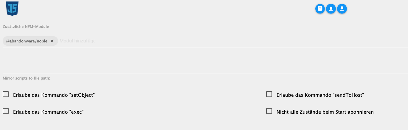

            @tigertim08 an welchem Rechner? zusätzlich oder als einziges Gerät? Falls Zweitgerät müsste dein Dongle hci1 sein.
            NPM-Module im javascript
            https://www.npmjs.com/package/@abandonware/noble

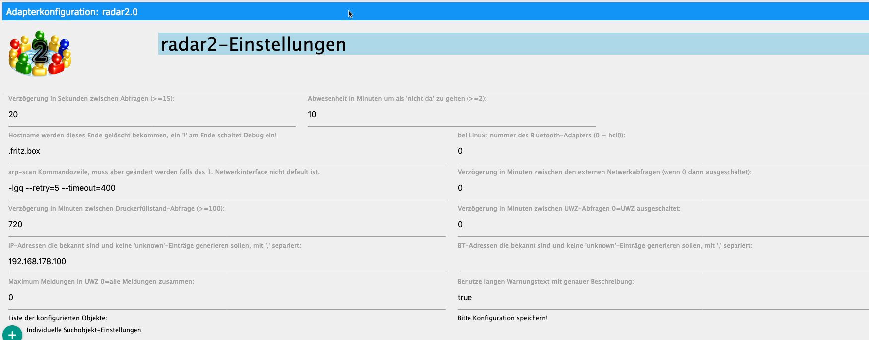

                danke für die Hilfe. Der radar 2 adapter läuft jetzt allerdings gibt mir das log immer noch eine Fehlermeldung aus
                2019-06-16 10:59:02.425 - info: host.iobroker instance system.adapter.radar2.0 started with pid 2053
                2019-06-16 10:59:04.418 - info: radar2.0 starting. Version 1.0.3 in /opt/iobroker/node_modules/iobroker.radar2, node: v8.16.0
                2019-06-16 10:59:04.550 - info: radar2.0 radar2 initialization started...
                2019-06-16 10:59:04.642 - info: radar2.0 Connected with '0.0.0.0' for DHCP Scan
                2019-06-16 10:59:04.779 - warn: radar2.0 Noble not available, Error: Error: /opt/iobroker/node_modules/@abandonware/bluetooth-hci-socket/lib/binding/binding.node: wrong ELF class: ELFCLASS32at Object.Module._extensions..node (module.js:682:18)at Module.load (module.js:566:32)at tryModuleLoad (module.js:506:12)at Function.Module._load (module.js:498:3)at Module.require (module.js:597:17)at require (internal/module.js:11:18)at Object. (/opt/iobroker/node_modules/@abandonware/bluetooth-hci-socket/lib/native.js:6:15)at Module._compile (module.js:653:30)at Object.Module._extensions..js (module.js:664:10)at Module.load (module.js:566:32)
                2019-06-16 10:59:04.785 - info: radar2.0 found 'node-bluetooth'
                2019-06-16 10:59:04.786 - info: radar2.0 radar2 set to flag items away if they are not seen for 10 minutes
                2019-06-16 10:59:04.786 - info: radar2.0 use known BT list: []
                2019-06-16 10:59:04.786 - info: radar2.0 use known IP list: [ '192.XXX.XXX.XXX' ]
                2019-06-16 10:59:04.787 - info: radar2.0 Remove name end for host names: .fritz.box
                2019-06-16 10:59:04.787 - info: radar2.0 arp-scan will use the following interfaces: [ 'ens18' ]
                2019-06-16 10:59:04.787 - info: radar2.0 radar2 set to scan every 20 seconds and printers every 720 minutes.
                2019-06-16 10:59:04.856 - info: radar2.0 Init item Forum with { name: 'Forum',ip: 'https://forum.iobroker.net',id: 'Forum',type: 'URL',lasthere: '2019-06-16T08:00:56.674Z' }
                2019-06-16 10:59:04.871 - info: radar2.0 Init item Tim with { name: 'Tim',bluetooth: [ '7c:2f:80:ad:c2:XX' ],id: 'Tim',type: 'BT',btVendor: 'Gigaset Communications GmbH' }
                2019-06-16 10:59:04.886 - info: radar2.0 Init item Judith with { name: 'Judith',bluetooth: [ '7c:2f:80:ad:c2:XX' ],id: 'Judith',type: 'BT',btVendor: 'Gigaset Communications GmbH' }
                2019-06-16 10:59:04.945 - info: radar2.0 Init item Server with { name: 'Server',id: 'Server',type: 'IP',rip: [ '192.XXX.XXX.XXX' ],lasthere: '2019-06-16T08:56:43.968Z',hasMAC: [ '00:08:9b:ed:d3:8b' ] }
                2019-06-16 10:59:04.951 - info: radar2.0 Adapter identified macs: (00:08:9b:ed:d3:8b),
                ips: (192.168.178.100),
                bts: (7c:2f:80:ad:c2:71,7c:2f:80:ad:c2:36)
                Und irgendwie findet er unser g-tag BLE devices auch nicht.... Grundsätzlich scheint Bluetooth aber zu laufen.
                Noch jemand eine Idee?

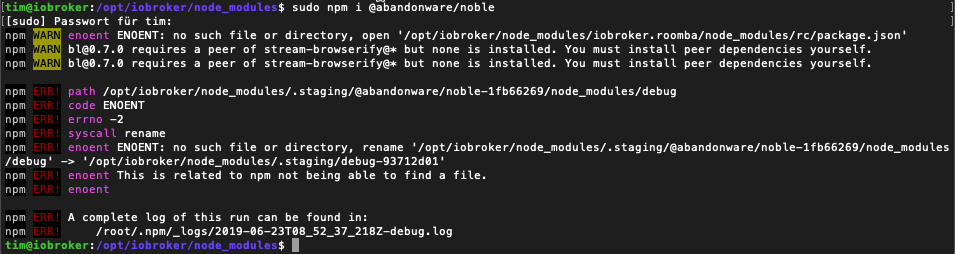

                      @tigertim08 auch installiert?
                      npm i @abandonware/noble
                      In /opt/iobroker/node_modules
                      tigertim08T 1 Antwort Letzte Antwort
                      • crunchipC crunchip
                        tigertim08T Offline
                        tigertim08T Offline
                        tigertim08
                        @crunchip habe ich gerade probiert, will aber leider nicht so wie ich will... 2019-06-23_10-53-19.png
                        Scheint als ob ich einen Schritt vorher vergessen habe... Nur welchen?
