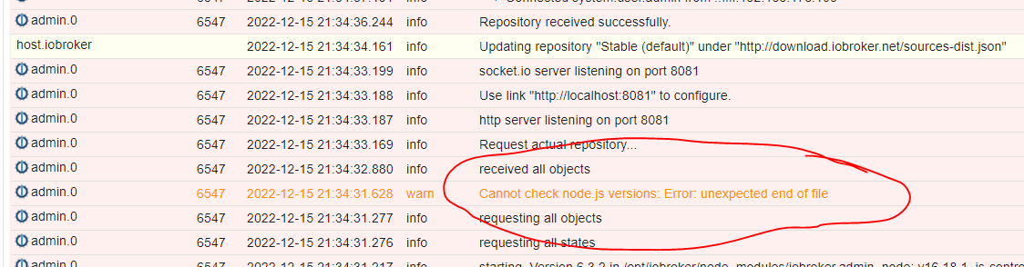

                                    OK, kommt auch noch..
                                    Passt das hier?
                                    admin.0
                                    6547	2022-12-15 21:34:39.355	info	==> Connected system.user.admin from ::ffff:192.168.178.103
                                    admin.0
                                    6547	2022-12-15 21:34:37.942	info	<== Disconnect system.user.admin from ::ffff:192.168.178.103 admin
                                    admin.0
                                    6547	2022-12-15 21:34:37.191	info	==> Connected system.user.admin from ::ffff:192.168.178.103
                                    admin.0
                                    6547	2022-12-15 21:34:36.244	info	Repository received successfully.
                                    host.iobroker
                                    2022-12-15 21:34:34.161	info	Updating repository "Stable (default)" under "http://download.iobroker.net/sources-dist.json"
                                    admin.0
                                    6547	2022-12-15 21:34:33.199	info	socket.io server listening on port 8081
                                    admin.0
                                    6547	2022-12-15 21:34:33.188	info	Use link "http://localhost:8081" to configure.
                                    admin.0
                                    6547	2022-12-15 21:34:33.187	info	http server listening on port 8081
                                    admin.0
                                    6547	2022-12-15 21:34:33.169	info	Request actual repository...
                                    admin.0
                                    6547	2022-12-15 21:34:32.880	info	received all objects
                                    admin.0
                                    6547	2022-12-15 21:34:31.628	warn	Cannot check node.js versions: Error: unexpected end of file
                                    admin.0
                                    6547	2022-12-15 21:34:31.277	info	requesting all objects
                                    admin.0
                                    6547	2022-12-15 21:34:31.276	info	requesting all states
                                    admin.0
                                    6547	2022-12-15 21:34:31.217	info	starting. Version 6.3.2 in /opt/iobroker/node_modules/iobroker.admin, node: v16.18.1, js-controller: 4.0.23

                                      #46

                                      • T Tobi68
                                        Passt das hier?
                                        admin.0
                                        admin.0
                                        admin.0
                                        admin.0
                                        host.iobroker
                                        admin.0
                                        admin.0
                                        admin.0
                                        admin.0
                                        admin.0
                                        admin.0
                                        admin.0
                                        admin.0
                                        admin.0

                                        @tobi68 sagte in Probleme beim aufspielen des Backups nach Neuinstallation:
                                        , kommt auch noch..
                                        was meinst du damit?
                                        T 1 Antwort Letzte Antwort
