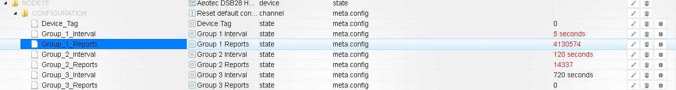

                Jetzt habe ich aber leider dasselbe problem wie Lenny:
                host.HomeControl 2016-11-06 21:58:11.453 info Restart adapter system.adapter.zwave.0 because enabled
                host.HomeControl 2016-11-06 21:58:11.453 error instance system.adapter.zwave.0 terminated with code 1 ()
                host.HomeControl 2016-11-06 21:58:11.172 info instance system.adapter.zwave.0 started with pid 49853
                host.HomeControl 2016-11-06 21:58:11.152 info object change system.adapter.zwave.0
                host.HomeControl 2016-11-06 21:57:48.442 info Restart adapter system.adapter.zwave.0 because enabled
                host.HomeControl 2016-11-06 21:57:48.441 error instance system.adapter.zwave.0 terminated with code 1 ()
                host.HomeControl 2016-11-06 21:57:48.139 info instance system.adapter.zwave.0 started with pid 49823
                host.HomeControl 2016-11-06 21:57:48.129 info object change system.adapter.zwave.0
                host.HomeControl 2016-11-06 21:57:44.177 info object change system.adapter.zwave.0
                host.HomeControl 2016-11-06 21:56:38.365 info Do not restart adapter system.adapter.zwave.0 because disabled or deleted
                host.HomeControl 2016-11-06 21:56:38.364 error instance system.adapter.zwave.0 terminated with code 1 ()
                host.HomeControl 2016-11-06 21:56:16.062 info object change system.adapter.zwave.0
                host.HomeControl 2016-11-06 21:56:07.734 info Restart adapter system.adapter.zwave.0 because enabled
                host.HomeControl 2016-11-06 21:56:07.734 error instance system.adapter.zwave.0 terminated with code 1 ()
                host.HomeControl 2016-11-06 21:56:07.569 info instance system.adapter.zwave.0 started with pid 49645
                host.HomeControl 2016-11-06 21:56:07.551 info object change system.adapter.zwave.0
                Weiter komt kein logging, auch mit info level auf debug. Das problem gab es glaube ich aber auch schon befohr du die aenderungen vorgenommen has wen mich recht erinnere war dies der grund (und abwesenheit versteck) warum ich damals zwave per domoticz gemacht habe.
                Edit:
                zur kontrolle nochmal in mein domoticz geschaut da leuft alles mit den binary's, ich tippe den fehler dan auch mehr auf adapter als de library's ?:
                PS: Und ja, befohr ich in iObroker den adapter starte gebe ich den USB frei aus domoticz + shutdown zur sicherheit.
                >!  ![979_zwave.jpg](/assets/uploads/files/979_zwave.jpg)
                 ![979_zwave2.jpg](/assets/uploads/files/979_zwave2.jpg)
                 ![979_iobroker_zwave.jpg](/assets/uploads/files/979_iobroker_zwave.jpg)

                                        Das Aeotec_EnergyMeter hat nach dem Anlernen alle Kanäle.
                                        Die Reports lassen sich aber nicht setzen, bleiben "rot"
                                         ![983_zwave_9.jpg](/assets/uploads/files/983_zwave_9.jpg)
