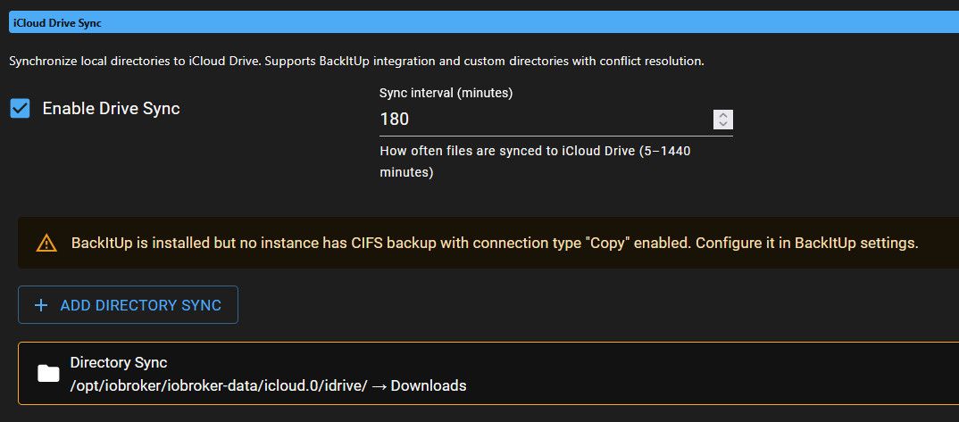

          Hier kommt dann eine Fehlermeldung:
          2026-04-20 20:05:04.767 - debug: icloud.0 (95981) Drive Sync: starting sync for 1 entries
          2026-04-20 20:05:06.868 - warn: icloud.0 (95981) Drive Sync: entry sync_1776691363262_28bt5d (/opt/iobroker/iobroker-data/icloud.0/idrive/) failed: Internal Server Error
          2026-04-20 20:05:06.872 - debug: icloud.0 (95981) Drive Sync: completed
          Schreibberechtigungen sind vorhanden:
          iobroker@iobroker:~$ ls -la /opt/iobroker/iobroker-data/icloud.0/idrive/
          total 8
          drwxrwxr-x+ 2 iobroker iobroker 4096 Apr 20 15:25 .
          drwxrwxr-x+ 3 iobroker iobroker 4096 Apr 20 15:25 ..

            Das war das einzige was ich nicht getestet habe - download von dateien - fehler ist gefunden

              0.6.4 (2026-04-20)
              • (ticaki) Drive Sync: fixed
              • (ticaki) Drive Sync admin UI: added local folder browser for directory-type sync entries
              @marc-berg das hat was länger gedauert
              da kommt noch ne 6.5 gleich hinter her - man kann die dialogboxen nicht scrollen
              0.6.5 (2026-04-20)
              • (ticaki) Drive Sync admin UI: both the iCloud Drive folder browser and the local folder browser are now scrollable (list capped at 300 px height)
              hm auf dem dev-server ist bei lokal ein button - auf meinem produktiv system nicht - kein plan - mal morgen abend gucken.

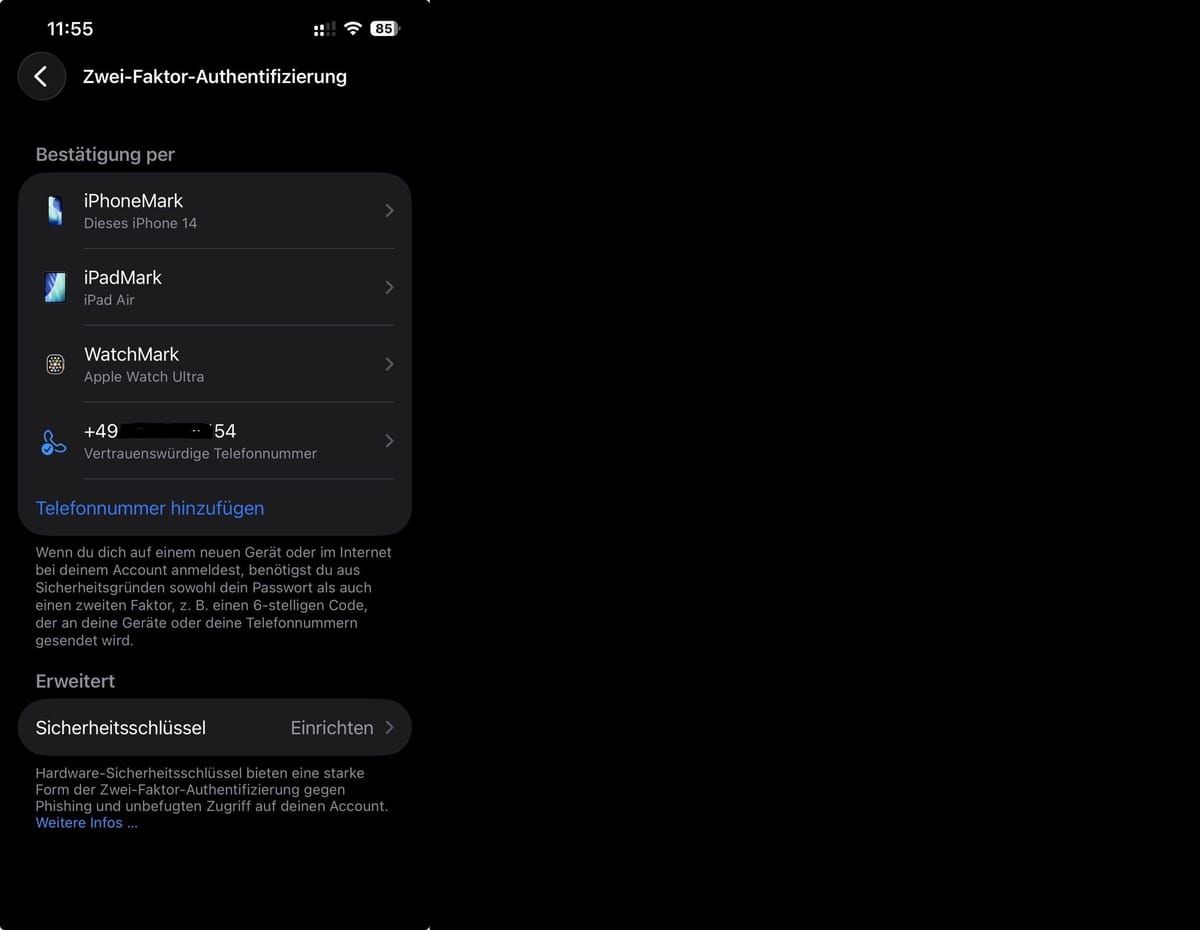

                    2026-04-21 08:12:03.817 - warn: admin.0 (1095) icloud has an invalid jsonConfig: [{"instancePath":"/items/_tabFindMy/items/_findMyDevices","schemaPath":"#/additionalProperties","keyword":"additionalProperties","params":{"additionalProperty":"attr"},"message":"must NOT have additional properties"},{"instancePath":"/items/_tabFindMy/items/_findMyDevices","schemaPath":"#/patternProperties/%5E.%2B/allOf/18/if","keyword":"if","params":{"failingKeyword":"then"},"message":"must match \"then\" schema"},{"instancePath":"/items/_tabFindMy","schemaPath":"#/properties/items/patternProperties/%5E.%2B/allOf/11/if","keyword":"if","params":{"failingKeyword":"then"},"message":"must match \"then\" schema"},{"instancePath":"","schemaPath":"#/if","keyword":"if","params":{"failingKeyword":"then"},"message":"must match \"then\" schema"}]
                    2026-04-21 08:12:31.774 - warn: icloud.0 (447489) MFA required — enter the 6-digit Apple code into state mfa.code
                    Proxmox 3 Node HA-Cluster Mini-PC N150 mit 32 GB RAM und 3x1TB shared SSDs via Linstor. VM- iobroker ,OpenCCU / LXC - Adguard, Traccar, iSpy, Fileserver (emby, MiniDLNA)...etc.
                      jsonConfig.json warnungen in meinen Adaptern bitte ignorieren, das sind in 90% der Fälle fehler im Adminschema und nicht in meiner Config :)
                      Zu der 2. Warnung bin ich dann mal so frech und sage: Lese bildet :D
                      https://github.com/ticaki/ioBroker.icloud/blob/main/README_GERMAN.md#zwei-faktor-authentifizierung-2fa
                      Wenns das nicht war nochmal melden.

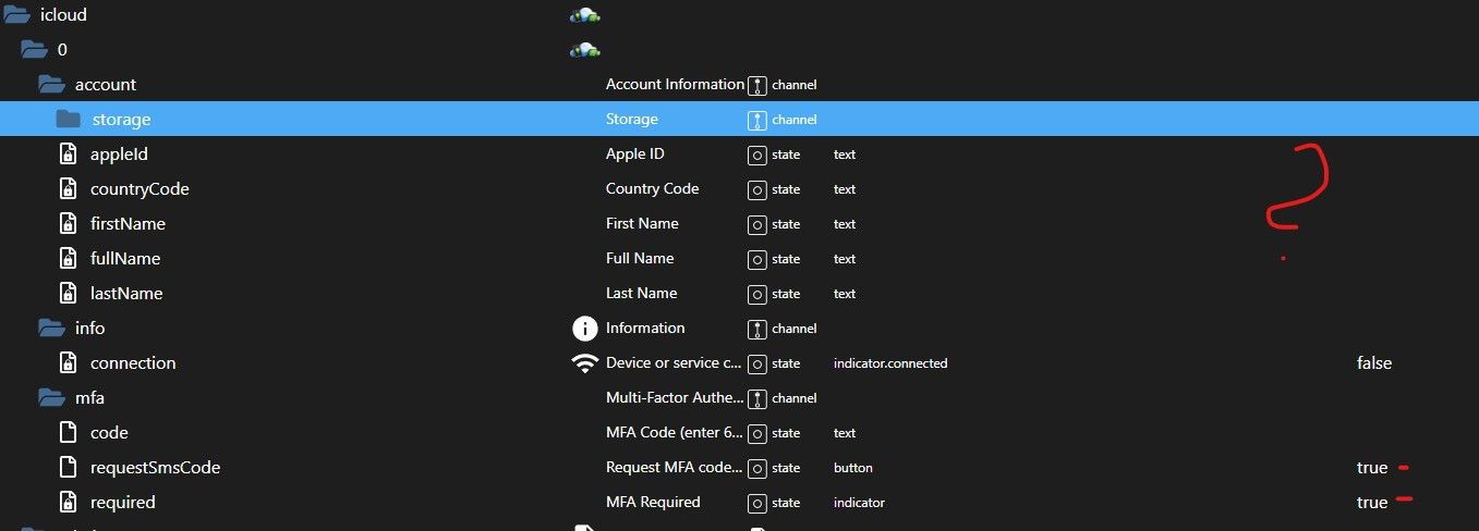

                              Ich denke, das habe ich gemacht:
                              Werden die Objekte appleid usw. erst nach dem connect beschrieben?

                                requestSmsCode ist ein Button. Nach Umstellung vom Expertmodus habe ich den dann gedrückt:
                                2026-04-21 11:48:00.233 - error: icloud.0 (447489) Failed to request SMS code: SMS request failed (403):
                                2026-04-21 11:48:56.703 - warn: icloud.0 (453246) MFA required — enter the 6-digit Apple code into state mfa.code
                                2026-04-21 11:49:30.243 - error: icloud.0 (453246) Failed to request SMS code: SMS request failed (412): {
                                "trustedPhoneNumbers" : [ {
                                "numberWithDialCode" : "+49 •••• •••••54",
                                "nonFTEU" : true,
                                "obfuscatedNumber" : "•••• •••••54",
                                "lastTwoDigits" : "54",
                                "pushMode" : "sms",
                                "i

                                  stoppe den adapter warte ne minute starte dann und mache es in einem Zug - ich hab noch nicht getestet was passiert wenn man sich da zeit lässt.
                                  Den button sieht man im darkthema nicht gell? Ist mir auch aufgefallen.

                                      @ticaki sagte:
                                      Funktioniert leider nicht.
                                      Ich starte den Adapter, dann erscheint "MFA requiered.....", dann drücke ich den Button und es erscheint der Fehler wie o.g.
