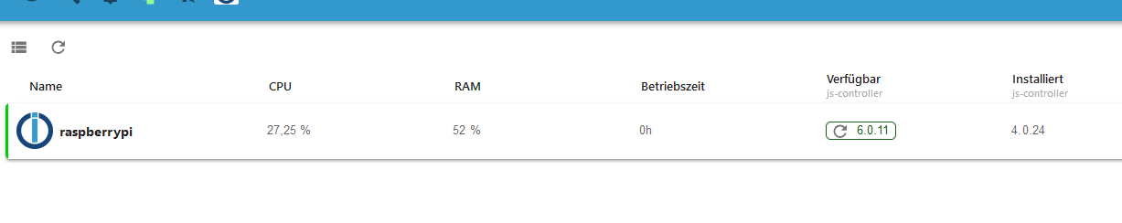

    Hallo habe einen Raspberry Pi 4 mit Iobroker der seit ca 2 Jahren nicht aktualisiert wurde.
    Leider bekomme ich den JS-Controller nicht aktualisiert.
    Wie gehe ich hier vor?

                  @thomas-braun Ach so. Die meldung von iob diag ist folgende:
                  *** iob diag is starting up, please wait ***
                  iob diag needs to be updated. Please execute 'iobroker fix' first.
                  pi@raspberrypi:~ $

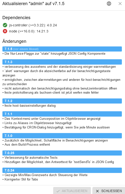

                      @thomas-braun Das ist jetzt die Ausgabe von iob diag

                      nodejs:                 N/A
                      /usr/bin/node           v14.21.3
                      /usr/bin/npm            6.14.18
                      /usr/bin/npx            6.14.18
                      /usr/bin/corepack       0.15.1
                      *** nodejs is NOT correctly installed ***
                      nodejs:
                        Installed: 14.21.3-deb-1nodesource1
                        Candidate: 14.21.3-deb-1nodesource1

                      Adapter    "admin"        : 7.1.5    , installed 6.3.5  [Updatable]
                      Adapter    "backitup"     : 3.0.25   , installed 2.6.23 [Updatable]
                      Adapter    "bosesoundtouch": 0.11.1  , installed 0.10.3 [Updatable]
                      Adapter    "discovery"    : 5.0.0    , installed 3.1.0  [Updatable]
                      Adapter    "fronius"      : 2.1.1    , installed 1.1.3  [Updatable]
                      Adapter    "gira-iot"     : 0.5.0    , installed 0.1.3  [Updatable]
                      Adapter    "gruenbeck"    : 0.0.43   , installed 0.0.42 [Updatable]
                      Adapter    "hmip"         : 1.24.3   , installed 1.20.0 [Updatable]
                      Adapter    "javascript"   : 8.8.3    , installed 7.0.3  [Updatable]
                      Controller "js-controller": 6.0.11   , installed 4.0.24 [Updatable]
                      Adapter    "knx"          : 2.0.28   , installed 2.0.17 [Updatable]
                      Adapter    "node-red"     : 5.2.1    , installed 4.0.3  [Updatable]
                      Adapter    "openknx"      : 0.9.0    , installed 0.5.3  [Updatable]
                      Adapter    "simple-api"   : 2.8.0    , installed 2.7.2  [Updatable]
                      Adapter    "socketio"     : 6.7.1    , installed 6.5.2  [Updatable]
                      Adapter    "telegram"     : 3.9.0    , installed 1.16.0 [Updatable]
                      Adapter    "web"          : 6.2.5    , installed 4.3.0  [Updatable]
                      Adapter    "whatsapp-cmb" : 0.3.0    , installed 0.2.3  [Updatable]
                      Adapter    "ws"           : 2.6.2    , installed 1.3.0  [Updatable]
                      Objects and States
                      Objects:        2403
                      States:         1719
                      Hit:1 http://raspbian.raspberrypi.org/raspbian bullseye InRelease
                      Hit:2 http://archive.raspberrypi.org/debian bullseye InRelease
                      Hit:3 https://deb.nodesource.com/node_14.x bullseye InRelease
                      Reading package lists... Done
                      Pending Updates: 1

                      nodejs:                 N/A
                      Recommended versions are nodejs 16.20.2 and npm 8.19.4
                      Wrong installation path detected. This needs to be fixed.
                      Please execute
                      iob nodejs-update
                      to fix these errors.
