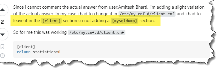

      simatecS Offline
      simatecS Offline
      simatec
      @metaxa direkt das erst Google Ergebnis sollte deinen Fehler beheben
      https://stackoverflow.com/questions/52423595/mysqldump-couldnt-execute-unknown-table-column-statistics-in-information-sc
      • Besuche meine Github Seite
      • HowTo Restore ioBroker
      metaxaM 1 Antwort Letzte Antwort

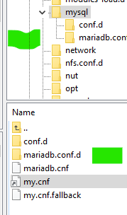

          metaxaM Offline
          metaxaM Offline
          metaxa
          @simatec ich habe soeben deinen Link durchgelesen, hoffentlich richtig verstanden und umgesetzt.
          "/etc/mysql/my.cnf" editiert
          # The MariaDB configuration file
          # The MariaDB/MySQL tools read configuration files in the following order:
          # 0. "/etc/mysql/my.cnf" symlinks to this file, reason why all the rest is read.
          # 1. "/etc/mysql/mariadb.cnf" (this file) to set global defaults,
          # 2. "/etc/mysql/conf.d/*.cnf" to set global options.
          # 3. "/etc/mysql/mariadb.conf.d/*.cnf" to set MariaDB-only options.
          # 4. "~/.my.cnf" to set user-specific options.
          # If the same option is defined multiple times, the last one will apply.
          # One can use all long options that the program supports.
          # Run program with --help to get a list of available options and with
          # --print-defaults to see which it would actually understand and use.
          # If you are new to MariaDB, check out https://mariadb.com/kb/en/basic-mariadb-articles/
          # This group is read both by the client and the server
          # use it for options that affect everything
          [client-server]
          # Port or socket location where to connect
          # port = 3306
          socket = /run/mysqld/mysqld.sock
          # Import all .cnf files from configuration directory
          !includedir /etc/mysql/conf.d/
          !includedir /etc/mysql/mariadb.conf.d/
          [mysqldump]
          column-statistics=0
          Leider keine Verbesserung, nur das Log liest sich etwas anders:
          backitup.0
          2024-09-06 09:37:55.028	error	[iobroker/clean] Backup files not deleted from /opt/iobroker/backups because some errors.
          backitup.0
          2024-09-06 09:37:09.653	error	[iobroker] Error: Command failed: /usr/bin/mysqldump -u andreas -p**** ioBroker -h 192.168.0.98 -P 3306 --quick --single-transaction > /opt/iobroker/backups/mysql_2024_09_06-09_37_09_backupiobroker.sql/usr/bin/mysqldump: unknown variable 'column-statistics=0'
          backitup.0
          2024-09-06 09:37:09.653	error	[iobroker/mysql] /usr/bin/mysqldump: unknown variable 'column-statistics=0'
          backitup.0
          2024-09-06 09:37:09.651	error	[iobroker/mysql] Error: Command failed: /usr/bin/mysqldump -u andreas -p**** ioBroker -h 192.168.0.98 -P 3306 --quick --single-transaction > /opt/iobroker/backups/mysql_2024_09_06-09_37_09_backupiobroker.sql
          backitup.0
          backitup.0
          backitup.0
          backitup.0
          Bitte um Hilfe!

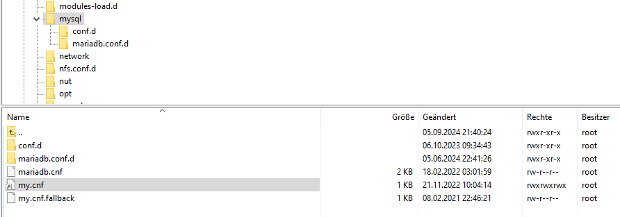

            @metaxa
            Das hast Du auch mal probiert?
            HmIP|ZigBee|Tasmota|Unifi
            Zabbix Certified Specialist
            • CodierknechtC Codierknecht
              @metaxa
              metaxaM Offline
              metaxaM Offline
              metaxa
              @codierknecht Ja gelesen, aber dieses File gibt es bei mir nicht:

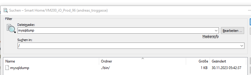

                      Und nochwas, dein Bild:
                      348b29fd-c803-47b6-ba7f-59d1be9ef255-1725569958953-026f2c8a-bb8f-4740-b404-e13fc1eef476-image.png
                      Zeigt aus meiner Sicht, dass es eine mysqldump in /bin gibt, du rufst aber die in /usr/bin auf. Zwei Versionen?
                      Edit: wohl doch eher ein Link.

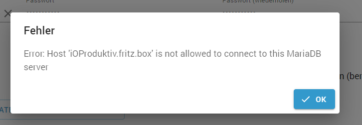

                                        @Marc-Berg neues Problem:
                                        Hat jemand eine Idee?
