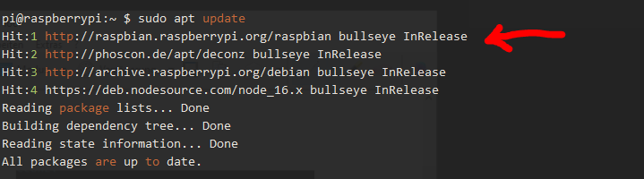

          @thomas-braun hier die Infos
          pi@raspberrypi:~ $ sudo apt update
          Hit:1 http://raspbian.raspberrypi.org/raspbian bullseye InRelease
          Hit:2 http://phoscon.de/apt/deconz bullseye InRelease
          Hit:3 http://archive.raspberrypi.org/debian bullseye InRelease
          Hit:4 https://deb.nodesource.com/node_16.x bullseye InRelease
          Reading package lists... Done
          Building dependency tree... Done
          Reading state information... Done
          All packages are up to date.
          pi@raspberrypi:~ $ apt policy deconz
          deconz:
            Installed: 2.20.01-raspbian-buster-stable
            Candidate: 2.20.01-raspbian-buster-stable
            Version table:
           *** 2.20.01-raspbian-buster-stable 500
                  500 http://phoscon.de/apt/deconz bullseye/main armhf Packages
                  100 /var/lib/dpkg/status
          pi@raspberrypi:~ $

            @gabe
            Hast du denn einen X-Server laufen?
            iob diag
            sagt?
            haselchenH G 2 Antworten Letzte Antwort

                                  @thomas-braun
                                  pi@raspberrypi:~ $ sudo apt full-upgrade
                                  Calculating upgrade... Done
                                  0 upgraded, 0 newly installed, 0 to remove and 0 not upgraded.
                                  G 1 Antwort Letzte Antwort

                                    @thomas-braun
