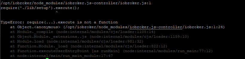

                                  • G
                                    gluecksmann @crunchip last edited by
                                    @crunchip
                                    sieht nicht gut aus...oder?
                                    • Thomas Braun
                                      Thomas Braun Most Active last edited by Thomas Braun
                                      @gluecksmann
                                      Bitte keine Urlaubsbildchen aus Konsolistan.
                                      Text auch als Text (in CodeTags eingebettet) posten.
                                      Kurz: Du stehst im falschen Verzeichnis.
                                      Das muss in /opt/iobroker ausgeführt werden.
                                      G 1 Reply Last reply Reply Quote 1

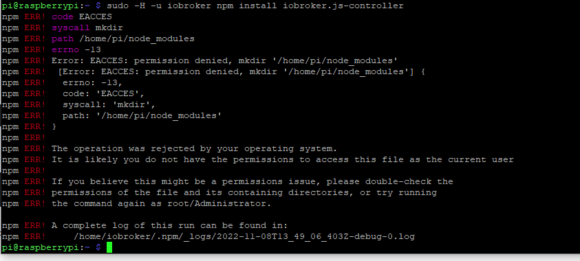

                                      • G
                                        gluecksmann @Thomas Braun last edited by
                                        @thomas-braun ```
                                        pi@raspberrypi:~ $ sudo -H -u iobroker npm install iobroker.js-controller
                                        npm ERR! code EACCES
                                        npm ERR! syscall mkdir
                                        npm ERR! path /home/pi/node_modules
                                        npm ERR! errno -13
                                        npm ERR! Error: EACCES: permission denied, mkdir '/home/pi/node_modules'
                                        npm ERR! [Error: EACCES: permission denied, mkdir '/home/pi/node_modules'] {
                                        npm ERR! errno: -13,
                                        npm ERR! code: 'EACCES',
                                        npm ERR! syscall: 'mkdir',
                                        npm ERR! path: '/home/pi/node_modules'
                                        npm ERR! }
                                        npm ERR!
                                        npm ERR! The operation was rejected by your operating system.
                                        npm ERR! It is likely you do not have the permissions to access this file as the current user
                                        npm ERR!
                                        npm ERR! If you believe this might be a permissions issue, please double-check the
                                        npm ERR! permissions of the file and its containing directories, or try running
                                        npm ERR! the command again as root/Administrator.
                                        npm ERR! /home/iobroker/.npm/_logs/2022-11-08T13_49_06_403Z-debug-0.log
                                        pi@raspberrypi:~ $
                                        • Thomas Braun
                                          Thomas Braun Most Active @gluecksmann last edited by Thomas Braun
                                          @gluecksmann
                                          Du stehst noch im falschen Haus.
                                          cd /opt/iobroker/
                                          Tip: Die Steuerzeichen gehören in eine neue, eigene Zeile.
                                          G 1 Reply Last reply Reply Quote 0
