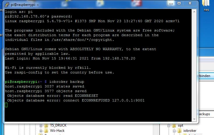

                                        geht immer noch nix 😞
                                        pi@raspberrypi:~ $ iobroker backup
                                        host.raspberrypi 3019 states saved
                                        host.raspberrypi 3579 objects saved
                                         Objects database error: read ECONNRESET
                                         Objects database error: connect ECONNREFUSED 127.0.0.1:9001
