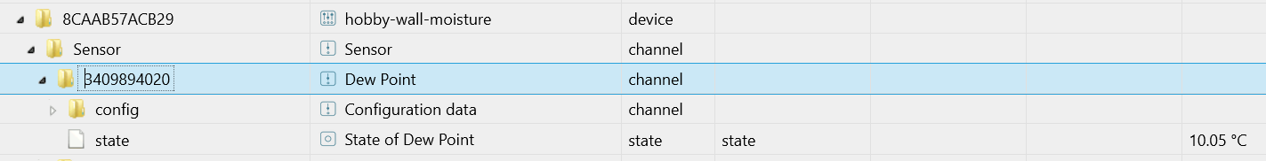

          example: currently we have the following path and ID
          leading to
          esphome.0.8CAAB57ACB29.Sensor.3409894020.state
          more convenient would be
          0_userdata.0.moisture.hobbyroom.hobby-wall-moisture.Dew Point.state
          with the correspondence / replacement:
          The user defined path
          replaces
          esphome.0
          The name of the ESP
          hobby-wall-moisture
          replaces the MAC of the ESP
          8CAAB57ACB29
          and the name of the sensor data point
          Dew Point
          replaces the random ID#
          3409894020
          The descriptor
          Sensor
          can be dropped
          E 1 Antwort Letzte Antwort
