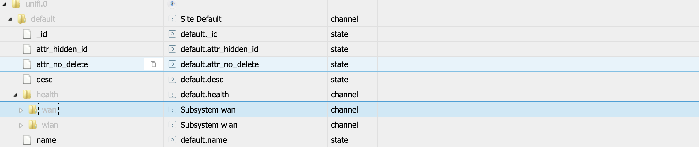

                                            SaschaS last edited by
                                            Ich habe ebenfalls ein USG im Einsatz und bin mit dem Controller auf 5.12.35-12979-1.
                                            Erhalte im LOG:
                                            host.raspberrypi	2020-02-13 21:06:46.266	info	instance system.adapter.unifi.0 terminated with code 0 (NO_ERROR)
                                            host.raspberrypi	2020-02-13 21:06:46.265	error	Caught by controller[0]: at traverseArray (/opt/iobroker/node_modules/iobroker.unifi/main.js:165:7)
                                            host.raspberrypi	2020-02-13 21:06:46.265	error	Caught by controller[0]: at Array.every (<anonymous>)
                                            host.raspberrypi	2020-02-13 21:06:46.265	error	Caught by controller[0]: at /opt/iobroker/node_modules/iobroker.unifi/main.js:168:7
                                            host.raspberrypi	2020-02-13 21:06:46.265	error	Caught by controller[0]: at traverse (/opt/iobroker/node_modules/iobroker.unifi/main.js:155:5)
                                            host.raspberrypi	2020-02-13 21:06:46.265	error	Caught by controller[0]: at traverseObject (/opt/iobroker/node_modules/iobroker.unifi/main.js:178:27)
                                            host.raspberrypi	2020-02-13 21:06:46.264	error	Caught by controller[0]: at /opt/iobroker/node_modules/iobroker.unifi/main.js:288:13
                                            host.raspberrypi	2020-02-13 21:06:46.264	error	Caught by controller[0]: at traverse (/opt/iobroker/node_modules/iobroker.unifi/main.js:155:5)
                                            host.raspberrypi	2020-02-13 21:06:46.264	error	Caught by controller[0]: at traverseObject (/opt/iobroker/node_modules/iobroker.unifi/main.js:184:7)
                                            host.raspberrypi	2020-02-13 21:06:46.263	error	Caught by controller[0]: at traverse (/opt/iobroker/node_modules/iobroker.unifi/main.js:156:32)
                                            host.raspberrypi	2020-02-13 21:06:46.263	error	Caught by controller[0]: at /opt/iobroker/node_modules/iobroker.unifi/main.js:292:58
                                            host.raspberrypi	2020-02-13 21:06:46.262	error	Caught by controller[0]: TypeError: Cannot read property 'subsystem' of null
                                            unifi.0	2020-02-13 21:06:39.559	info	(30725) Terminated (NO_ERROR): Without reason
                                            unifi.0	2020-02-13 21:06:39.556	info	(30725) terminating
                                            unifi.0	2020-02-13 21:06:39.495	info	(30725) cleaned everything up...
                                            unifi.0	2020-02-13 21:06:39.493	error	(30725) TypeError: Cannot read property 'subsystem' of null at /opt/iobroker/node_modules/iobroker.unifi/main.js:292:58 at traverse (/opt/iobroker/node_modules/iobroker.unifi/main.js:156:32)
                                            unifi.0	2020-02-13 21:06:39.491	error	(30725) uncaught exception: Cannot read property 'subsystem' of null
                                            unifi.0	2020-02-13 21:06:39.415	info	(30725) getSitesStats: default
                                            unifi.0	2020-02-13 21:06:36.016	info	(30725) controller = 192.168.1.17:8443
                                            Es wurden offenbar auch einige Datenpunkte angelegt, aber nicht beschrieben:
                                            Jemand eine Idee was man noch versuchen kann, außer Downgraden..
