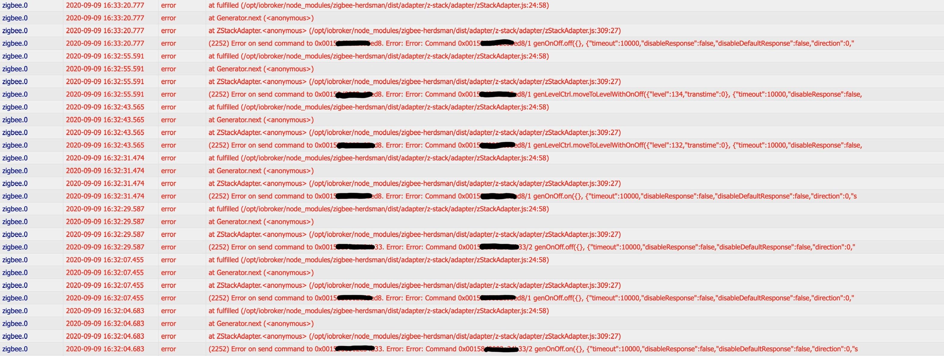

          @Thomas-Braun Zwischendurch erst einmal danke für deine Mühe und Hilfe.
          Leider sind die beiden Adapter noch immer auf rot.
          Der Fehler-Log sieht so aus:
          2020-09-28 13:21:00.300 - info: host.raspberrypi Restart adapter system.adapter.zigbee.0 because enabled
          2020-09-28 13:21:30.328 - info: host.raspberrypi instance system.adapter.zigbee.0 started with pid 2930
          2020-09-28 13:21:30.954 - error: host.raspberrypi Caught by controller[0]: /opt/iobroker/node_modules/iobroker.zigbee/node_modules/zigbee-herdsman/node_modules/bindings/bindings.js:121
          2020-09-28 13:21:30.954 - error: host.raspberrypi Caught by controller[0]: throw e;
          2020-09-28 13:21:30.955 - error: host.raspberrypi Caught by controller[0]: ^
          2020-09-28 13:21:30.955 - error: host.raspberrypi Caught by controller[0]: Error: libnode.so.64: cannot open shared object file: No such file or directory
          2020-09-28 13:21:30.955 - error: host.raspberrypi Caught by controller[0]: at Object.Module._extensions..node (internal/modules/cjs/loader.js:1187:18)
          2020-09-28 13:21:30.955 - error: host.raspberrypi Caught by controller[0]: at Module.load (internal/modules/cjs/loader.js:985:32)
          2020-09-28 13:21:30.955 - error: host.raspberrypi Caught by controller[0]: at Function.Module._load (internal/modules/cjs/loader.js:878:14)
          2020-09-28 13:21:30.956 - error: host.raspberrypi Caught by controller[0]: at Module.require (internal/modules/cjs/loader.js:1025:19)
          2020-09-28 13:21:30.956 - error: host.raspberrypi Caught by controller[0]: at require (internal/modules/cjs/helpers.js:72:18)
          2020-09-28 13:21:30.956 - error: host.raspberrypi Caught by controller[0]: at bindings (/opt/iobroker/node_modules/iobroker.zigbee/node_modules/zigbee-herdsman/node_modules/bindings/bindings.js:112:48)
          2020-09-28 13:21:30.956 - error: host.raspberrypi Caught by controller[0]: at Object. (/opt/iobroker/node_modules/iobroker.zigbee/node_modules/zigbee-herdsman/node_modules/@serialport/bindings/lib/linux.js:2:36)
          2020-09-28 13:21:30.956 - error: host.raspberrypi Caught by controller[0]: at Module._compile (internal/modules/cjs/loader.js:1137:30)
          2020-09-28 13:21:30.957 - error: host.raspberrypi Caught by controller[0]: at Object.Module._extensions..js (internal/modules/cjs/loader.js:1157:10)
          2020-09-28 13:21:30.957 - error: host.raspberrypi Caught by controller[0]: at Module.load (internal/modules/cjs/loader.js:985:32)
          2020-09-28 13:21:30.957 - error: host.raspberrypi instance system.adapter.zigbee.0 terminated with code 1 (JS_CONTROLLER_STOPPED)

          @Jona
          Hast du deine Adapter nach dem Update auf node 12 neu installiert?
          iobroker rebuild apdatername --install
          Siehe auch hier:
          https://forum.iobroker.net/topic/22867/how-to-node-js-für-iobroker-richtig-updaten
          (Ich hatte übrigens auch immer diverse Probleme mit dem CC2531 und habe ihn dann auf Anraten des Forums in die Tonne gekloppt. Das Teil ist für größere Mesh Netze nur bedingt geeignet. Mal klappt es, mal nicht...)
          J 2 Antworten Letzte Antwort
          • F fabwal
            @Jona
            Siehe auch hier:
            Jona
            #33
            @fabwal Super Tipp - das war es! Nun kann ich Zigbee und BLE wieder nutzen. Mal schauen, ob die Fehler nach dem Richten meiner Nodejs Installation weiterhin auftauchen.
