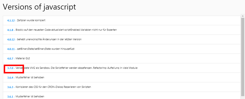

                                        • bahnuhr
                                          bahnuhr Forum Testing Most Active last edited by
                                          admin: 3.6.0
                                          javascript: 4.1.12
