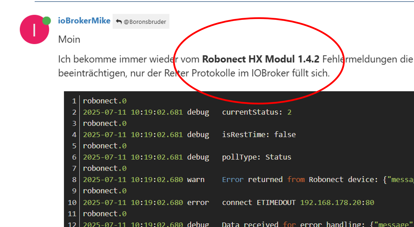

              Ich bekomme immer wieder vom Robonect HX Modul 1.4.2 Fehlermeldungen die aber die Funktion nicht beeinträchtigen, nur der Reiter Protokolle im IOBroker füllt sich.
              robonect.0
              2025-07-11 10:19:02.681	debug	currentStatus: 2
              robonect.0
              2025-07-11 10:19:02.681	debug	isRestTime: false
              robonect.0
              2025-07-11 10:19:02.681	debug	pollType: Status
              robonect.0
              2025-07-11 10:19:02.680	warn	Error returned from Robonect device: {"message":"connect ETIMEDOUT 192.168.178.20:80","name":"Error","stack":"Error: connect ETIMEDOUT 192.168.178.20:80\n at Function.AxiosError.from (/opt/iobroker/node_modules/axios/lib/core/AxiosError.js:92:14)\n at RedirectableRequest.handleRequestError (/opt/iobroker/node_modules/axios/lib/adapters/http.js:620:25)\n at RedirectableRequest.emit (node:events:524:28)\n at RedirectableRequest.emit (node:domain:489:12)\n at ClientRequest.eventHandlers.<computed> (/opt/iobroker/node_modules/follow-redirects/index.js:38:24)\n at ClientRequest.emit (node:events:536:35)\n at ClientRequest.emit (node:domain:489:12)\n at emitErrorEvent (node:_http_client:101:11)\n at Socket.socketErrorListener (node:_http_client:504:5)\n at Socket.emit (node:events:524:28)\n at Axios.request (/opt/iobroker/node_modules/axios/lib/core/Axios.js:45:41)\n at processTicksAndRejections (node:internal/process/task_queues:95:5)","config":{"transitional":{"silentJSONParsing":true,"forcedJSONParsing":true,"clarifyTimeoutError":false},"adapter":["xhr","http","fetch"],"transformRequest":[null],"transformResponse":[null],"timeout":0,"xsrfCookieName":"XSRF-TOKEN","xsrfHeaderName":"X-XSRF-TOKEN","maxContentLength":-1,"maxBodyLength":-1,"env":{},"headers":{"Accept":"application/json, text/plain, */*","User-Agent":"axios/1.10.0","Accept-Encoding":"gzip, compress, deflate, br"},"auth":{"username":"xxxxx","password":"yyyyy"},"params":{"cmd":"status"},"method":"get","url":"http://192.168.178.20/api/json","allowAbsoluteUrls":true},"code":"ETIMEDOUT"}
              robonect.0
              2025-07-11 10:19:02.680	error	connect ETIMEDOUT 192.168.178.20:80
              robonect.0
              2025-07-11 10:19:02.680	debug	Data received for error handling: {"message":"connect ETIMEDOUT 192.168.178.20:80","name":"Error","stack":"Error: connect ETIMEDOUT 192.168.178.20:80\n at Function.AxiosError.from (/opt/iobroker/node_modules/axios/lib/core/AxiosError.js:92:14)\n at RedirectableRequest.handleRequestError (/opt/iobroker/node_modules/axios/lib/adapters/http.js:620:25)\n at RedirectableRequest.emit (node:events:524:28)\n at RedirectableRequest.emit (node:domain:489:12)\n at ClientRequest.eventHandlers.<computed> (/opt/iobroker/node_modules/follow-redirects/index.js:38:24)\n at ClientRequest.emit (node:events:536:35)\n at ClientRequest.emit (node:domain:489:12)\n at emitErrorEvent (node:_http_client:101:11)\n at Socket.socketErrorListener (node:_http_client:504:5)\n at Socket.emit (node:events:524:28)\n at Axios.request (/opt/iobroker/node_modules/axios/lib/core/Axios.js:45:41)\n at processTicksAndRejections (node:internal/process/task_queues:95:5)","config":{"transitional":{"silentJSONParsing":true,"forcedJSONParsing":true,"clarifyTimeoutError":false},"adapter":["xhr","http","fetch"],"transformRequest":[null],"transformResponse":[null],"timeout":0,"xsrfCookieName":"XSRF-TOKEN","xsrfHeaderName":"X-XSRF-TOKEN","maxContentLength":-1,"maxBodyLength":-1,"env":{},"headers":{"Accept":"application/json, text/plain, */*","User-Agent":"axios/1.10.0","Accept-Encoding":"gzip, compress, deflate, br"},"auth":{"username":"xxxxx","password":"yyyyy"},"params":{"cmd":"status"},"method":"get","url":"http://192.168.178.20/api/json","allowAbsoluteUrls":true},"code":"ETIMEDOUT"}
              robonect.0
              2025-07-11 10:18:23.383	debug	Polling API for data [{"cmd":"status"}] started
              Habe ein Update der Application von 1.3b auf 1.5 gemacht.
              Bei beiden Version war es dasselbe.
              Boronsbruder 1 Reply Last reply Reply Quote 0

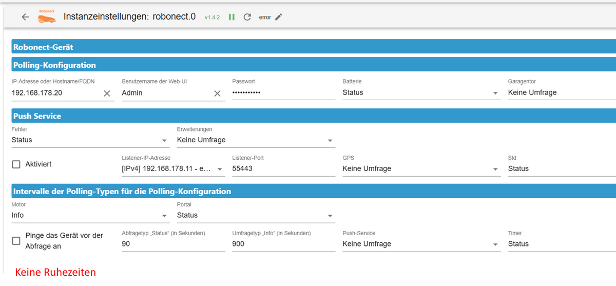

                              kannst du mal die Einstellungen deiner Instanz posten?
                              Ich habe zum Beispiel
                              aktiviert.
                              Evtl. verhindert das Timeouts?
                              Achja, führt bei mir aber immer mal wieder zu
                              	warn	No connection to lawn mower (Not able to ping it). Check network connection.
                              Einträgen, was aber wahrscheinlich an meinem Setup mit einer WLAN-Brücke liegt
                              I V 2 Replies Last reply Reply Quote 0
                              • I
                                ioBrokerMike @Boronsbruder last edited by
                                @boronsbruder sagte in Neuer Robonect HX Adapter:
                                Bitte sehr.
                                Werde mal den Ping reinnehmen.
                                • Boronsbruder
                                  Boronsbruder @ioBrokerMike last edited by
                                  @iobrokermike
                                  Hmm, ich seh da auch nichts, was die Timeouts auslösen könnte...
                                  I 1 Reply Last reply Reply Quote 0
