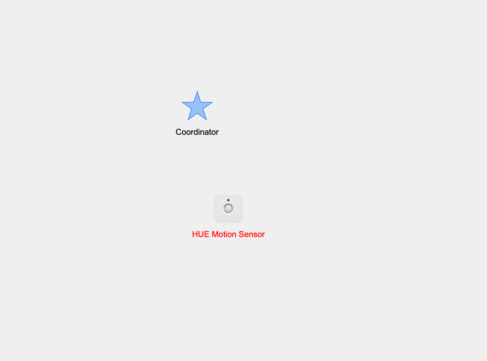

    Der Adapter bleibt nach wie vor gelb

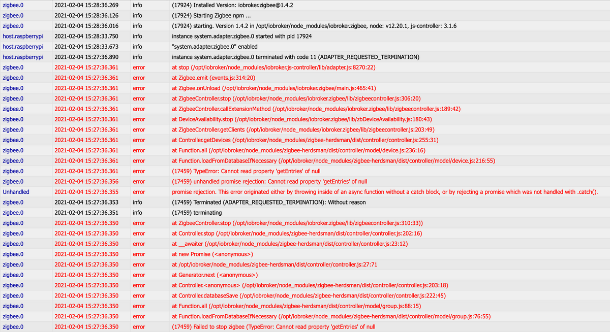

    2021-02-04 14:23:06.071 - info: host.raspberrypi "system.adapter.zigbee.0" enabled
    2021-02-04 14:23:06.126 - info: host.raspberrypi instance system.adapter.zigbee.0 started with pid 1874
    2021-02-04 14:23:08.278 - info: zigbee.0 (1874) starting. Version 1.3.1 in /opt/iobroker/node_modules/iobroker.zigbee, node: v10.23.2, js-controller: 3.1.6
    2021-02-04 14:23:08.409 - info: zigbee.0 (1874) Starting Zigbee npm ...
    2021-02-04 14:24:10.393 - error: zigbee.0 (1874) Failed to start Zigbee
    2021-02-04 14:24:10.395 - error: zigbee.0 (1874) Error: AREQ - ZDO - stateChangeInd after 60000ms
    at Timeout.waiter.timer.setTimeout [as _onTimeout] (/opt/iobroker/node_modules/zigbee-herdsman/dist/utils/waitress.js:46:35)
    at ontimeout (timers.js:436:11)
    at tryOnTimeout (timers.js:300:5)
    at listOnTimeout (timers.js:263:5)
    at Timer.processTimers (timers.js:223:10)
    2021-02-04 14:24:20.398 - info: zigbee.0 (1874) Try to reconnect. 1 attempts left
    2021-02-04 14:24:20.399 - info: zigbee.0 (1874) Starting Zigbee npm ...
    2021-02-04 14:24:20.611 - error: zigbee.0 (1874) Failed to start Zigbee
    2021-02-04 14:24:20.612 - error: zigbee.0 (1874) Error: Error while opening serialport 'Error: Error Resource temporarily unavailable Cannot lock port'
    at Znp. (/opt/iobroker/node_modules/zigbee-herdsman/dist/adapter/z-stack/znp/znp.js:136:32)
    at Generator.next ()
    at /opt/iobroker/node_modules/zigbee-herdsman/dist/adapter/z-stack/znp/znp.js:27:71
    at new Promise ()
    at __awaiter (/opt/iobroker/node_modules/zigbee-herdsman/dist/adapter/z-stack/znp/znp.js:23:12)
    at SerialPort.serialPort.open (/opt/iobroker/node_modules/zigbee-herdsman/dist/adapter/z-stack/znp/znp.js:134:49)
    at SerialPort._error (/opt/iobroker/node_modules/zigbee-herdsman/node_modules/@serialport/stream/lib/index.js:198:14)
    at binding.open.then.err (/opt/iobroker/node_modules/zigbee-herdsman/node_modules/@serialport/stream/lib/index.js:242:12)
    2021-02-04 14:24:28.755 - info: web.0 (1723) ==>Connected system.user.admin from ::ffff:192.168.0.2
    2021-02-04 14:24:28.782 - info: web.0 (1723) <==Disconnect system.user.admin from ::ffff:192.168.0.2 vis.0
    2021-02-04 14:24:29.948 - info: web.0 (1723) ==>Connected system.user.admin from ::ffff:192.168.0.2
    2021-02-04 14:25:00.044 - info: host.raspberrypi instance system.adapter.dwd.0 started with pid 2382
    2021-02-04 14:25:02.250 - info: dwd.0 (2382) starting. Version 2.5.2 in /opt/iobroker/node_modules/iobroker.dwd, node: v10.23.2, js-controller: 3.1.6
    2021-02-04 14:25:07.297 - info: dwd.0 (2382) Terminated (ADAPTER_REQUESTED_TERMINATION): Without reason
    2021-02-04 14:25:07.828 - info: host.raspberrypi instance system.adapter.dwd.0 terminated with code 11 (ADAPTER_REQUESTED_TERMINATION)
    2021-02-04 14:25:48.892 - info: host.raspberrypi stopInstance system.adapter.zigbee.0 (force=false, process=true)
    2021-02-04 14:25:48.896 - info: host.raspberrypi stopInstance system.adapter.zigbee.0 send kill signal
    2021-02-04 14:25:48.906 - info: zigbee.0 (1874) Got terminate signal TERMINATE_YOURSELF
    2021-02-04 14:25:48.910 - info: zigbee.0 (1874) cleaned everything up...
    2021-02-04 14:25:48.922 - info: zigbee.0 (1874) Zigbee: disabling joining new devices.
    2021-02-04 14:25:48.927 - error: zigbee.0 (1874) Failed to stop zigbee (TypeError: Cannot read property 'getEntries' of null
    at Function.loadFromDatabaseIfNecessary (/opt/iobroker/node_modules/zigbee-herdsman/dist/controller/model/group.js:76:55)
    at Function.all (/opt/iobroker/node_modules/zigbee-herdsman/dist/controller/model/group.js:88:15)
    at Controller.databaseSave (/opt/iobroker/node_modules/zigbee-herdsman/dist/controller/controller.js:219:45)
    at Controller. (/opt/iobroker/node_modules/zigbee-herdsman/dist/controller/controller.js:200:18)
    at /opt/iobroker/node_modules/zigbee-herdsman/dist/controller/controller.js:27:71
    at new Promise ()
    at __awaiter (/opt/iobroker/node_modules/zigbee-herdsman/dist/controller/controller.js:23:12)
    at Controller.stop (/opt/iobroker/node_modules/zigbee-herdsman/dist/controller/controller.js:199:16)
    at ZigbeeController.stop (/opt/iobroker/node_modules/iobroker.zigbee/lib/zigbeecontroller.js:308:33))
    2021-02-04 14:25:48.929 - info: zigbee.0 (1874) terminating
    2021-02-04 14:25:48.932 - info: zigbee.0 (1874) Terminated (ADAPTER_REQUESTED_TERMINATION): Without reason
    2021-02-04 14:25:48.934 - error: Unhandled promise rejection. This error originated either by throwing inside of an async function without a catch block, or by rejecting a promise which was not handled with .catch().
    2021-02-04 14:25:48.935 - error: zigbee.0 (1874) unhandled promise rejection: Cannot read property 'getEntries' of null
    2021-02-04 14:25:48.938 - error: zigbee.0 (1874) TypeError: Cannot read property 'getEntries' of null
    at Function.loadFromDatabaseIfNecessary (/opt/iobroker/node_modules/zigbee-herdsman/dist/controller/model/device.js:216:55)
    at Function.all (/opt/iobroker/node_modules/zigbee-herdsman/dist/controller/model/device.js:236:16)
    at Controller.getDevices (/opt/iobroker/node_modules/zigbee-herdsman/dist/controller/controller.js:252:31)
    at ZigbeeController.getClients (/opt/iobroker/node_modules/iobroker.zigbee/lib/zigbeecontroller.js:201:49)
    at DeviceAvailability.stop (/opt/iobroker/node_modules/iobroker.zigbee/lib/zbDeviceAvailability.js:120:43)
    at ZigbeeController.callExtensionMethod (/opt/iobroker/node_modules/iobroker.zigbee/lib/zigbeecontroller.js:187:42)
    at ZigbeeController.stop (/opt/iobroker/node_modules/iobroker.zigbee/lib/zigbeecontroller.js:304:20)
    at Zigbee.onUnload (/opt/iobroker/node_modules/iobroker.zigbee/main.js:450:41)
    at Zigbee.emit (events.js:198:13)
    at stop (/opt/iobroker/node_modules/iobroker.js-controller/lib/adapter.js:8270:22)
    2021-02-04 14:25:49.462 - info: host.raspberrypi instance system.adapter.zigbee.0 terminated with code 11 (ADAPTER_REQUESTED_TERMINATION)
    2021-02-04 14:25:51.940 - info: host.raspberrypi instance system.adapter.zigbee.0 started with pid 2632
    2021-02-04 14:25:54.667 - info: zigbee.0 (2632) starting. Version 1.3.1 in /opt/iobroker/node_modules/iobroker.zigbee, node: v10.23.2, js-controller: 3.1.6

                #33
                Der Adapter ist jetzt auf 1.4.2 jedoch bleibt er bei gelb stehen.
                Ich bekomme den Adapter einfach nicht mehr zum laufen.
                • Masterg 23M Masterg 23

                    zigbee.0	2021-02-04 15:35:01.215	error	at stop (/opt/iobroker/node_modules/iobroker.js-controller/lib/adapter.js:8270:22)
                    zigbee.0	2021-02-04 15:35:01.215	error	at Zigbee.emit (events.js:314:20)
                    zigbee.0	2021-02-04 15:35:01.215	error	at Zigbee.onUnload (/opt/iobroker/node_modules/iobroker.zigbee/main.js:465:41)
                    zigbee.0	2021-02-04 15:35:01.215	error	at ZigbeeController.stop (/opt/iobroker/node_modules/iobroker.zigbee/lib/zigbeecontroller.js:306:20)
                    zigbee.0	2021-02-04 15:35:01.215	error	at ZigbeeController.callExtensionMethod (/opt/iobroker/node_modules/iobroker.zigbee/lib/zigbeecontroller.js:189:42)
                    zigbee.0	2021-02-04 15:35:01.215	error	at DeviceAvailability.stop (/opt/iobroker/node_modules/iobroker.zigbee/lib/zbDeviceAvailability.js:180:43)
                    zigbee.0	2021-02-04 15:35:01.215	error	at ZigbeeController.getClients (/opt/iobroker/node_modules/iobroker.zigbee/lib/zigbeecontroller.js:203:49)
                    zigbee.0	2021-02-04 15:35:01.215	error	at Controller.getDevices (/opt/iobroker/node_modules/zigbee-herdsman/dist/controller/controller.js:255:31)
                    zigbee.0	2021-02-04 15:35:01.215	error	at Function.all (/opt/iobroker/node_modules/zigbee-herdsman/dist/controller/model/device.js:236:16)
                    zigbee.0	2021-02-04 15:35:01.215	error	at Function.loadFromDatabaseIfNecessary (/opt/iobroker/node_modules/zigbee-herdsman/dist/controller/model/device.js:216:55)
                    zigbee.0	2021-02-04 15:35:01.215	error	(17924) TypeError: Cannot read property 'getEntries' of null
                    zigbee.0	2021-02-04 15:35:01.212	error	(17924) unhandled promise rejection: Cannot read property 'getEntries' of null
                    Unhandled	2021-02-04 15:35:01.212	error	promise rejection. This error originated either by throwing inside of an async function without a catch block, or by rejecting a promise which was not handled with .catch().
                    zigbee.0	2021-02-04 15:35:01.211	info	(17924) Terminated (ADAPTER_REQUESTED_TERMINATION): Without reason
                    zigbee.0	2021-02-04 15:35:01.210	info	(17924) terminating
                    zigbee.0	2021-02-04 15:35:01.209	error	at ZigbeeController.stop (/opt/iobroker/node_modules/iobroker.zigbee/lib/zigbeecontroller.js:310:33))
                    zigbee.0	2021-02-04 15:35:01.209	error	at Controller.stop (/opt/iobroker/node_modules/zigbee-herdsman/dist/controller/controller.js:202:16)
                    zigbee.0	2021-02-04 15:35:01.209	error	at __awaiter (/opt/iobroker/node_modules/zigbee-herdsman/dist/controller/controller.js:23:12)
                    zigbee.0	2021-02-04 15:35:01.209	error	at new Promise (<anonymous>)
                    zigbee.0	2021-02-04 15:35:01.209	error	at /opt/iobroker/node_modules/zigbee-herdsman/dist/controller/controller.js:27:71
                    zigbee.0	2021-02-04 15:35:01.209	error	at Generator.next (<anonymous>)
                    zigbee.0	2021-02-04 15:35:01.209	error	at Controller.<anonymous> (/opt/iobroker/node_modules/zigbee-herdsman/dist/controller/controller.js:203:18)
                    zigbee.0	2021-02-04 15:35:01.209	error	at Controller.databaseSave (/opt/iobroker/node_modules/zigbee-herdsman/dist/controller/controller.js:222:45)
                    zigbee.0	2021-02-04 15:35:01.209	error	at Function.all (/opt/iobroker/node_modules/zigbee-herdsman/dist/controller/model/group.js:88:15)
                    zigbee.0	2021-02-04 15:35:01.209	error	at Function.loadFromDatabaseIfNecessary (/opt/iobroker/node_modules/zigbee-herdsman/dist/controller/model/group.js:76:55)
                    zigbee.0	2021-02-04 15:35:01.209	error	(17924) Failed to stop zigbee (TypeError: Cannot read property 'getEntries' of null
                    zigbee.0	2021-02-04 15:35:01.206	info	(17924) Zigbee: disabling joining new devices.
                    zigbee.0	2021-02-04 15:35:01.201	info	(17924) cleaned everything up...
                    zigbee.0	2021-02-04 15:35:01.200	info	(17924) Got terminate signal TERMINATE_YOURSELF
                    host.raspberrypi	2021-02-04 15:35:01.192	info	stopInstance system.adapter.zigbee.0 send kill signal
                    host.raspberrypi	2021-02-04 15:35:01.189	info	stopInstance system.adapter.zigbee.0 (force=false, process=true)
                      @thomas-braun
