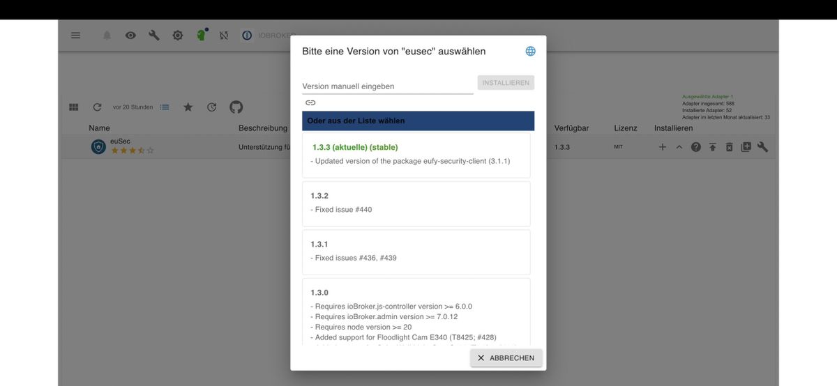

                              Anbei ein Screenshot, von den Versionen die mir zur Verfügung stehen:

                                @niiccooo1
                                Weniger Screenshots, mehr Konsole...
                                iob repo list
                                iob update
                                sagt?
                                N 1 Antwort Letzte Antwort

                                      • N niiccooo1
                                        @thomas-braun said in Test Adapter eusec 2.0.x:
                                        iobroker url iobroker.eusec@latest --debug
                                        root@iobroker:/opt/iobroker# iobroker url iobroker.eusec@latest --debug
                                        install iobroker.eusec@latest
                                        NPM version: 10.9.4
                                        Installing iobroker.eusec@latest... (System call)
                                        npm error code EBADENGINE
                                        npm error engine Unsupported engine
                                        npm error engine Not compatible with your version of node/npm: ring-client-api@12.1.1
                                        npm error notsup Not compatible with your version of node/npm: ring-client-api@12.1.1
                                        npm error notsup Required: {"node":"^18 || ^20"}
                                        npm error notsup Actual:   {"npm":"10.9.4","node":"v22.21.0"}
                                        npm error A complete log of this run can be found in: /opt/iobroker/.npm/_logs/2025-11-02T15_31_44_513Z-debug-0.log
                                        upload [13] eusec.admin /opt/iobroker/node_modules/iobroker.eusec/admin/eusec.png eusec.png image/png
                                        upload [12] eusec.admin /opt/iobroker/node_modules/iobroker.eusec/admin/i18n/de/translations.json i18n/de/translations.json application/json
                                        upload [11] eusec.admin /opt/iobroker/node_modules/iobroker.eusec/admin/i18n/en/translations.json i18n/en/translations.json application/json
                                        upload [10] eusec.admin /opt/iobroker/node_modules/iobroker.eusec/admin/i18n/es/translations.json i18n/es/translations.json application/json
                                        upload [9] eusec.admin /opt/iobroker/node_modules/iobroker.eusec/admin/i18n/fr/translations.json i18n/fr/translations.json application/json
                                        upload [8] eusec.admin /opt/iobroker/node_modules/iobroker.eusec/admin/i18n/it/translations.json i18n/it/translations.json application/json
                                        upload [7] eusec.admin /opt/iobroker/node_modules/iobroker.eusec/admin/i18n/nl/translations.json i18n/nl/translations.json application/json
                                        upload [6] eusec.admin /opt/iobroker/node_modules/iobroker.eusec/admin/i18n/pl/translations.json i18n/pl/translations.json application/json
                                        upload [5] eusec.admin /opt/iobroker/node_modules/iobroker.eusec/admin/i18n/pt/translations.json i18n/pt/translations.json application/json
                                        upload [4] eusec.admin /opt/iobroker/node_modules/iobroker.eusec/admin/i18n/ru/translations.json i18n/ru/translations.json application/json
                                        upload [3] eusec.admin /opt/iobroker/node_modules/iobroker.eusec/admin/i18n/uk/translations.json i18n/uk/translations.json application/json
                                        upload [2] eusec.admin /opt/iobroker/node_modules/iobroker.eusec/admin/i18n/zh-cn/translations.json i18n/zh-cn/translations.json application/json
                                        upload [1] eusec.admin /opt/iobroker/node_modules/iobroker.eusec/admin/jsonConfig.json jsonConfig.json application/json
                                        upload [0] eusec.admin /opt/iobroker/node_modules/iobroker.eusec/admin/words.js words.js application/javascript
                                        Updating objects from io-package.json for adapter "eusec" with version "1.3.3"
                                        #37
                                        @niiccooo1 sagte in Test Adapter eusec 2.0.x:
                                        root@iobroker
                                        Hampel da NICHT als root herum.
                                          root@iobroker
                                          N Offline
                                          N Offline
                                          niiccooo1
                                          #38
                                          @thomas-braun
                                          Ist von Docker Container... Kann man das ändern?
