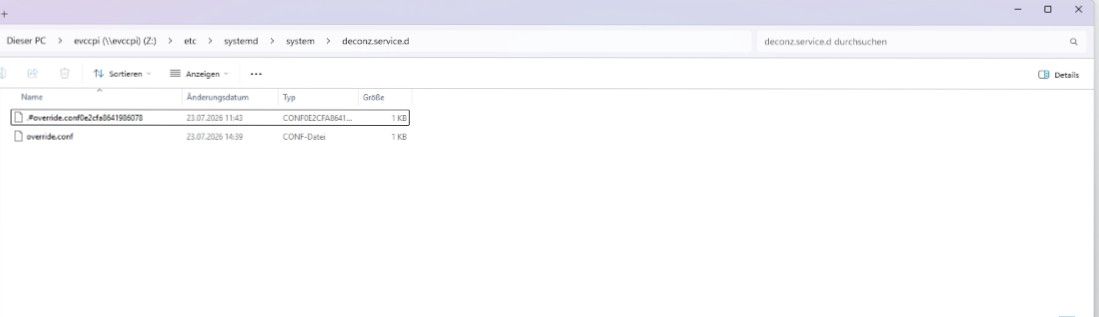

          dazukommt nach dem edit
          sudo systemctl edit deconz.service
          Editing "/etc/systemd/system/deconz.service.d/override.conf" canceled: temporary file is empty.

                    Jul 23 15:13:32 evccpi systemd[1]: /etc/systemd/system/deconz.service.d/override.conf:1: Assignment outside of section. Ignoring.
                    Jul 23 15:13:32 evccpi systemd[1]: deconz.service: Service has more than one ExecStart= setting, which is only allowed for Type=oneshot services. Refusing.
                    Jul 23 15:13:37 evccpi systemd[1]: /etc/systemd/system/deconz.service.d/override.conf:1: Assignment outside of section. Ignoring.
                    Jul 23 15:13:53 evccpi systemd[1]: /etc/systemd/system/deconz.service.d/override.conf:1: Assignment outside of section. Ignoring.
                    Jul 23 15:13:53 evccpi systemd[1]: deconz.service: Service has more than one ExecStart= setting, which is only allowed for Type=oneshot services. Refusing.
                    Jul 23 15:13:56 evccpi systemd[1]: /etc/systemd/system/deconz.service.d/override.conf:1: Assignment outside of section. Ignoring.

                      @docsnyder7 sagte:
                      Was steht denn jetzt da drin?

                            @Michael-Schmitt
                            Ja, das hatte ich ja oben auch schon so gefunden:
                            How to Fix It:
                            Clear the old value:
                            Add an empty ExecStart= line before your new ExecStart= line in your override/drop-in file to wipe previous definitions.
                            476
