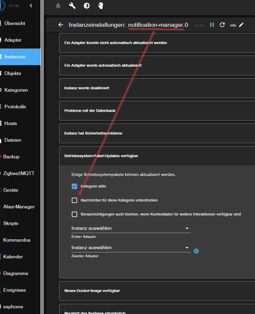

      crunchipC Offline
      crunchipC Offline
      crunchip
      @AIXroot sagte in Disable OS update on none debian/ubuntu installations:
      Where do I disable the OS updates check in iobroker
      • A Offline
        A Offline
        AIXroot
        I had not installed notification.manager until now. Installing it and activating the option did not help either.
        • ilovegymI Offline
          ilovegymI Offline
          ilovegym
          Hi Norbert, how does it appears? In the admin-tab of the web interface, or in the command line, can you provide a screenshot, please?
