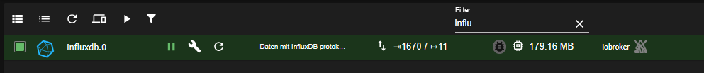

    ich nutze noch InfluxDB V1 da ich für die paar Grafen die ich mit Grafana darstelle keinen Bedarf sehe einen Upgrade zu machen.
    Heute ist mir aufgefallen das ein Wert im Influx Adapter diese Meldungen im Log bringt:
    influxdb.0
    	2025-11-22 14:50:16.723	debug	Send: 500 of: 501 in: 21ms
    influxdb.0
    	2025-11-22 14:50:16.703	debug	Query to execute: SELECT value from "Battery Capacity" WHERE time <= '2025-11-08T13:51:00.000Z' ORDER BY time DESC LIMIT 1;SELECT * from "Battery Capacity" WHERE time > '2025-11-08T13:51:00.000Z' AND time < '2025-11-22T13:51:00.000Z' ORDER BY time DESC LIMIT 500;SELECT value from "Battery Capacity" WHERE time >= '2025-11-22T13:51:00.000Z' LIMIT 1
    influxdb.0
    	2025-11-22 14:50:16.702	debug	modbus.4.holdingRegisters.4.588_battery_capacity17638194167020.39390693054842796 getHistory message: {"id":"modbus.4.holdingRegisters.4.588_battery_capacity","options":{"instance":"influxdb.0","start":1762609860000,"end":1763819460000,"from":true,"ack":true,"q":true,"addId":false,"aggregate":"none","returnNewestEntries":true,"user":"system.user.admin"}}
    influxdb.0
    	2025-11-22 14:50:16.702	debug	Incoming message getHistory from system.adapter.admin.0
    influxdb.0
    	2025-11-22 14:50:16.667	debug	Send: 500 of: 500 in: 188ms
    influxdb.0
    	2025-11-22 14:50:16.486	debug	Query to execute: SELECT value from "Battery Capacity" WHERE time <= '1999-12-31T23:00:00.000Z' ORDER BY time DESC LIMIT 1;SELECT * from "Battery Capacity" WHERE time > '1999-12-31T23:00:00.000Z' AND time < '2025-11-22T13:50:17.360Z' ORDER BY time ASC LIMIT 500;SELECT value from "Battery Capacity" WHERE time >= '2025-11-22T13:50:17.360Z' LIMIT 1
    influxdb.0
    	2025-11-22 14:50:16.479	debug	modbus.4.holdingRegisters.4.588_battery_capacity17638194164790.08800547770176248 getHistory message: {"id":"modbus.4.holdingRegisters.4.588_battery_capacity","options":{"instance":"influxdb.0","start":946681200000,"end":1763819417360,"limit":1,"from":false,"ack":false,"q":false,"addId":false,"aggregate":"none","user":"system.user.admin"}}
    Und das Grafana Panel dazu leer ist.
    Jemand eine Idee was die Ursache sein kann?

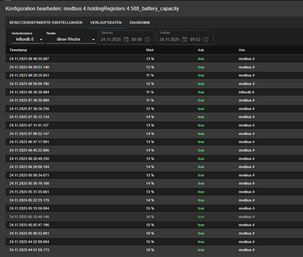

          wendy2702
          doch die Instanz steht auf Debug:

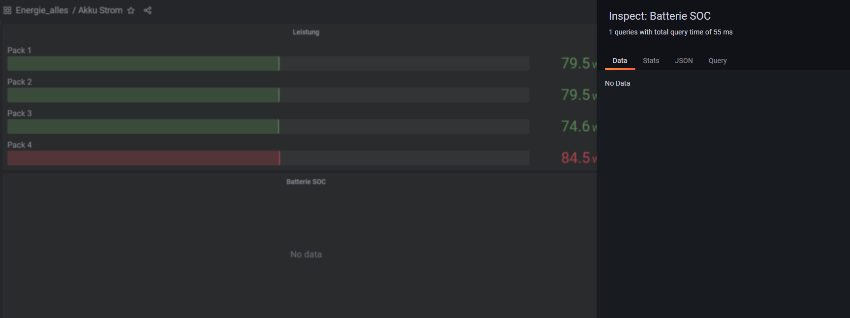

          In Grafana sieht es halt so aus was die Werte betrifft:
          Wie man am oberen Graphen sieht werden die Werte für die einzelnen Batterie Packs noch geschrieben.
          Nur der SOC nicht mehr.

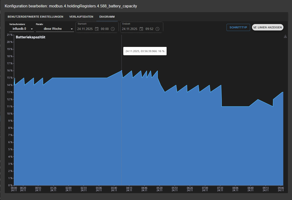

          Das ist das Objekt:
          Und der dazugehörige Graph aus IOB:
          Sowie die Werte:
          Ich habe iob, Instanz, Influx, Grafana schon alles gestoppt, neu gestartet, kompletten VMs neu gestartet.
          Aber der Wert will aus welchem Grund auch immer nicht mehr in Grafana erscheinen.

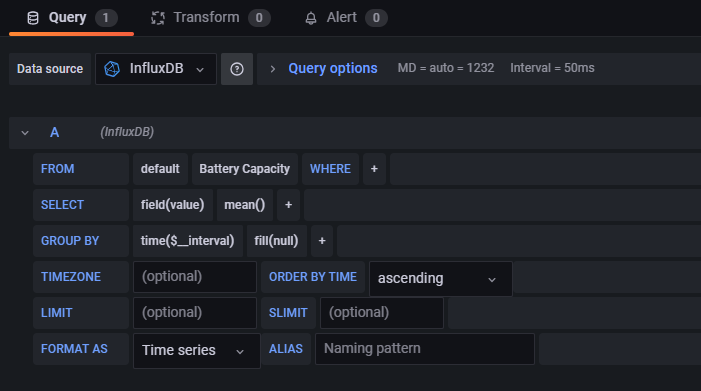

            zeigmal den select aus dem dashboard
            • wendy2702W Online
              wendy2702W Online
              wendy2702
              Hier der select:
              Dieser Eintrag im log mit dem Limit etc. kommt übrigens nur für dieses eine Objekt:
