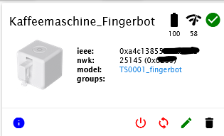

      Guten Morgen alle zusammen,
      neues Jahr neues Pech (mit Zigbee)
      Seit heute Morgen will mein Fingerbot nicht mehr funktionieren. Ich habe ihn schon aus den Objekten gelöscht, neu gekoppelt, Zigbee Adapter und Pi neu gestartet aber es kommt immer folgende Meldung wenn ich den Fingerbot über die Zigbee Adapter Oberfläche antriggere:
      host.raspberrypi
      	2025-01-02 08:21:25.363	info	Restart adapter system.adapter.zigbee.0 because enabled
      host.raspberrypi
      	2025-01-02 08:21:25.362	error	instance system.adapter.zigbee.0 terminated with code 6 (UNCAUGHT_EXCEPTION)
      host.raspberrypi
      	2025-01-02 08:21:25.362	error	Caught by controller[1]: at Zigbee.publishFromState (/opt/iobroker/node_modules/iobroker.zigbee/main.js:652:23)
      host.raspberrypi
      	2025-01-02 08:21:25.362	error	Caught by controller[1]: at Array.forEach (<anonymous>)
      host.raspberrypi
      	2025-01-02 08:21:25.361	error	Caught by controller[1]: at /opt/iobroker/node_modules/iobroker.zigbee/main.js:726:31
      host.raspberrypi
      	2025-01-02 08:21:25.361	error	Caught by controller[1]: TypeError: Cannot read properties of undefined (reading 'includes')
      host.raspberrypi
      	2025-01-02 08:21:25.360	error	Caught by controller[1]: This error originated either by throwing inside of an async function without a catch block, or by rejecting a promise which was not handled with .catch(). The promise rejected with the reason:
      zigbee.0
      	2025-01-02 08:21:24.566	warn	Terminated (UNCAUGHT_EXCEPTION): Without reason
      zigbee.0
      	2025-01-02 08:21:24.564	info	terminating
      zigbee.0
      	2025-01-02 08:21:24.005	info	Zigbee: disabling joining new devices.
      zigbee.0
      	2025-01-02 08:21:24.000	info	cleaned everything up...
      zigbee.0
      	2025-01-02 08:21:23.978	error	Cannot read properties of undefined (reading 'includes')
      zigbee.0
      	2025-01-02 08:21:23.978	error	TypeError: Cannot read properties of undefined (reading 'includes') at /opt/iobroker/node_modules/iobroker.zigbee/main.js:726:31 at Array.forEach (<anonymous>) at Zigbee.publishFromState (/opt/iobroker/node_modules/iobroker.zigbee/main.js:652:23)
      zigbee.0
      	2025-01-02 08:21:23.977	error	unhandled promise rejection: Cannot read properties of undefined (reading 'includes')
      zigbee.0
      	2025-01-02 08:21:23.976	error	Unhandled promise rejection. This error originated either by throwing inside of an async function without a catch block, or by rejecting a promise which was not handled with .catch().
      zigbee.0
      	2025-01-02 08:21:15.460	info	List of port: [{"path":"/dev/ttyUSB0","manufacturer":"Silicon Labs","serialNumber":"0001","pnpId":"usb-Silicon_Labs_Sonoff_Zigbee_3.0_USB_Dongle_Plus_0001-if00-port0","vendorId":"10c4","productId":"ea60"}]
      admin.0
      	2025-01-02 08:21:15.058	info	==> Connected system.user.admin from ::ffff:192.168.178.116

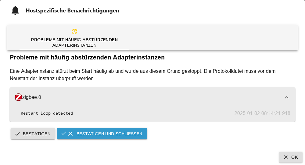

      Ausserdem erscheint unter "Host" diese Meldung:
      In diesem Zusammenhang sollte ich vielleicht noch erwähnen das auch andere, Baugleiche Fingerbots nicht mehr wollen.
      Bedauerlicherweise kann ich mit der Meldung aus dem Protokoll nichts anfangen.
      Kann mir wohl jemand einen Tipp geben was ich tun kann das die Fingerbots wieder funktionieren?
      Es sind diese Fingerbots:
      Ich würde mich über Eure Unterstützung freuen.
      Gruß Duffy

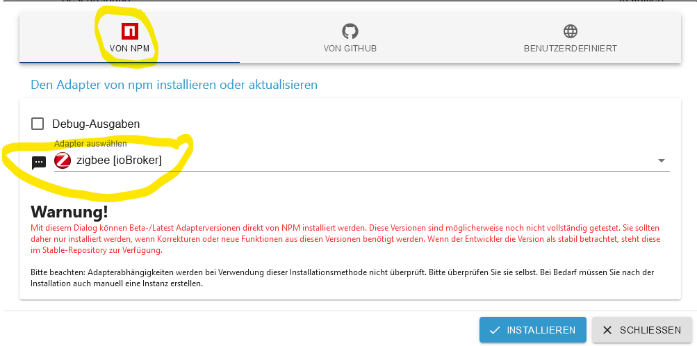

            Beta Repsoitorry aktiviert.
            Expertenmodus aktiviert
            über die Katze, von Github (mittlerer Reiter) Zigbee ausgewählt und installiert.
            Schon läuft wieder der Kaffee 🙂

                  entweder umschalten des Repos mit anschließendem Neuladen der Adapterliste
                  oder über die "böse" Katze und dort dem ersten Reiter (npm)

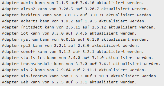

                        Ich habe jetzt auf Beta umgestellt und es zeigt mir 14 mögliche Updates an.
                        Zigbee aber nicht mehr. Ok, ist ja schon installiert.
                        Aber wie um alles in der Welt könnte ich jetzt beispielsweise den Alexa Adapter von 3.26.5 auf 3.26.7 heben?
                        Man ist das kompliziert ;-(

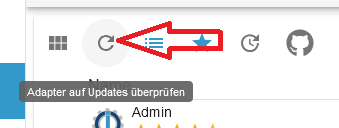

                          Hast du im Admin auf "Adapter auf Updates überprüfen" geklickt?
                          Duffy 1 Reply Last reply Reply Quote 0

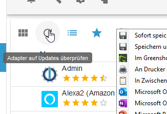

                              Irgendwie ist deine Ansicht da ziemlich lückenhaft. Mal mit F5 oder in hartnäckigen Fällen Strg + F5 die Browser-Ansicht aktualisiert?

                                      Duffy @Gaspode last edited by
                                      @gaspode

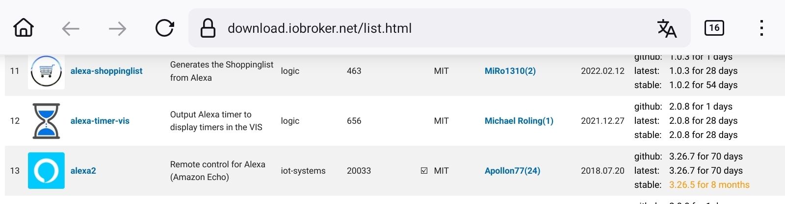

                                      Ich habe jetzt wieder auf Stablke gestellt jetzt sieht es deinem Screenshot etwas ähnlicher:
                                      Leider zeigt es bei mir nicht die 3.26.7 an.
                                      Nicht das ich die jetzt bei Alexa2 bräuchte mir geht es nur um das Verständnis wie man die Latest installiert.
                                      Thomas Braun Homoran 2 Replies Last reply Reply Quote 0
                                            Natürlich nicht!
                                            die 26.7 ist auch nicht stable
                                            @duffy sagte in Zigbee Fingerbot, heute gibts kein Kaffee [gel.]:
                                            das hatten wir doch vorhin:
                                            @homoran sagte in Zigbee Fingerbot, heute gibts kein Kaffee [gel.]:
                                            Verrätst mir bitte wie das mit der Latest geht?
                                            aber nochmal:
                                            Warum willst du das?
                                            Willst du stabile Adapter haben, oder willst du Betatester für neue Versionen sein?
