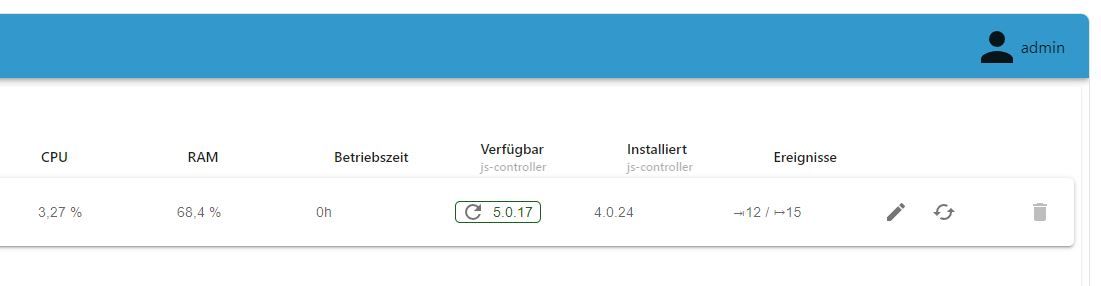

    Ich bekomme den js-controller nicht auf 5.0.17 aktualisiert!
    Bin nach dieser Anweisung vorgegangen (siehe Anhang)!
    Wie bekomme ich das update hin?

      @stephan1966
      Um da helfen zu können, wäre die Ausgabe des Log (in Code-Tags</>) hilfreich.
      Der Versuch des Update sollte ja irgend etwas von sich geben.

        Stephan1966
        @codierknecht
        Copy text starting here:
                                v.2023-10-10
           Static hostname: raspberrypismarthome
                 Icon name: computer
          Operating System: Raspbian GNU/Linux 11 (bullseye)
                    Kernel: Linux 6.1.21-v8+
              Architecture: arm64
        Installation:           native
        Kernel:                 aarch64
        Userland:               armhf
        Timezone:               Europe/Berlin (CET, +0100)
        User-ID:                1000
        X-Server:               false
        Pending OS-Updates:     0
        Pending iob updates:    16
        /home/iobroker/.diag.sh: line 486: nodejs: command not found
        Nodejs-Installation:
                                /usr/bin/node           v14.21.3
                                /usr/bin/npm            6.14.18
                                /usr/bin/npx            6.14.18
                                /usr/bin/corepack       0.15.1
        Recommended versions are nodejs 16.20.2 and npm 8.19.4
        *** nodejs is NOT correctly installed ***
        Wrong installation path detected. This needs to be fixed.
        Please check
        https://forum.iobroker.net/topic/35090/howto-nodejs-installation-und-upgrades-unter-debian
        for more information on how to fix these errors.
        MEMORY:
        Mem:            3.8G        740M        2.5G        1.0M        577M        3.2G
        Swap:            99M          0B         99M
        Total:          3.9G        740M        2.6G
        Active iob-Instances:   13
        Active repo(s): stable
        ioBroker Core:          js-controller           4.0.24
                                admin                   6.3.5
        + system.adapter.admin.0                  : admin                 : raspberrypismarthome                     -  enabled, port: 8081, bind: 0.0.0.0, run as: admin
        + system.adapter.web.0                    : web                   : raspberrypismarthome                     -  enabled, port: 8082, bind: 0.0.0.0, run as: admin
        Objects:                1994
        States:                 1715
        Size of iob-Database:
        11M     /opt/iobroker/iobroker-data/objects.jsonl
        6.3M    /opt/iobroker/iobroker-data/objects.json.migrated
        6.3M    /opt/iobroker/iobroker-data/objects.json.bak.migrated
        4.2M    /opt/iobroker/iobroker-data/states.jsonl
        488K    /opt/iobroker/iobroker-data/states.json.migrated
        488K    /opt/iobroker/iobroker-data/states.json.bak.migrated
        0       /opt/iobroker/iobroker-data/states.json.broken
        =================== END OF SUMMARY =================
        Beste Grüße,
        Stephan
        Iobroker Nutzer seit 2022

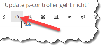

          Stephan1966
          @codierknecht sagte in Update js-controller geht nicht:
          Wie geht das?
          Beste Grüße,
          Stephan
          CodierknechtC Thomas BraunT 2 Antworten Letzte Antwort

            • S Stephan1966
              Wie geht das?
              @stephan1966
              iob stop
              iob fix
              iob nodejs-update 18
              Danach:
              iob update
              iob update all
              iob stop
              iob upgrade self
              iob start
              S 1 Antwort Letzte Antwort
                @stephan1966
                iob stop
                iob fix
                Danach:
                iob update
                iob update all
                iob stop
                iob upgrade self
                iob start
                Stephan1966
                Hat funktioniert, Super, DANKE 👍

                            js-controller:  5.0.17

                            Controller "js-controller": 5.0.17   , installed 5.0.17
