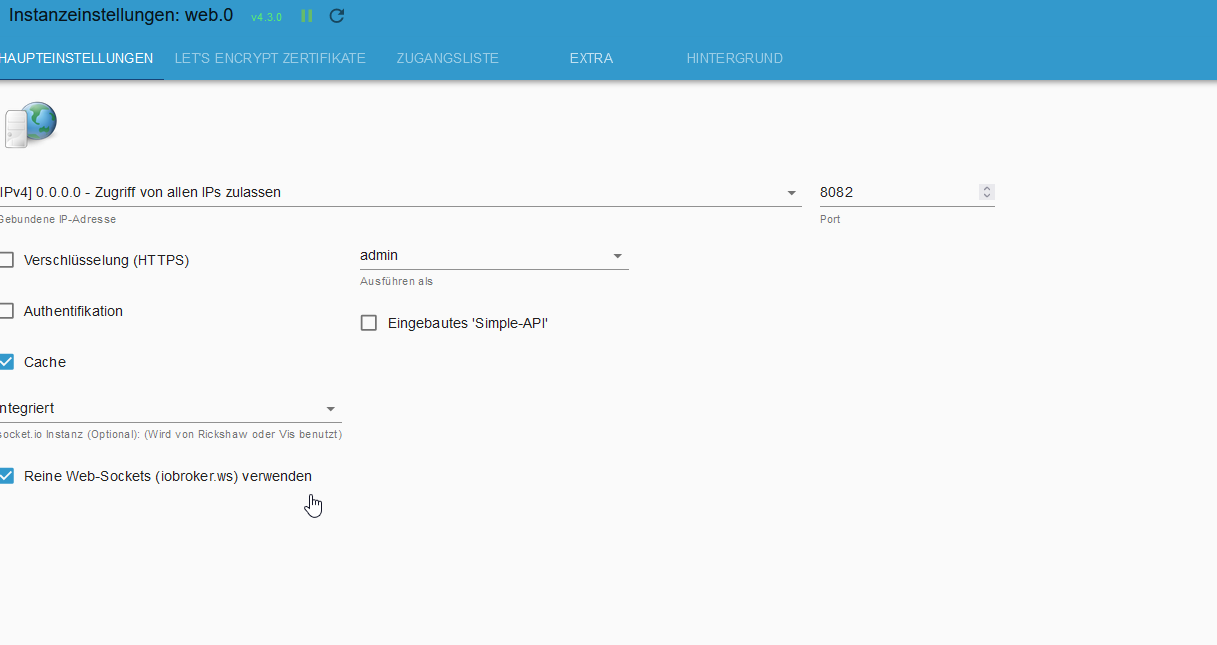

        @iobrokerrisseonline
        Screenshot vom Web Adapter bitte
        I 2 Replies Last reply Reply Quote 0
        • I
          iobrokerrisseonline @sigi234 last edited by
          Oben rechts dar kleine rote Fehler
          • I
            sigi234 1 Reply Last reply Reply Quote 0
            • sigi234
              sigi234 Forum Testing Most Active @iobrokerrisseonline last edited by
              Reine Websockets anhaken
              I 1 Reply Last reply Reply Quote 0
              • I
                iobrokerrisseonline @sigi234 last edited by iobrokerrisseonline
                @sigi234 Perfekt, hat geklappt. Danke
