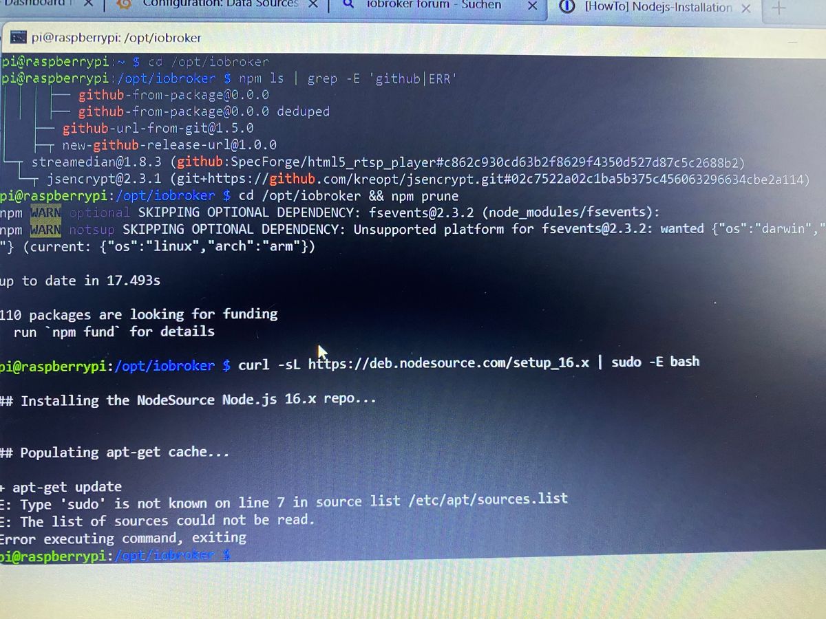

        Das hier kommt immer. Hab die anleitung von thomas genommen
        • B blue106
          @blue106
          Keine Screenshots. Kann man nicht lesen, kann man nicht zitieren usw.
          Text aus der Konsole in CodeTags eingebettet hier rein.

            @blue106

            @thomas-braun
            Keine ahnung wie das geht. Kanns nur so machen. Weiter als das komm ich net
            • B blue106
              @thomas-braun
              @blue106
              Dann lies den Hinweis von @Homoran

                pi@raspberrypi:~ $ cd /opt/iobroker
                pi@raspberrypi:/opt/iobroker $ npm ls | grep -E 'github|ERR'
                │ │ │ ├── github-from-package@0.0.0
                │ │ │ ├── github-from-package@0.0.0 deduped
                │   ├── github-url-from-git@1.5.0
                │   ├─┬ new-github-release-url@1.0.0
                └─┬ streamedian@1.8.3 (github:SpecForge/html5_rtsp_player#c862c930cd63b2f8629f4350d527d87c5c2688b2)
                  └─┬ jsencrypt@2.3.1 (git+https://github.com/kreopt/jsencrypt.git#02c7522a02c1ba5b375c456063296634cbe2a114)
                pi@raspberrypi:/opt/iobroker $ cd /opt/iobroker && npm prune
                npm WARN optional SKIPPING OPTIONAL DEPENDENCY: fsevents@2.3.2 (node_modules/fsevents):
                npm WARN notsup SKIPPING OPTIONAL DEPENDENCY: Unsupported platform for fsevents@2.3.2: wanted {"os":"darwin","arch":"any"} (current: {"os":"linux","arch":"arm"})
                up to date in 17.493s
                110 packages are looking for funding
                  run `npm fund` for details
                pi@raspberrypi:/opt/iobroker $ curl -sL https://deb.nodesource.com/setup_16.x | sudo -E bash
                ## Installing the NodeSource Node.js 16.x repo...
                ## Populating apt-get cache...
                + apt-get update
                E: Type 'sudo' is not known on line 7 in source list /etc/apt/sources.list
                E: The list of sources could not be read.
                Error executing command, exiting
                pi@raspberrypi:/opt/iobroker $ node -v
                v12.22.8
                pi@raspberrypi:/opt/iobroker $ iob stop
                + apt-get update
                MOD-EDIT: Code-tags angepasst!

                  @blue106
                  cat /etc/apt/sources.list
                  Da steht offenbar Quark in der sources.list drin.

                                        • B blue106
                                          @thomas-braun
                                          pi@raspberrypi:~ $ sudo apt update
                                          Hit:1 http://archive.raspberrypi.org/debian buster InRelease
                                          Hit:2 http://raspbian.raspberrypi.org/raspbian buster InRelease
                                          Hit:3 https://deb.nodesource.com/node_12.x buster InRelease
                                          Ign:4 https://archive.raspbian.org/raspian buster InRelease
                                          Hit:5 https://archive.raspbian.org/raspbian buster InRelease
                                          Err:6 https://archive.raspbian.org/raspian buster Release
                                            404  Not Found [IP: 2a00:1098:0:80:1000:75:0:2 443]
                                          Reading package lists... Done
                                          E: The repository 'https://archive.raspbian.org/raspian buster Release' does not have a Release file.
                                          N: Updating from such a repository can't be done securely, and is therefore disabled by default.
                                          N: See apt-secure(8) manpage for repository creation and user configuration details.
                                          habs endlich gefunden in zeile 7 un habs geändert. aber wirklich akutell wird nix
                                          #22
                                          @blue106
                                          sudo sed -i 's/raspian/raspbian/g' /etc/apt/sources.list
                                          sudo sed -i 's/raspian/raspbian/g' /etc/apt/sources.list.d/*
                                          Dann nochmal
                                          sudo apt update
                                          698
