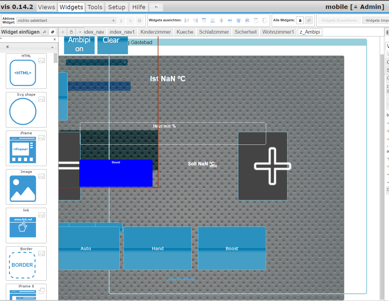

    Guten Morgen,
    ich habe Heizungsthermostate mit grouping erstellt, im Browser ist die Darstellung korrekt, jedoch in der Vis App ist alles zerschossen, kann mir jemand helfen?
    Was mir auch noch aufgefallen ist, beim views duplizieren erscheint der neue view nicht, mann muss ihn manuell über die url anwählen und dann erneut speichern.
    hier ma der code vom widget:
    [{"tpl":"_tplGroup","data":{"members":["w00458","w00459","w00460","w00461","w00462","w00463","w00464","w00465","w00466","w00467","w00468","w00469","w00470","w00471","w00472","w00473","w00474","w00475","w00476","w00477"],"attrCount":"11","signals-cond-0":"==","signals-val-0":true,"signals-icon-0":"/vis/signals/lowbattery.png","signals-icon-size-0":0,"signals-blink-0":false,"signals-horz-0":0,"signals-vert-0":0,"signals-hide-edit-0":false,"signals-cond-1":"==","signals-val-1":true,"signals-icon-1":"/vis/signals/lowbattery.png","signals-icon-size-1":0,"signals-blink-1":false,"signals-horz-1":0,"signals-vert-1":0,"signals-hide-edit-1":false,"signals-cond-2":"==","signals-val-2":true,"signals-icon-2":"/vis/signals/lowbattery.png","signals-icon-size-2":0,"signals-blink-2":false,"signals-horz-2":0,"signals-vert-2":0,"signals-hide-edit-2":false,"attrType1":"id","groupAttr1":"hm-rpc.0.NEQ0939873.2.ACTUAL_TEMPERATURE","attrName1":"Ist_temp","attrType2":"id","attrType3":"id","attrType4":"id","attrType5":"id","attrType6":"id","attrType7":"id","attrType8":"id","attrType9":"id","attrName2":"Soll_temp","attrName3":"Mode","attrName4":"Boost_time","attrName5":"Auto_mode","attrName6":"Manu_mode","attrName7":"Boost_mode","attrName8":"Battery_voltage","attrName9":"Valve","g_visibility":false,"visibility-cond":"==","visibility-val":1,"visibility-groups-action":"hide","groupAttr2":"hm-rpc.0.NEQ0939873.2.SET_TEMPERATURE","groupAttr3":"hm-rpc.0.NEQ0939873.2.CONTROL_MODE","groupAttr4":"hm-rpc.0.NEQ0939873.2.BOOST_STATE","groupAttr5":"hm-rpc.0.NEQ0939873.2.AUTO_MODE","groupAttr6":"hm-rpc.0.NEQ0939873.2.MANU_MODE","groupAttr7":"hm-rpc.0.NEQ0939873.2.BOOST_MODE","groupAttr8":"hm-rpc.0.NEQ0939873.2.BATTERY_STATE","groupAttr9":"hm-rpc.0.MEQ1582211.4.VALVE_STATE","attrName10":"Luftfeuchte","attrName11":"view","attrType10":"id","attrType11":"views","groupAttr11":"z_hz_bad","groupAttr10":"hm-rpc.0.NEQ0939873.2.ACTUAL_HUMIDITY"},"style":{"top":"604px","left":"475px","width":"320px","height":"190px","z-index":"0"},"widgetSet":"basic"},{"tpl":"tplValueListHtml8","data":{"oid":"groupAttr3","count":"3","signals-cond-0":"==","signals-val-0":true,"signals-icon-0":"/vis/signals/lowbattery.png","signals-icon-size-0":0,"signals-blink-0":false,"signals-horz-0":0,"signals-vert-0":0,"signals-hide-edit-0":false,"signals-cond-1":"==","signals-val-1":true,"signals-icon-1":"/vis/signals/lowbattery.png","signals-icon-size-1":0,"signals-blink-1":false,"signals-horz-1":0,"signals-vert-1":0,"signals-hide-edit-1":false,"signals-cond-2":"==","signals-val-2":true,"signals-icon-2":"/vis/signals/lowbattery.png","signals-icon-size-2":0,"signals-blink-2":false,"signals-horz-2":0,"signals-vert-2":0,"signals-hide-edit-2":false,"value0":"AUTO","value1":"Hand","style0":"background-color: green; padding-top:3px;","style1":"background-color: red; padding-top:3px;","test_list":"3","style2":"","value2":" ","value3":"Boost","style3":"background-color: blue; padding-top:3px;","name":"Hz Badezimmer","g_visibility":false,"visibility-cond":"==","visibility-val":1,"visibility-groups-action":"hide","title":"Verlauf Schlafzimmer"},"style":{"left":"21.28%","top":"47.42%","z-index":"3","color":"#ffffff","text-align":"center","width":"22.8%","height":"10.31%","border-radius":"4px","padding-top":"","line-height":"","font-size":"x-small","background-color":"#FFFFFF"},"widgetSet":"basic","grouped":true},{"tpl":"tplValueFloat","data":{"oid":"groupAttr9","is_comma":"true","factor":"1","html_append_singular":" %","html_append_plural":" %","is_tdp":"false","gestures-offsetX":0,"gestures-offsetY":0,"digits":"0","signals-cond-0":"==","signals-val-0":true,"signals-icon-0":"/vis/signals/lowbattery.png","signals-icon-size-0":0,"signals-blink-0":false,"signals-horz-0":0,"signals-vert-0":0,"signals-hide-edit-0":false,"signals-cond-1":"==","signals-val-1":true,"signals-icon-1":"/vis/signals/lowbattery.png","signals-icon-size-1":0,"signals-blink-1":false,"signals-horz-1":0,"signals-vert-1":0,"signals-hide-edit-1":false,"signals-cond-2":"==","signals-val-2":true,"signals-icon-2":"/vis/signals/lowbattery.png","signals-icon-size-2":0,"signals-blink-2":false,"signals-horz-2":0,"signals-vert-2":0,"signals-hide-edit-2":false,"html_prepend":"Heizt mit: ","name":"Hz Badezimmer","g_visibility":false,"visibility-cond":"==","visibility-val":1,"visibility-groups-action":"hide","title":"Verlauf Schlafzimmer"},"style":{"left":"35.26%","top":"33.51%","width":"30.4%","height":"10.82%","color":"white","text-align":"center","font-family":"Arial, Helvetica, sans-serif","font-style":"normal","font-variant":"normal","font-weight":"bold","font-size":"small","z-index":"6","border-width":"1px","border-style":"none","border-color":"white","border-radius":"0px"},"widgetSet":"basic","grouped":true},{"tpl":"tplValueFloat","data":{"oid":"groupAttr1","is_comma":"true","factor":"1","html_append_singular":" ºC","html_append_plural":" ºC","signals-cond-0":"==","signals-val-0":true,"signals-icon-0":"/vis/signals/lowbattery.png","signals-icon-size-0":0,"signals-blink-0":false,"signals-horz-0":0,"signals-vert-0":0,"signals-hide-edit-0":false,"signals-cond-1":"==","signals-val-1":true,"signals-icon-1":"/vis/signals/lowbattery.png","signals-icon-size-1":0,"signals-blink-1":false,"signals-horz-1":0,"signals-vert-1":0,"signals-hide-edit-1":false,"signals-cond-2":"==","signals-val-2":true,"signals-icon-2":"/vis/signals/lowbattery.png","signals-icon-size-2":0,"signals-blink-2":false,"signals-horz-2":0,"signals-vert-2":0,"signals-hide-edit-2":false,"is_tdp":false,"html_prepend":"Ist ","name":"Hz Badezimmer","digits":"1","g_visibility":false,"visibility-cond":"==","visibility-val":1,"visibility-groups-action":"hide","title":"Verlauf Schlafzimmer"},"style":{"left":"28.27%","top":"14.43%","width":"43.77%","height":"14.43%","color":"white","text-align":"center","font-family":"Arial, Helvetica, sans-serif","font-style":"normal","font-variant":"normal","font-weight":"bold","font-size":"x-large","z-index":"3","border-width":"1px","border-style":"none","border-color":"white","border-radius":"0px"},"widgetSet":"basic","grouped":true},{"tpl":"tplValueFloat","data":{"oid":"groupAttr2","is_comma":"true","factor":"1","html_append_singular":" ºC","html_append_plural":" ºC","digits":"1","signals-cond-0":"==","signals-val-0":true,"signals-icon-0":"/vis/signals/lowbattery.png","signals-icon-size-0":0,"signals-blink-0":false,"signals-horz-0":0,"signals-vert-0":0,"signals-hide-edit-0":false,"signals-cond-1":"==","signals-val-1":true,"signals-icon-1":"/vis/signals/lowbattery.png","signals-icon-size-1":0,"signals-blink-1":false,"signals-horz-1":0,"signals-vert-1":0,"signals-hide-edit-1":false,"signals-cond-2":"==","signals-val-2":true,"signals-icon-2":"/vis/signals/lowbattery.png","signals-icon-size-2":0,"signals-blink-2":false,"signals-horz-2":0,"signals-vert-2":0,"signals-hide-edit-2":false,"is_tdp":false,"html_prepend":"Soll ","name":"Hz Badezimmer","g_visibility":true,"visibility-cond":"<","visibility-val":"3","visibility-groups-action":"hide","visibility-oid":"groupAttr3","title":"Verlauf Schlafzimmer"},"style":{"left":"48.33%","top":"47.94%","width":"32.22%","height":"8.76%","color":"white","text-align":"center","font-family":"Arial, Helvetica, sans-serif","font-style":"normal","font-variant":"normal","font-weight":"bold","font-size":"medium","z-index":"3"},"widgetSet":"basic","grouped":true},{"tpl":"tplIconInc","data":{"oid":"groupAttr2","repeat_delay":"800","repeat_interval":"800","src":"/vis.0/thermostat/control_plus.png","step":"+0.5","minmax":"30","signals-cond-0":"==","signals-val-0":true,"signals-icon-0":"/vis/signals/lowbattery.png","signals-icon-size-0":0,"signals-blink-0":false,"signals-horz-0":0,"signals-vert-0":0,"signals-hide-edit-0":false,"signals-cond-1":"==","signals-val-1":true,"signals-icon-1":"/vis/signals/lowbattery.png","signals-icon-size-1":0,"signals-blink-1":false,"signals-horz-1":0,"signals-vert-1":0,"signals-hide-edit-1":false,"signals-cond-2":"==","signals-val-2":true,"signals-icon-2":"/vis/signals/lowbattery.png","signals-icon-size-2":0,"signals-blink-2":false,"signals-horz-2":0,"signals-vert-2":0,"signals-hide-edit-2":false,"text":"","name":"Hz Badezimmer","g_visibility":false,"visibility-cond":"==","visibility-val":1,"visibility-groups-action":"hide","title":"Verlauf Schlafzimmer"},"style":{"left":"82.37%","top":"36.6%","background":"#444444","width":"15.2%","height":"25.77%","z-index":"3"},"widgetSet":"jqui","grouped":true},{"tpl":"tplIconInc","data":{"oid":"groupAttr2","repeat_delay":"800","repeat_interval":"800","src":"/vis.0/thermostat/control_minus.png","step":"-0.5","minmax":"4.5","signals-cond-0":"==","signals-val-0":true,"signals-icon-0":"/vis/signals/lowbattery.png","signals-icon-size-0":0,"signals-blink-0":false,"signals-horz-0":0,"signals-vert-0":0,"signals-hide-edit-0":false,"signals-cond-1":"==","signals-val-1":true,"signals-icon-1":"/vis/signals/lowbattery.png","signals-icon-size-1":0,"signals-blink-1":false,"signals-horz-1":0,"signals-vert-1":0,"signals-hide-edit-1":false,"signals-cond-2":"==","signals-val-2":true,"signals-icon-2":"/vis/signals/lowbattery.png","signals-icon-size-2":0,"signals-blink-2":false,"signals-horz-2":0,"signals-vert-2":0,"signals-hide-edit-2":false,"text":"","invert_icon":false,"imageHeight":"98","name":"Hz Badezimmer","g_visibility":false,"visibility-cond":"==","visibility-val":1,"visibility-groups-action":"hide","title":"Verlauf Schlafzimmer"},"style":{"left":"2.81%","top":"36.6%","background":"#444444","width":"15.2%","height":"25.77%","z-index":"3"},"widgetSet":"jqui","grouped":true},{"tpl":"tplValueLastchange","data":{"oid":"groupAttr2","signals-cond-0":"==","signals-val-0":true,"signals-icon-0":"/vis/signals/lowbattery.png","signals-icon-size-0":0,"signals-blink-0":false,"signals-horz-0":0,"signals-vert-0":0,"signals-hide-edit-0":false,"signals-cond-1":"==","signals-val-1":true,"signals-icon-1":"/vis/signals/lowbattery.png","signals-icon-size-1":0,"signals-blink-1":false,"signals-horz-1":0,"signals-vert-1":0,"signals-hide-edit-1":false,"signals-cond-2":"==","signals-val-2":true,"signals-icon-2":"/vis/signals/lowbattery.png","signals-icon-size-2":0,"signals-blink-2":false,"signals-horz-2":0,"signals-vert-2":0,"signals-hide-edit-2":false,"format_date":"DD.MM.YYYY um hh:mm:ss Uhr","html_prepend":"Letzte Einstellung: ","name":"Hz Badezimmer","g_visibility":false,"visibility-cond":"==","visibility-val":1,"visibility-groups-action":"hide","title":"Verlauf Schlafzimmer"},"style":{"left":"2.13%","top":"92.78%","width":"94.83%","font-style":"normal","font-variant":"normal","font-size":"x-small","height":"5.15%","color":"rgb(38, 179, 247)","z-index":6,"text-align":"center"},"widgetSet":"basic","grouped":true},{"tpl":"tplValueFloat","data":{"oid":"groupAttr4","is_comma":"true","factor":"1","html_append_singular":" min","html_append_plural":" min","is_tdp":"false","gestures-offsetX":0,"gestures-offsetY":0,"digits":"0","signals-cond-0":"==","signals-val-0":true,"signals-icon-0":"/vis/signals/lowbattery.png","signals-icon-size-0":0,"signals-blink-0":false,"signals-horz-0":0,"signals-vert-0":0,"signals-hide-edit-0":false,"signals-cond-1":"==","signals-val-1":true,"signals-icon-1":"/vis/signals/lowbattery.png","signals-icon-size-1":0,"signals-blink-1":false,"signals-horz-1":0,"signals-vert-1":0,"signals-hide-edit-1":false,"signals-cond-2":"==","signals-val-2":true,"signals-icon-2":"/vis/signals/lowbattery.png","signals-icon-size-2":0,"signals-blink-2":false,"signals-horz-2":0,"signals-vert-2":0,"signals-hide-edit-2":false,"html_prepend":"","name":"Hz Badezimmer","g_visibility":true,"visibility-cond":"==","visibility-val":"3","visibility-groups-action":"hide","visibility-oid":"groupAttr3","title":"Verlauf Schlafzimmer"},"style":{"left":"63.83%","top":"48.97%","width":"14.59%","height":"8.25%","color":"white","text-align":"center","font-family":"Arial, Helvetica, sans-serif","font-style":"normal","font-variant":"normal","font-weight":"bold","font-size":"small","z-index":"5","border-width":"1px","border-style":"none","border-color":"white","border-radius":"0px"},"widgetSet":"basic","grouped":true},{"tpl":"tplValueFloatBar","data":{"oid":"groupAttr4","g_fixed":false,"g_visibility":true,"g_css_font_text":false,"g_css_background":false,"g_css_shadow_padding":false,"g_css_border":false,"g_gestures":false,"g_signals":false,"min":"0","max":"30","orientation":"horizontal","color":"#47aaff","signals-cond-0":"==","signals-val-0":true,"signals-icon-0":"/vis/signals/lowbattery.png","signals-icon-size-0":0,"signals-blink-0":false,"signals-horz-0":0,"signals-vert-0":0,"signals-hide-edit-0":false,"signals-cond-1":"==","signals-val-1":true,"signals-icon-1":"/vis/signals/lowbattery.png","signals-icon-size-1":0,"signals-blink-1":false,"signals-horz-1":0,"signals-vert-1":0,"signals-hide-edit-1":false,"signals-cond-2":"==","signals-val-2":true,"signals-icon-2":"/vis/signals/lowbattery.png","signals-icon-size-2":0,"signals-blink-2":false,"signals-horz-2":0,"signals-vert-2":0,"signals-hide-edit-2":false,"name":"Hz Badezimmer","visibility-cond":"==","visibility-val":"3","visibility-groups-action":"hide","visibility-oid":"groupAttr3","title":"Verlauf Schlafzimmer"},"style":{"left":"62.92%","top":"45.36%","width":"14.89%","height":"13.92%","z-index":"3"},"widgetSet":"basic","grouped":true},{"tpl":"tplJquiRadioList","data":{"oid":"groupAttr3","g_fixed":false,"g_visibility":false,"g_css_font_text":false,"g_css_background":false,"g_css_shadow_padding":false,"g_css_border":false,"g_gestures":false,"g_signals":false,"values":"0;1;3","texts":"AUTO;MANU;BOOS","signals-cond-0":"==","signals-val-0":true,"signals-icon-0":"/vis/signals/lowbattery.png","signals-icon-size-0":0,"signals-blink-0":false,"signals-horz-0":0,"signals-vert-0":0,"signals-hide-edit-0":false,"signals-cond-1":"==","signals-val-1":true,"signals-icon-1":"/vis/signals/lowbattery.png","signals-icon-size-1":0,"signals-blink-1":false,"signals-horz-1":0,"signals-vert-1":0,"signals-hide-edit-1":false,"signals-cond-2":"==","signals-val-2":true,"signals-icon-2":"/vis/signals/lowbattery.png","signals-icon-size-2":0,"signals-blink-2":false,"signals-horz-2":0,"signals-vert-2":0,"signals-hide-edit-2":false,"name":"Hz Badezimmer","visibility-cond":"==","visibility-val":1,"visibility-groups-action":"hide","title":"Verlauf Schlafzimmer"},"style":{"left":"7.6%","top":"71.65%","height":"1.03%","width":"0.61%","z-index":"3"},"widgetSet":"jqui","grouped":true},{"tpl":"tplJquiButtonState","data":{"oid":"groupAttr7","buttontext":"Boost","signals-cond-0":"==","signals-val-0":true,"signals-icon-0":"/vis/signals/lowbattery.png","signals-icon-size-0":0,"signals-blink-0":false,"signals-horz-0":0,"signals-vert-0":0,"signals-hide-edit-0":false,"signals-cond-1":"==","signals-val-1":true,"signals-icon-1":"/vis/signals/lowbattery.png","signals-icon-size-1":0,"signals-blink-1":false,"signals-horz-1":0,"signals-vert-1":0,"signals-hide-edit-1":false,"signals-cond-2":"==","signals-val-2":true,"signals-icon-2":"/vis/signals/lowbattery.png","signals-icon-size-2":0,"signals-blink-2":false,"signals-horz-2":0,"signals-vert-2":0,"signals-hide-edit-2":false,"value":"true","name":"Hz Badezimmer","g_visibility":false,"visibility-cond":"==","visibility-val":1,"visibility-groups-action":"hide","title":"Verlauf Schlafzimmer"},"style":{"left":"66.87%","top":"73.2%","font-size":"small","width":"21.28%","text-align":"center","z-index":"4","height":"16.49%"},"widgetSet":"jqui","grouped":true},{"tpl":"tplJquiButtonState","data":{"oid":"groupAttr6","buttontext":"Hand","signals-cond-0":"==","signals-val-0":true,"signals-icon-0":"/vis/signals/lowbattery.png","signals-icon-size-0":0,"signals-blink-0":false,"signals-horz-0":0,"signals-vert-0":0,"signals-hide-edit-0":false,"signals-cond-1":"==","signals-val-1":true,"signals-icon-1":"/vis/signals/lowbattery.png","signals-icon-size-1":0,"signals-blink-1":false,"signals-horz-1":0,"signals-vert-1":0,"signals-hide-edit-1":false,"signals-cond-2":"==","signals-val-2":true,"signals-icon-2":"/vis/signals/lowbattery.png","signals-icon-size-2":0,"signals-blink-2":false,"signals-horz-2":0,"signals-vert-2":0,"signals-hide-edit-2":false,"value":"20","name":"Hz Badezimmer","g_visibility":false,"visibility-cond":"==","visibility-val":1,"visibility-groups-action":"hide","title":"Verlauf Schlafzimmer"},"style":{"left":"38.3%","top":"73.2%","font-size":"small","width":"21.28%","text-align":"center","z-index":"4","height":"16.49%"},"widgetSet":"jqui","grouped":true},{"tpl":"tplJquiButtonState","data":{"oid":"groupAttr5","buttontext":"Auto","signals-cond-0":"==","signals-val-0":true,"signals-icon-0":"/vis/signals/lowbattery.png","signals-icon-size-0":0,"signals-blink-0":false,"signals-horz-0":0,"signals-vert-0":0,"signals-hide-edit-0":false,"signals-cond-1":"==","signals-val-1":true,"signals-icon-1":"/vis/signals/lowbattery.png","signals-icon-size-1":0,"signals-blink-1":false,"signals-horz-1":0,"signals-vert-1":0,"signals-hide-edit-1":false,"signals-cond-2":"==","signals-val-2":true,"signals-icon-2":"/vis/signals/lowbattery.png","signals-icon-size-2":0,"signals-blink-2":false,"signals-horz-2":0,"signals-vert-2":0,"signals-hide-edit-2":false,"value":"true","no_style":false,"name":"Hz Badezimmer","g_visibility":false,"visibility-cond":"==","visibility-val":1,"visibility-groups-action":"hide","title":"Verlauf Schlafzimmer"},"style":{"left":"10.64%","top":"73.2%","font-size":"small","width":"21.28%","text-align":"center","z-index":"4","height":"16.49%"},"widgetSet":"jqui","grouped":true},{"tpl":"tplMfdCustom10","data":{"oid":"groupAttr8","g_fixed":true,"g_visibility":false,"g_css_font_text":false,"g_css_background":false,"g_css_shadow_padding":false,"g_css_border":false,"g_gestures":false,"g_signals":false,"asButton":"true","icon0":"/vis.0/thermostat/measure_battery_0.png","icon1":"/vis.0/thermostat/measure_battery_0.png","icon2":"/vis.0/thermostat/measure_battery_25.svg","icon3":"/vis.0/thermostat/measure_battery_25.svg","icon4":"/vis.0/thermostat/measure_battery_50.svg","icon5":"/vis.0/thermostat/measure_battery_50.svg","icon6":"/vis.0/thermostat/measure_battery_50.svg","icon7":"/vis.0/thermostat/measure_battery_75.svg","icon8":"/vis.0/thermostat/measure_battery_75.svg","icon9":"/vis.0/thermostat/measure_battery_100.svg","icon10":"/vis.0/thermostat/measure_battery_100.svg","signals-cond-0":"==","signals-val-0":true,"signals-icon-0":"/vis/signals/lowbattery.png","signals-icon-size-0":0,"signals-blink-0":false,"signals-horz-0":0,"signals-vert-0":0,"signals-hide-edit-0":false,"signals-cond-1":"==","signals-val-1":true,"signals-icon-1":"/vis/signals/lowbattery.png","signals-icon-size-1":0,"signals-blink-1":false,"signals-horz-1":0,"signals-vert-1":0,"signals-hide-edit-1":false,"signals-cond-2":"==","signals-val-2":true,"signals-icon-2":"/vis/signals/lowbattery.png","signals-icon-size-2":0,"signals-blink-2":false,"signals-horz-2":0,"signals-vert-2":0,"signals-hide-edit-2":false,"min":"1.5","max":"4.6","name":"Hz Badezimmer","visibility-cond":"==","visibility-val":1,"visibility-groups-action":"hide","title":"Verlauf Schlafzimmer"},"style":{"left":"3.13%","top":"13.42%","width":"10.64%","height":"18.04%","z-index":"4"},"widgetSet":"jqui-mfd","grouped":true},{"tpl":"tplImage","data":{"g_fixed":false,"g_visibility":false,"g_css_font_text":false,"g_css_background":false,"g_css_shadow_padding":false,"g_css_border":true,"g_gestures":false,"g_signals":false,"refreshInterval":"0","refreshOnWakeUp":"false","refreshOnViewChange":"false","signals-cond-0":"==","signals-val-0":true,"signals-icon-0":"/vis/signals/lowbattery.png","signals-icon-size-0":0,"signals-blink-0":false,"signals-horz-0":0,"signals-vert-0":0,"signals-hide-edit-0":false,"signals-cond-1":"==","signals-val-1":true,"signals-icon-1":"/vis/signals/lowbattery.png","signals-icon-size-1":0,"signals-blink-1":false,"signals-horz-1":0,"signals-vert-1":0,"signals-hide-edit-1":false,"signals-cond-2":"==","signals-val-2":true,"signals-icon-2":"/vis/signals/lowbattery.png","signals-icon-size-2":0,"signals-blink-2":false,"signals-horz-2":0,"signals-vert-2":0,"signals-hide-edit-2":false,"src":"/vis.0/thermostat/metal_background.jpg","name":"Hz Badezimmer","oid":"","visibility-cond":"==","visibility-val":1,"visibility-groups-action":"hide","title":"Verlauf Schlafzimmer"},"style":{"left":"1.22%","top":"7.22%","width":"98.78%","height":"92.78%","z-index":"1","border-color":"#484851","border-radius":"5px","border-style":"","border-width":"","opacity":"0.6"},"widgetSet":"basic","grouped":true},{"tpl":"tplFrame","data":{"title":"Heizung Badezimmer","title_color":"444444","title_top":"1","title_left":"6","header_height":"20","header_color":"#99cfdb","gestures-offsetX":0,"gestures-offsetY":0,"signals-cond-0":"==","signals-val-0":true,"signals-icon-0":"/vis/signals/lowbattery.png","signals-icon-size-0":0,"signals-blink-0":false,"signals-horz-0":0,"signals-vert-0":0,"signals-hide-edit-0":false,"signals-cond-1":"==","signals-val-1":true,"signals-icon-1":"/vis/signals/lowbattery.png","signals-icon-size-1":0,"signals-blink-1":false,"signals-horz-1":0,"signals-vert-1":0,"signals-hide-edit-1":false,"signals-cond-2":"==","signals-val-2":true,"signals-icon-2":"/vis/signals/lowbattery.png","signals-icon-size-2":0,"signals-blink-2":false,"signals-horz-2":0,"signals-vert-2":0,"signals-hide-edit-2":false,"name":"Hz Badezimmer","oid":"","g_visibility":false,"visibility-cond":"==","visibility-val":1,"visibility-groups-action":"hide"},"style":{"left":"0.3%","top":"0%","width":"98.78%","height":"97.94%","z-index":"2","border-width":"3px","border-style":"solid","border-color":"#99cfdb","border-radius":"6px","font-family":"","background":""},"widgetSet":"basic","grouped":true},{"tpl":"tplValueFloatBar","data":{"oid":"groupAttr9","factor":"1","color":"#a4d5fe","min":"0","max":"99","orientation":"horizontal","gestures-offsetX":0,"gestures-offsetY":0,"signals-cond-0":"==","signals-val-0":true,"signals-icon-0":"/vis/signals/lowbattery.png","signals-icon-size-0":0,"signals-blink-0":false,"signals-horz-0":0,"signals-vert-0":0,"signals-hide-edit-0":false,"signals-cond-1":"==","signals-val-1":true,"signals-icon-1":"/vis/signals/lowbattery.png","signals-icon-size-1":0,"signals-blink-1":false,"signals-horz-1":0,"signals-vert-1":0,"signals-hide-edit-1":false,"signals-cond-2":"==","signals-val-2":true,"signals-icon-2":"/vis/signals/lowbattery.png","signals-icon-size-2":0,"signals-blink-2":false,"signals-horz-2":0,"signals-vert-2":0,"signals-hide-edit-2":false,"name":"Hz Badezimmer","g_visibility":false,"visibility-cond":"==","visibility-val":1,"visibility-groups-action":"hide","title":"Verlauf Schlafzimmer"},"style":{"left":"21.58%","top":"32.99%","width":"57.75%","height":"8.25%","border-color":"white","border-radius":"5px","border-width":"","border-style":"","z-index":"3"},"widgetSet":"basic","grouped":true},{"tpl":"tplValueFloatBar","data":{"oid":"","factor":"1","color":"#47aaff","min":"0","max":"99","orientation":"horizontal","gestures-offsetX":0,"gestures-offsetY":0,"signals-cond-0":"==","signals-val-0":true,"signals-icon-0":"/vis/signals/lowbattery.png","signals-icon-size-0":0,"signals-blink-0":false,"signals-horz-0":0,"signals-vert-0":0,"signals-hide-edit-0":false,"signals-cond-1":"==","signals-val-1":true,"signals-icon-1":"/vis/signals/lowbattery.png","signals-icon-size-1":0,"signals-blink-1":false,"signals-horz-1":0,"signals-vert-1":0,"signals-hide-edit-1":false,"signals-cond-2":"==","signals-val-2":true,"signals-icon-2":"/vis/signals/lowbattery.png","signals-icon-size-2":0,"signals-blink-2":false,"signals-horz-2":0,"signals-vert-2":0,"signals-hide-edit-2":false,"name":"Hz Badezimmer","g_visibility":false,"visibility-cond":"==","visibility-val":1,"visibility-groups-action":"hide","title":"Verlauf Schlafzimmer"},"style":{"left":"21.58%","top":"32.99%","width":"57.75%","height":"8.25%","border-color":"white","border-radius":"5px","border-width":"1px","border-style":"solid","z-index":"4"},"widgetSet":"basic","grouped":true},{"tpl":"tplContainerIconDialog","data":{"g_fixed":false,"g_visibility":false,"g_css_font_text":false,"g_css_background":false,"g_css_shadow_padding":false,"g_css_border":false,"g_gestures":false,"g_signals":false,"visibility-cond":"==","visibility-val":1,"visibility-groups-action":"hide","signals-cond-0":"==","signals-val-0":true,"signals-icon-0":"/vis/signals/lowbattery.png","signals-icon-size-0":0,"signals-blink-0":false,"signals-horz-0":0,"signals-vert-0":0,"signals-hide-edit-0":false,"signals-cond-1":"==","signals-val-1":true,"signals-icon-1":"/vis/signals/lowbattery.png","signals-icon-size-1":0,"signals-blink-1":false,"signals-horz-1":0,"signals-vert-1":0,"signals-hide-edit-1":false,"signals-cond-2":"==","signals-val-2":true,"signals-icon-2":"/vis/signals/lowbattery.png","signals-icon-size-2":0,"signals-blink-2":false,"signals-horz-2":0,"signals-vert-2":0,"signals-hide-edit-2":false,"src":"/vis.0/thermostat/measure_current.png","contains_view":"groupAttr11","title":"Verlauf Arbeitszimmer","dialog_width":"800","dialog_height":"500","name":"Hz Badezimmer","invert_icon":false,"text":""},"style":{"left":"86.25%","top":"13.16%","width":"10.94%","height":"18.42%","z-index":"3"},"widgetSet":"jqui","grouped":true},{"tpl":"tplValueFloat","data":{"oid":"groupAttr10","is_comma":"true","factor":"1","html_append_singular":"%","html_append_plural":"%","signals-cond-0":"==","signals-val-0":true,"signals-icon-0":"/vis/signals/lowbattery.png","signals-icon-size-0":0,"signals-blink-0":false,"signals-horz-0":0,"signals-vert-0":0,"signals-hide-edit-0":false,"signals-cond-1":"==","signals-val-1":true,"signals-icon-1":"/vis/signals/lowbattery.png","signals-icon-size-1":0,"signals-blink-1":false,"signals-horz-1":0,"signals-vert-1":0,"signals-hide-edit-1":false,"signals-cond-2":"==","signals-val-2":true,"signals-icon-2":"/vis/signals/lowbattery.png","signals-icon-size-2":0,"signals-blink-2":false,"signals-horz-2":0,"signals-vert-2":0,"signals-hide-edit-2":false,"is_tdp":false,"html_prepend":"","name":"Hz Badezimmer","digits":"","title":"Verlauf Schlafzimmer","g_visibility":false,"visibility-cond":"==","visibility-val":1,"visibility-groups-action":"hide"},"style":{"left":"70.63%","top":"13.68%","width":"11.56%","height":"9.47%","color":"white","text-align":"center","font-family":"Arial, Helvetica, sans-serif","font-style":"normal","font-variant":"normal","font-weight":"normal","font-size":"","z-index":"3","border-width":"1px","border-style":"none","border-color":"white","border-radius":"0px"},"widgetSet":"basic","grouped":true}]
    Edit: die oberen beiden sind nicht gruppiert
    Lg Tobi
    [1768_unbenannt.jpg](/assets/uploads/files/1768_unbenannt.jpg)
    [1768_20170503_071209.jpg](/assets/uploads/files/1768_20170503_071209.jpg)
    • BluefoxB Offline
      BluefoxB Offline
      https://play.google.com/apps/testing/net.iobroker.vis
      Bitte testen
      • MeistertrM Offline
        MeistertrM Offline
        Meistertr
        @Bluefox:
        Bitte testen `
        Das ging schnell :) , habe es gerade installiert, wird alles wieder richtig angezeigt. Danke
        • BluefoxB Offline
          BluefoxB Offline
          @Meistertr:
          @Bluefox:
          Bitte testen Das ging schnell :) , habe es gerade installiert, wird alles wieder richtig angezeigt. Danke
          Dann kann ich das aus Beta schieben. Hatte keine Zeit gehabt zu testen. ;)
