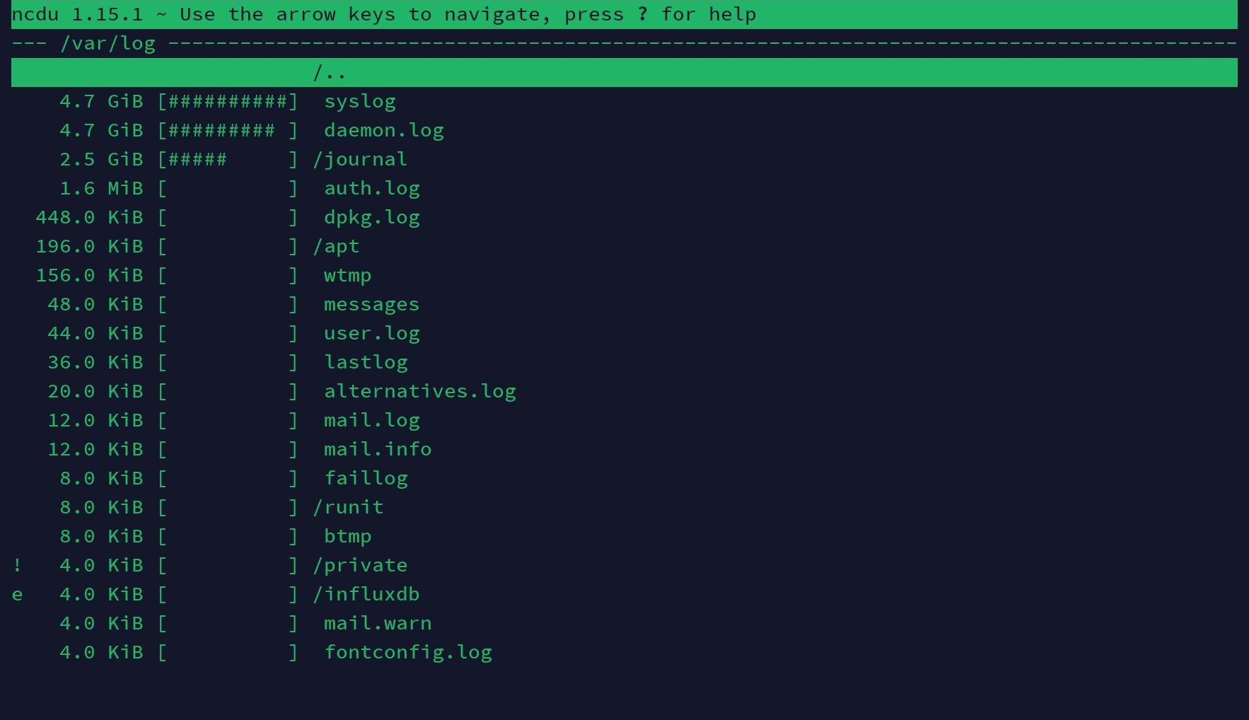

            Nordischerjung @Thomas Braun last edited by
            @thomas-braun Moin, ich habe die Syslog mal runtergeladen, die ist komplett vol mit dem hier (ist nur ein Ausschnitt, ist immer so ein ganzer Block mit influx)
            Sep 28 08:30:23 iOBroker influxd-systemd-start.sh[182]: [httpd] 127.0.0.1 - admin [28/Sep/2022:08:30:23 +0200] "POST /write?database=iobroker&db=iobroker&p=%5BREDACTED%5D&precision=ms&u=admin HTTP/1.1 " 204 0 "-" "-" 07fc50fc-3ef7-11ed-b728-72560074c759 2358
            Sep 28 08:30:23 iOBroker influxd-systemd-start.sh[182]: ts=2022-09-28T06:30:23.888800Z lvl=info msg="Executing query" log_id=0dBbw97l000 service=query query="SELECT value FROM iobroker.global.\"s7.0.Markers.22.Ist_Temp_Vor_Wint_li\" WHERE time <= '2022-09-25T07:00:00.000Z' ORDER BY time DESC LIMIT 1"
            Sep 28 08:30:23 iOBroker influxd-systemd-start.sh[182]: ts=2022-09-28T06:30:23.894495Z lvl=info msg="Executing query" log_id=0dBbw97l000 service=query query="SELECT * FROM iobroker.global.\"s7.0.Markers.22.Ist_Temp_Vor_Wint_li\" WHERE time > '2022-09-25T07:00:00.000Z' AND time < '2022-09-28T07:00:00.000Z' ORDER BY time ASC"
            Sep 28 08:30:24 iOBroker influxd-systemd-start.sh[182]: ts=2022-09-28T06:30:24.037551Z lvl=info msg="Executing query" log_id=0dBbw97l000 service=query query="SELECT value FROM iobroker.global.\"s7.0.Markers.22.Ist_Temp_Vor_Wint_li\" WHERE time >= '2022-09-28T07:00:00.000Z' LIMIT 1"
            Sep 28 08:30:24 iOBroker influxd-systemd-start.sh[182]: [httpd] 127.0.0.1 - admin [28/Sep/2022:08:30:23 +0200] "GET /query?db=iobroker&p=%5BREDACTED%5D&precision=ms&q=SELECT+value+from+%22s7.0.Markers.22.Ist_Temp_Vor_Wint_li%22+WHERE+time+%3C%3D+%272022-09-25T07%3A00%3A00.000Z%27+ORDER+BY+time+DESC+LIMIT+1%3BSELECT+%2A+from+%22s7.0.Markers.22.Ist_Temp_Vor_Wint_li%22+WHERE++time+%3E+%272022-09-25T07%3A00%3A00.000Z%27+AND++time+%3C+%272022-09-28T07%3A00%3A00.000Z%27+ORDER+BY+time+ASC%3BSELECT+value+from+%22s7.0.Markers.22.Ist_Temp_Vor_Wint_li%22+WHERE+time+%3E%3D+%272022-09-28T07%3A00%3A00.000Z%27+LIMIT+1&u=admin HTTP/1.1" 200 2926267 "-" "-" 08812fae-3ef7-11ed-b729-72560074c759 535085
            Sep 28 08:30:24 iOBroker influxd-systemd-start.sh[182]: ts=2022-09-28T06:30:24.830036Z lvl=info msg="Executing query" log_id=0dBbw97l000 service=query query="SELECT value FROM iobroker.global.\"s7.0.Markers.26.Ist_Temp_Rueck_Wint_li\" WHERE time <= '2022-09-25T07:00:00.000Z' ORDER BY time DESC LIMIT 1"
            Sep 28 08:30:24 iOBroker influxd-systemd-start.sh[182]: ts=2022-09-28T06:30:24.836450Z lvl=info msg="Executing query" log_id=0dBbw97l000 service=query query="SELECT * FROM iobroker.global.\"s7.0.Markers.26.Ist_Temp_Rueck_Wint_li\" WHERE time > '2022-09-25T07:00:00.000Z' AND time < '2022-09-28T07:00:00.000Z' ORDER BY time ASC"
            Sep 28 08:30:24 iOBroker influxd-systemd-start.sh[182]: ts=2022-09-28T06:30:24.990065Z lvl=info msg="Executing query" log_id=0dBbw97l000 service=query query="SELECT value FROM iobroker.global.\"s7.0.Markers.26.Ist_Temp_Rueck_Wint_li\" WHERE time >= '2022-09-28T07:00:00.000Z' LIMIT 1"
            oder so etwas so immer ca. 800 Zeilen von 07:30:03 - 07:30:20 zB
            Sep 28 07:30:18 iOBroker bash[18027]: Using TZID without Luxon available is unsupported. Returned times are in UTC, not the requested time zone

                        JLeg 1 Reply Last reply Reply Quote 0
                        • JLeg
                          JLeg @Nordischerjung last edited by
                          @nordischerjung sagte in iOBroker im LXC keine Verbindung mehr:
                          Aber wie bekomme ich denn jetzt diese syslog und daemon.log kleiner?
                          mit
                          sudo cat /dev/null > /var/log/syslog
                          wär' das erstmal auf "Dateigrösse 0"; dann am besten mal schauen, ob es in ''/etc/logrotate.d/rsyslog'' einen Eintrag für ''/var/log/syslog'' gibt (sollte es immer). Normalerweise steht das auf "daily", d.h. das Log wird jeden Tag wegrotiert...
                          N 2 Replies Last reply Reply Quote 0

                              • JLeg
                                @nordischerjung normalerweise sollten 7 Tage genügen - ist glaube ich auch Debian-Default:
                                rotate 7
                                daily
                                damit werden die Logs jeden Tag rotiert - und komprimiert. Sollte das nicht der Fall sein, müsstest du mal schauen, ob Logrotate überhaupt funktioniert. Erstest: "sudo logrotate /etc/logrotate.conf" sollte ohne Fehler aufgerufen werden können...
                                • N
                                  Nordischerjung @JLeg last edited by
                                  @jleg sagte in iOBroker im LXC keine Verbindung mehr:
                                  da kommt das
                                  sb@iOBroker:~$ sudo logrotate /etc/logrotate.conf
                                  sb@iOBroker:~$
                                    geht nicht, keine Berechtigung. Habe es mit nano probiert und mit Filezilla. Die Rechte kann ich auch nicht ändern
