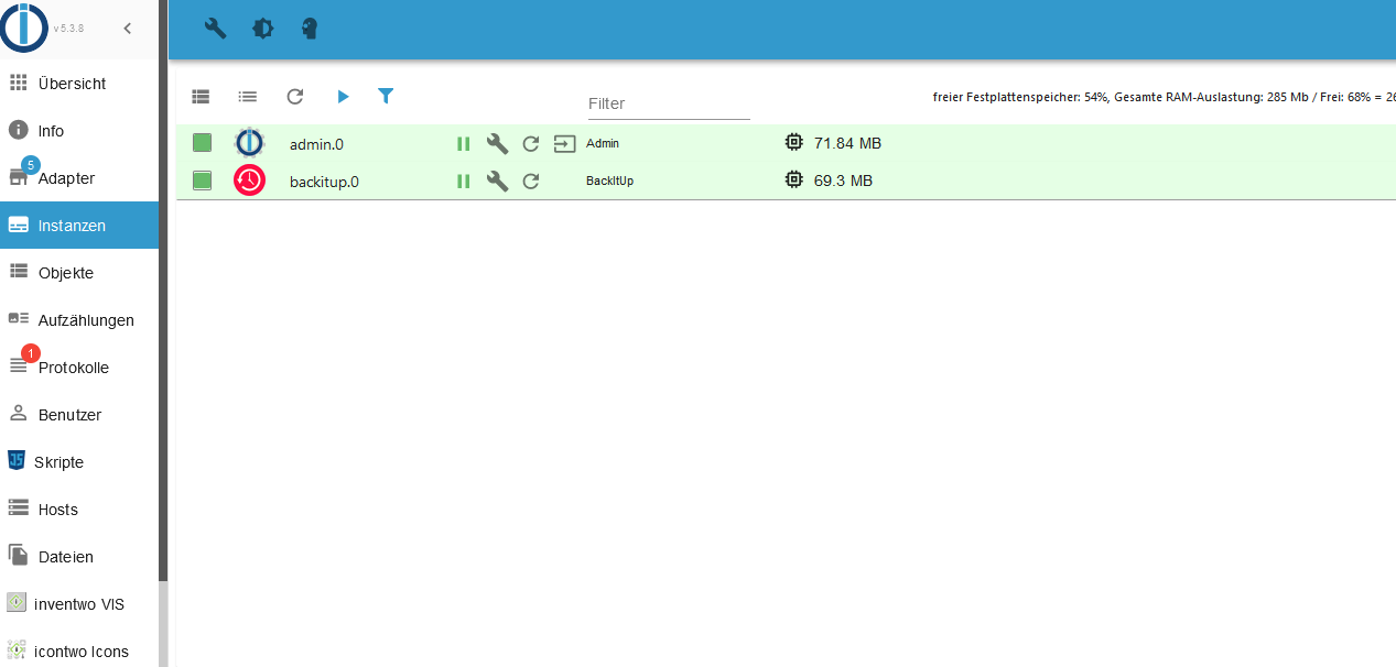

  • U user4711
    @glasfaser
    2022-08-20 13:14:56.438  - info: host.buanet-iobroker6 instance system.adapter.admin.0 terminated with code 11 (ADAPTER_REQUESTED_TERMINATION)
    2022-08-20 13:14:56.439  - info: host.buanet-iobroker6 instance system.adapter.backitup.0 terminated with code 11 (ADAPTER_REQUESTED_TERMINATION)
    2022-08-20 13:14:56.439  - info: host.buanet-iobroker6 instance system.adapter.javascript.0 terminated with code 11 (ADAPTER_REQUESTED_TERMINATION)
    2022-08-20 13:14:56.462  - info: host.buanet-iobroker6 instance system.adapter.web.0 terminated with code 11 (ADAPTER_REQUESTED_TERMINATION)
    2022-08-20 13:14:56.462  - info: host.buanet-iobroker6 All instances are stopped.
    2022-08-20 13:14:56.505  - info: host.buanet-iobroker6 terminated
    2022-08-20 13:16:22.364  - info: host.buanet-iobroker1 iobroker.js-controller version 4.0.23 js-controller starting
    2022-08-20 13:16:22.367  - info: host.buanet-iobroker1 Copyright (c) 2014-2022 bluefox, 2014 hobbyquaker
    2022-08-20 13:16:22.367  - info: host.buanet-iobroker1 hostname: buanet-iobroker1, node: v16.17.0
    2022-08-20 13:16:22.368  - info: host.buanet-iobroker1 ip addresses: 192.168.200.150
    2022-08-20 13:16:22.954  - info: host.buanet-iobroker1 connected to Objects and States
    2022-08-20 13:16:22.972  - info: host.buanet-iobroker1 added notifications configuration of host
    2022-08-20 13:16:22.975  - info: host.buanet-iobroker1 Node.js version has changed from 14.19.3 to 16.17.0
    2022-08-20 13:16:23.214  - info: host.buanet-iobroker1 Delete host system.host.buanet-iobroker6
    2022-08-20 13:16:23.271  - info: host.buanet-iobroker1 33 instances found
    2022-08-20 13:16:23.280  - warn: host.buanet-iobroker1 does not start any instances on this host
    2022-08-20 13:16:23.440  - info: host.buanet-iobroker1 Successfully updated capabilities "cap_net_admin, cap_net_bind_service, cap_net_raw" for /usr/bin/node
    2022-08-20 13:24:51.958  - info: host.buanet-iobroker1 received SIGTERM
    2022-08-20 13:24:51.981  - info: host.buanet-iobroker1 terminated
    2022-08-20 13:25:19.152  - info: host.buanet-iobroker1 iobroker.js-controller version 4.0.23 js-controller starting
    2022-08-20 13:25:19.156  - info: host.buanet-iobroker1 Copyright (c) 2014-2022 bluefox, 2014 hobbyquaker
    2022-08-20 13:25:19.156  - info: host.buanet-iobroker1 hostname: buanet-iobroker1, node: v16.17.0
    2022-08-20 13:25:19.156  - info: host.buanet-iobroker1 ip addresses: 192.168.200.150
    2022-08-20 13:25:19.718  - info: host.buanet-iobroker1 connected to Objects and States
    2022-08-20 13:25:19.736  - info: host.buanet-iobroker1 added notifications configuration of host
    2022-08-20 13:25:19.957  - info: host.buanet-iobroker1 33 instances found
    2022-08-20 13:25:19.964  - warn: host.buanet-iobroker1 does not start any instances on this host
    2022-08-20 13:27:28.027  - info: host.buanet-iobroker1 received SIGTERM
    2022-08-20 13:27:28.048  - info: host.buanet-iobroker1 terminated                                                                                                              2022-08-20 13:14:40.013  - warn: javascript.0 (639)     at Object.<anonymous> (script.js.Summegesamtwertalleaddieren-aus-ccu:33:105)

    GlasfaserG Offline
    GlasfaserG Offline
    Glasfaser
    #61
    @user4711
    pkill -u iobroker
    iobroker host this
    iobroker fix
    danach den Container über die Dockeroberfläche neu starten .
    und warten , es fehlen noch Adapter die nachinstalliert werden !!

            @glasfaser ok hab log laufen lassen da wurde was installiert :

            bei aktive Instanzen steht aber immer noch nur Admin und backitup
              GlasfaserG Offline
              GlasfaserG Offline
              Glasfaser
              #66
              @user4711
              Zeige mal ein Screenshot von den Instanzen
              U HomoranH 2 Antworten Letzte Antwort

                user4711
                #67
                @glasfaser

                  GlasfaserG Offline
                  GlasfaserG Offline
                  Glasfaser
                  #68
                  @user4711
                  Da stimmt was nicht ....
                  das Backup wurde nicht installiert ... !
                  da sollten alle Adapter-Instanzen kommen die du mal installiert hattest .
                  Nimm BackitUp , kannst du dort ein Backup auswählen ,
                  Bzw. lege dein Backup in den Ordner zuvor
                  U 1 Antwort Letzte Antwort

                      @glasfaser sorry war einges ausgeblendet, und viele Instanzen nichgt gestartet
                      JS läuft, VIS wird auch angezeigt aber verstümmlet fehlen fast alle Anzeigen
