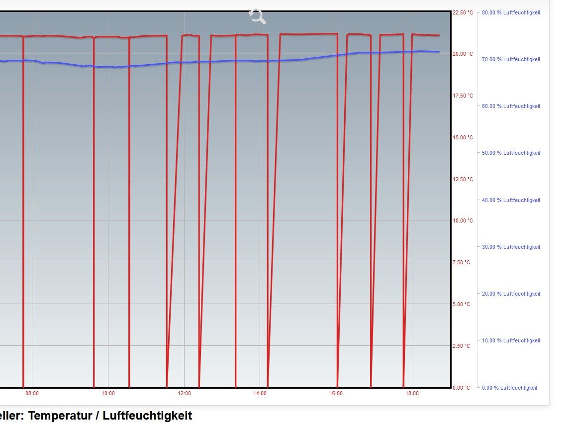

        @homoran Hier hab ich ihn endlich erwischt:
        2022-06-27 06:08:00.864 - debug: sql.0 (10128) new value received for deconz.0.sensors.00158d0004659051.humidity, new-value=70.47, ts=1656302880864, relog=false
        2022-06-27 06:08:00.864 - debug: sql.0 (10128) Min-Delta reached deconz.0.sensors.00158d0004659051.humidity, last-value='70.22', new-value=70.47, ts=1656302880864
        2022-06-27 06:08:00.866 - debug: sql.0 (10128) new value received for deconz.0.sensors.00158d0004659051.temperature, new-value=21.07, ts=1656302880864, relog=false
        2022-06-27 06:08:00.866 - debug: sql.0 (10128) Min-Delta reached deconz.0.sensors.00158d0004659051.temperature, last-value='0', new-value=21.07, ts=1656302880864
        2022-06-27 06:08:00.866 - debug: sql.0 (10128) Datatype deconz.0.sensors.00158d0004659051.temperature: Currently: number, StorageType: String
        2022-06-27 06:08:00.866 - debug: sql.0 (10128) pushValueIntoDB called for deconz.0.sensors.00158d0004659051.temperature (type: 1, ID: 37) and state: {"val":"21.12","ack":true,"ts":1656301786559,"q":0,"from":"system.adapter.deconz.0","user":"system.user.admin","lc":1656301786546}
        2022-06-27 06:08:00.866 - debug: sql.0 (10128) prepareTaskCheckTypeAndDbId CALLED for deconz.0.sensors.00158d0004659051.temperature
        2022-06-27 06:08:00.866 - debug: sql.0 (10128) pushValueIntoDB-prepareTaskCheckTypeAndDbId RESULT for deconz.0.sensors.00158d0004659051.temperature (type: 1, ID: 37) and state: {"val":"21.12","ack":true,"ts":1656301786559,"q":0,"from":"system.adapter.deconz.0","user":"system.user.admin","lc":1656301786546}
        2022-06-27 06:08:00.866 - debug: sql.0 (10128) INSERT INTO `iobroker-db`.ts_string (id, ts, val, ack, _from, q) VALUES(37, 1656301786559, '21.12', 1, 7, 0);
        2022-06-27 06:08:00.873 - error: sql.0 (10128) Cannot insert INSERT INTO `iobroker-db`.ts_string (id, ts, val, ack, _from, q) VALUES(37, 1656301786559, '21.12', 1, 7, 0);: Error: ER_DUP_ENTRY: Duplicate entry '37-1656301786559' for key 'ts_string.PRIMARY' (id: deconz.0.sensors.00158d0004659051.temperature)
        2022-06-27 06:08:01.867 - debug: sql.0 (10128) Datatype deconz.0.sensors.00158d0004659051.humidity: Currently: number, StorageType: String
        2022-06-27 06:08:01.867 - debug: sql.0 (10128) pushValueIntoDB called for deconz.0.sensors.00158d0004659051.humidity (type: 1, ID: 38) and state: {"val":"70.47","ack":true,"ts":1656302880864,"q":0,"from":"system.adapter.deconz.0","user":"system.user.admin","lc":1656302880864}
        2022-06-27 06:08:01.867 - debug: sql.0 (10128) prepareTaskCheckTypeAndDbId CALLED for deconz.0.sensors.00158d0004659051.humidity
        2022-06-27 06:08:01.867 - debug: sql.0 (10128) pushValueIntoDB-prepareTaskCheckTypeAndDbId RESULT for deconz.0.sensors.00158d0004659051.humidity (type: 1, ID: 38) and state: {"val":"70.47","ack":true,"ts":1656302880864,"q":0,"from":"system.adapter.deconz.0","user":"system.user.admin","lc":1656302880864}
        2022-06-27 06:08:01.867 - debug: sql.0 (10128) INSERT INTO `iobroker-db`.ts_string (id, ts, val, ack, _from, q) VALUES(38, 1656302880864, '70.47', 1, 7, 0);
        2022-06-27 06:08:01.868 - debug: sql.0 (10128) Datatype deconz.0.sensors.00158d0004659051.temperature: Currently: number, StorageType: String
        2022-06-27 06:08:01.868 - debug: sql.0 (10128) pushValueIntoDB called for deconz.0.sensors.00158d0004659051.temperature (type: 1, ID: 37) and state: {"val":"21.07","ack":true,"ts":1656302880864,"q":0,"from":"system.adapter.deconz.0","user":"system.user.admin","lc":1656302880864}
        2022-06-27 06:08:01.868 - debug: sql.0 (10128) prepareTaskCheckTypeAndDbId CALLED for deconz.0.sensors.00158d0004659051.temperature
        2022-06-27 06:08:01.868 - debug: sql.0 (10128) pushValueIntoDB-prepareTaskCheckTypeAndDbId RESULT for deconz.0.sensors.00158d0004659051.temperature (type: 1, ID: 37) and state: {"val":"21.07","ack":true,"ts":1656302880864,"q":0,"from":"system.adapter.deconz.0","user":"system.user.admin","lc":1656302880864}
        2022-06-27 06:08:01.868 - debug: sql.0 (10128) INSERT INTO `iobroker-db`.ts_string (id, ts, val, ack, _from, q) VALUES(37, 1656302880864, '21.07', 1, 7, 0);
        Komisch nur, dass es nur bei dem Temperaturwert passiert... So siehts im Flot-Adapter aus:

          @surfer09 sagte in Fehler im LOG SQL-Adapter:
          ich hab es jetzt nicht erkannt, nutze weder sql noch deconz.
          ich denke aber dass es an der 0 liegt
                  in der tabelle ts_string sind die felder id und ts (also datenpunktid=id und timestamp=ts) beide als primärschlüssel definiert.
                  Die Fehlermeldung
                  sagt aus, das für die Kombination datenpunktid 37 (den namen dazu kann man in tabelle datapoints nachschauen) und timestamp 2 werte geschrieben werden sollten.
                  der erste hat geklappt, der 2. nicht, da die beiden schlüssel zusammen eindeutig sein müssen.
                  wenn du keine eigenen skripts verwendest mit denen du daten da reinschreibst, sollte das durch dich eigentlich nicht möglich sein. der timestamp löscht auf 1000ste Sekunde auf. Auch das so schnell neue Daten entstehen wahrscheinlich auch nicht.
                  Von daher, am besten die Softwarestände des history und des sql adapters prüfen, ggfs. aktualisieren oder gar neu installieren.
                  die 0 werte in deinem diagram dürften nichts mit dem fehler zu tun haben. das kommt dann zustande wenn der sensor mal eine 0 liefert weil er nichts messen konnte. die kannst du glaube ich aber in den einstellungen des history/sql/flot-adapters herausfiltern.
                  surfer09 1 Reply Last reply Reply Quote 1

                    @oliverio @mickym : Sorry, die Version hatte ich vergessen. Ich hatte die 1.16.2 im Einsatz, habe jetzt aber auf die 2.1.3 hochgezogen. Mal sehen, was jetzt so passiert.
                    surfer09 1 Reply Last reply Reply Quote 0
                    • surfer09
                      surfer09 @surfer09 last edited by
                      Die Version 2.1.3 scheint fehlerfrei zu funktionieren. Seit der Installation habe ich keine Fehler mehr und auch die Werte im FLOT Adapter sind jetzt durchgehend wieder plausibel.
