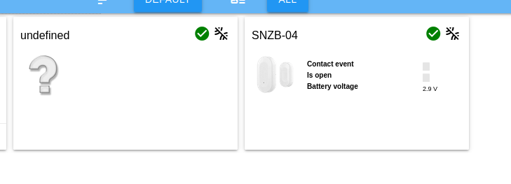

                                        @thomas-braun Danke, hat geklappt...paring geht immer noch nicht aber er hatte jetzt
                                        zigbee.0
                                        	2022-06-15 21:48:23.035	error	Device 0x60a423fffeebdcf4 "undefined" not described in statesMapping.
                                        zigbee.0
                                        	2022-06-15 21:48:22.874	info	debug devices set to []
                                        zigbee.0
                                        	2022-06-15 21:48:22.838	warn	download icon Switch1 for undefined Device not available. Check your devices.
                                        es wird besser
                                        zigbee.0
                                        	2022-06-15 21:52:26.217	info	Zigbee: stop joining
                                        zigbee.0
                                        	2022-06-15 21:51:12.634	info	Starting interview of '0x5c0272fffe81d3a2'
                                        zigbee.0
                                        	2022-06-15 21:53:30.984	error	Failed to interview '0x5c0272fffe81d3a2', device has not succesfully been paired. undefined
                                        nein leider nichts:
                                        zigbee.0
                                        	2022-06-15 22:00:16.275	error	Failed to interview '0x5c0272fffe81d3a2', device has not succesfully been paired. undefined
                                        zigbee.0
                                        	2022-06-15 21:59:46.547	info	Zigbee: stop joining
                                        zigbee.0
                                        	2022-06-15 21:57:58.074	info	Starting interview of '0x5c0272fffe81d3a2'
                                        zigbee.0
                                        	2022-06-15 21:57:15.175	info	Zigbee: allowing new devices to join.
                                        arteck 1 Reply Last reply Reply Quote 0
