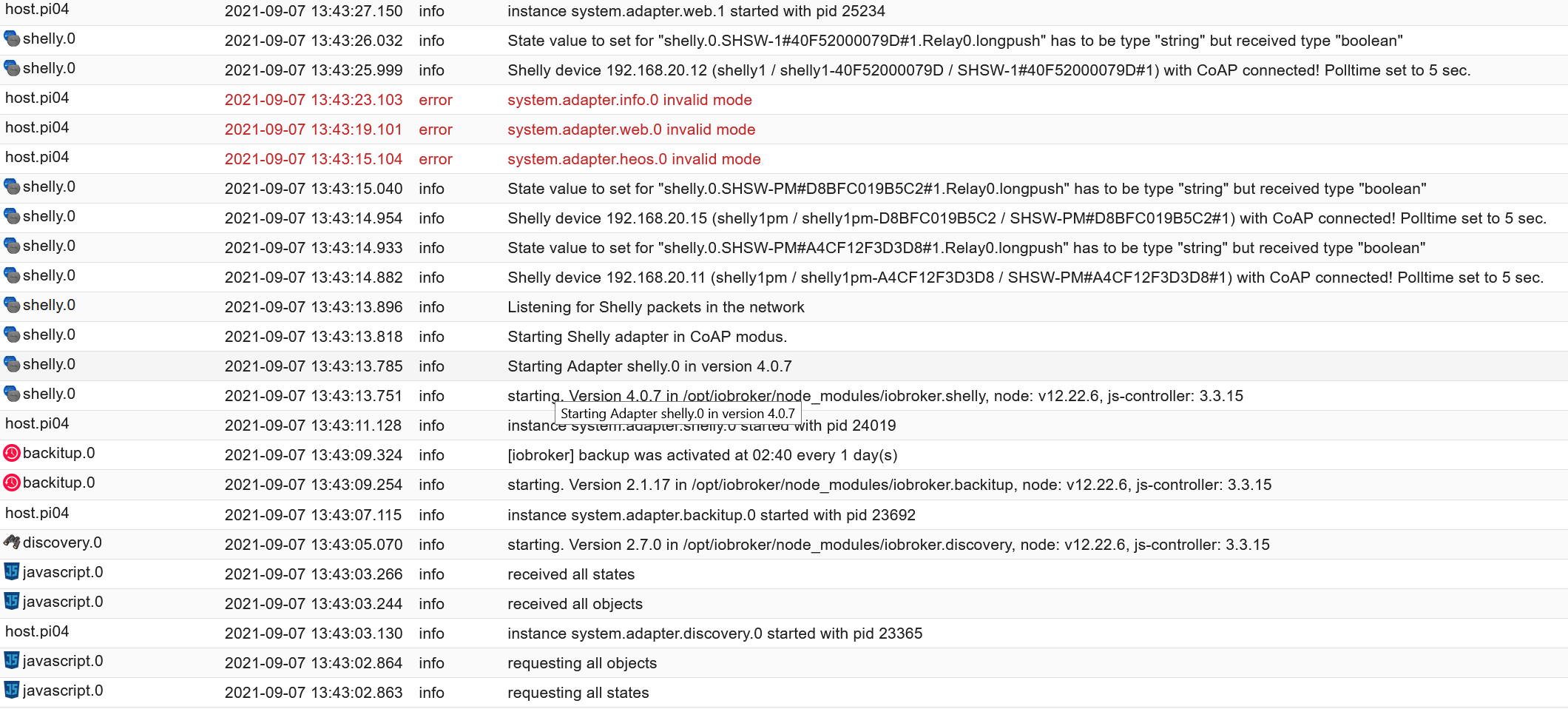

    @fastfoot :
    sudo curl -sL https://deb.nodesource.com/setup_12.x | sudo -E bash -
    sudo apt install -y nodejs
    sudo reboot now
    sudo curl -sL https://iobroker.net/install.sh | bash -
    sudo reboot now
    Raspbian was installed with the Raspi_Imager_1.6.2
    @dbh sagte in Adapters show invalid mode:
    is the only line that is necessary for a clean installation.
    What does your system reply to
    iobroker status
    iobroker update -i
    iobroker list adapters
    iobroker list instances
    D 1 Antwort Letzte Antwort

      DBh
      @thomas-braun
      Hi Thomas,
      here the response to the commands:
      pi@pi04:/opt/iobroker $ iobroker status
      Objects type: file
      States type: file
      pi@pi04:/opt/iobroker $ iobroker update -i
      Used repository: default
      hash changed or no sources cached => force download of new sources
      update done
      Adapter "admin" : 5.1.23 , installed 5.1.23
      Adapter "backitup" : 2.1.17 , installed 2.1.17
      Adapter "discovery" : 2.7.0 , installed 2.7.0
      Adapter "heos" : 1.8.6 , installed 1.8.6
      Adapter "info" : 1.9.8 , installed 1.9.8
      Adapter "javascript" : 5.2.8 , installed 5.2.8
      Controller "js-controller" : 3.3.15 , installed 3.3.15
      Adapter "node-red" : 2.4.0 , installed 2.4.0
      Adapter "shelly" : 4.0.7 , installed 4.0.7
      Adapter "simple-api" : 2.6.1 , installed 2.6.1
      Adapter "socketio" : 3.1.4 , installed 3.1.4
      Adapter "vis" : 1.4.3 , installed 1.4.3
      Adapter "web" : 3.4.7 , installed 3.4.7
      pi@pi04:/opt/iobroker $ iobroker list adapters
      system.adapter.admin : admin - v5.1.23
      system.adapter.backitup : backitup - v2.1.17
      system.adapter.discovery : discovery - v2.7.0
      system.adapter.heos : heos - v1.8.6
      system.adapter.info : info - v1.9.8
      system.adapter.javascript : javascript - v5.2.8
      system.adapter.node-red : node-red - v2.4.0
      system.adapter.shelly : shelly - v4.0.7
      system.adapter.web : web - v3.4.7
      pi@pi04:/opt/iobroker $ iobroker list instances
      • system.adapter.admin.0 : admin : pi04 - enabled, port: 8081, bind: 0.0.0.0, run as: admin
      • system.adapter.backitup.0 : backitup : pi04 - enabled
      • system.adapter.discovery.0 : discovery : pi04 - enabled
        system.adapter.heos.0 : heos : pi04 - enabled
        system.adapter.info.0 : info : pi04 - enabled
      • system.adapter.javascript.0 : javascript : pi04 - enabled
      • system.adapter.node-red.0 : node-red : pi04 - enabled, port: 1880, bind: 0.0.0.0
      • system.adapter.shelly.0 : shelly : pi04 - enabled, port: 1882, bind: 0.0.0.0
        system.adapter.web.0 : web : pi04 - enabled
      • system.adapter.web.1 : web : pi04 - enabled, port: 8082, bind: 0.0.0.0, run as: admin
      • instance is alive
      Cheers
      Dieter

            @dbh
            iobroker start info
            Und warum zwei Instanzen von web?

                  @dbh
                  Was steht in den drei Objekten
                  • system.adapter.heos.0
                  • system.adapter.info.0
                  • system.adapter.web.0
                  unter "OBJEKTDATEN" hinter common.mode? Expertenmodus aktivieren!

                          @dbh
                          Da ist wohl beim Erstellen der Instanzen einiges schief gelaufen.
                          Lösche die Instanzen und erstelle sie neu. Falls es dann immer noch so aussieht, lösche die Adapter und installiere sie neu.
                          D 2 Antworten Letzte Antwort
                            @dbh
                            DBh
                            @paul53 Danke, mache ich
                              @dbh
                              DBh
                              @paul53 Das Löschen und Neuanlegen der Instanzen hat gereicht. Läuft, besten Dank!
                              • D DBh
                                @dbh sagte: Löschen und Neuanlegen der Instanzen hat gereicht.
                                Dann markiere bitte das Thema in der Überschrift des ersten Beitrags als [Gelöst].
