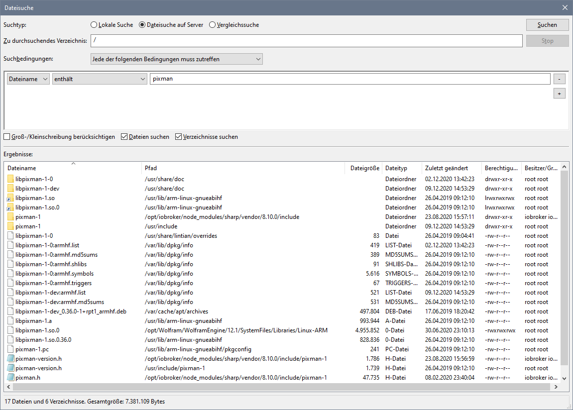

    sudo apt update
    sudo apt install build-essential libcairo2-dev libpango1.0-dev libjpeg-dev libgif-dev librsvg2-dev libpixman-1-dev
    sudo apt dist-upgrade
    sudo reboot
